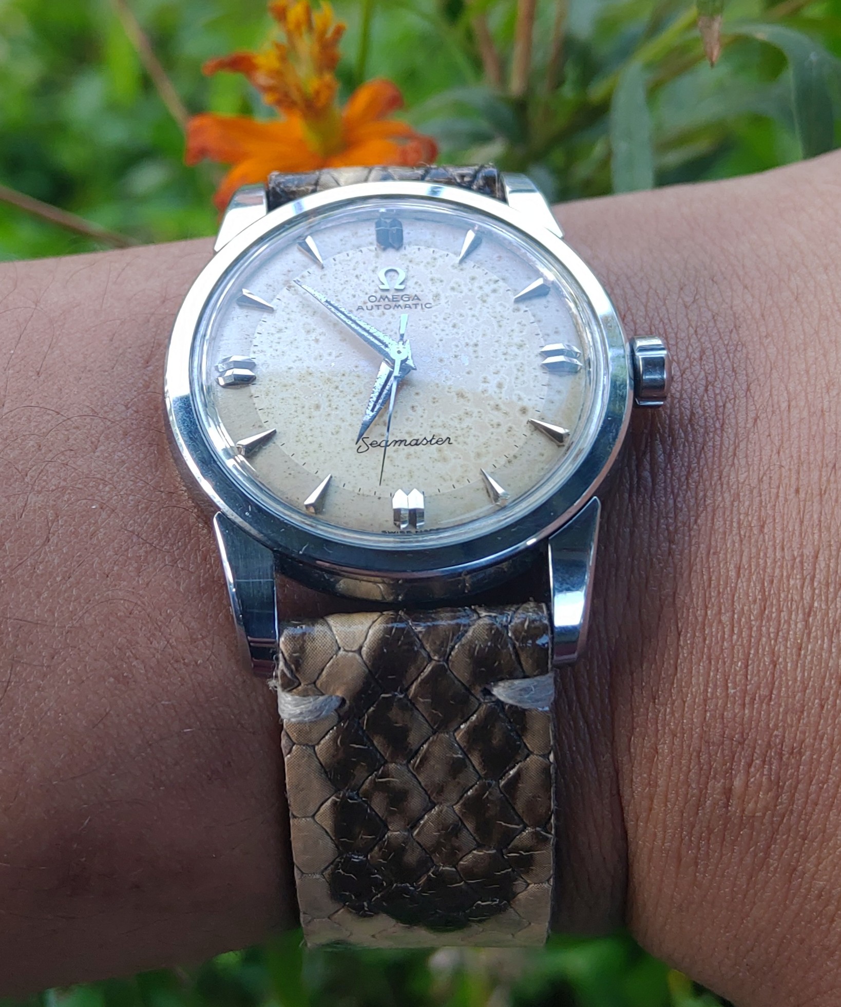

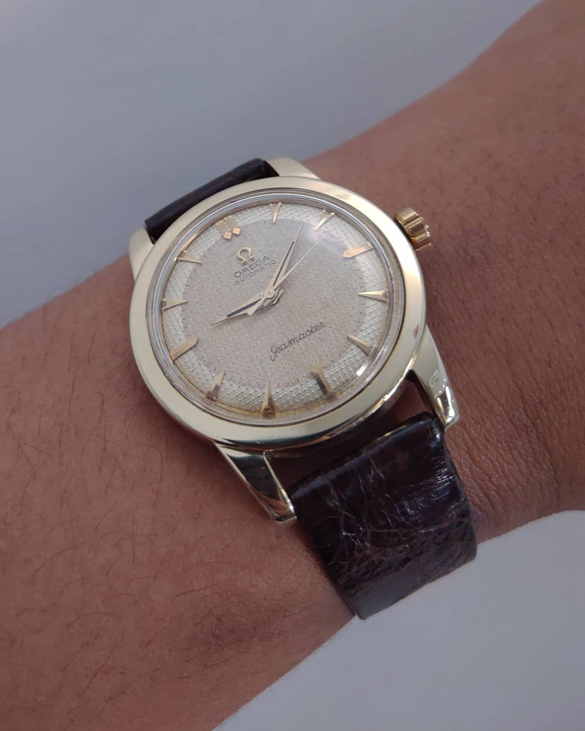

Ouh.... I've seen https://www.instagram.com/dial.doctor done it or fellow member that done it here in this forum in the thread "show us your patterned dials", said only 2secs dip into lemon juice. I'm wondering if that's possible without damaging the dial texts or things in the process but those people seems really good tho.... Im curious about that so that leads the question on how in the world you do that. 馃槻

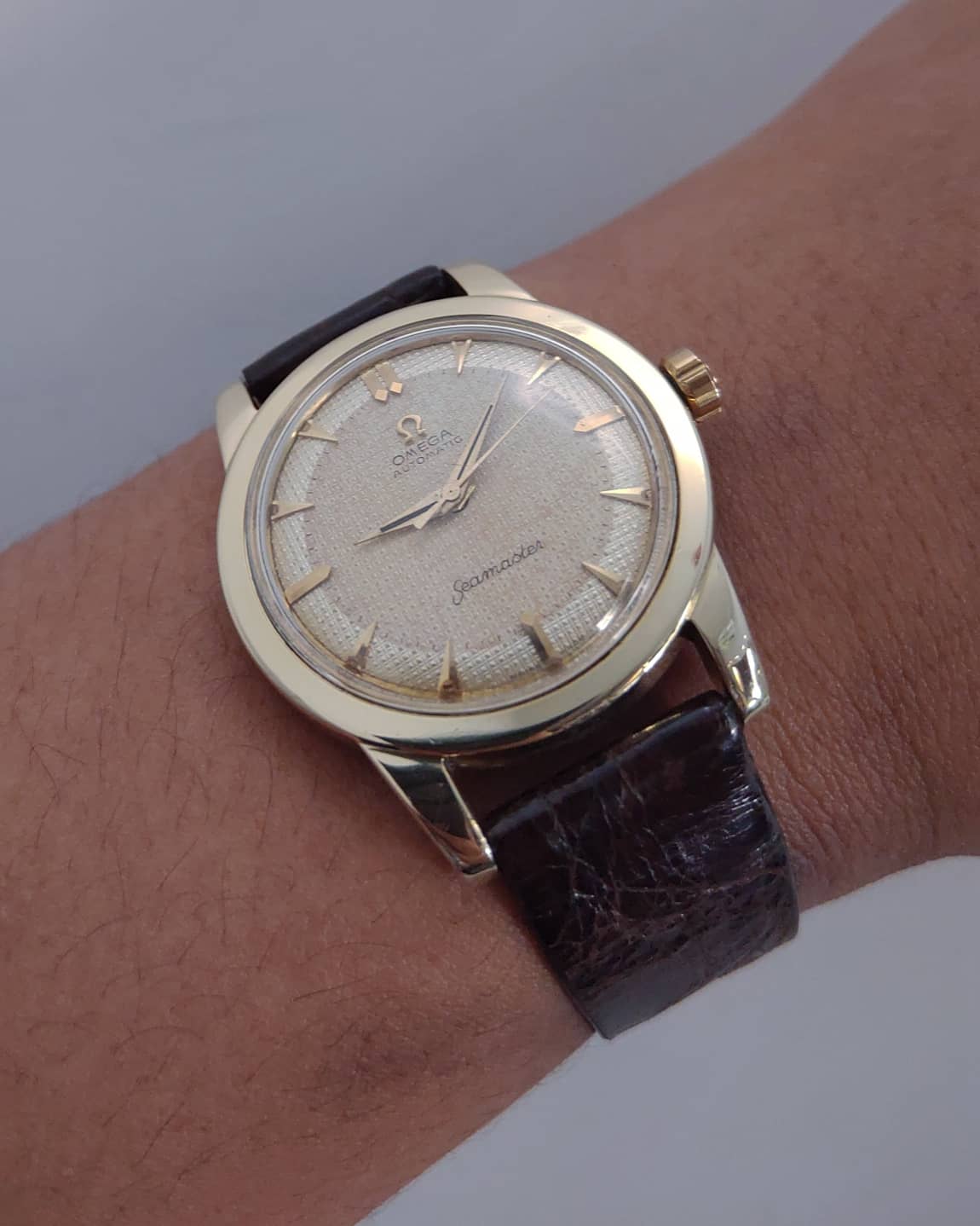

I was talking about this Giff2577 post in here...
https://omegaforums.net/threads/show-your-honeycomb-textured-omega-dial.14340/page-8
What do you think?

I did the lemon juice trick on two dials, the first was a lady Seamaster that was orange from years of funk- it removed the lume and lacquer but the lettering was fine and it came out like a gem. The second was a disaster- a water damaged Silver dialed Seamaster that had a modeled finish but wasn鈥檛 horrible- the lettering floated right off- it was awful. That one got redialed and eventually sold.
I have a good friend who does my spot cleaning (the Burgeron sticky swabs and Rodico) and relumes hands for me. It鈥檚 amazing how well a light cleaning can remove the funk, but you really have to know what you鈥檙e doing, go slowly and never be aggressive. This is not something to do on a watch you care about unless you are a total pro and go in with realistic expectations.

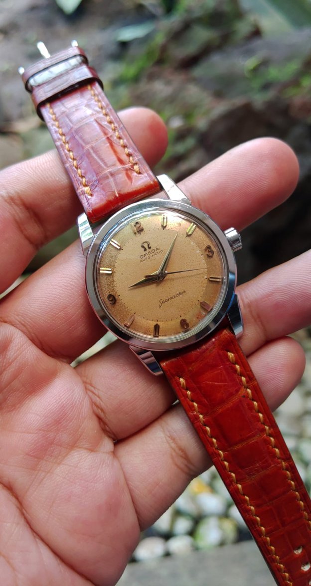

Still loved my dial though on these beauties... Though, if there's a way to restore the condition of a vintage watch into how the way it looks when it was produced, that would be fantastic, for the watch and the owner that inherited them, I guess?
