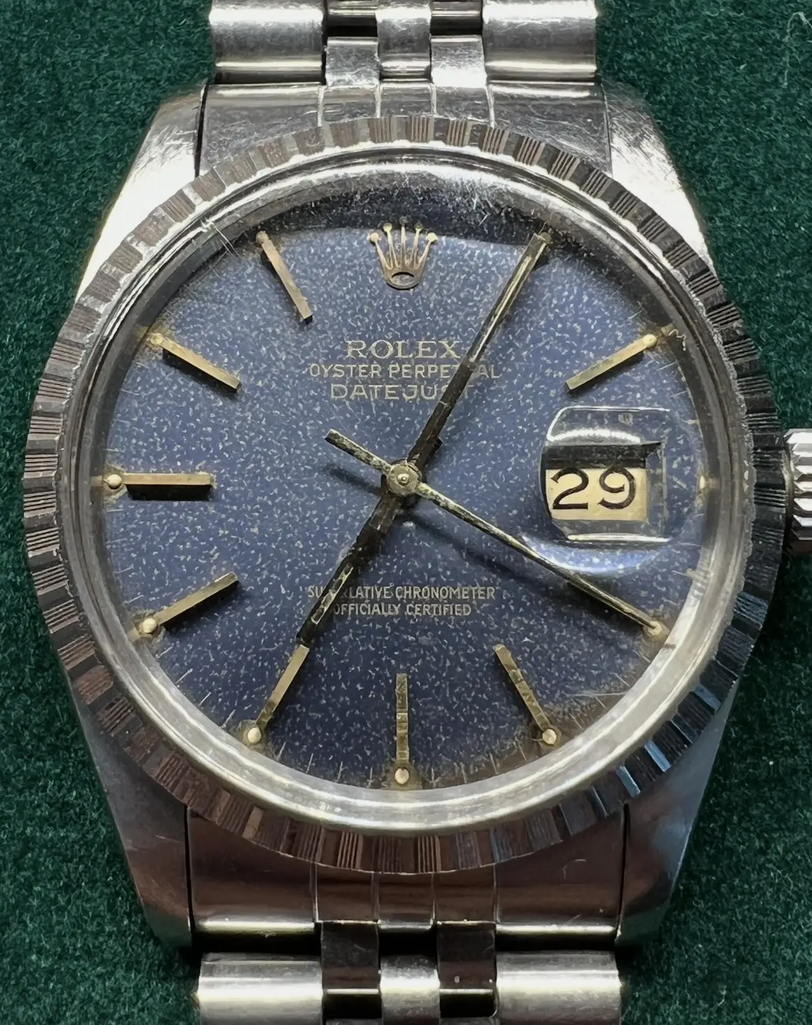

Datejust 16030 with lots of sentimental value given by family member. The tritium dial and hands are tarnished and hardly legible (water damage on both). Runs great, previously serviced and cal. 3035 overhauled in 2017 by Rolex (no new parts/polish).

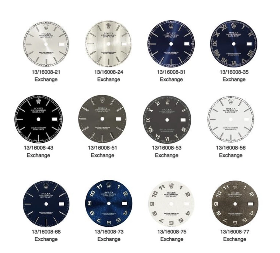

I’m thinking about replacing the dial and hands now to freshen it up. SC gave me these options (+ full service required):
I’ll lose the open 6 and 9 datewheel, in addition to the tritium dial and hands.
Should I do this for a sum of $2,100? Dilemma is between making it wearable vs. keeping its old charm and sentimental value of the family member. What would you do?

Lot of money for a servicedial. I’d swap but not for a brand new dial (and service at an independent)
3,442
9,146
I'd go with the -31, but that's just me.
Very fair point, but no independent has parts in my city. Genuine dial and hands on eBay are going to set me back ~$1,000. Not to mention the Rolex service gives you a new crystal, service card and warranty. It’s a tough choice between cost, parts back. It would suck loosing the original dial and datewheel.
It’s either 31 or 68. A tough choice between the two as well.
Sounds high. Anyway: then 31

From the choices you ate given, I'd say -68 because it's most like the original, no ?
68 would definitely be the closest to the original.

I vote 68 and its your watch. I say go for the factory spa treatment.

Isn’t the original dial grey? If you’re changing I’d say 51.
However, as to whether you should:shouldn’t change it, I’d need a much better picture of the current dial to form an opinion. The one picture we have is really poor and it’s impossible to confirm the condition of the dial.

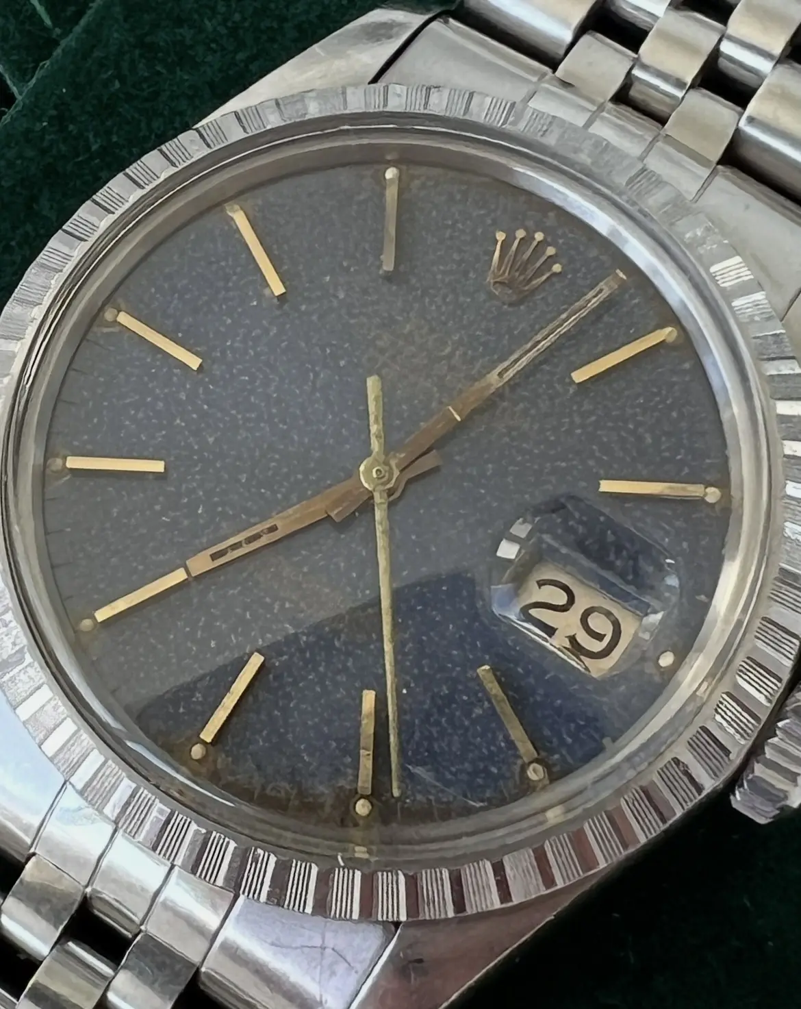

Here’s a couple closer looks (natural light and under direct light):
The dial is a stunner and would have patina’d beautifully if it weren’t for water intrusion. Shame.
(Oh and check out that open “9”… they don’t make em like that anymore)
Oh wow, that actually looks cool. On the initial picture, it looked like the dial was fully gone.
Hmm, this changes my personal opinion (just mine!).
If you find someone skilled in restorations, a lot can be saved here. The hands can be polished and replated. Same for the hour markers. The dial itself is a pretty cool "starry night". The datewheel can probably be cleaned as well. The most tricky bit would be the dial edge between 4 and 6 o'clock (and 11?).
I’ve looked into this, and no one wants to touch it with a ten-foot pole. The hands and indices are lacquered, and they can’t be polished off. Every watchmaker I’ve consulted told me to leave them as is.
I appreciate your opinion on the dial. It has developed a patina unique to blue dial Rolexes of the age. It would have looked stunning without the water intrusion.
