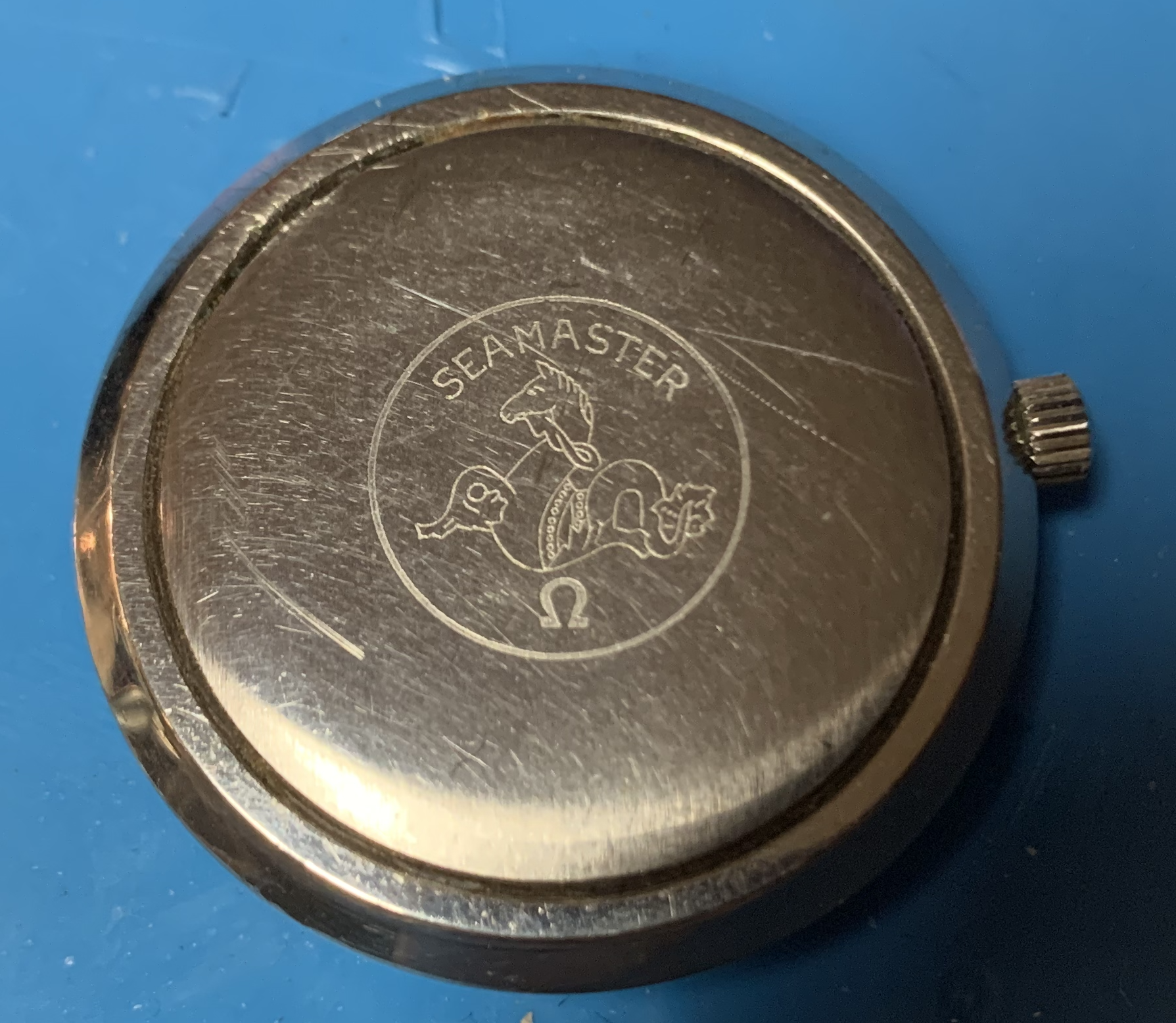

When logging some of my watch case numbers I found I can not figure out how to open this one:

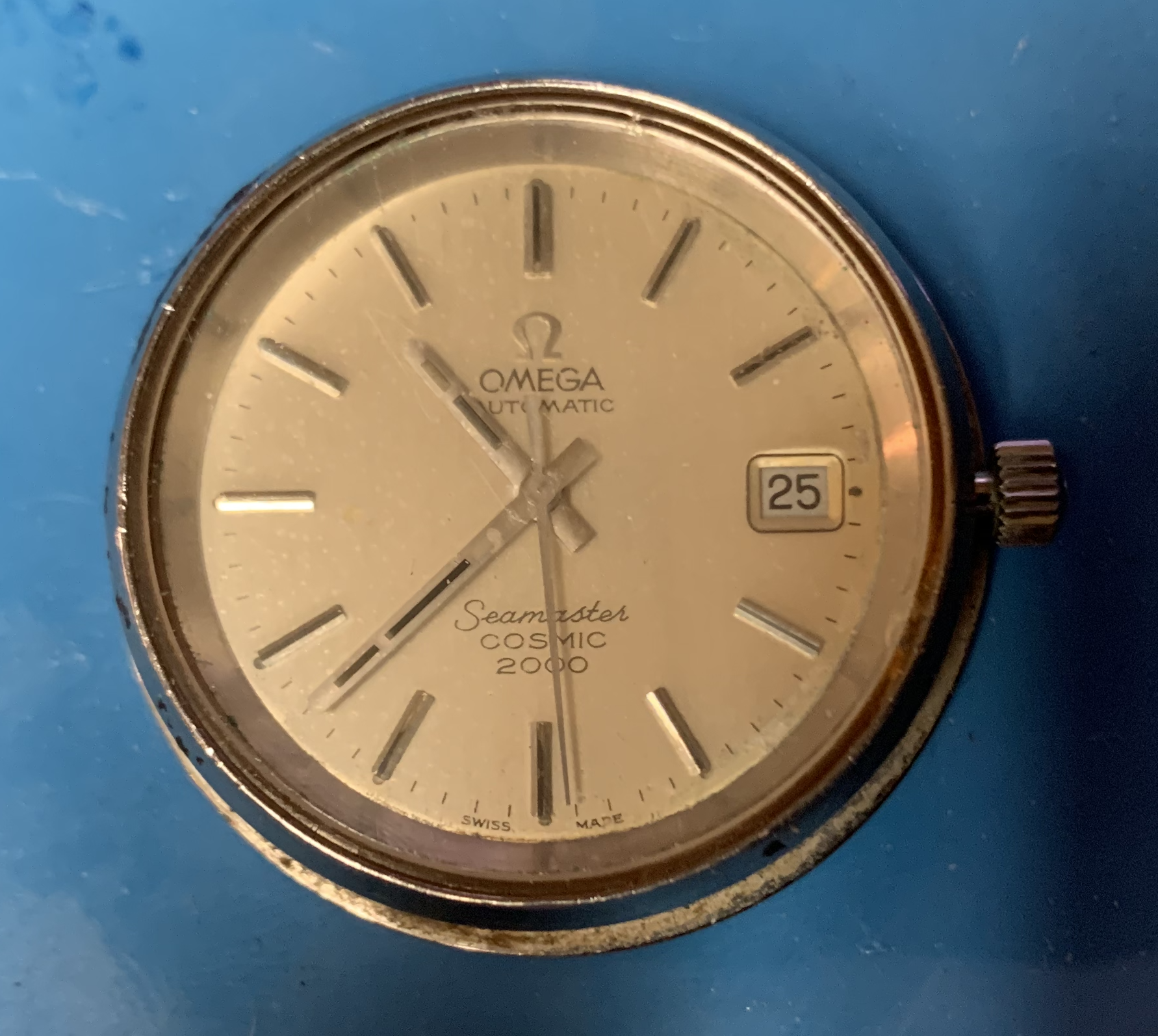

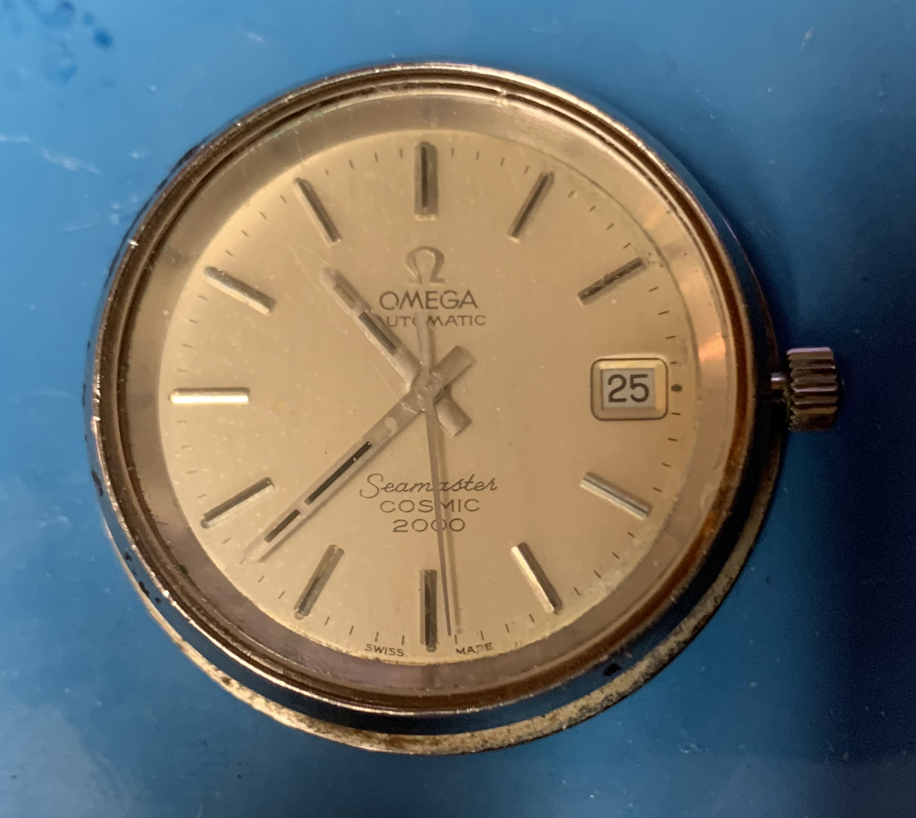

(note the dial is silver not sure why it came out gold under the flourecent light)

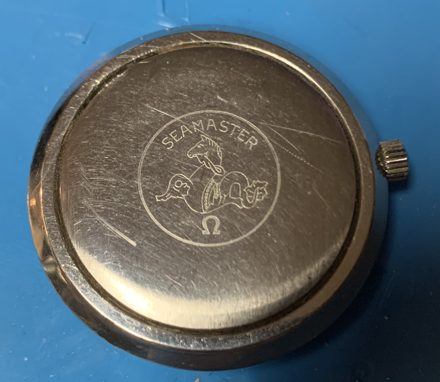

Here is the back. This looks like it fit into a larger outer case with a rubber gasket in a grove. There seems to be a divot where a case opener can be inserted. I see a lot of scratches near it (and mea culpa I added a few more this evening.)
I know some seamaster cases are opened from the front and use a split stem. But before I start tugging on the stem I thought I might ask for advice here first.

The movement is contained in a "tuna can" and sealed by the crystal and associated plastic gasket.
From memory it has a split stem, which when removed will allow you to use a pump to increase pressure inside the case until the crystal pops off.

Guess I will not be opening it in the near future. You are correct about the split stem. For all the stuff I do have, I do not have the necissary pump. Surprisingly the watch runs. The only reason I would have opened it would be to document the date and movement caliber (so I do not have to keep opening things to see what they are.)

Caliber 1012, approx 1970 to 1979.

Remove the crown by pulling it outward to release the crown and stud from the internal stem. The stem will be in the hand setting position, so you’l need to apply a tool to reach through the case tube to press the split stem inward to the run position. The movement, case back, and crystal then can be pressed out of the case by using a crystal press. Maybe have somebody do this for you, if you are unsure. Are you sure you can do what is needed to the movement, if you do get it out of the case? Then, you have to be able to get it back together!
