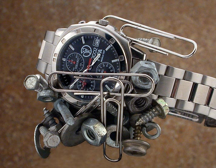

  9. STANDY schizophrenic pizza orderer and watch collector Jan 4, 2019
    16,381
    45,035
    If your watch looks like this worry
    Read this thread @Archer and @Canuck being watchmakers have some great input
    https://omegaforums.net/threads/omega-watch-arrived-and-not-working.86812/
    gemini4, orario and Darlinboy like this.
