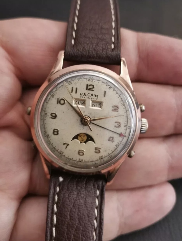

Hello guys!
I found this beautiful vintage Vulcain watch online that I could get for around 400€. It is a triple calendar with a moonphase. (Talked with the seller and agreed on price privately)
There is just one problem: the seller has stated that the month pusher nor the window isn't working. The pusher seems to be "stuck", as he described it. All the other functions work.
How bad of a problem is this and how much would it cost approx. to get it fixed?

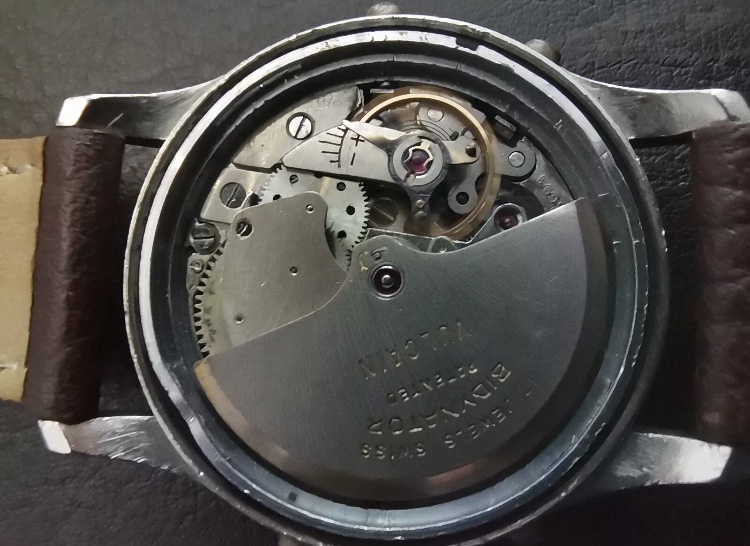

Thanks for pointing that out, here is a pic of the movement 😀
7,797
14,399
Could be something as simple as dirt obstructing the pusher operation which could be fixed when the movement is cleaned. Or it could be a broken wire jumper spring or a bent lever, they can all be repaired. No idea of the cost but probably more than the purchase price.
15,996
48,111
Basic Felsa 690 with complications. Cost to repair? How might we know? Behind the dial, this is rather a complex watch, and it likely will need to be dismantled entirely in order to diagnose and solve whatever is wrong. Expect to have to take out a second mortgage.

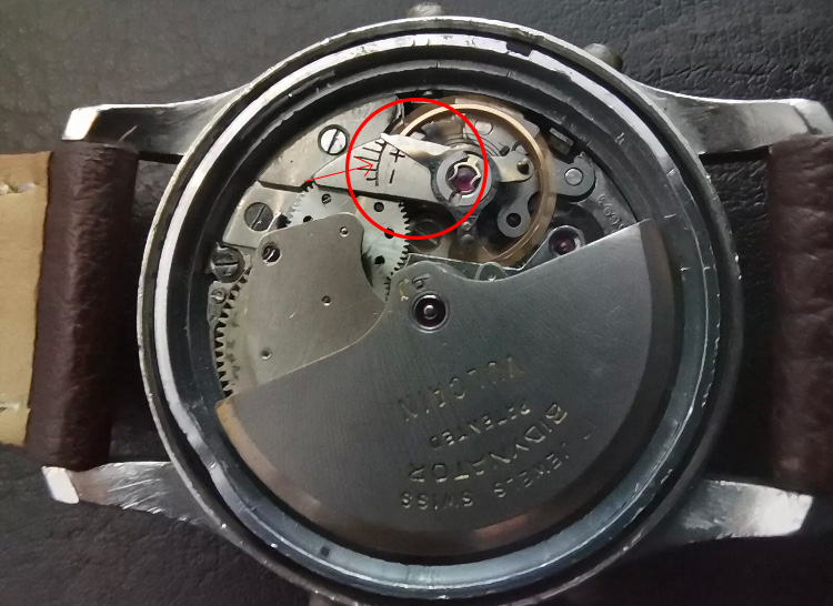

I see📖 Could you educate the newbie here and tell how the regulators position looks off/tells that the watch need service?
439
938
Usually you want it sitting in the middle (where the arrow is pointing).
Adjusting the regulator basically means you are making the movement run slightly faster or slower, by making a small change in the effective length of the balance hairspring.
A properly serviced watch should not need adjustments.
77
33
Okay well, that makes sense😁
What does it mean and what causes it that it's pointing so much to the + here? Or vice versa to the - ?
439
938
I'm no expert, let's wait for @Archer to chime in but my guess would be to compensate for a watch being too fast or too slow without having to service it.
Or if you want the watch to be as accurate as possible with a faulty original part?
