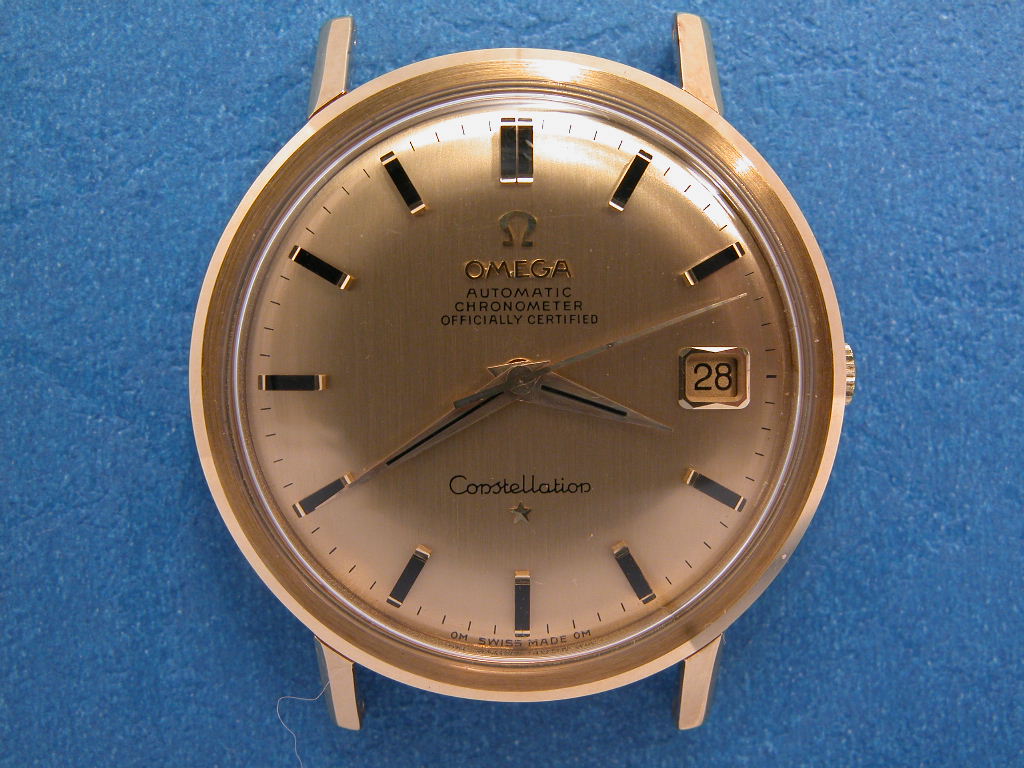

Another example in 18K gold.
stunning
is it .004 or .010?
do you know what serial/year this is ?
not seen an OM dial on either reference (they generally came in later)
324
639
Thank you and your remarks on OM dial.
No sure of the ref. It is an England case. From the markers, I would say it is a later ref. 168.010 of 63.
Any other insight ?
6,832
10,502
Any other insight ?

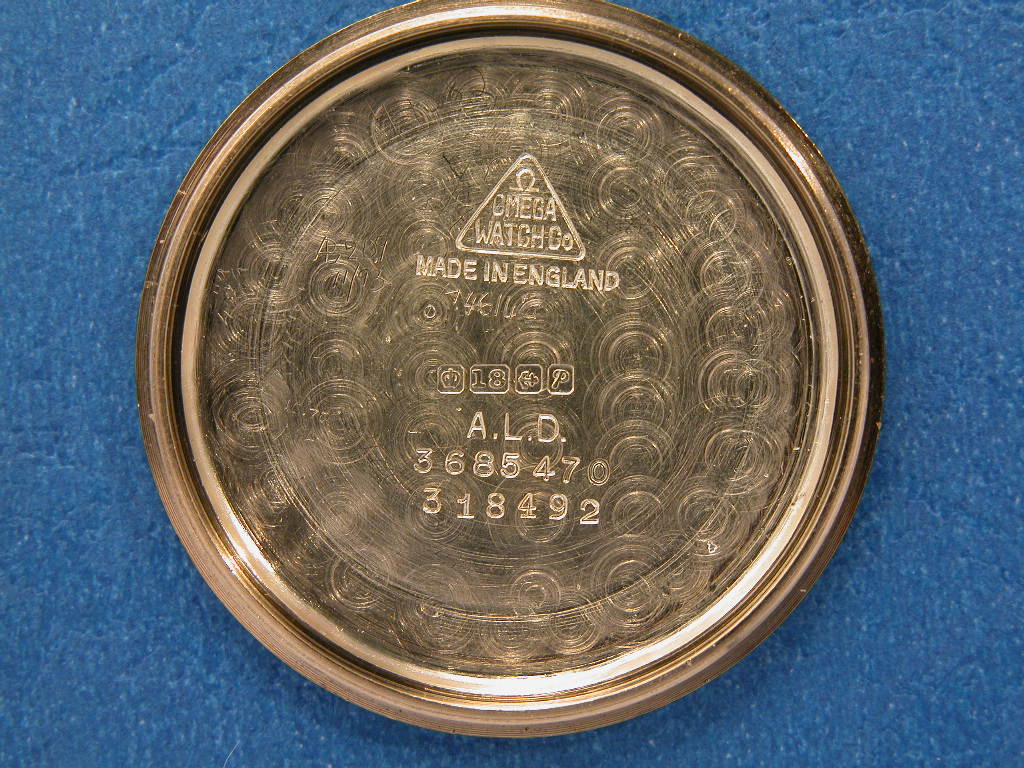

Ah!
I should have remembered this watch.
Not only for the remarkable case but also for the ‘vexing’ hallmark.
I’ve never quite understood why, if the .010 being a “replacement for the .004”, Omega give both the same first year of production date. (1962)
however, there are are relatively few 561 .010s, the majority being 564s, whilst it is the other way round for .004s
so I think it reasonable to suggest one followed the other.
Being an English case, it’s difficult to know whether it’s a ‘facsimile’ of an .004 or .010.
I suppose if it has a 19mm lug spacing it would be the latter, if 18mm the former.
do you have the movt cal and serial number?
324
639
You are probably right.
I do know the lug size cuz I do not have the watch with me. It is now at the bank vault.
It is cal 564 and serial no. 26,972k.
Thanks for your insights.
6,832
10,502
This starts to make a lot more sense. (Or at least some sense)
A 26,97xxx serial, cal 564 would place the date around ‘68/‘69, which is much more in keeping with the OM signed dial.
Now, watches were frequently sold years after their production date but if the case was made ‘64/‘65, it’s just a question of why it was kept hanging around for three or four years waiting for a movt.
So, either the movt (and dial) were replaced but given the condition of the case, I can only think it’s to do with it being a locally cased watch being assembled long after the case was made.
