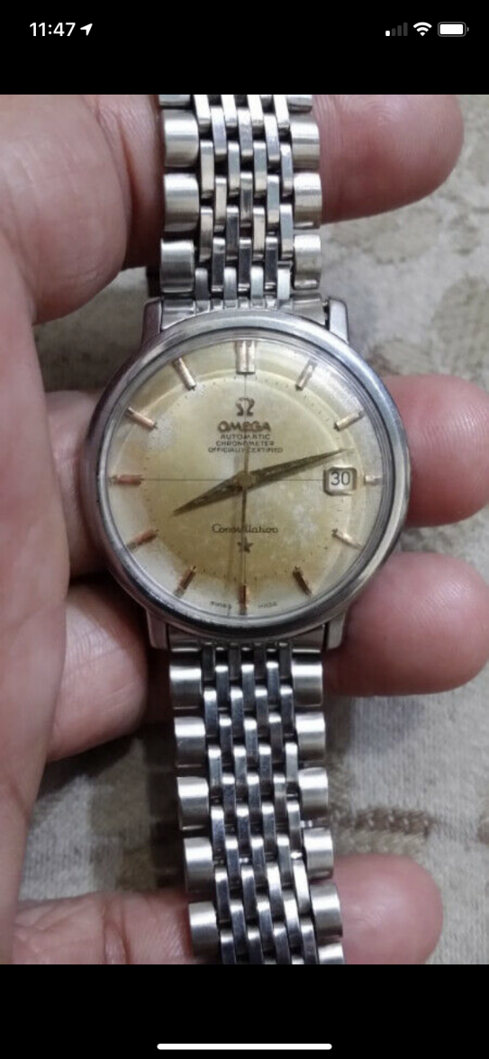

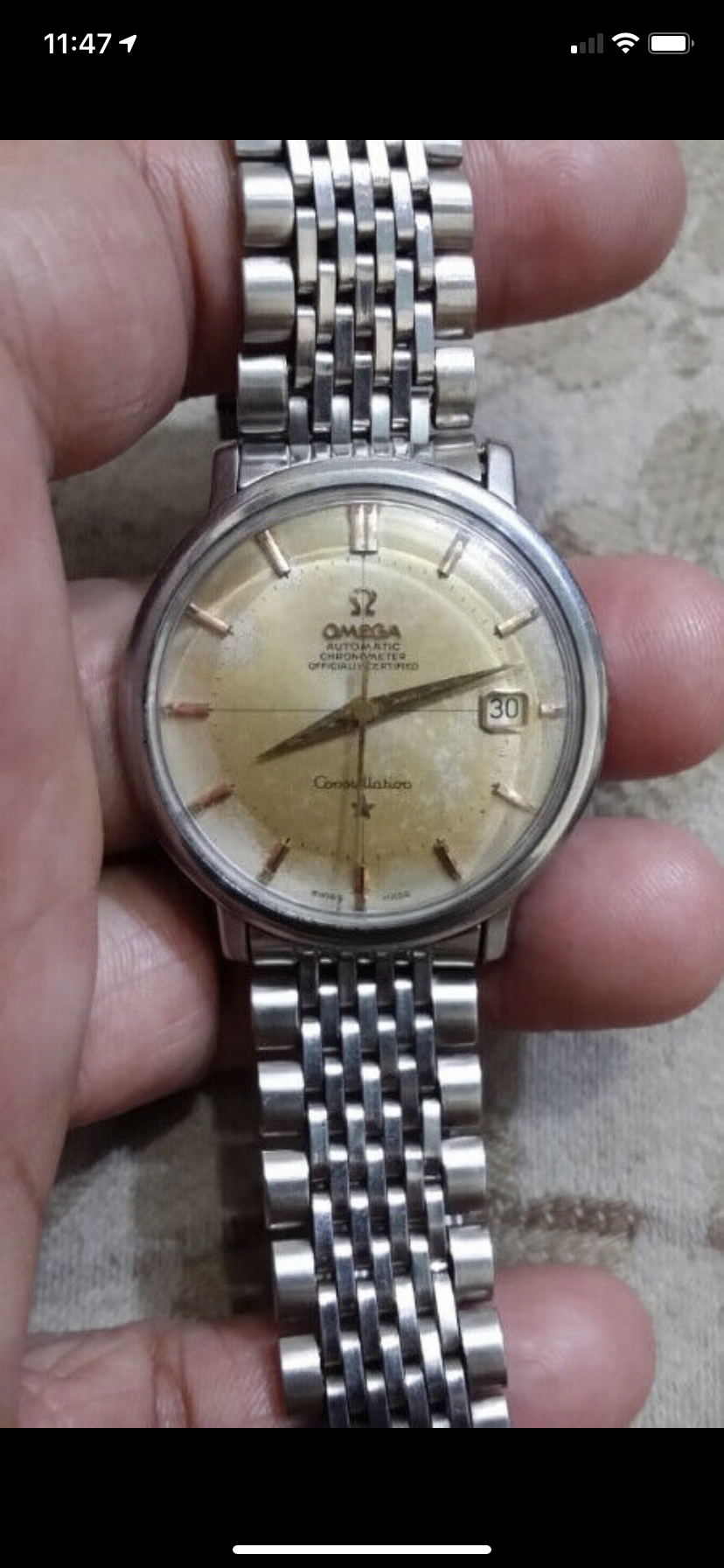

I recently came across this Constellation that is local to me, and priced at $1000, CAD.
Cal 561
Pie pan ?
Jumbo ?
hidden crown ?
Seemed unique to me, but looks a bit rough.

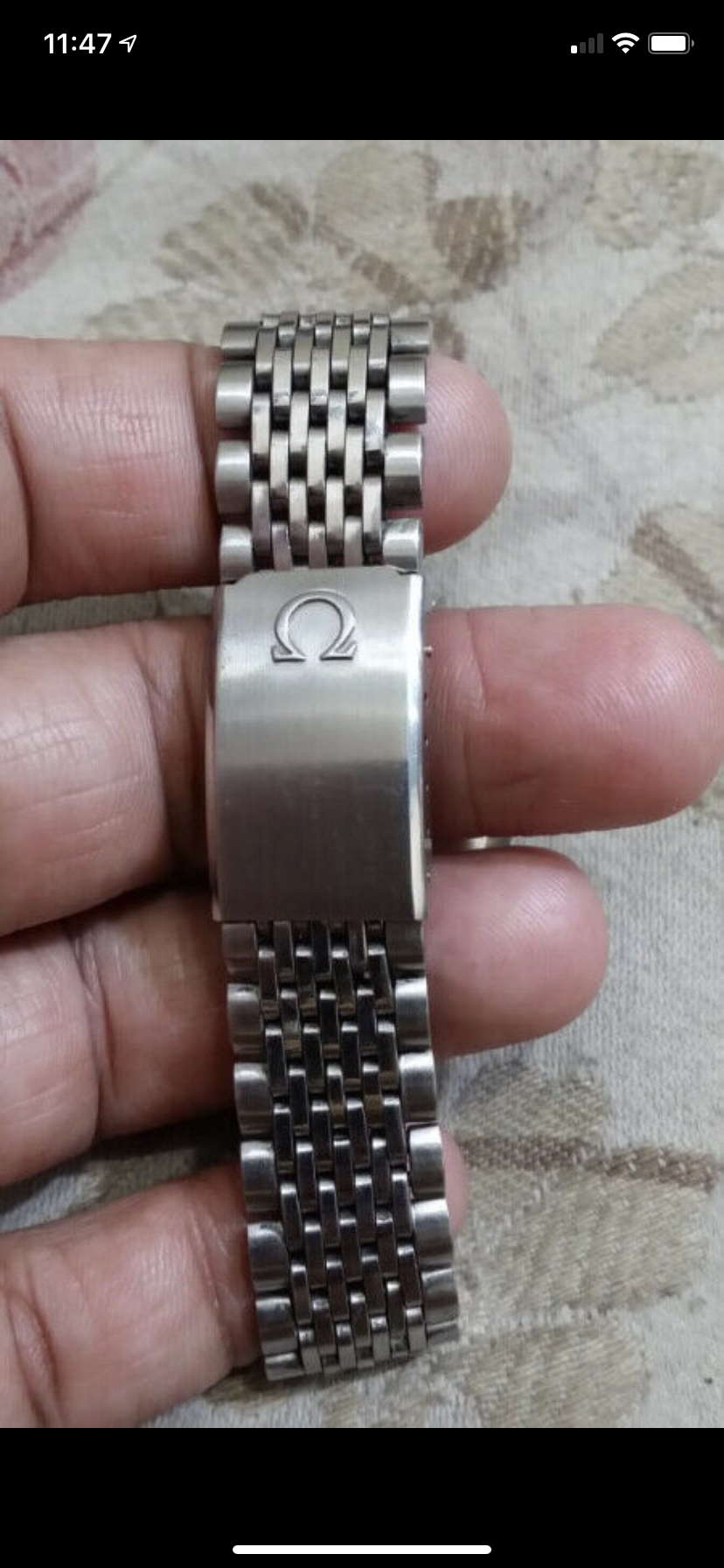

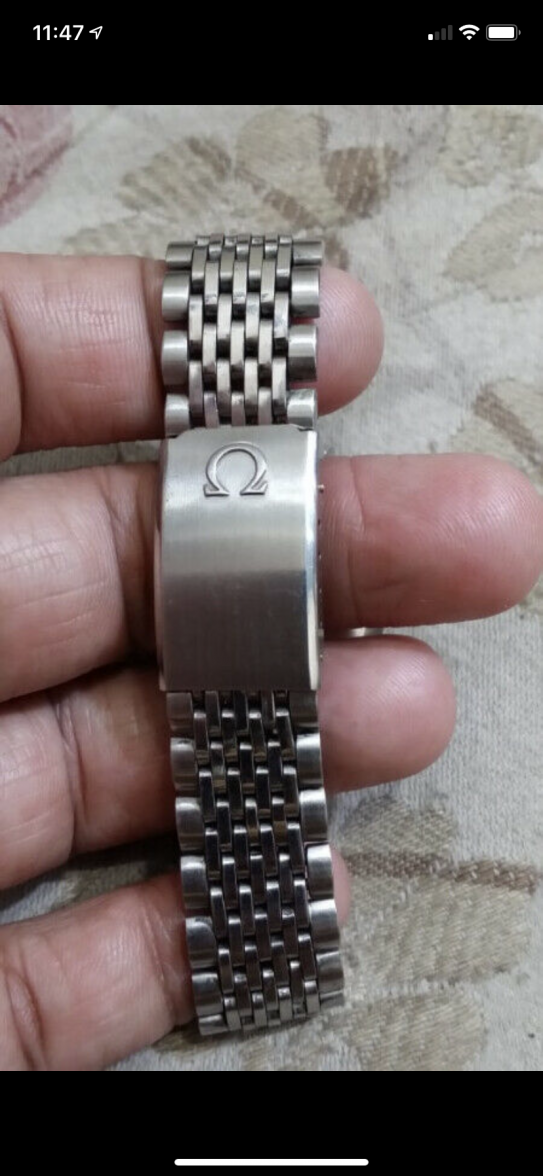

He says its the original BOR bracelet ...
no service history and i am waiting for him to get me the reference number..
Does the clasp look like it doesn't belong to the watch ?
Thoughts ?

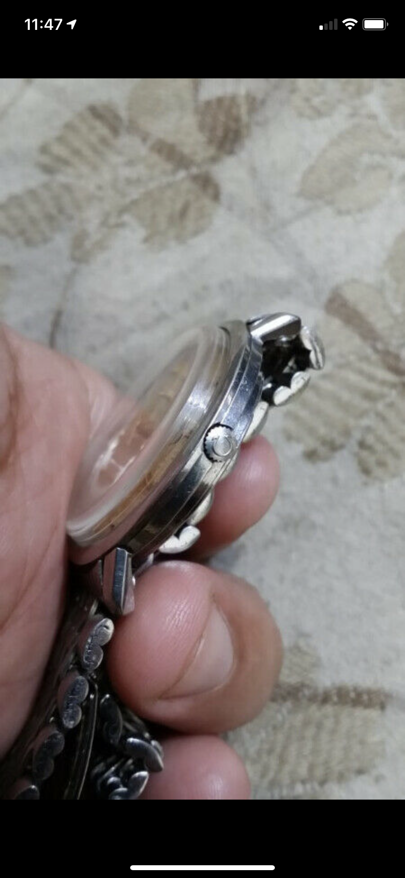

is it polished ?
Anything stick out ?
im considering grabbing it.
I don't understand?
It is either a ref. 168.010 or a 168.004. The bracelet is incorrect.

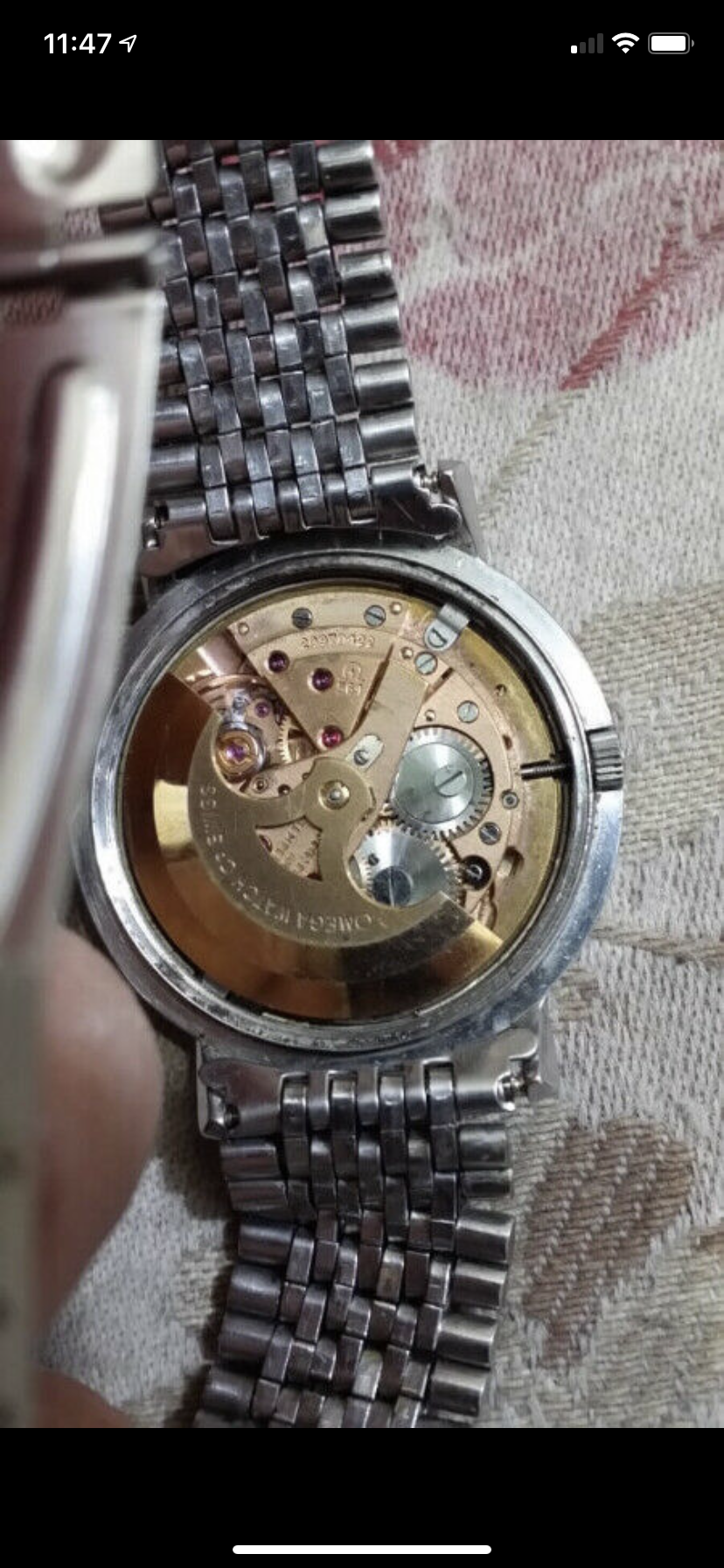

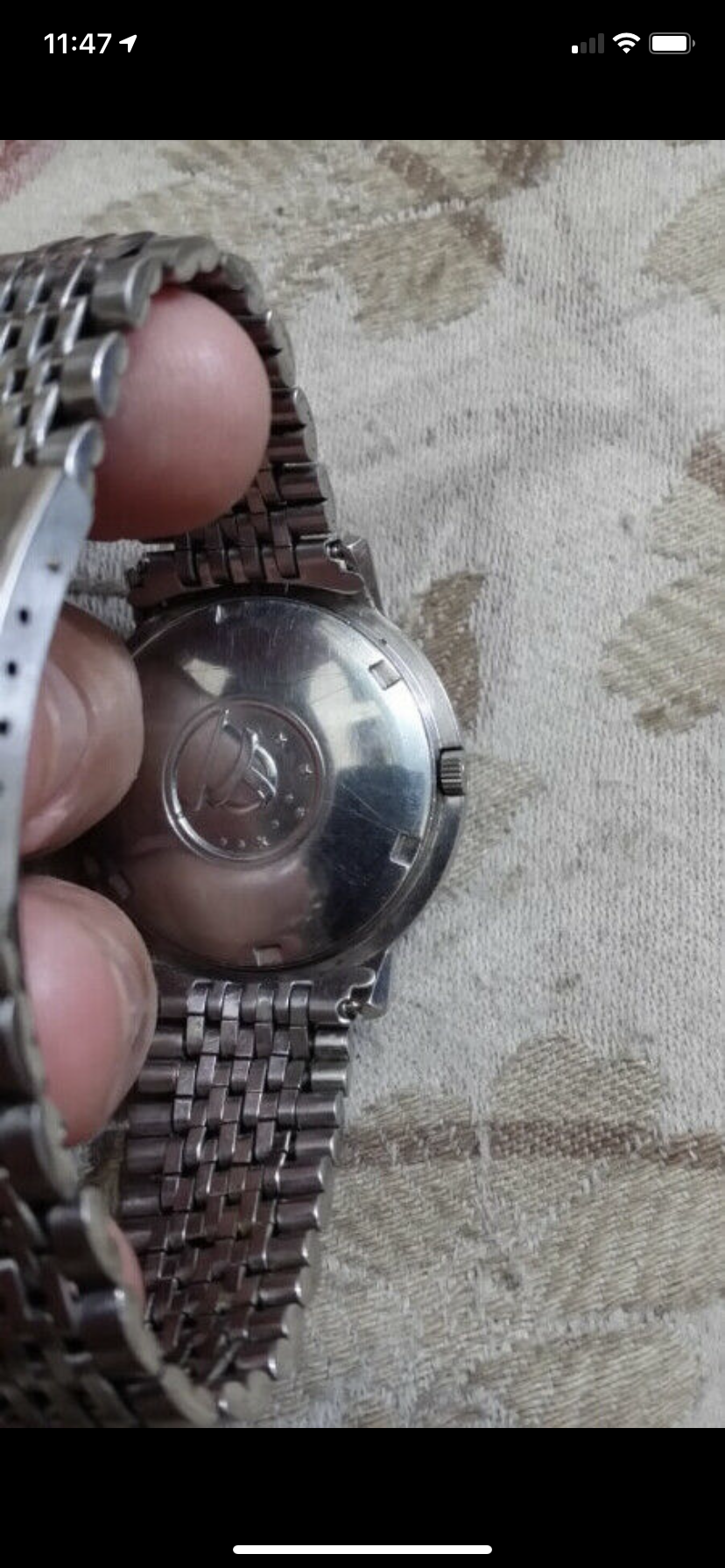

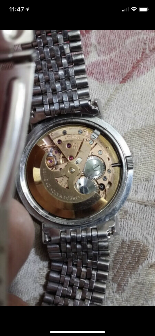

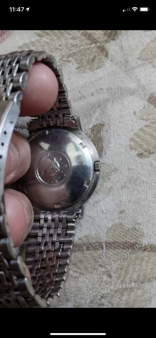

I just saw the case back,
its a 168.004,
I just thought the hidden crown was interesting and looked unique to me, so i was curious what the experts of OF thought.
Does it look rough for the price .. etc.
i thought the bracelet looked incorrect

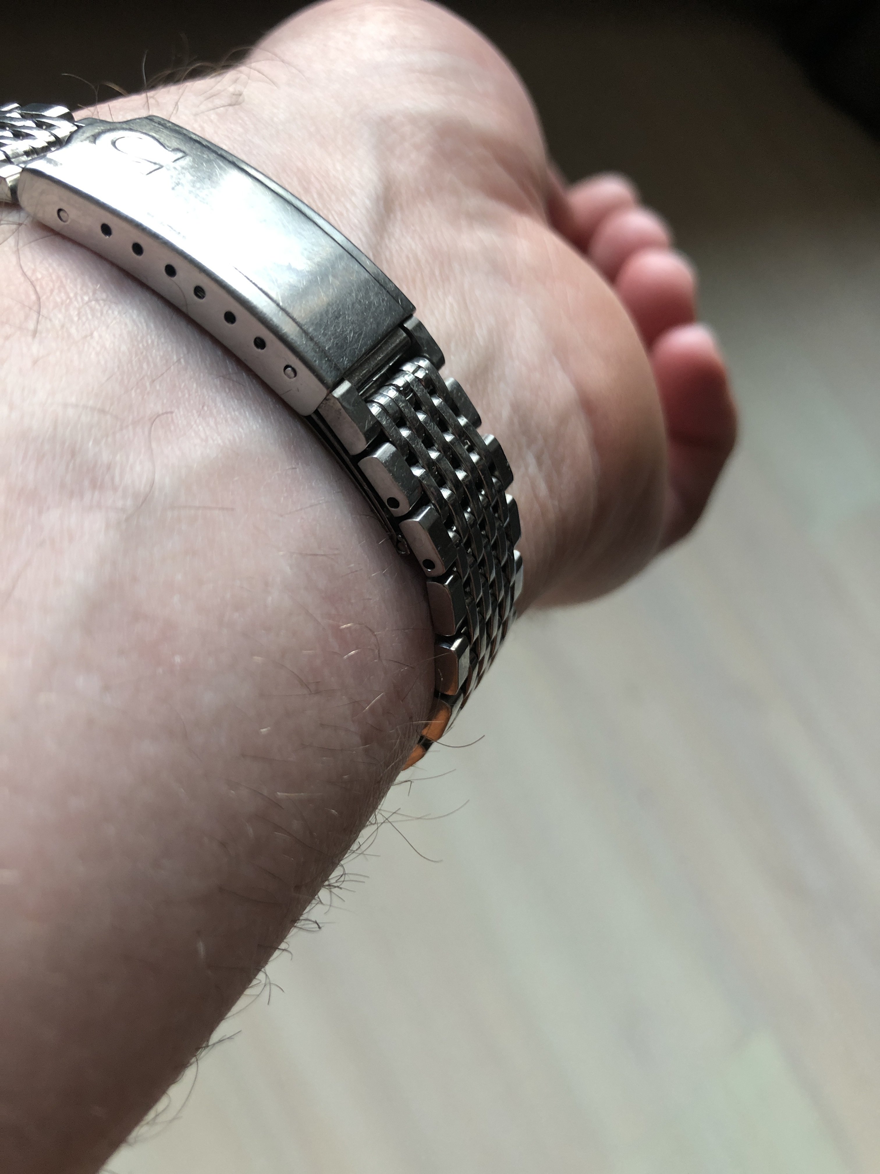

The end links have no number in it and the side links of the bracelet are folded... I am pretty sure the bracelet is fake.

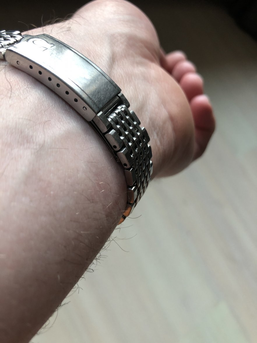

The sidelinks must look like this

And with $ 1000... run...

The 168.004 got nice wristpresence. But it's a common model. You will find a much better one with patience. And probably for the same money.

The dial is the most important thing, and this one is very bad. No need to even look further.
