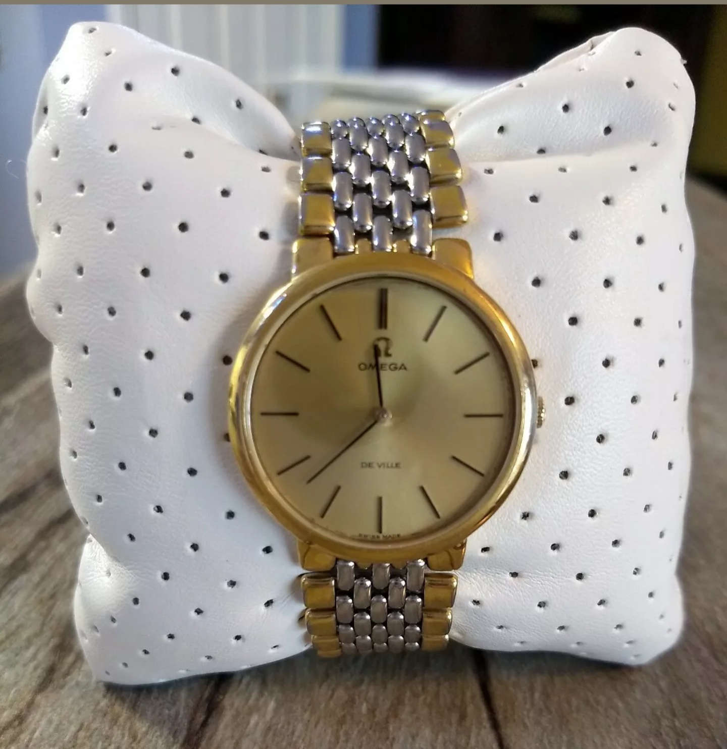

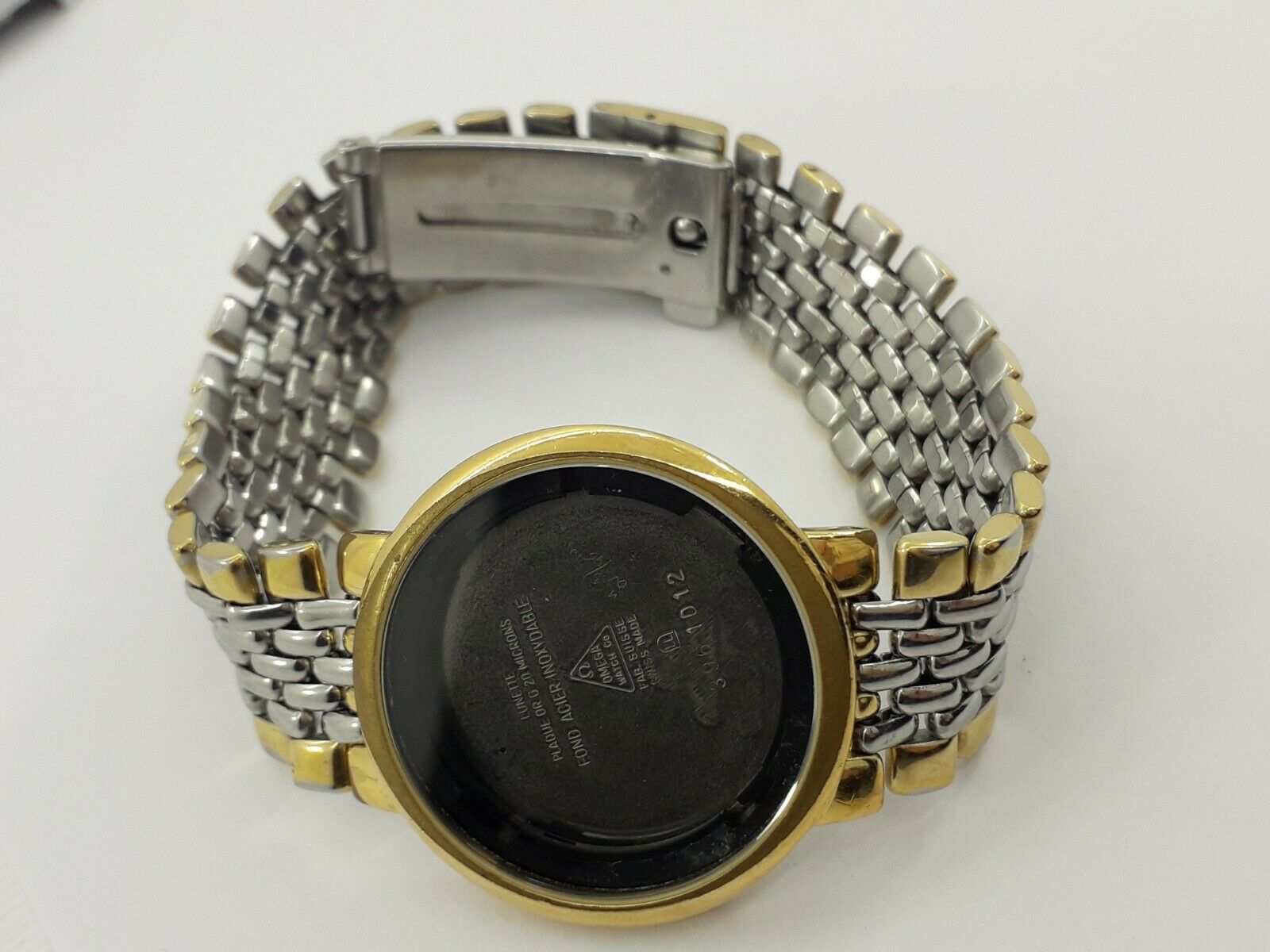

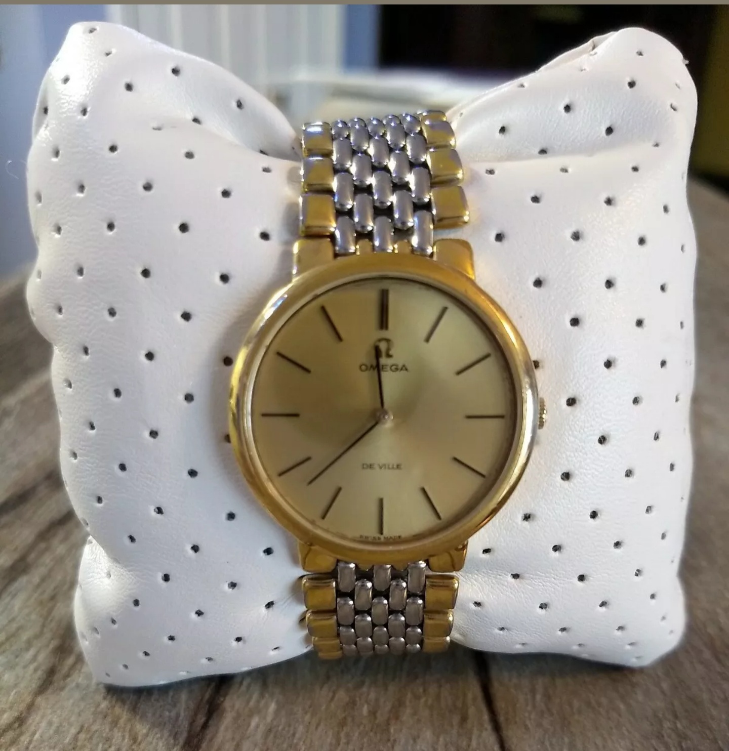

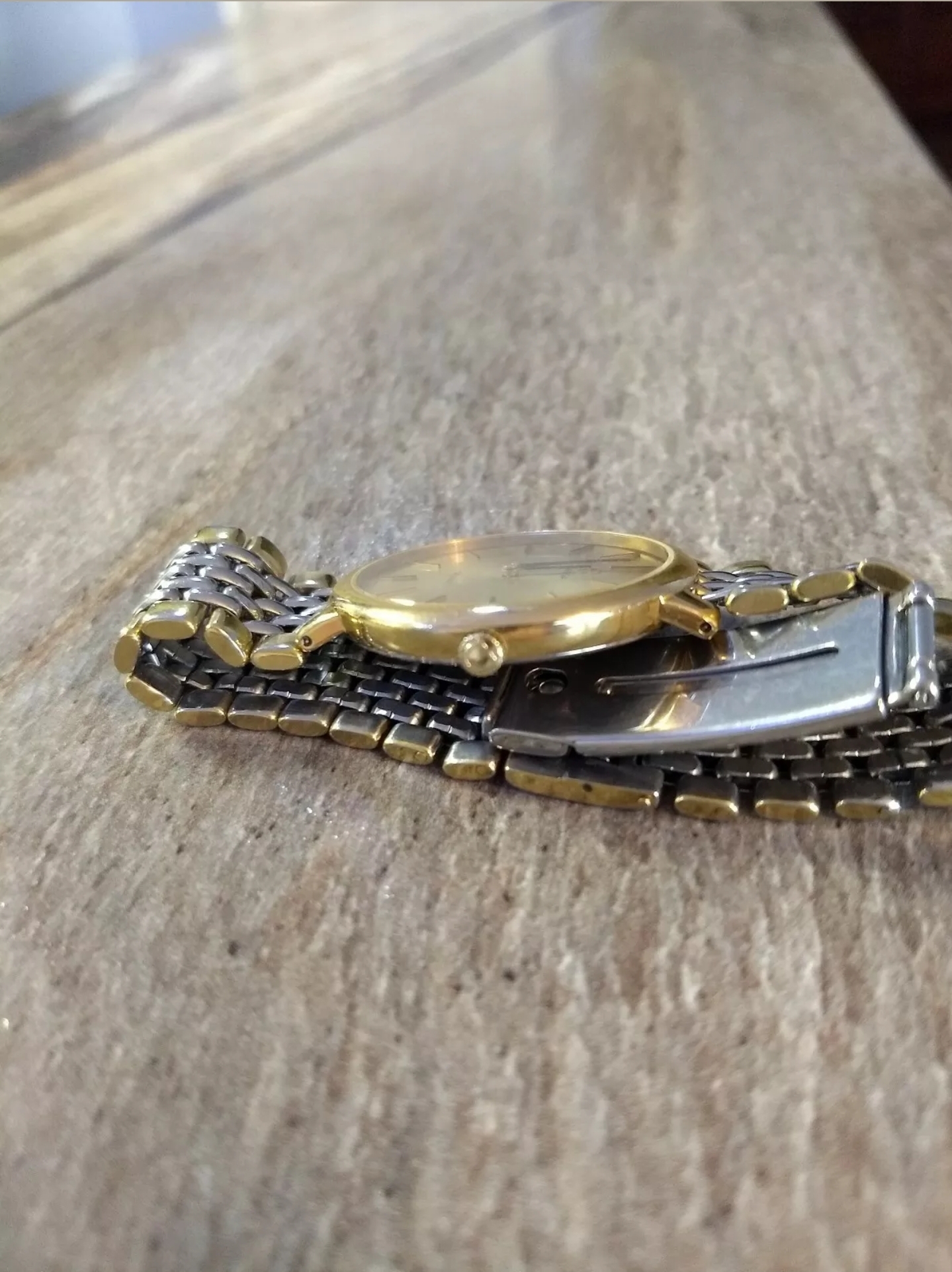

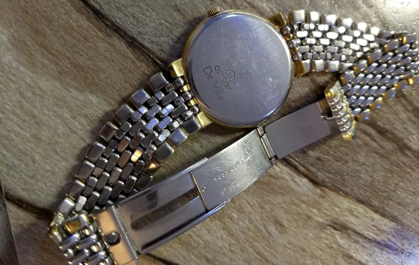

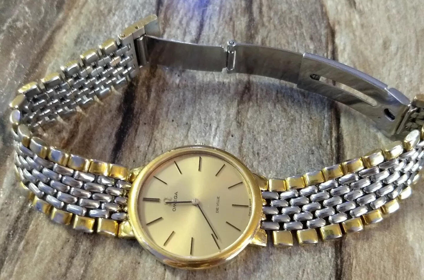

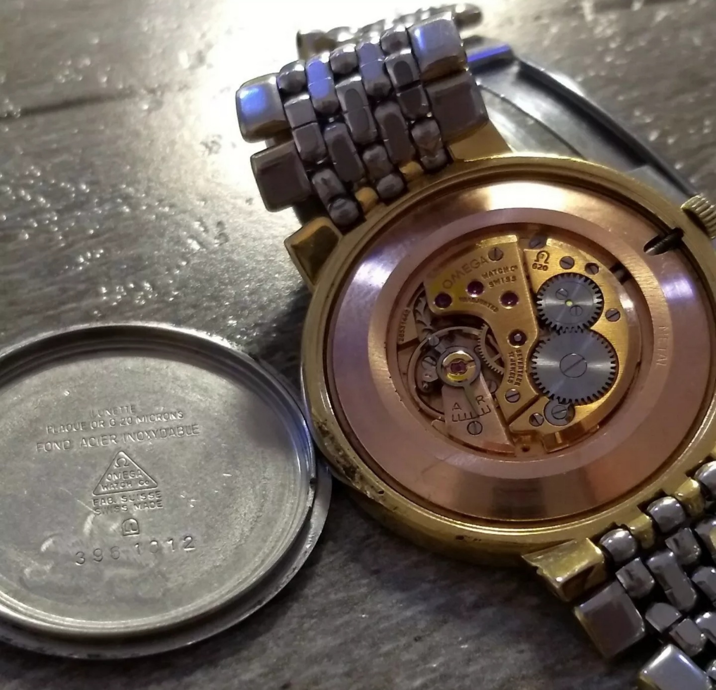

Hi. Need help finding ref number for Vintage De Ville/ know if its real
40
20
Bought this watch recently. Was looking to find more info on it. Its a De Ville. I believe from the 70s. I don't believe the back casing is the original. Stainless steel.
3,595
13,551
I’m no expert on the De Villes, but your ref is from a watch that was released in 1987 with a cal 1430 quartz movement. The cal. 620 in your watch in from the 60s, though, if I’m not mistaken. So I’m afraid it’s certainly a Franken in some way, even if it’s just the case back - that being said, if it’s only that then there are definitely worse Frankens out there.
3,595
13,551
Another thought: I know it’s definitely not a 396.1012 since 9=electronic and 6=water resistant calendar and the watch you have is certainly neither of the two, but a part of me could sympathize with the idea of someone putting a genuine mechanic movement in a quartz watch. 😉
521
789

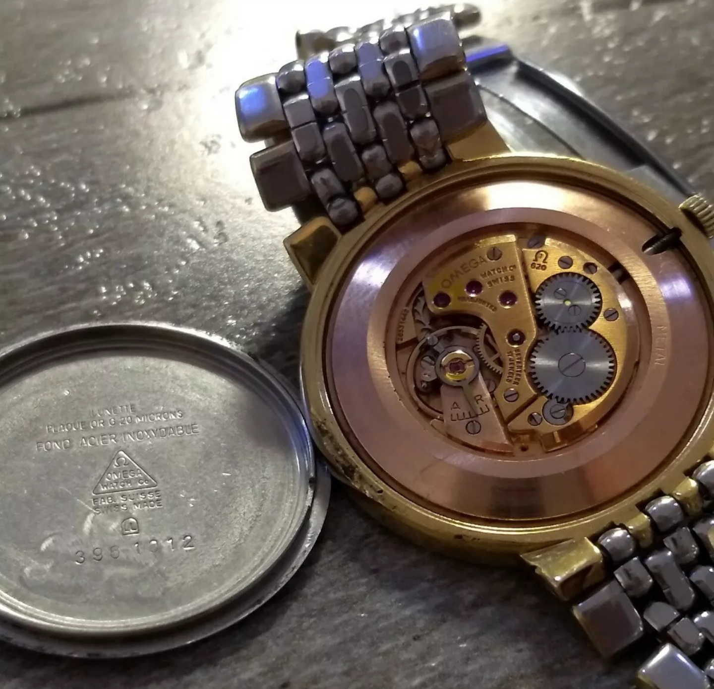

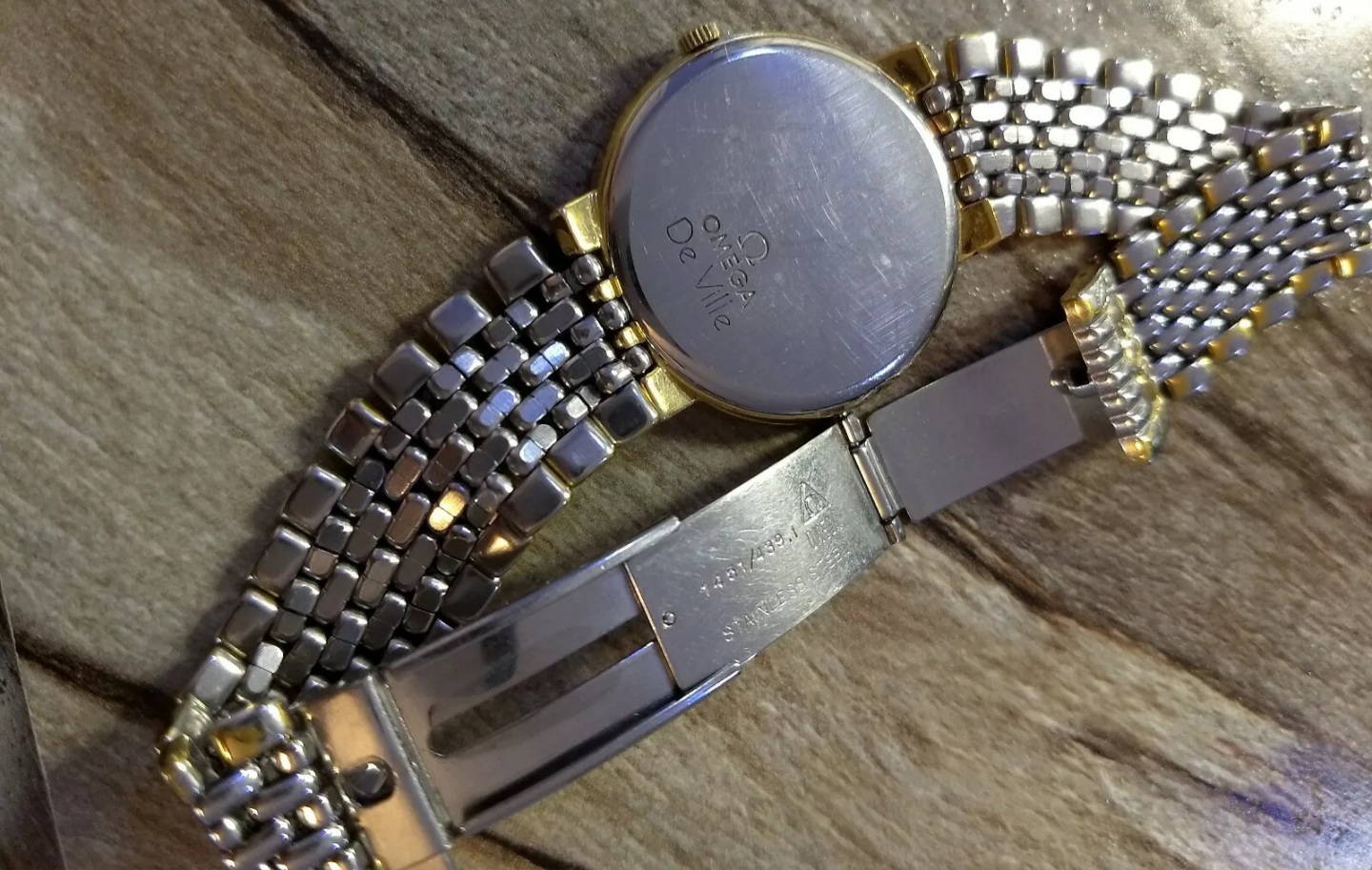

Ref appears stamped inside the caseback at the bottom, 396-1012, and here it is on the Omega website: https://www.omegawatches.com/watch-omega-de-ville-omega-dl-396-1012
What's unusual is that I can only find reference to the quartz movement for this model as shown in this link, tho it has a different caseback but marked with the same reference #.
https://www.catawiki.com/l/35873555-omega-de-ville-cal-1430-396-1012-men-1980-1989
I have seen the caseback that's on yours on steel and other steel and gold variations, so maybe (this is a guess) somebody put this one together after the quartz bit failed? Maybe somebody can tell you if this ever came with both movement types.
Here's info on that tiny movement as well: https://watchguy.co.uk/repair-service-omega-calibre-620/
The retaining ring coating matches the movement on your watch. I hope this gets you started, but we need someone more informed than I to clear this up.

Thanks for the reply. I dont know yet how I feel about the watch knowing that its not fully original. I did buy it because it was not a quartz so theirs a weird duality regarding the matter.

Well, that is not something you see every day. Interesting first post for sure.
1,441
3,809
396.1012 is an 80s quartz watch usually with a date so the dial and movement are wrong. Caseback and bracelet may match. I hope it was very cheap
18,835
39,173
Looks like someone had a left over 620 and dial from a gold melt victim, and found this and thought, "Hey! That'll fit!".
Not a bad transformation actually, but still a franken if not disclosed to the buyer.
