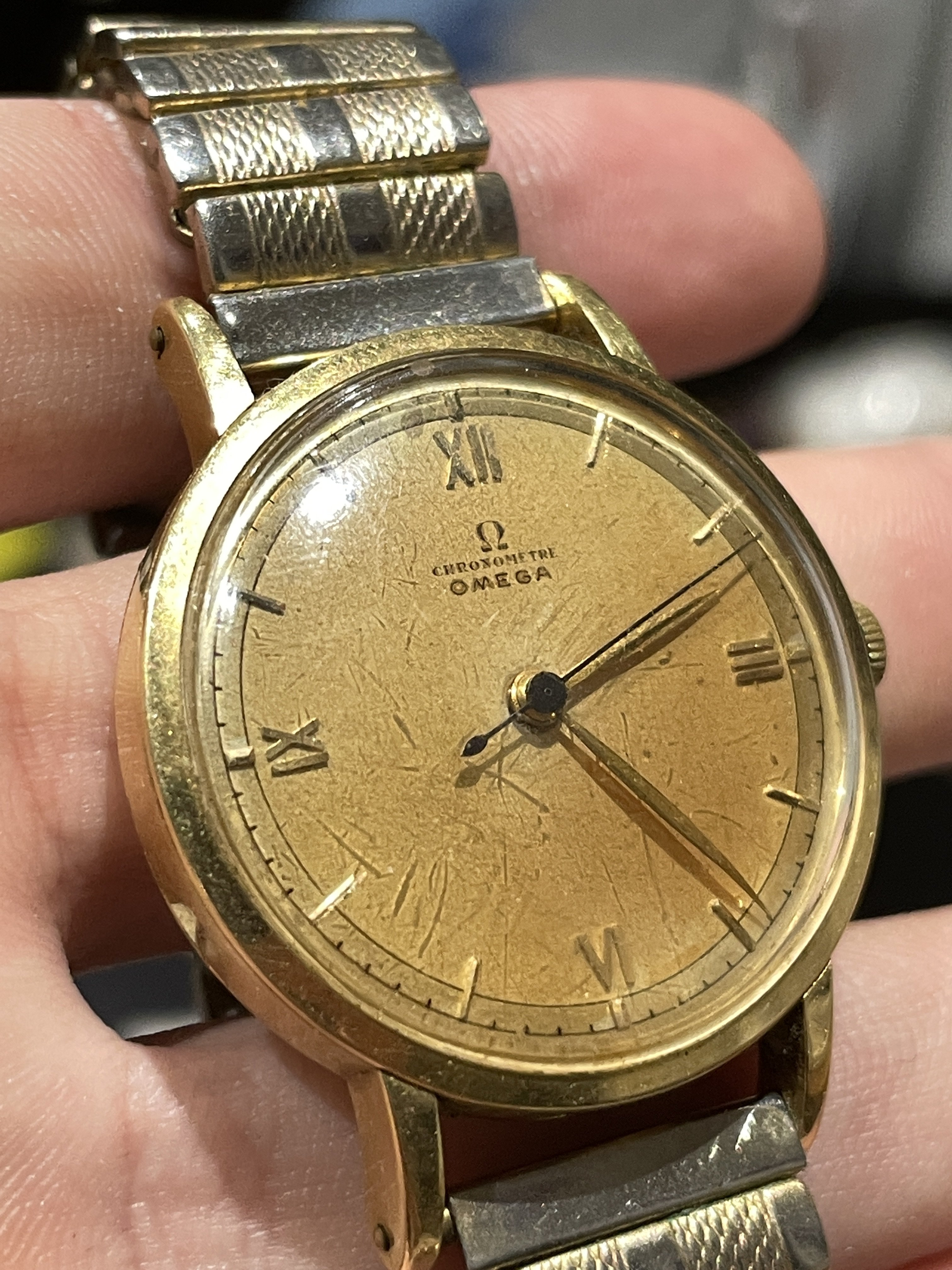

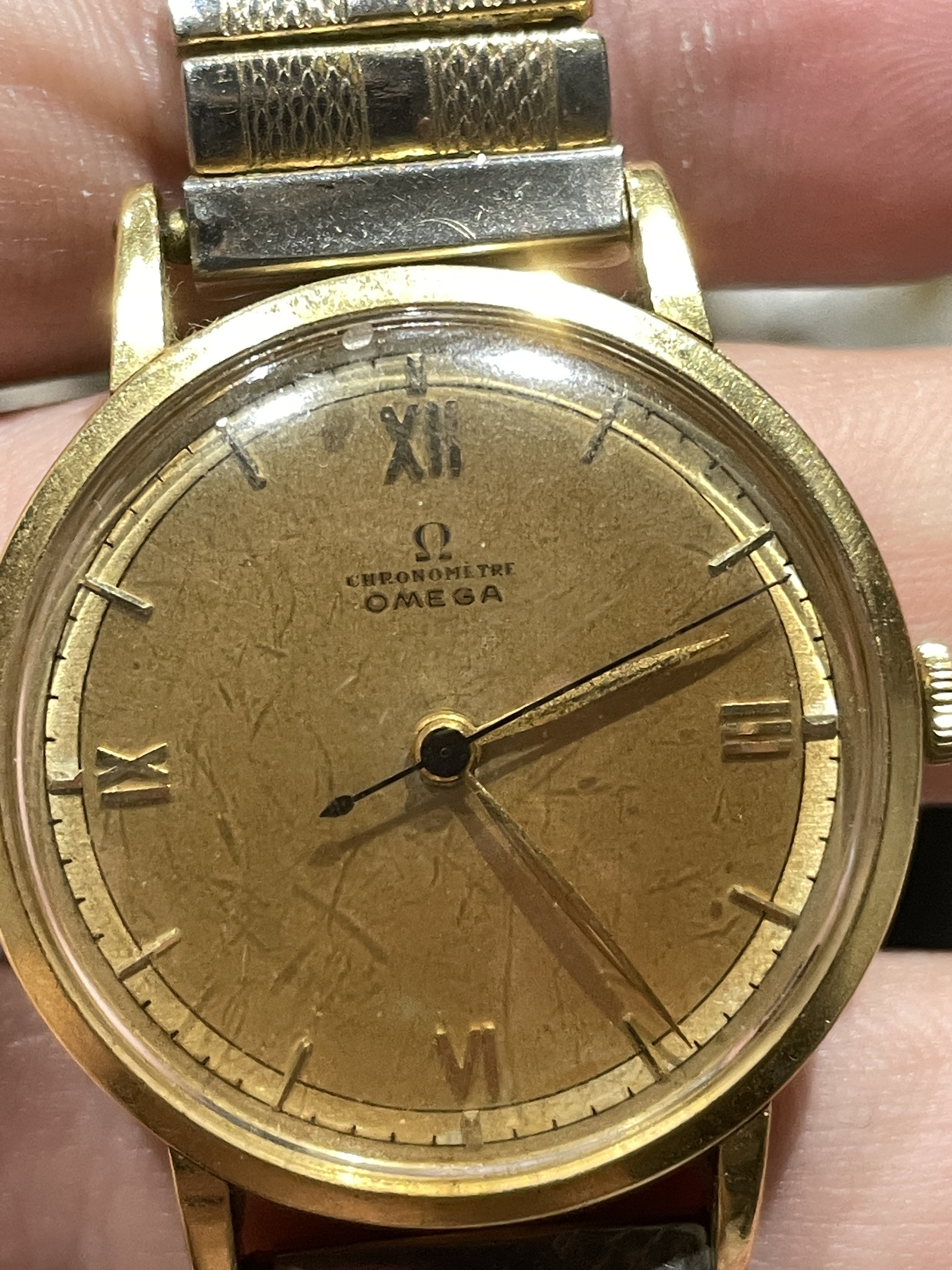

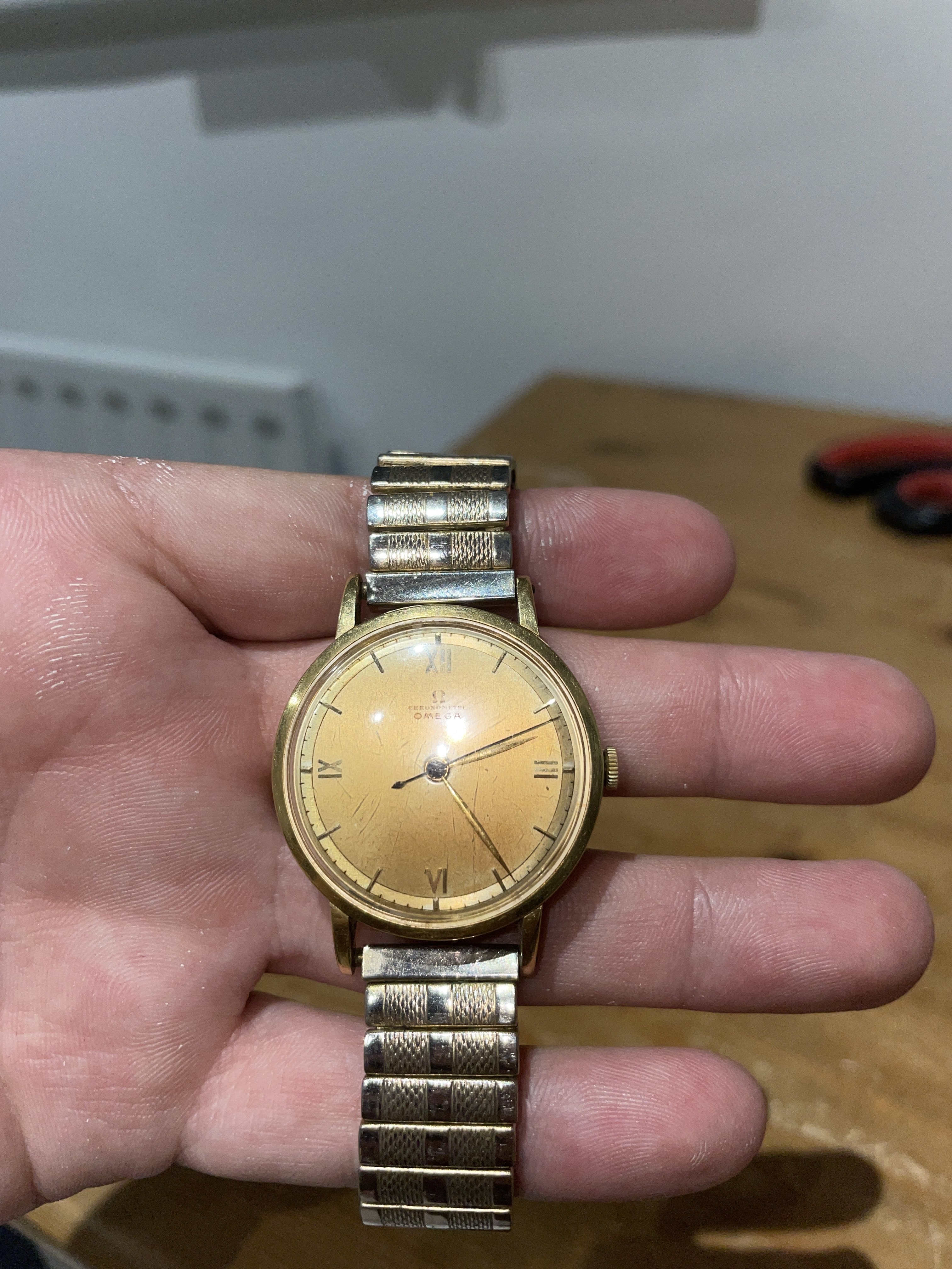

Hi guys im extremely new to watches and am looking for any information and help possible on this omega I recently received from my grandad who passed. I cannot find any similar omega chronometers that have this dial. Most I found have the “automatic” on the dial? I believe the bracelet is aftermarket topps from the 70’s, but really have no idea and would love some help! Thanks in advance, its my first time here!

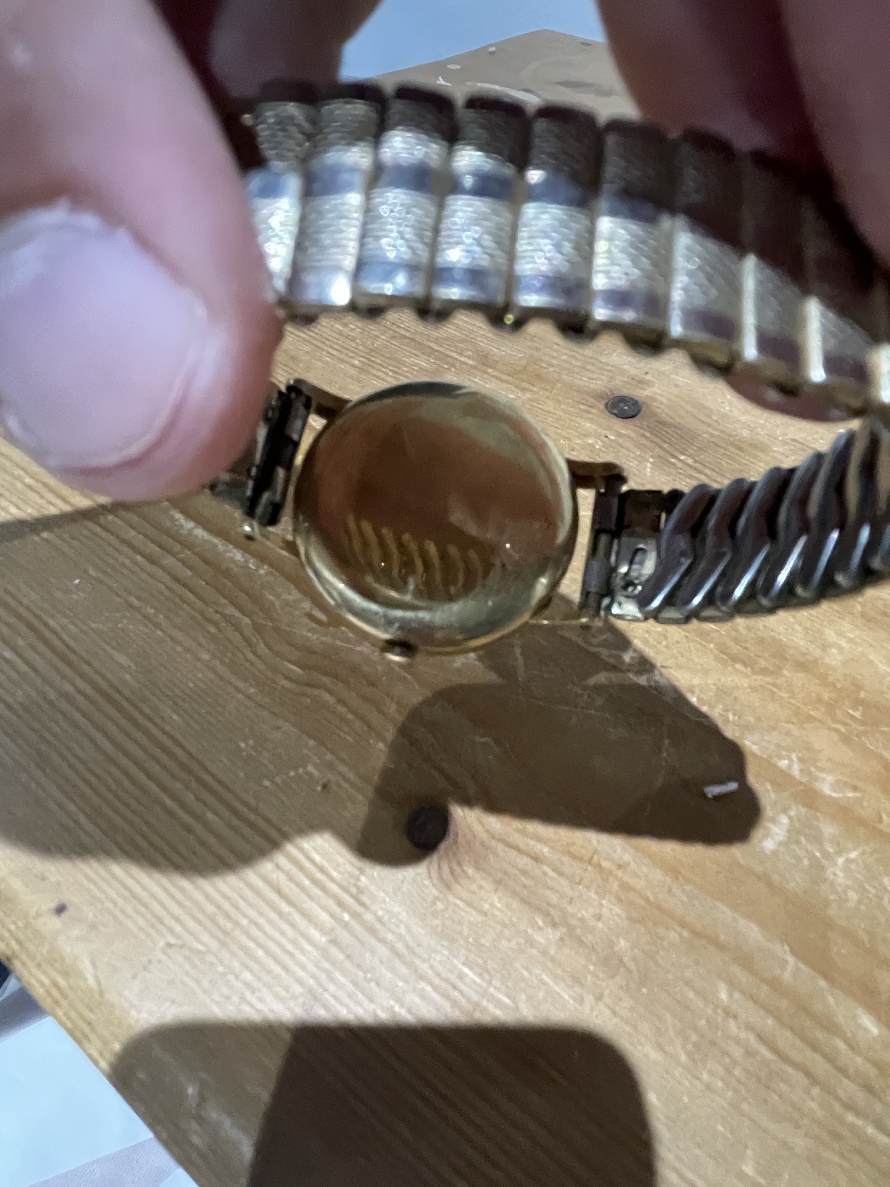

Everything to know is on the inside. Find a watchmaker to crack the case and let you take pictures. Don't be too concerned about the dial, there are numerous variations. Also, chronometers need not be automatic. It's the timekeeping, not the winding system, that determines whether it's a chronometer.
318
290

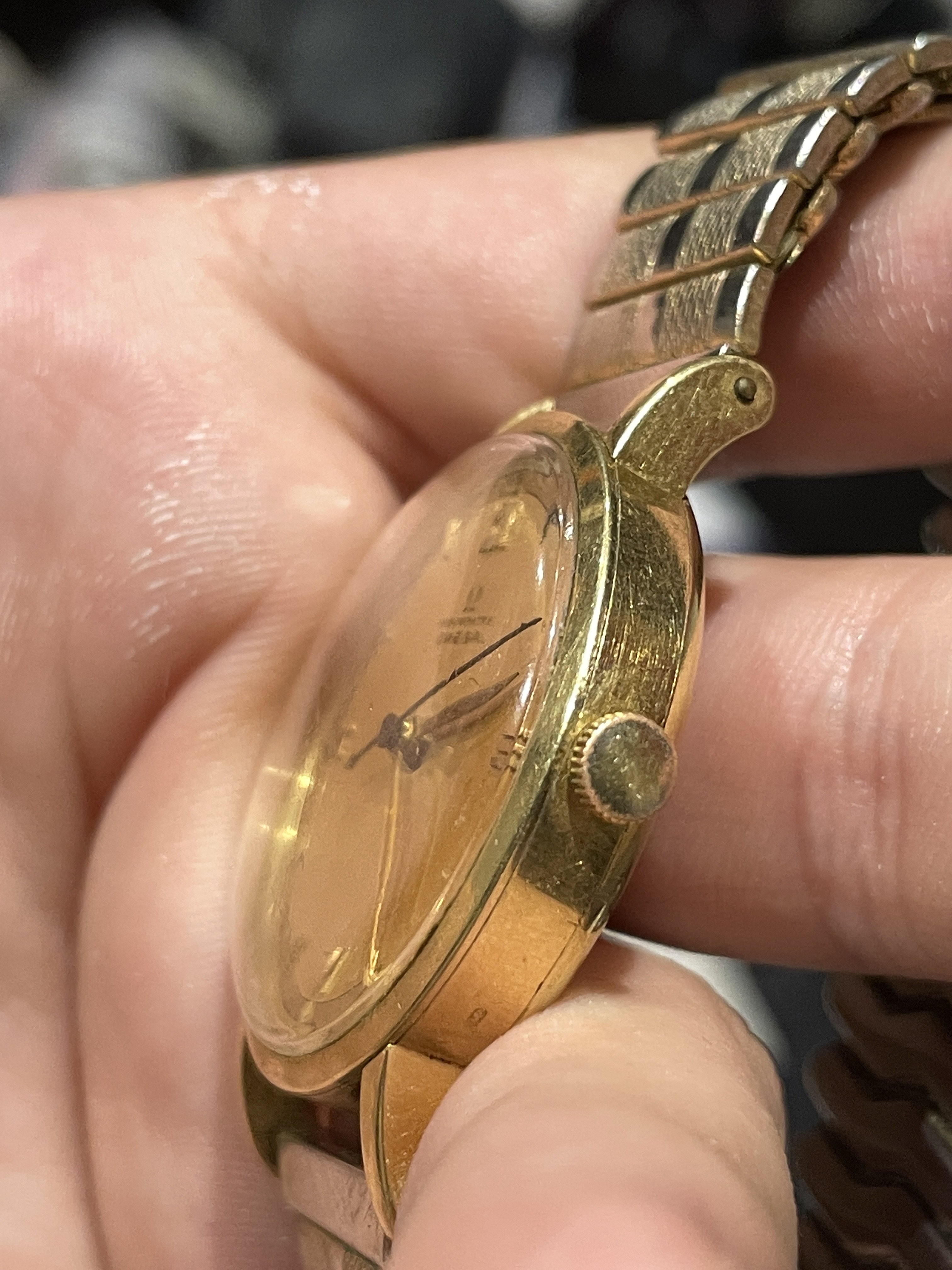

That’s an attractive watch and a great legacy. You should have it serviced if you plan to keep it, including polishing the crystal.

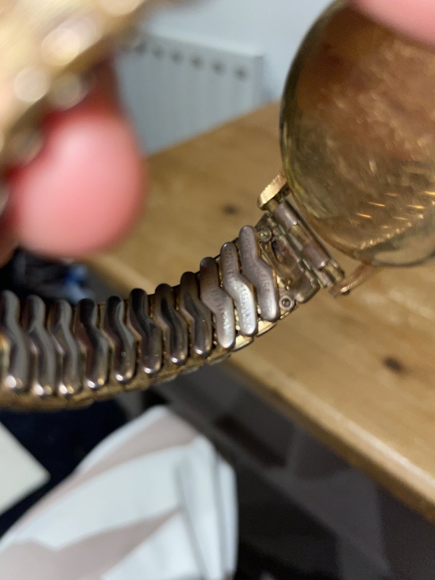

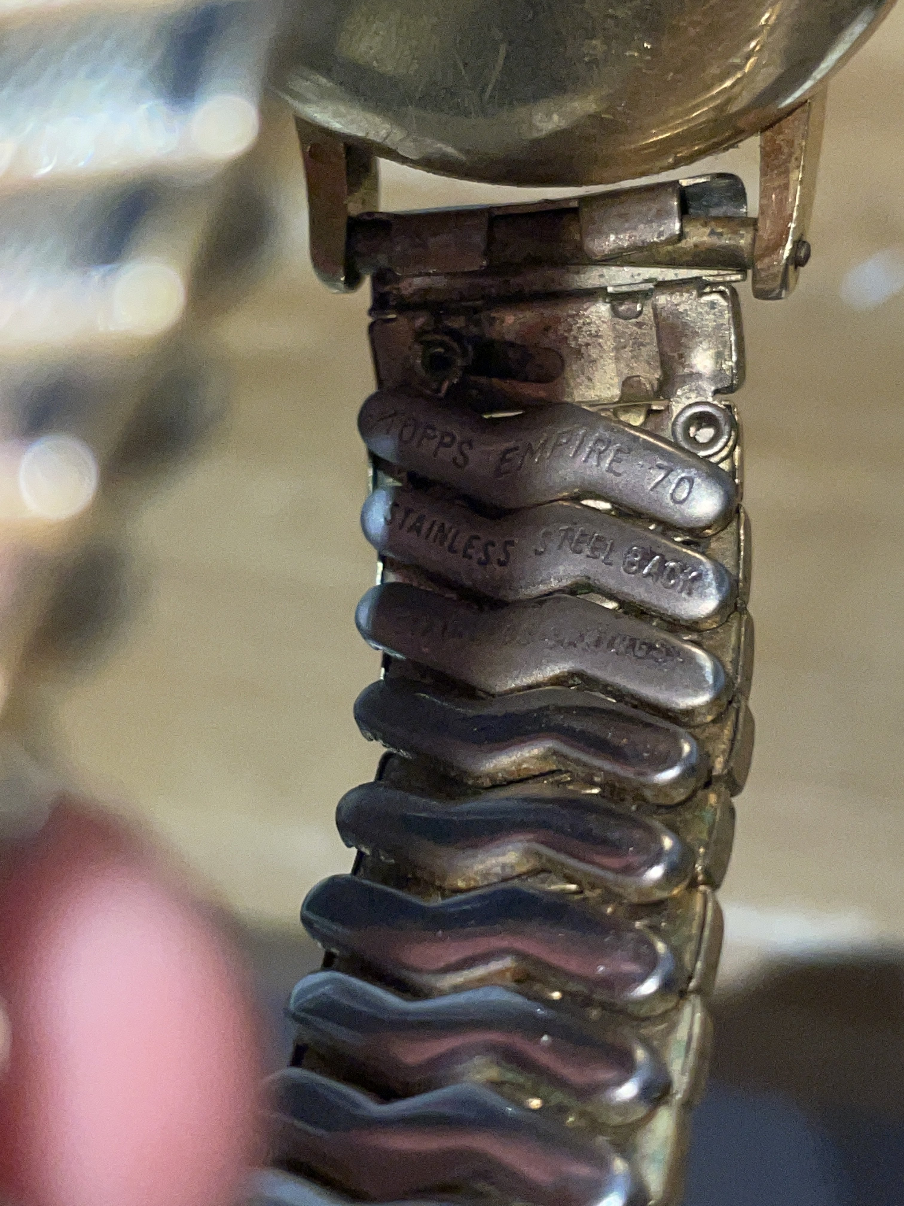

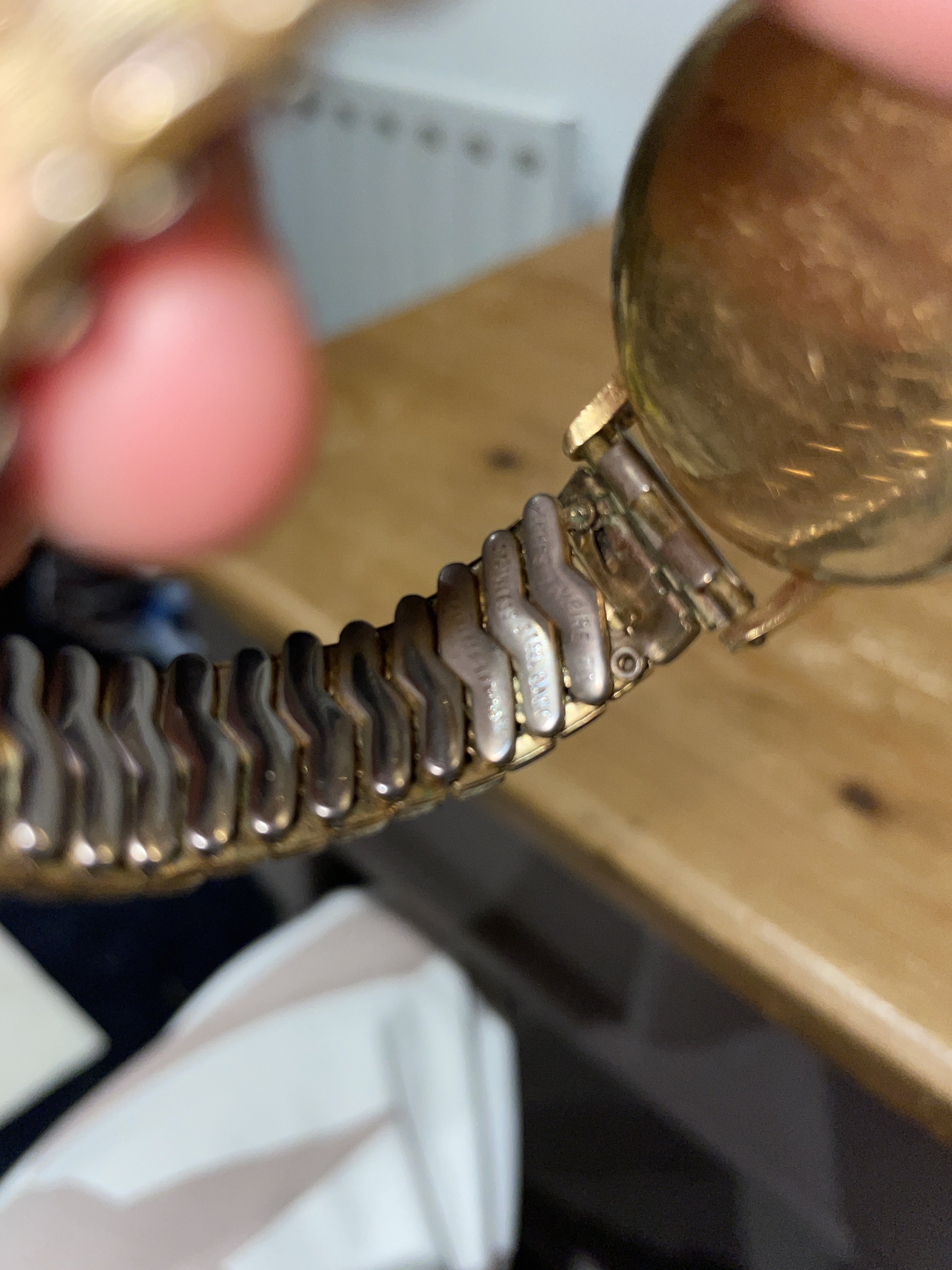

Please … throw away the bracelet and get a decent leather strap with the right sized spring bars. They shouldn’t stick outside of the case.
Let us know the serial number, movement calibre and model reference when you have it opened.

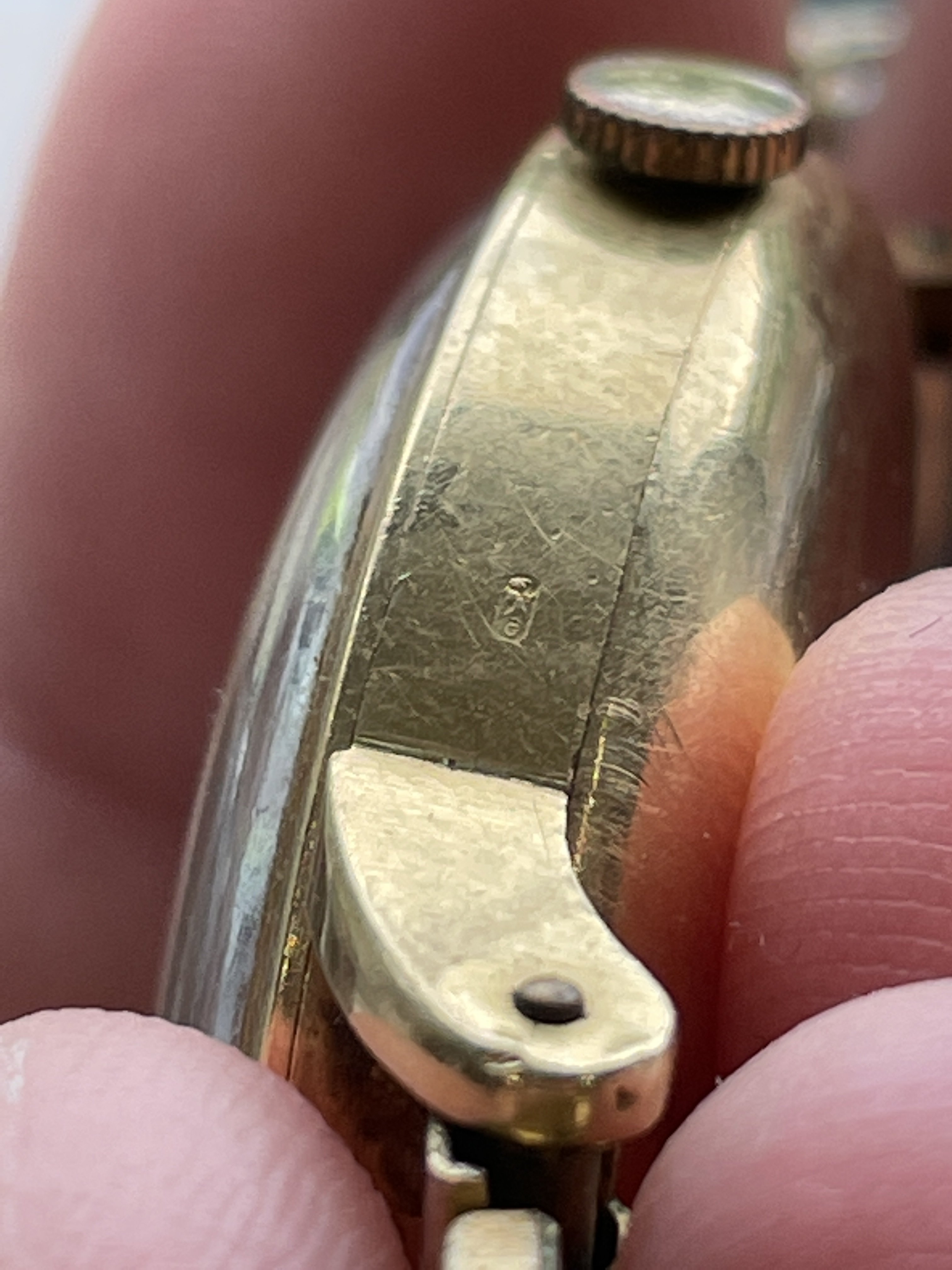

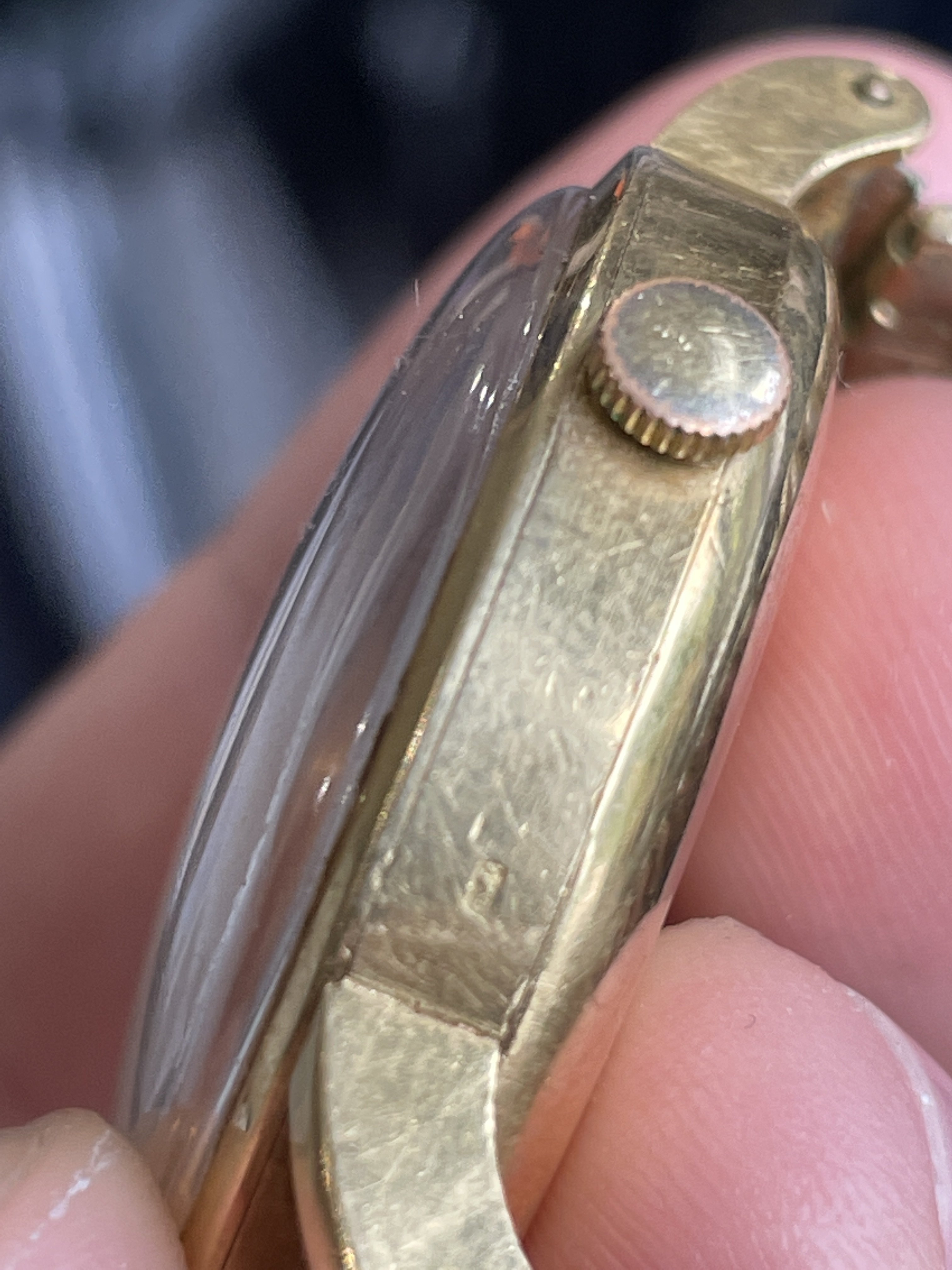

Have a look, if the underside of the lug at 5 o'clock has a stamp in the metal. If so, take a better picture there. Erich(macOmega) will tell you more. Nice example and handwinding calibre 30T2RG, if a Chronometer.....

Btw: the Person, who installed that Band with these Springbars should front a Firing Squad.....

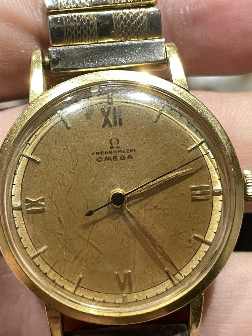

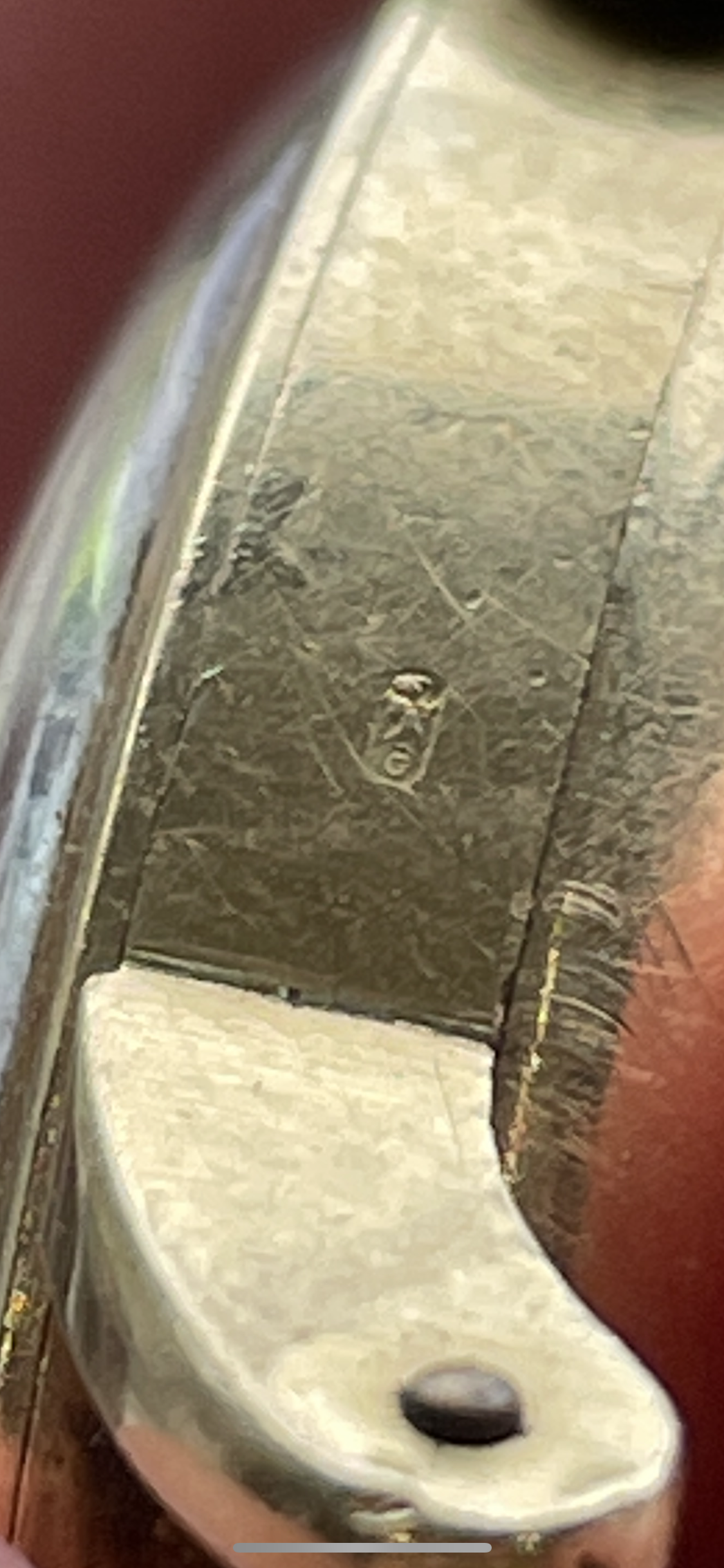

It looks like there's a stamp on one of the lugs and one on the side of the watch:
18 carat case 😀
18 carat case 😀
That's what I thought as well. But need a close up pics. to confirm.....

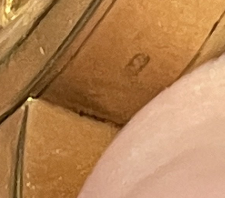

Hey thanks so much for the help so far guys! I myself didn’t notice the tiny mark, it looks to my eye just a dent but maybe not. I have attached 3 images, my camera will only focus so far, looks to me like a womans head and a letter g underneath?
18 carat case 😀
