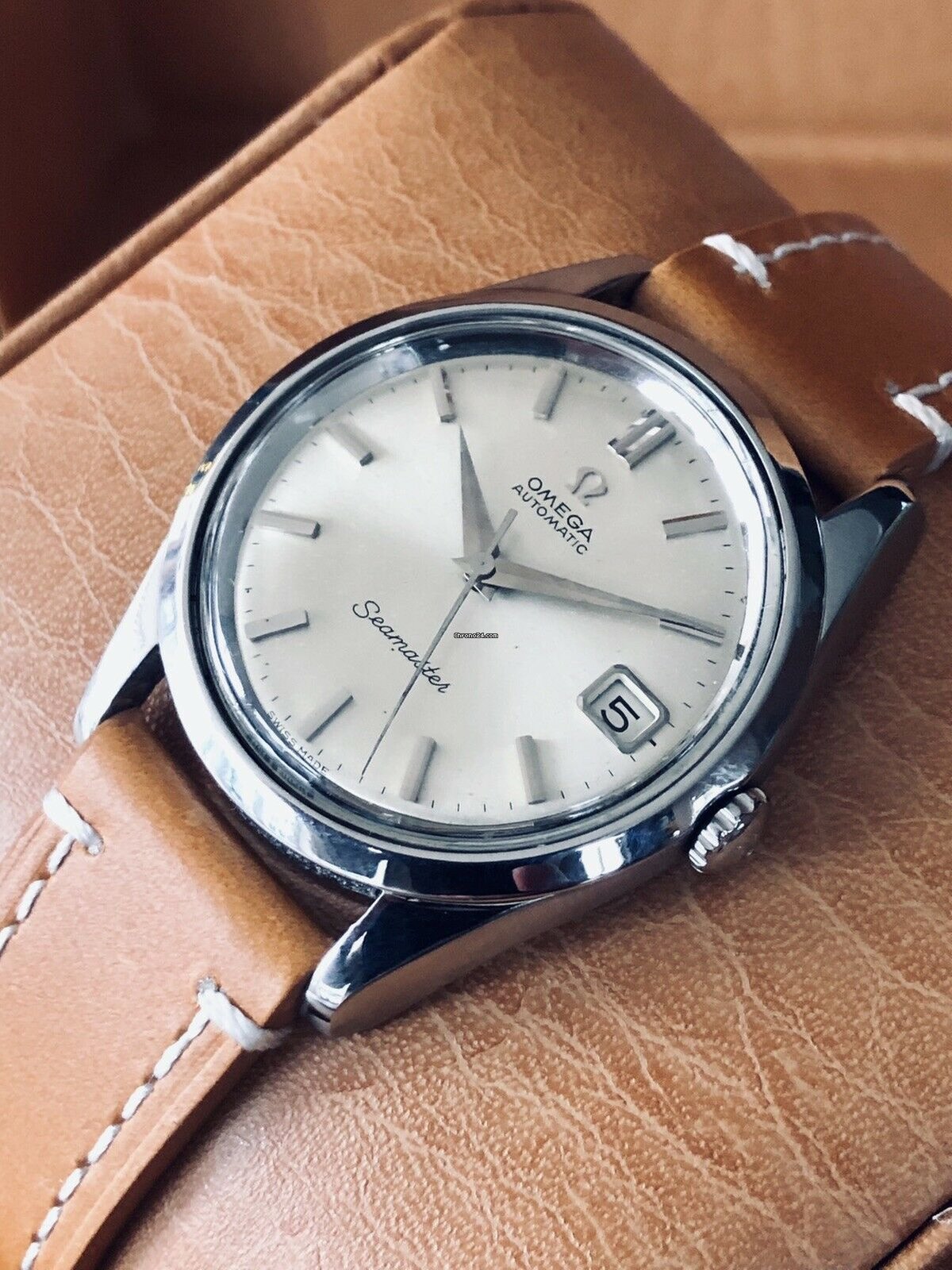

Hi, I am new to watch collecting but I have found that the vintage Omegas offer a lot of good value to the entry level collector. I have spent the fast few days on Chrono24 looking through a few watches and I found a 1963 Omega Seamaster Automatic, Calibre 562 with date. The asking price is $1,756 AUD ($1,200 USD, £915 sterling and €1083 Euro).

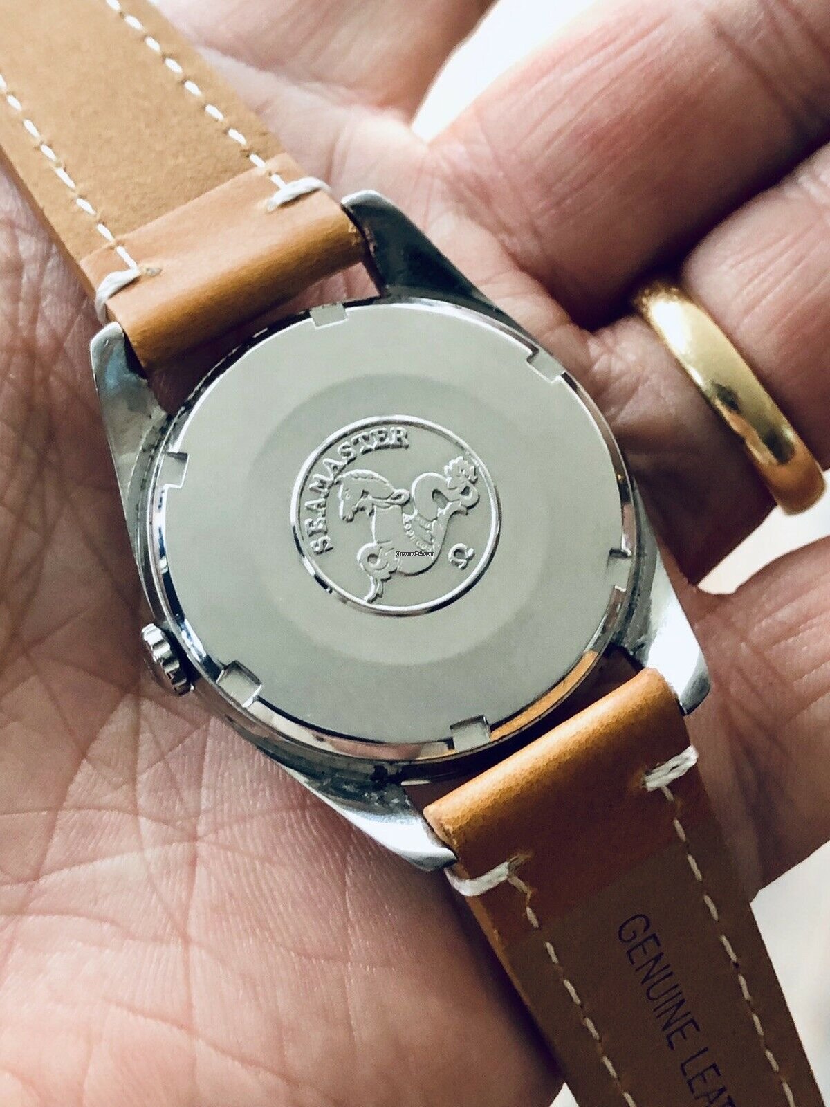

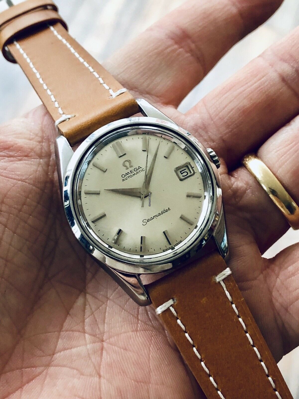

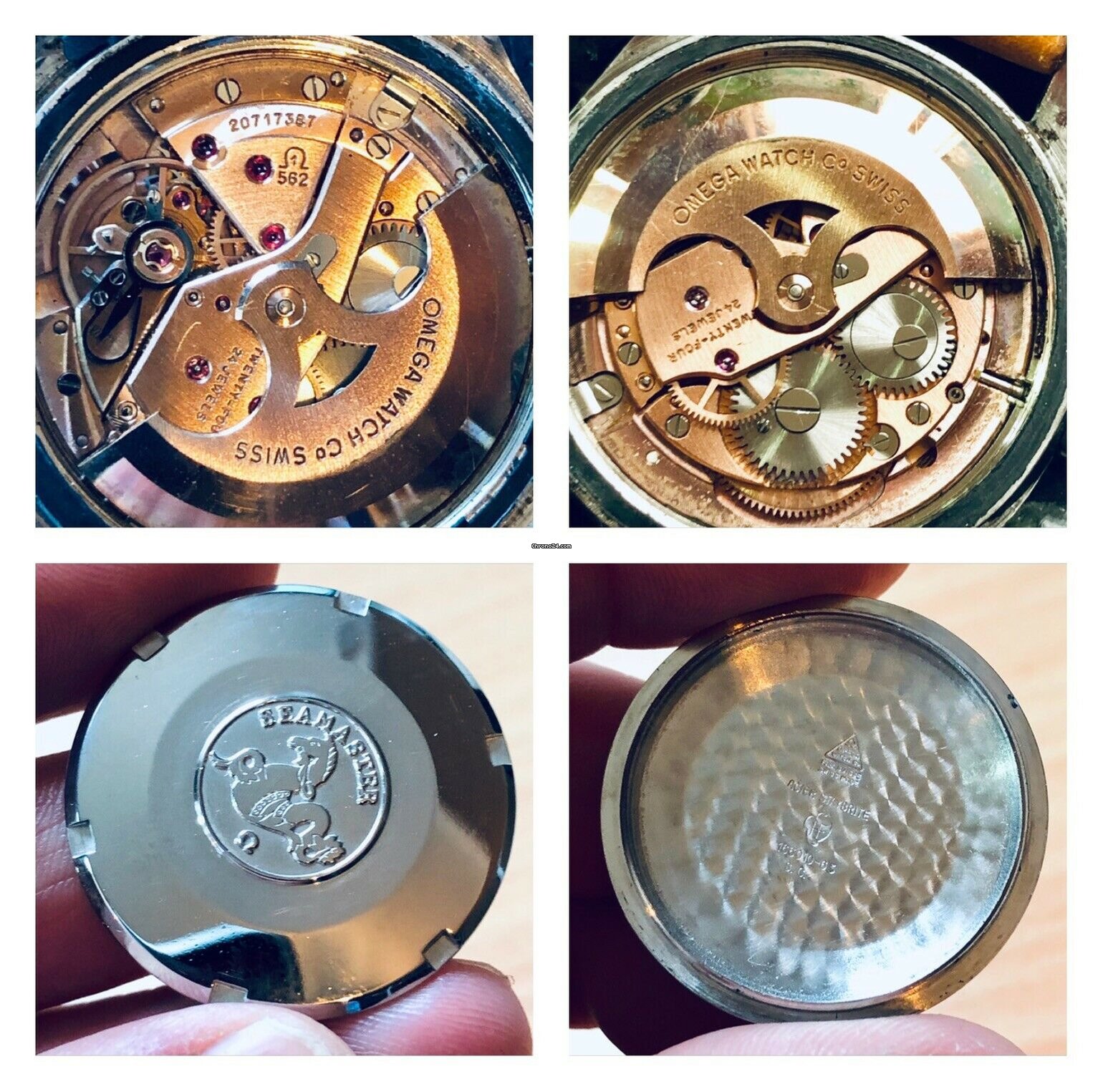

I have attached photos and the condition looks great to me. The dealer has serviced it and is happy to send the servicing papers with it. From my current knowledge, this is a happy medium where I don't think I will be inheriting too much risk in which I will be faced with functional issues. However, the extent of knowledge is limited and I do not have a trained eye to really pick up on any potential issues in the movement or with the watch as a whole. I would really appreciate some guidance, whether this is a good find and if I should jump on it? Or is this something not worth pursuing - furthermore any tips or advice would be greatly appreciated.

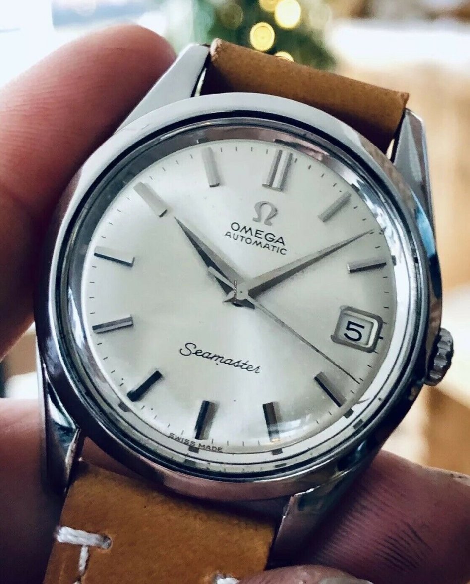

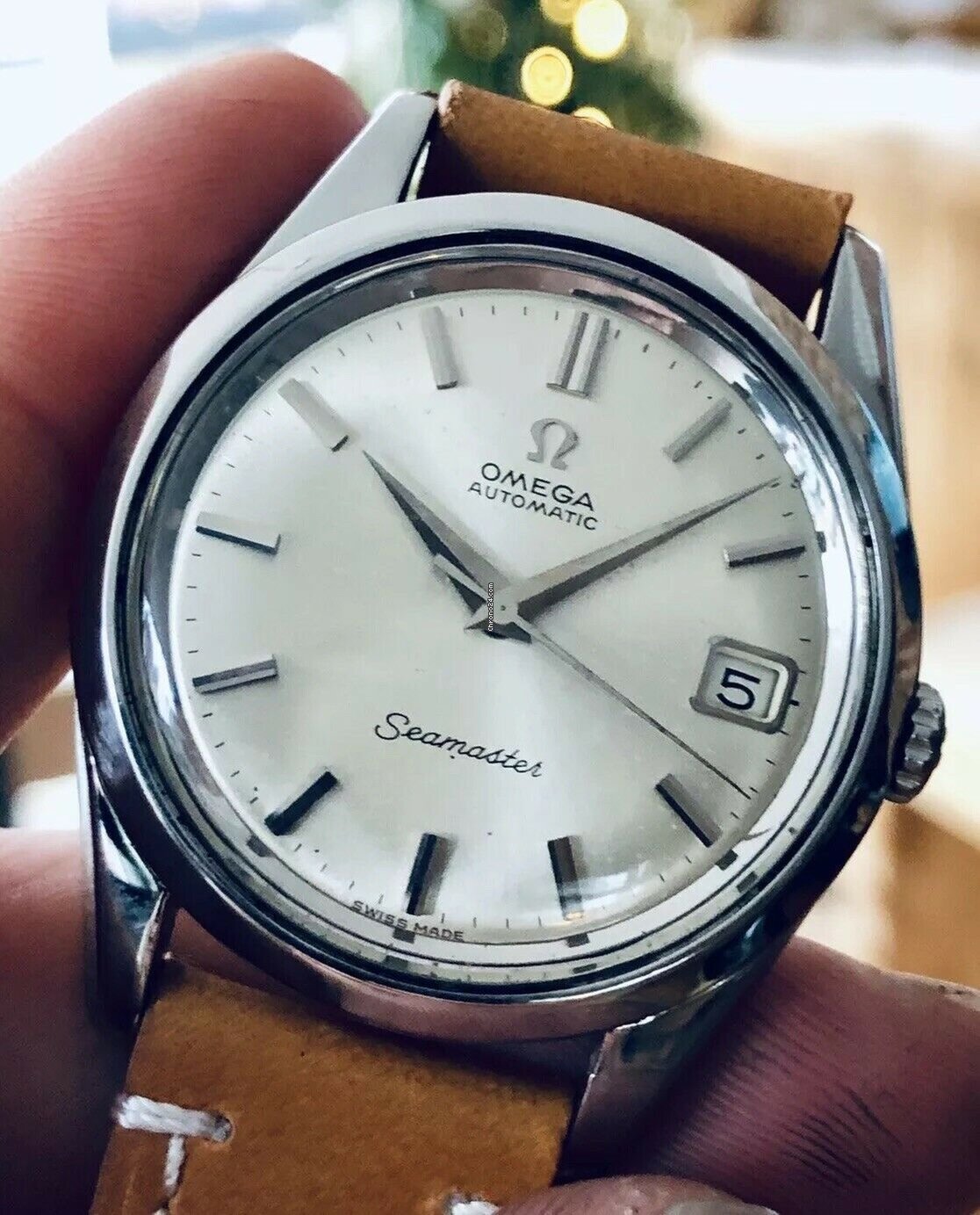

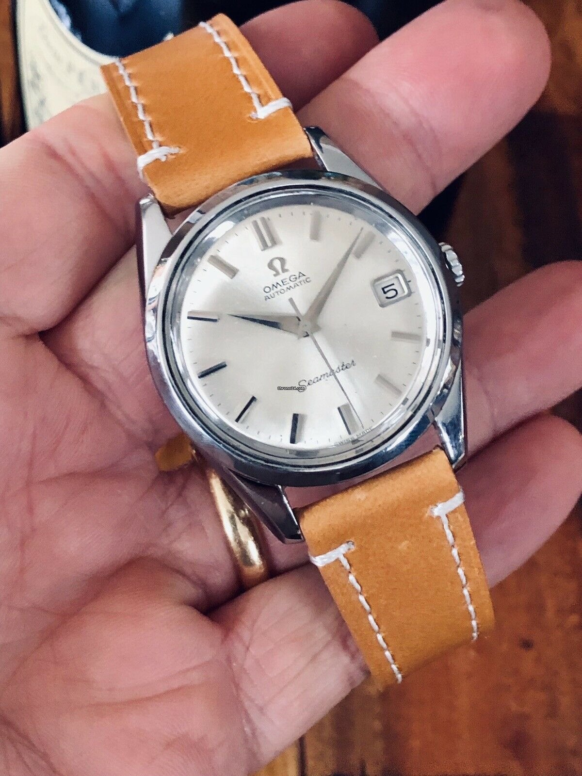

I would be asking the seller if those photos are post or pre service.
If post then why hasn't the case back seal been replaced? Also I would want to know if the rotor rubbing issue has been addressed.
Overall the watch looks original but it's seen a too much time on the polishing wheel for me.
Price is 50% too high.
These are quite a common reference, you could do better for less with patience and education.

I would check if the caseback's reference datecode suffix is saying -63 or -65, if it's -63, then imo, nothing is eye-glaringly wrong, if you're okay with the slightly soft case. Assuming that the watch was legitimately serviced, I would purchase it for about 200 USD below asking if it came with a proper BOR bracelet. In any case, it is priced too high.

+1 on verifying if the gasket and rotor rubbing issue has been addressed post service. There also seems to be some pitting on the case in or around the caseback. That would compromise water resistance greatly.
The watch also appears to be unpolished on the sides? The side of the lugs still have that natural vertical brushing, but appears to have been polished everywhere else. The price seems too high. I think could get a cal. 564 chronometer on a BOR for that amount.

That price is definitely too high, and the case is a little too polished for most tastes. You can get a contemporary Seamaster in better condition with a good BOR bracelet for less than $USD 800 (AUD 1200) from reputable ebay sellers.
