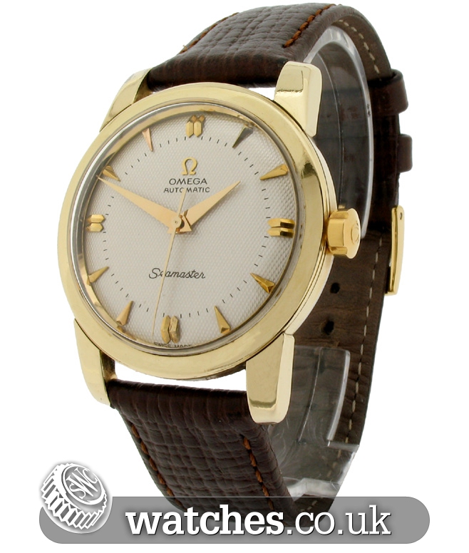

Sorry.....this is mine. I made a huge mistake in parting with it when suffering with poor health and deeply regretted it. Fortunately I was able to buy it back (the shop had the details of the person who bought it from them). Still suffering with health, but at that time i was VERY ill, physically and mentally.
Yes, foolish. Yes, I got stung and lost out financially. Yes, very glad to have back in my possession.
As per my original post, again, any information would be gratefully accepted.
Oh, the strap the watch has now is different to that in the pictures from google. I had asked for the watch to have the original style it would have had new.
So, again, never seen another one like it.

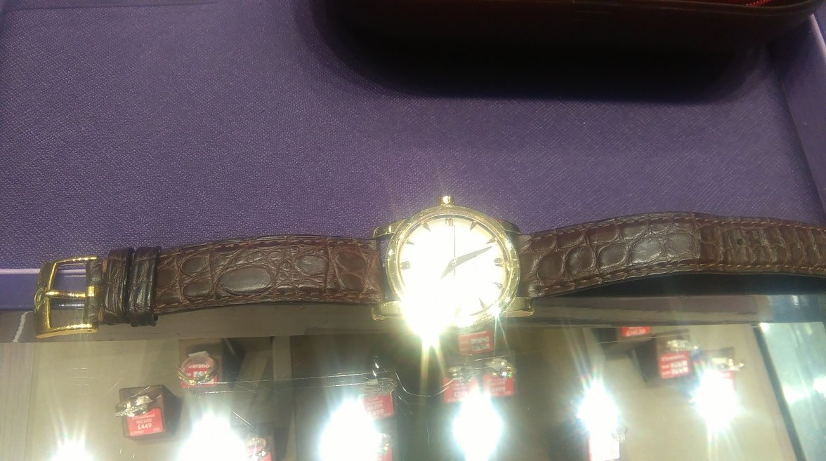

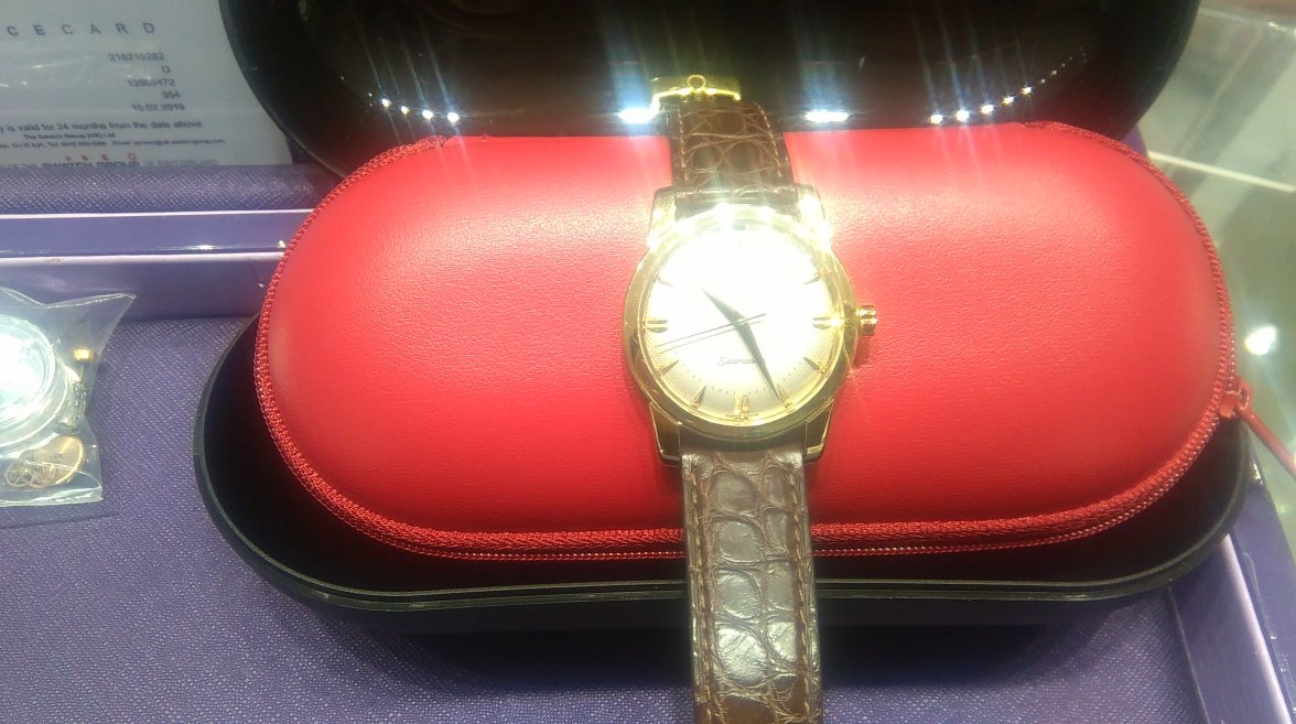

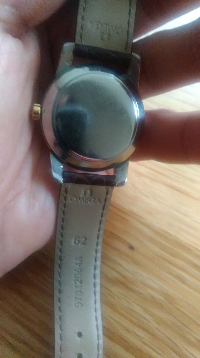

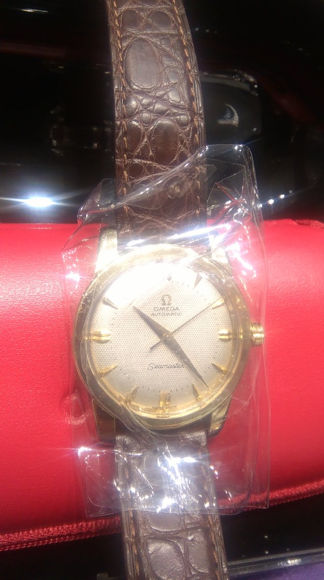

What's in the parts bag from Omega? I think I see the crystal but there's something else in there that looks like a case back.

Thanks efauser - I'll hopefully be able to tell you tomorrow as I'll ask the jewellers who sent the watch to Omega for servicing for a copy of the service report.

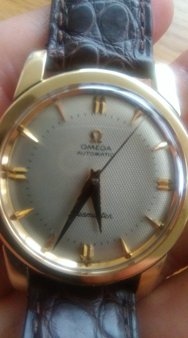

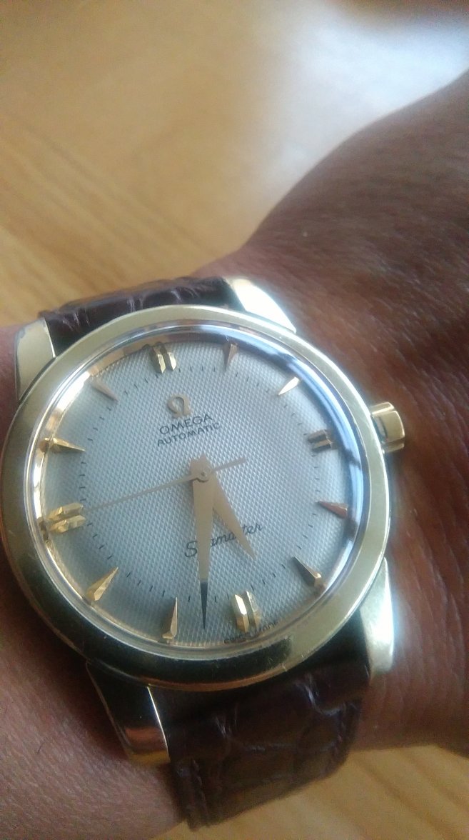

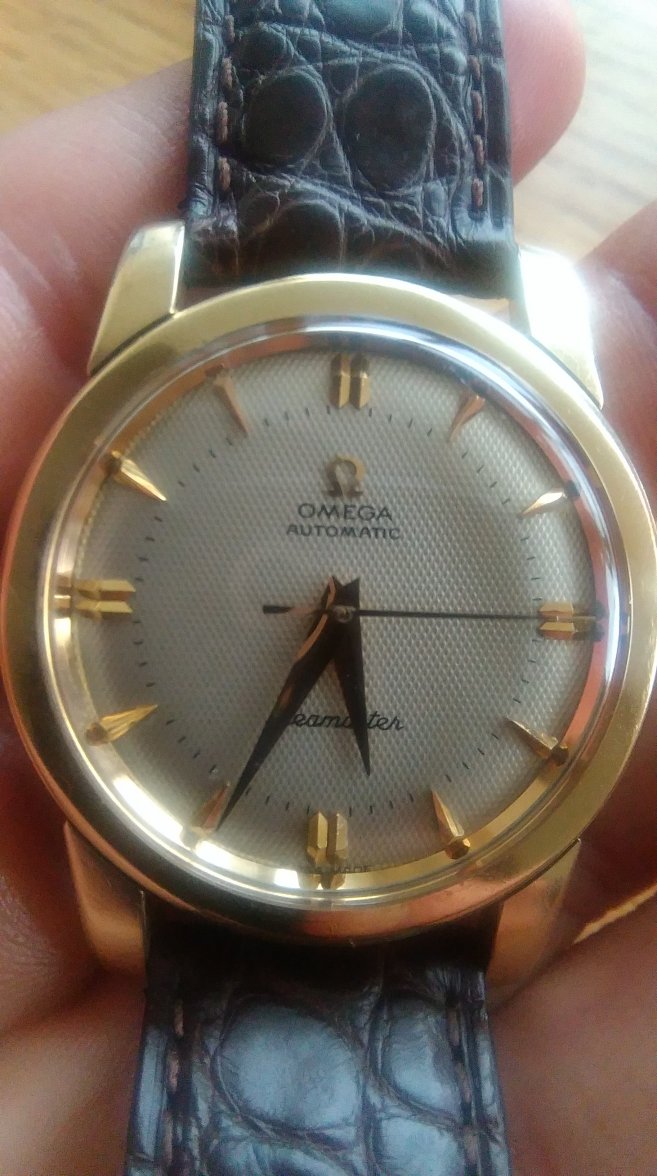

My mobile phone camera is not the best, but I've attached pictures of my Seamaster taken today.
Is it a honeycomb or waffle 'textured' dial?
I've contacted the Omega Museum and cost of an extract is 120 francs. What they have said is they cannot tell me how many watches were produced with the same dial / baton configuration.
What i do know is model CD2767, Calibre 354, Serial Number 13969472, Year 1952.
Is it one of the more uncommon variations?
Fully restored (apart from Gold Capping which I was told cannot be done - correct me if that is wrong) and serviced twice. Wanted watch back to as new condition without losing the originality.
Opinions please?
12
Top left where strap and case meet is reflections not scratches / marks.

Limited value due to all of the restoration work, but also because gold-capped models are low on the desirability scale. The hour and minute hands appear to be dubious in terms of style. They would not have been completely flat like that when the watch was originally produced.

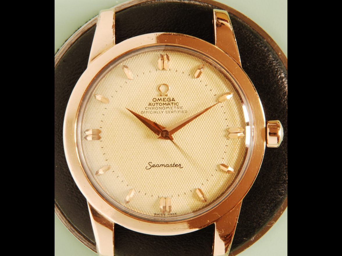

Here’s my 2657 Jumbo seamaster chronometer I think it tells you what members are talking about as to originality
It’s a well held belief that omega should not be allowed anywhere near their vintage pieces
10,829
16,847
Reading between the lines a little, I have a feeling you expect the value to be rather higher than many of us with similar pieces would estimate. A waffle dial is certainly desirable but I have a feeling that one isn't fully original (based on the fonts) and the gold capped rather than solid or steel case will hold it back. If I were forced to put a value on it, I would be in the mid hundreds ballpark. If you are laying out money on a Bienne service and professional valuations I am guessing that wont be an opinion you share but there it is, you probably spent more on the service that it would fetch on the open market. This is not the passport to riches you may think...

Without seeing how bad the dial was originally it is difficult to say but the fact remains that a redialed gold cap fat lug SM is not massively desirable. If the dial was originally passable then yes you have removed value in messing with it, if it was junk then you have added value. All things being equal it would have been better if the dial were fully original but time and circumstance means that 60+ year old watches aren't always pretty.

STS no doubt did what they could within the instructions you gave, asking them to re-fit the hands they removed 5 years ago strikes me as a fools errand. They will have either been binned or re-purposed by now and their warranty is 2 years so they have no obligation to help. They will have fitted what Omega offer as the current replacement for this calibre and model, often on an older watch this is not exactly like for like.
It is not overly restored and indeed might ensnare a noob, but any intervention on the dial will be detectable to a seasoned collector and collectors generally value originality over all things. Its funny you mentioned Somlo since they are more than happy to sell over-restored shiny things at hugely inflated prices to rich Mayfair types with more money than sense. If it were in their window it would probably be priced at £2K. Unfortunately in the real world (ie an Ebay or Fellows auction) considering the lug gold cap damage I think it would be lucky to make £5-600 all IMHO of course. I am probably coming across as unkind and my opinion unwelcome, that is not my intention but I wouldn't want to see you throw yet more money away if you are looking to sell this. An extract for instance wont add the £100 it costs so wont be worth it unless you want the info for sentimental reasons of course.
