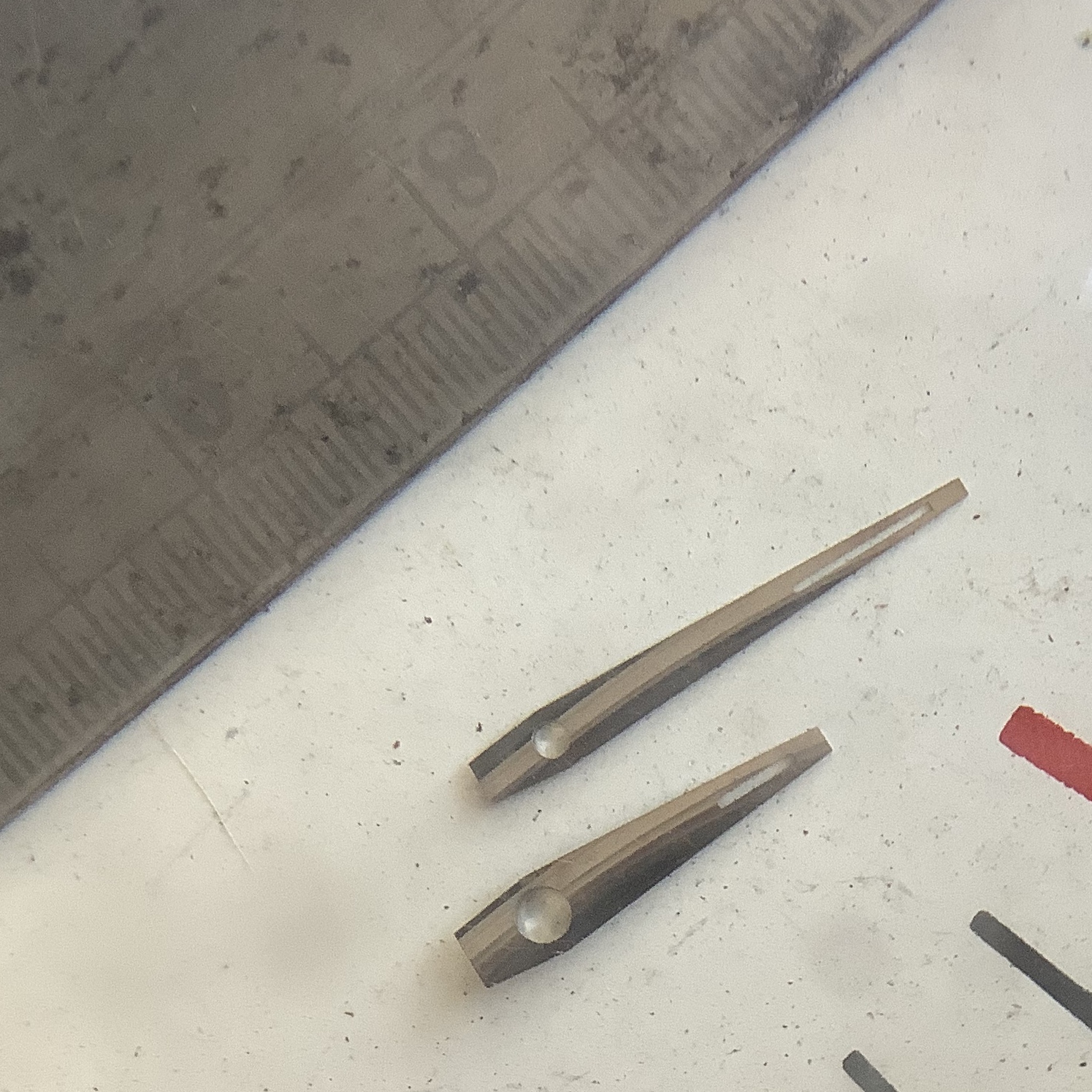

I bought some hands and included are an hour and minute hand that surely are Universal Geneve. To my eye they look like space compax ones, but then again there are many models that appear to have near identical hour and minute hands (Nina etc). I tried to find a resource on this but had no luck so far. So can I ask the experts, a) if there is a resource which defines the characteristics of these hands by reference, or b) if there isn’t a resource, whether anyone can help ID them...

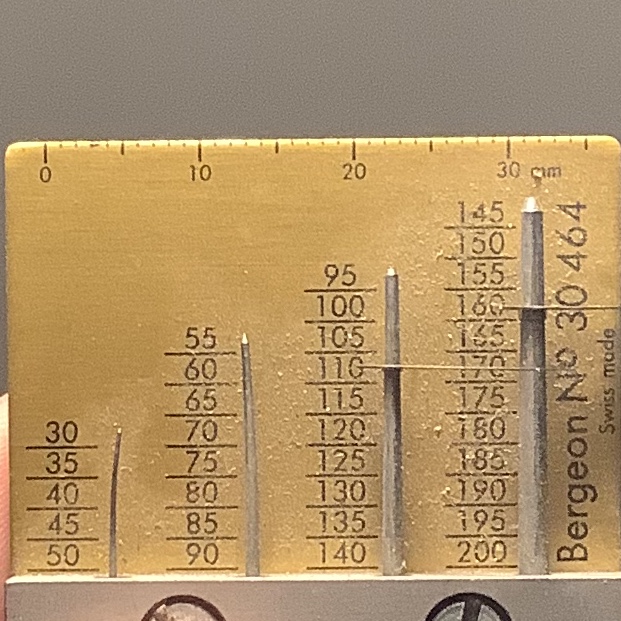

Looks good for Val.72 (1.60 x 1.10)
Where should I check the lengths ?
Hole-Centre to Tip, or total length ?

Here are the measured lengths @rolokr
End to end (directly measured)
H: 11.7mm
M: 15.9mm
Centerline to end (estimated from photo using above measurements)
H: 9.3mm
M: 13.6mm
