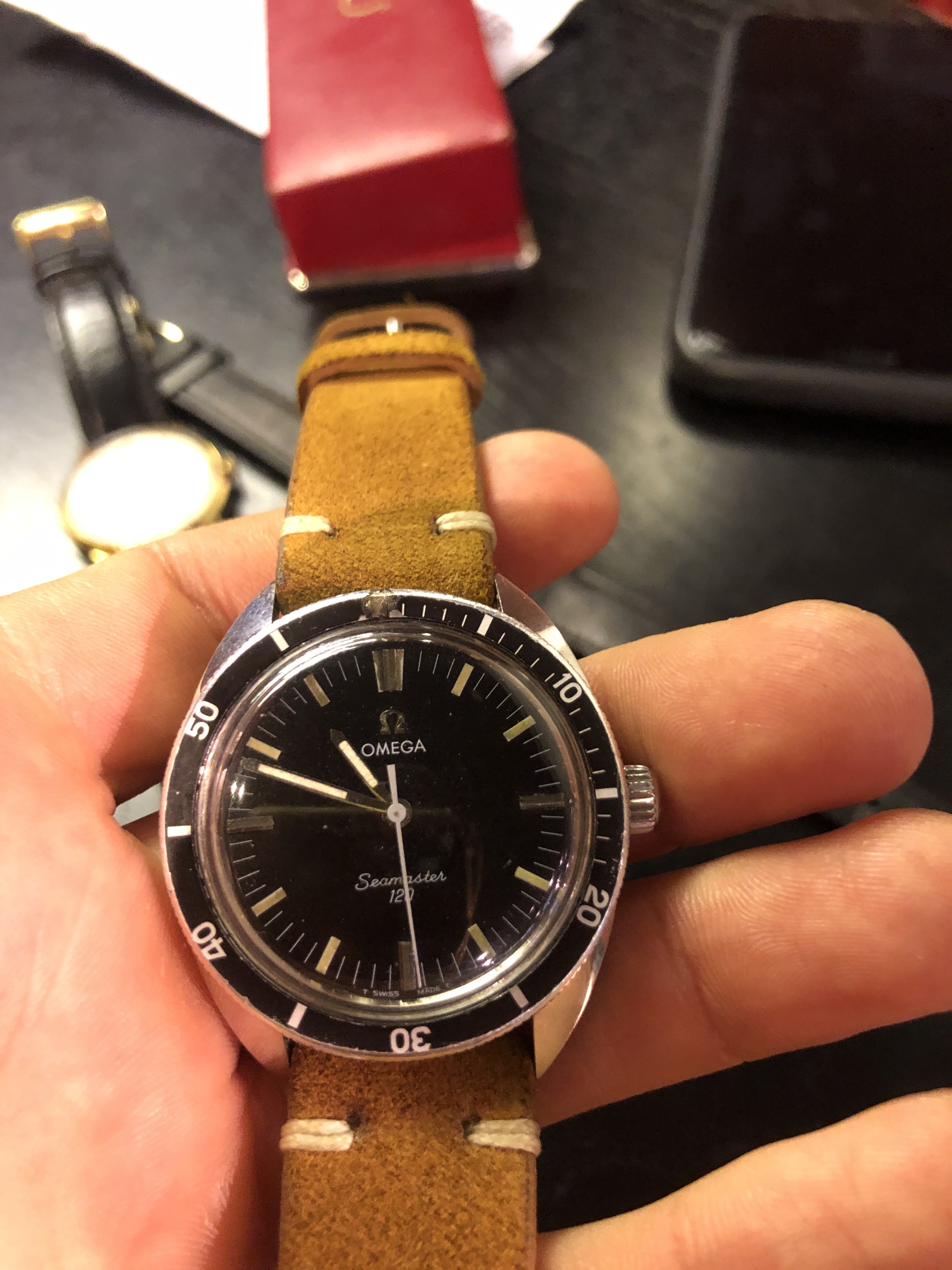

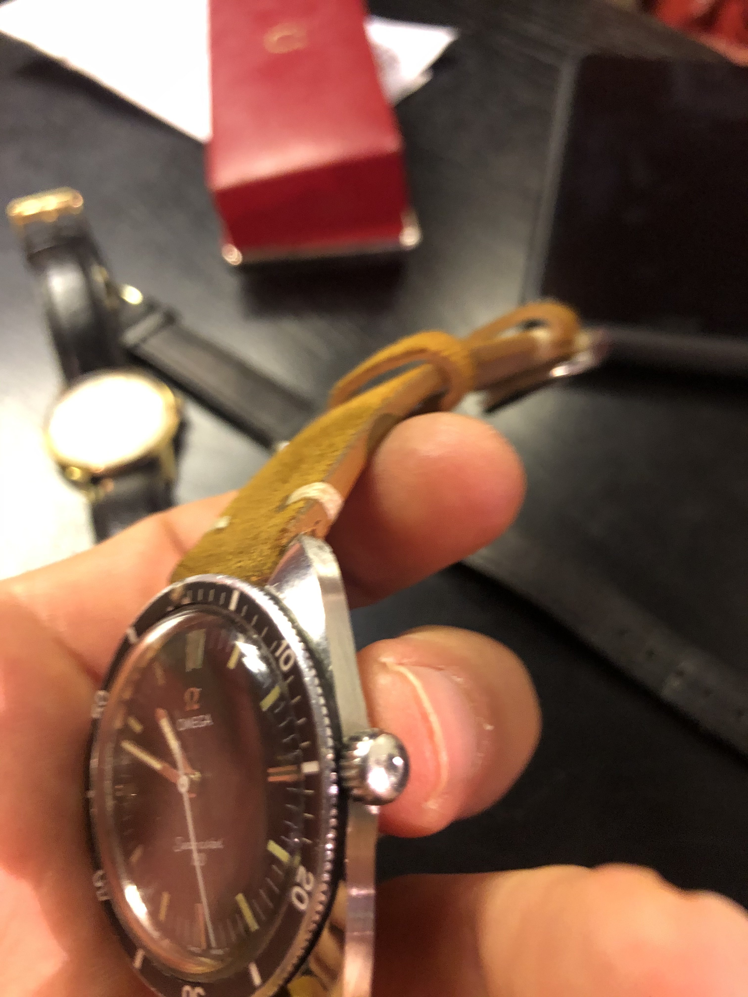

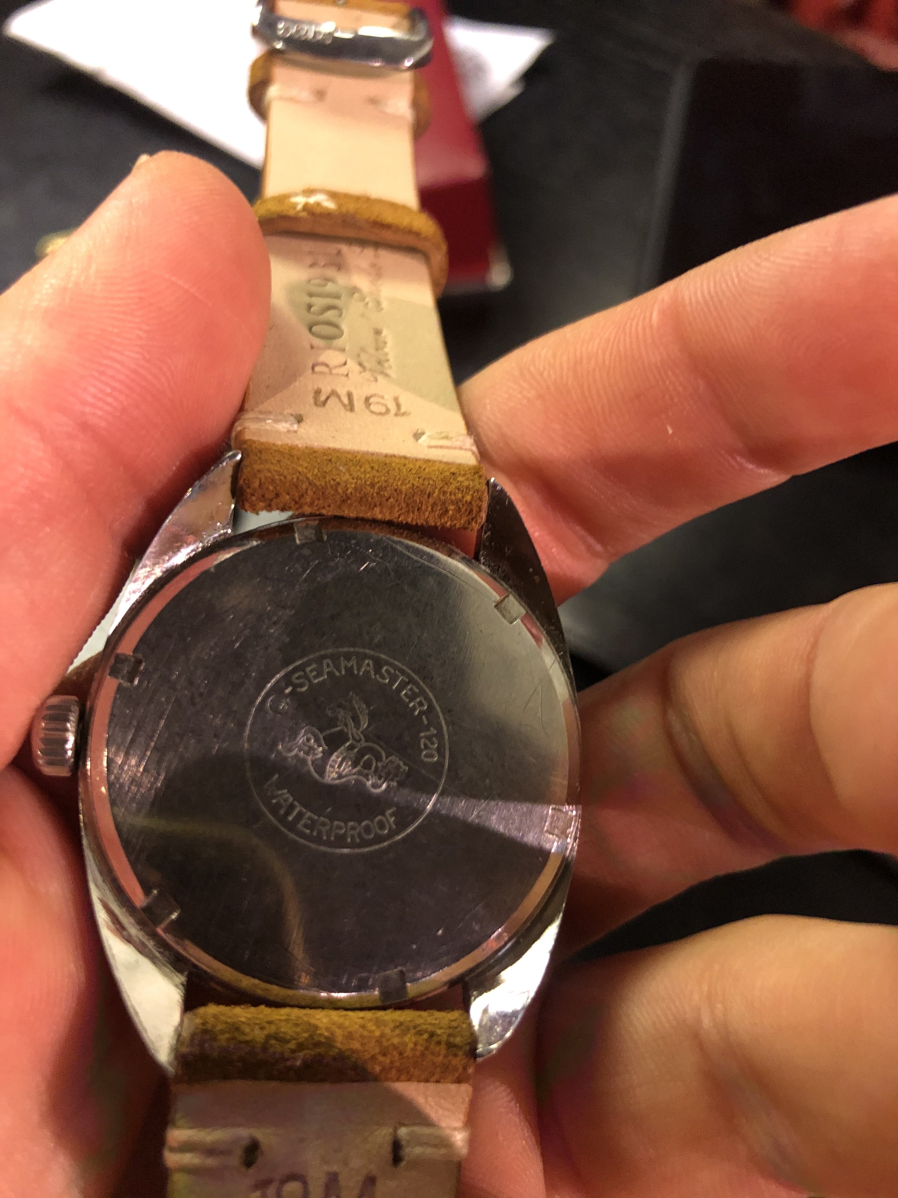

Dear members,

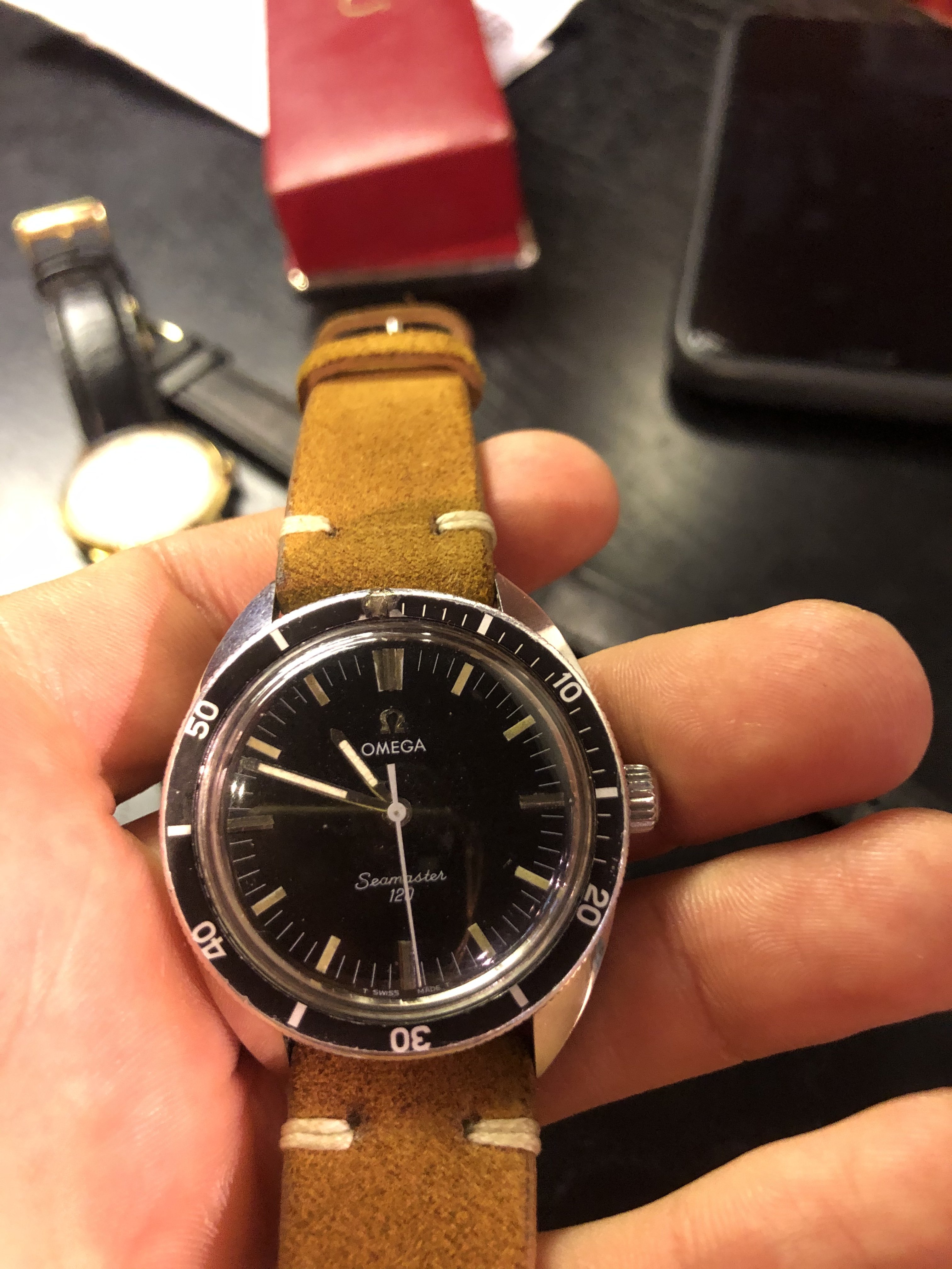

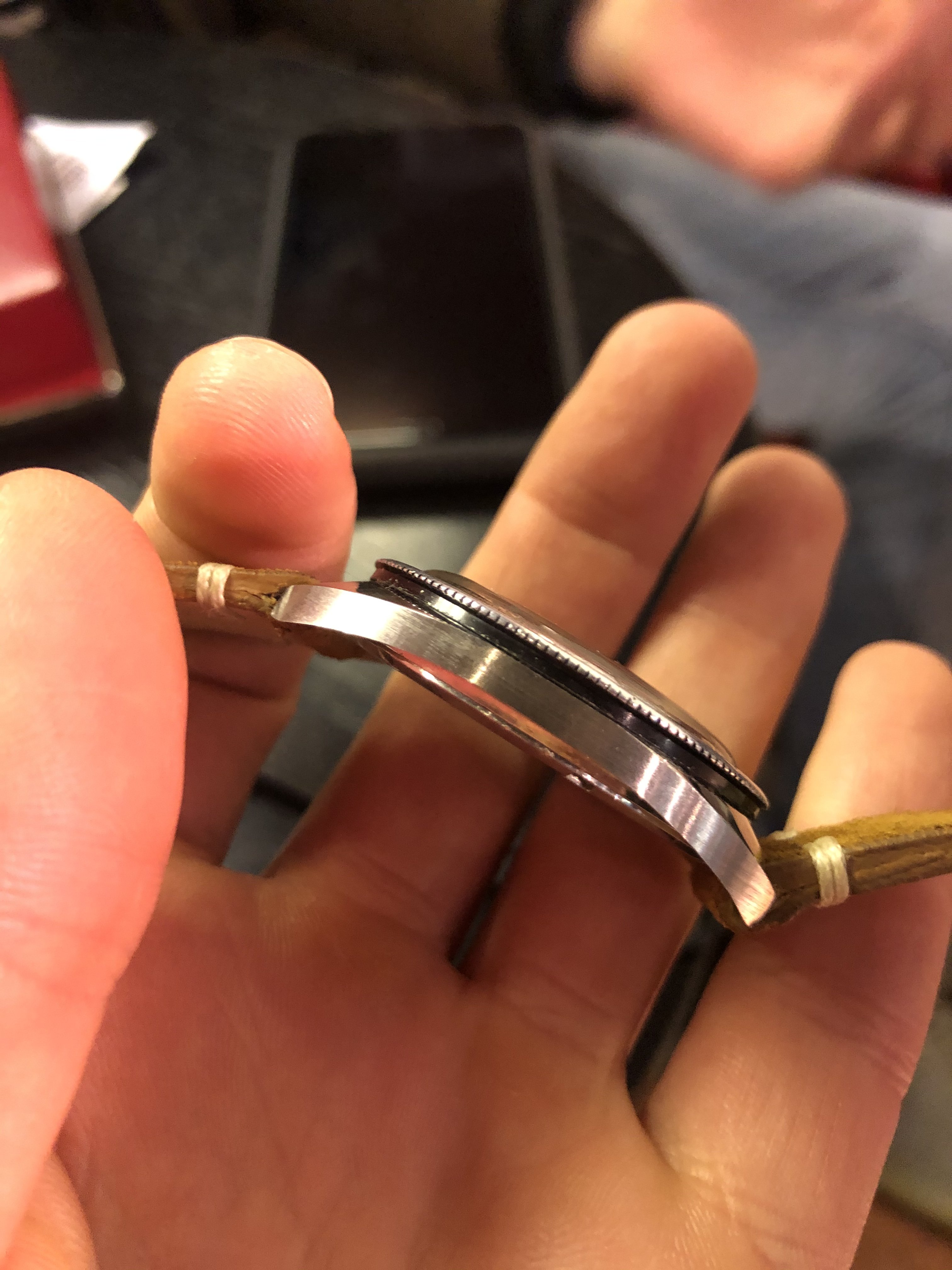

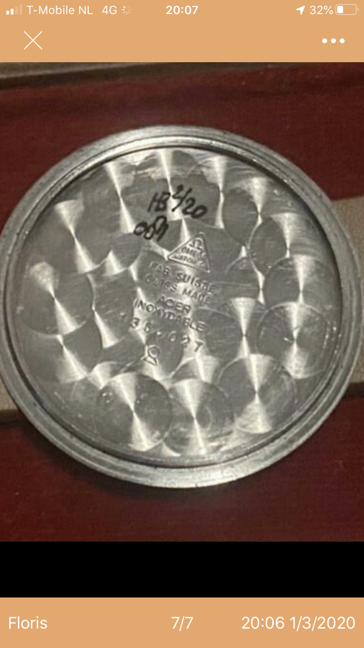

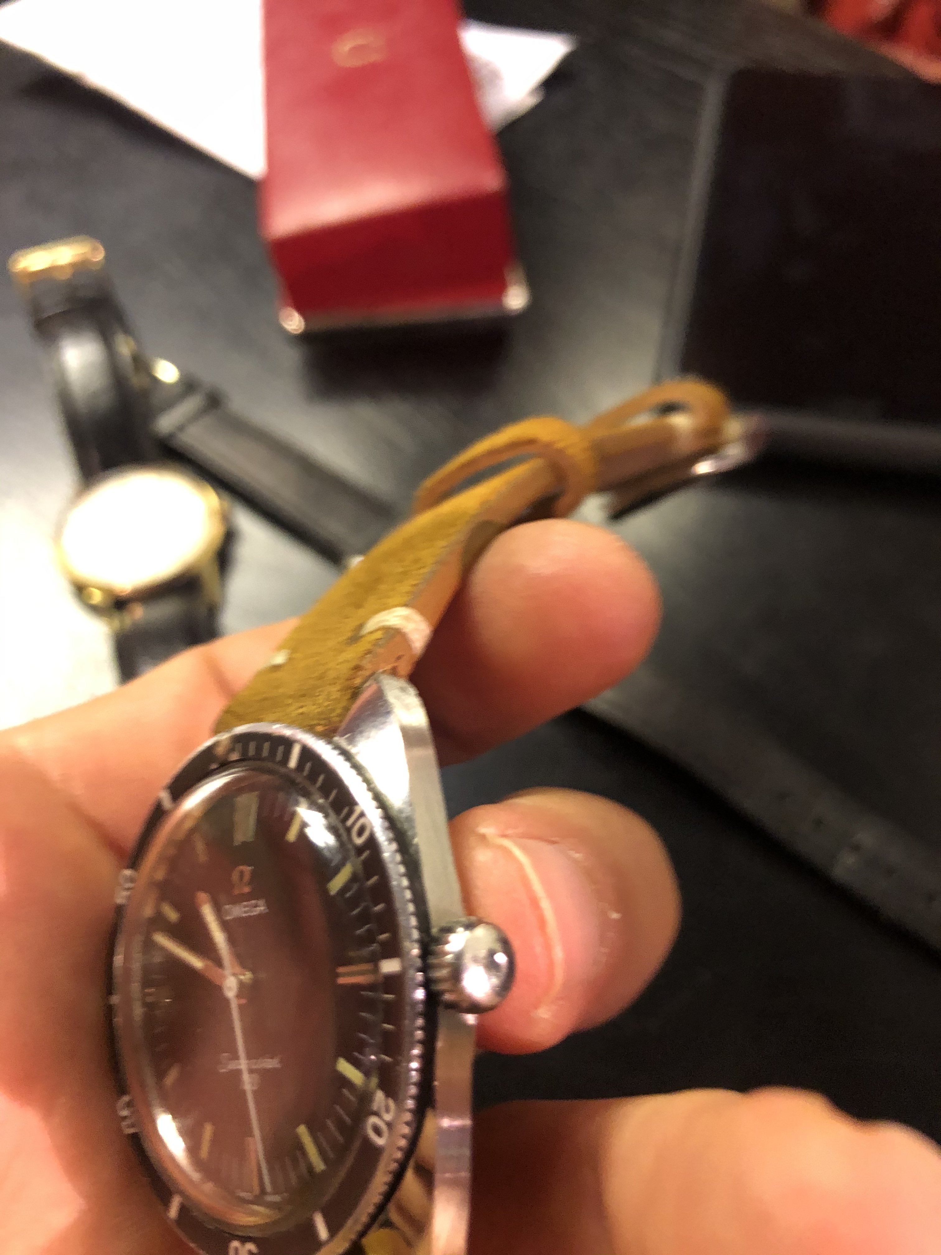

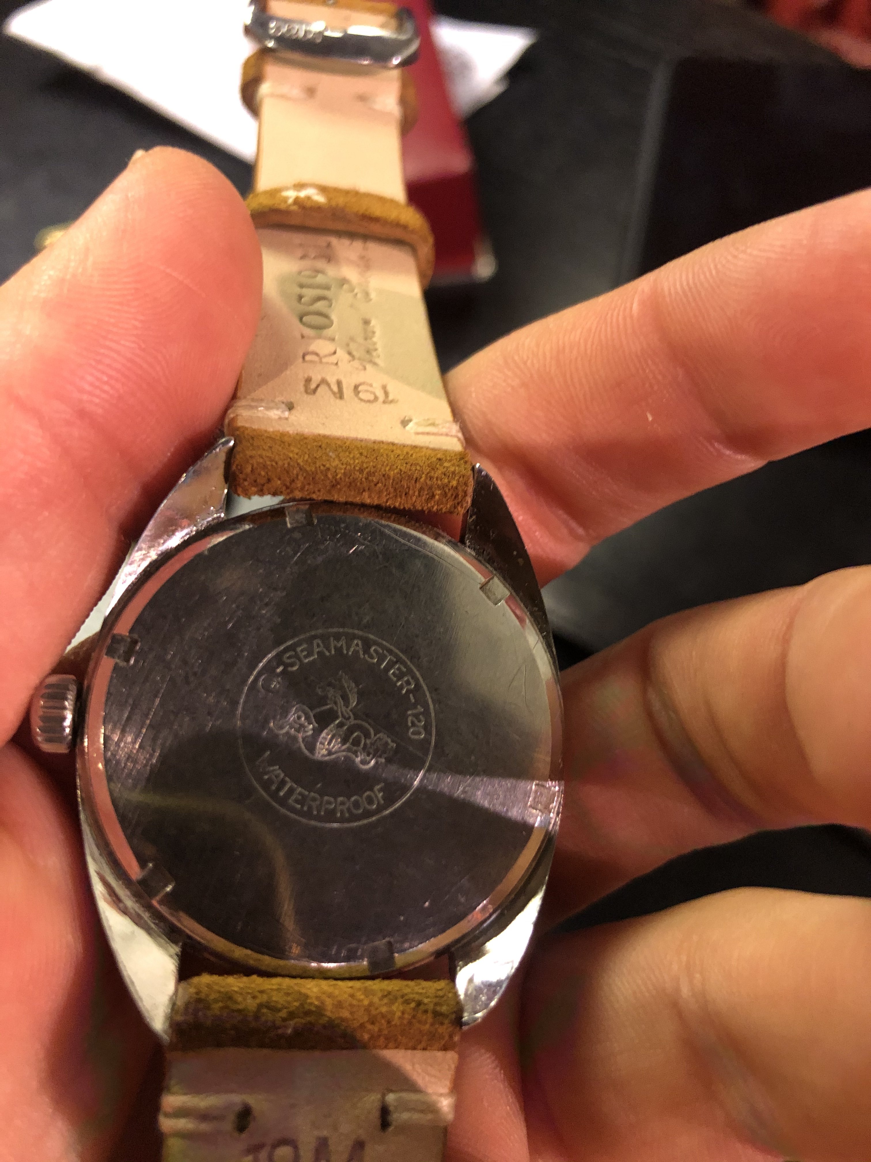

This is my first post, I just started my interest in watches and Omega. I came across a vintage Omega seamaster 120 watch and need your help with it. I have read the information here about the aspects you need to pay attention to when buying a vintage sm 120, but am still now sure if this is a good buy. The dial looks original to me. Im not sure about the bezel, and the notches at 3 and 9 are not there. Im happy with your advice,
Jan
1,372
2,001
Even the more recent fakes have the notches at 3 and 9. This one is definitely not legit

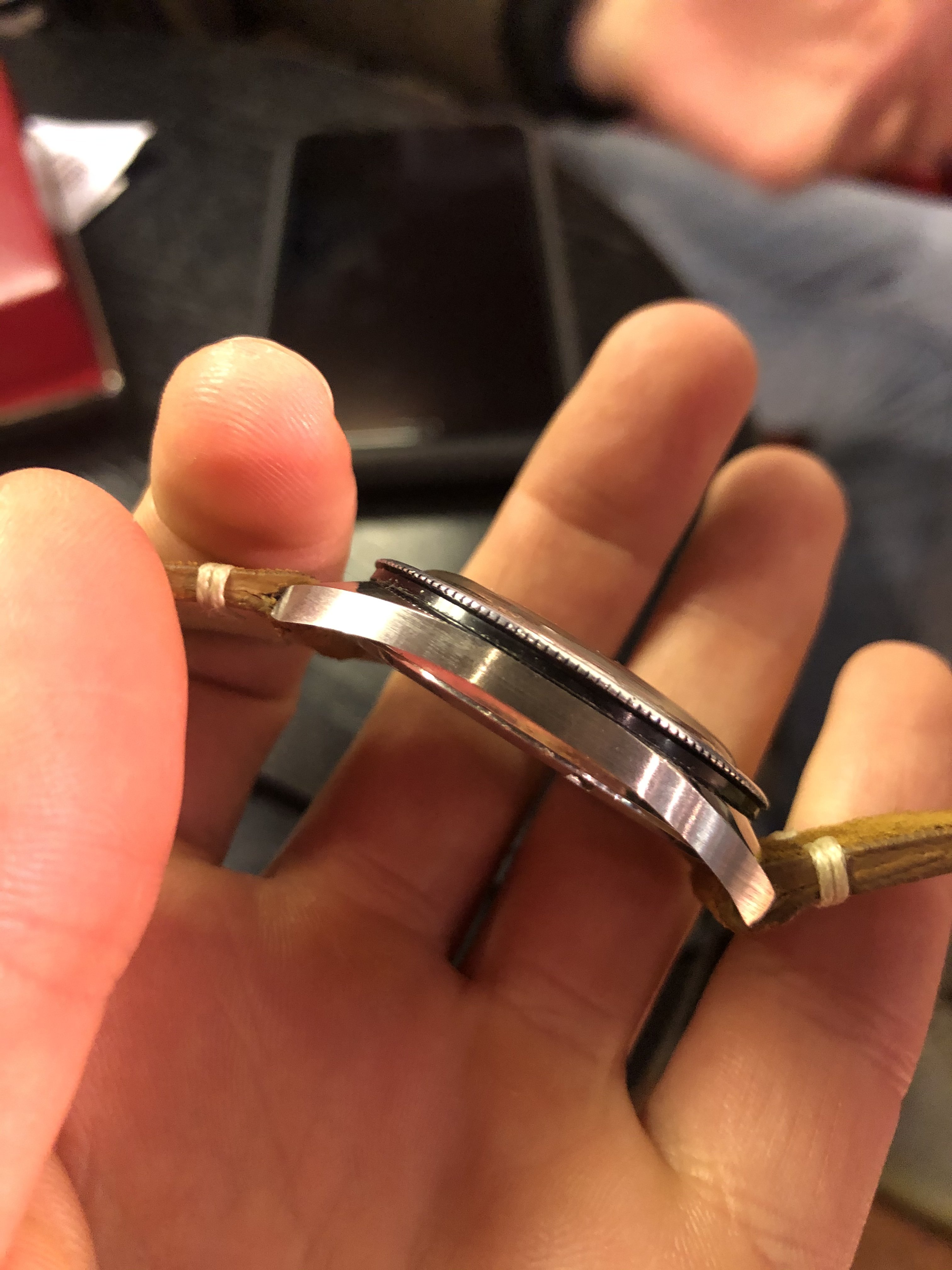

I'm also wondering if the bezel has been ground/buffed down to hide it's newness and the possible fact that it doesn't have the right number of teeth.
2,086
2,899

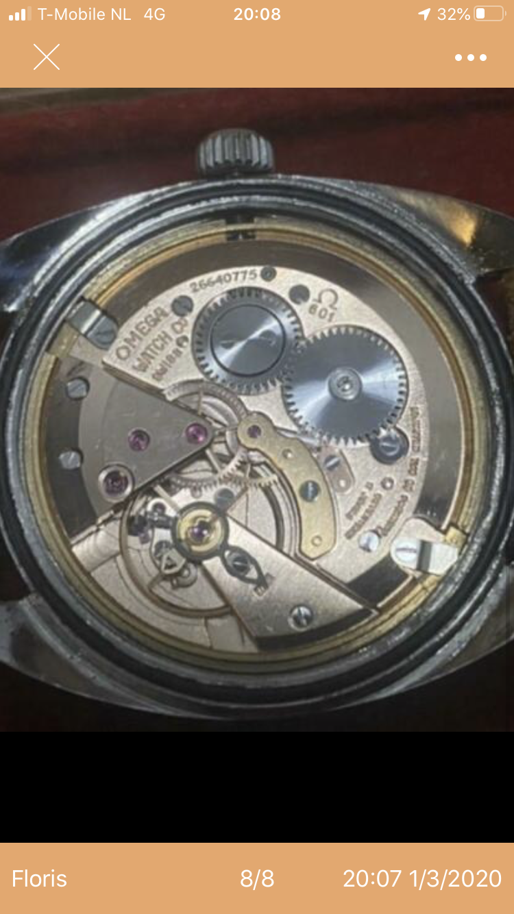

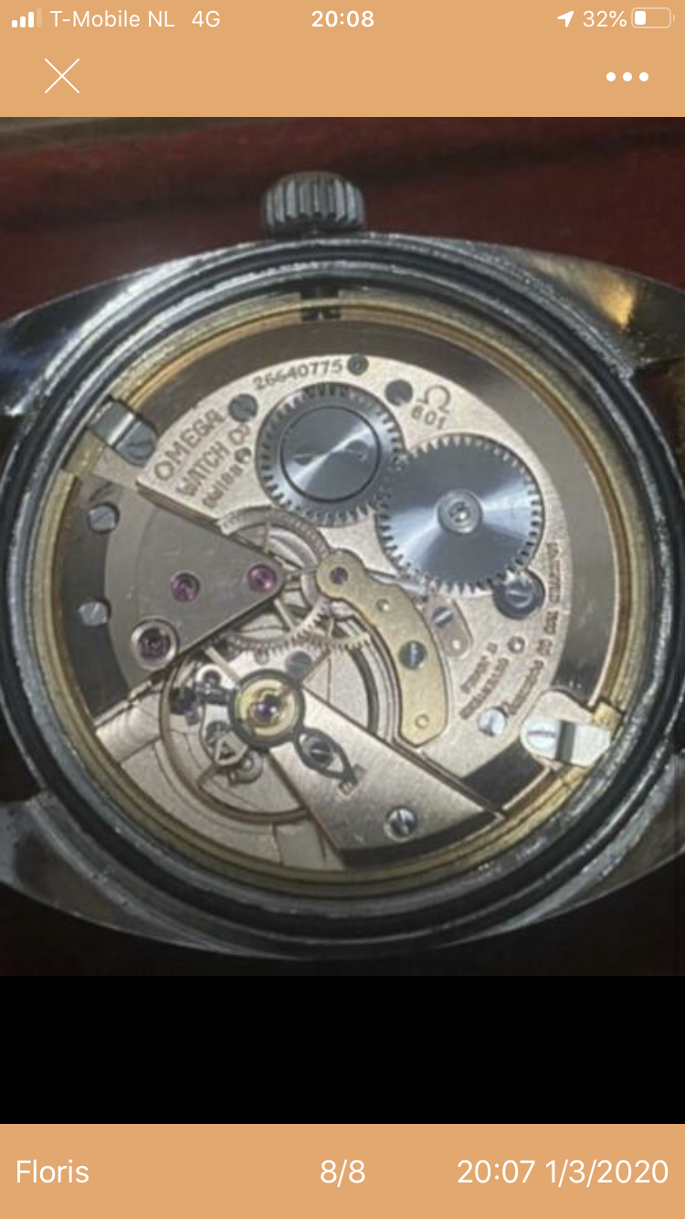

At least not everything's correct with the movement.
8
Thank you for your replies. I was wondering to whether the bezel hast been buffed down. I am not going to buy this watch. Thanks again.
