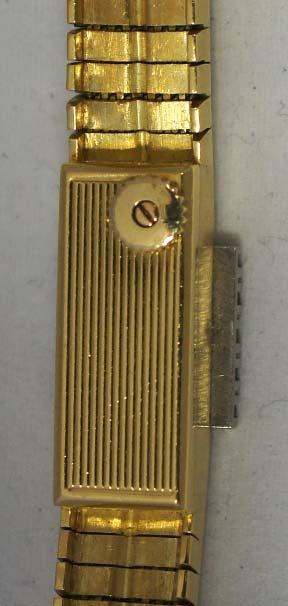

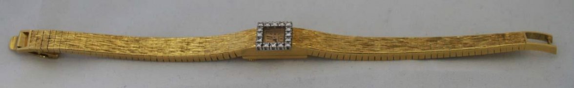

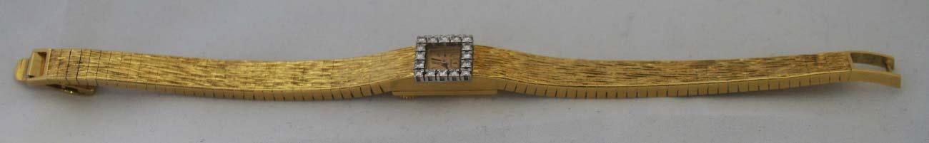

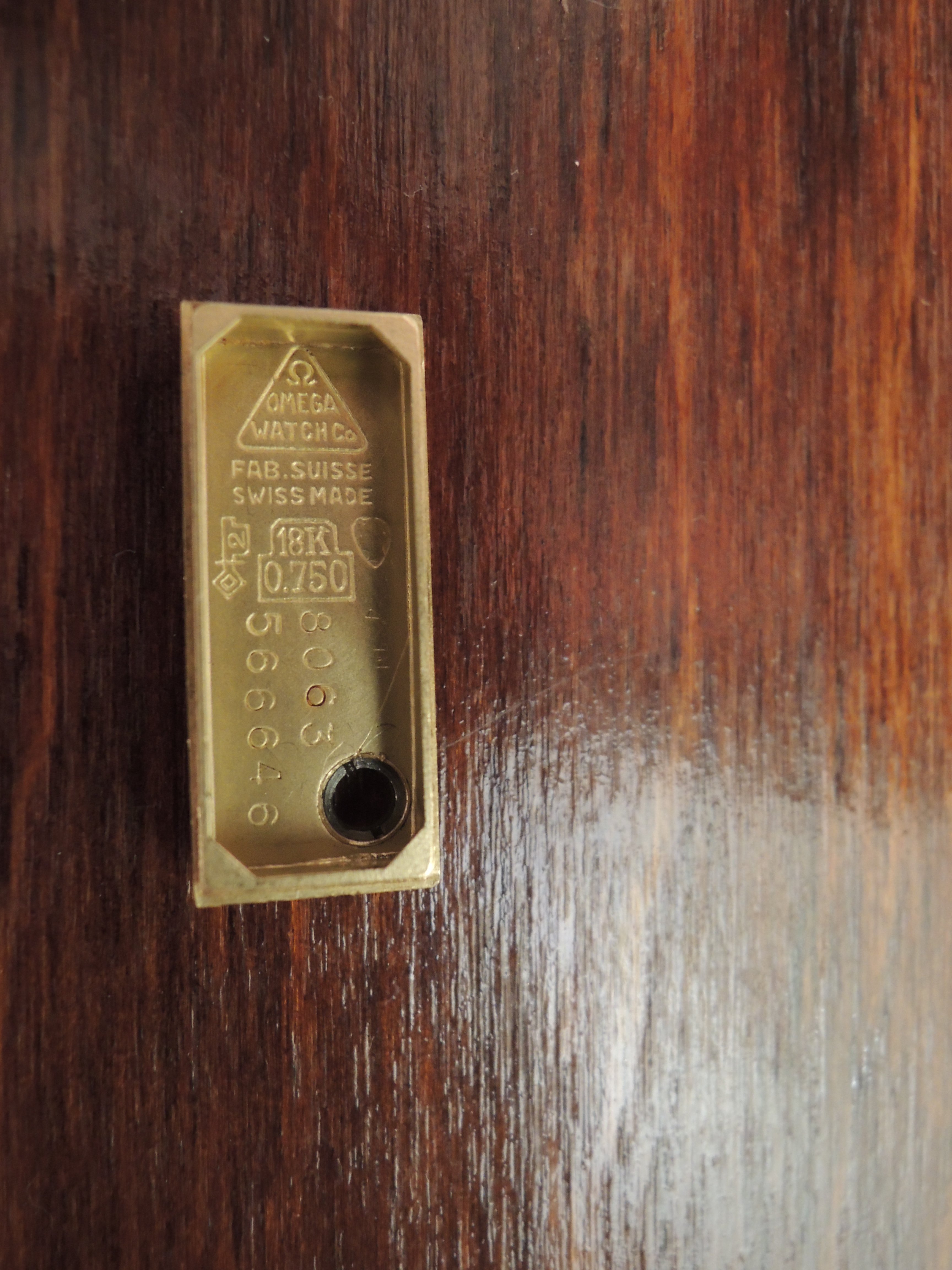

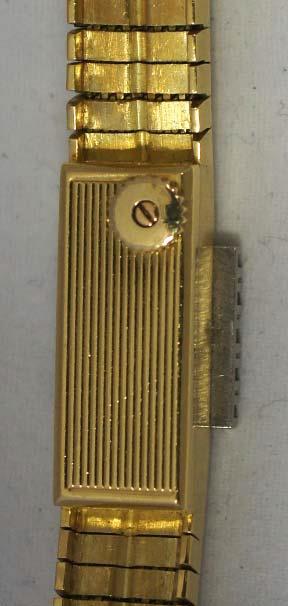

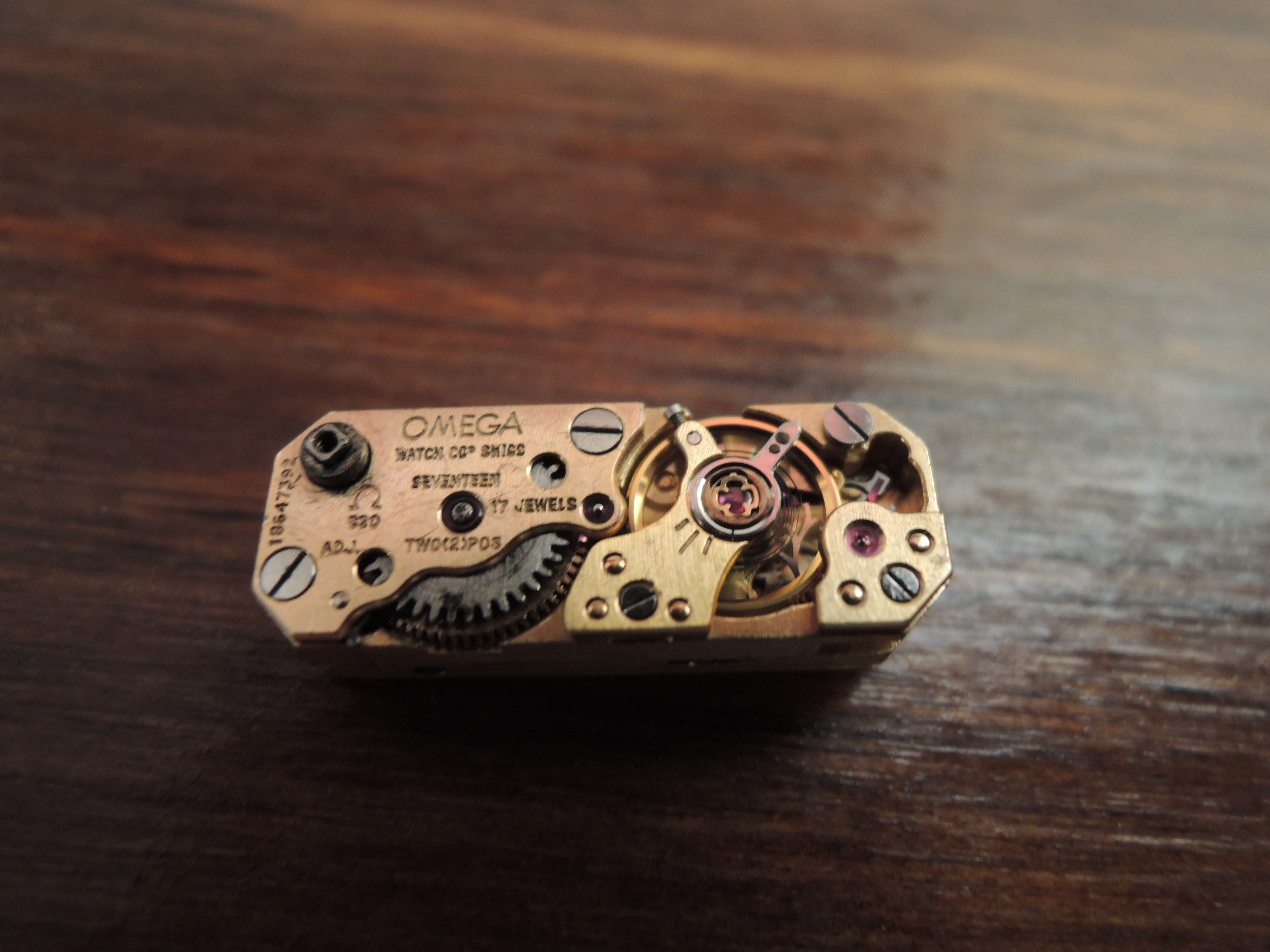

Hello! I recently inherited this watch from my grandmother and I don't have much information about it.

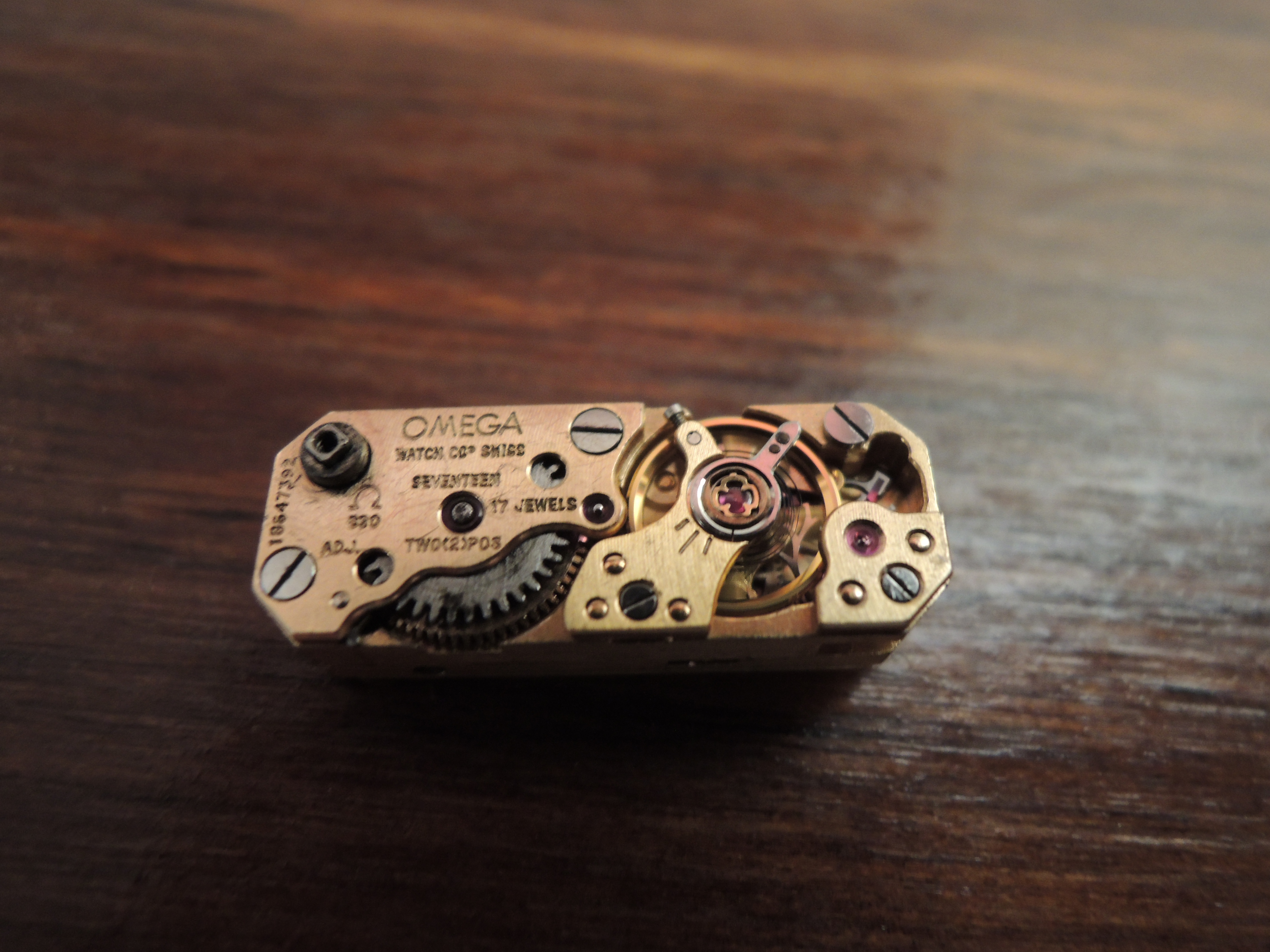

I attach photos of the watch, movement and inscriptions at the bottom of the box.
The movement is omega 690.
Any information you can provide is welcome.
Thank you very much

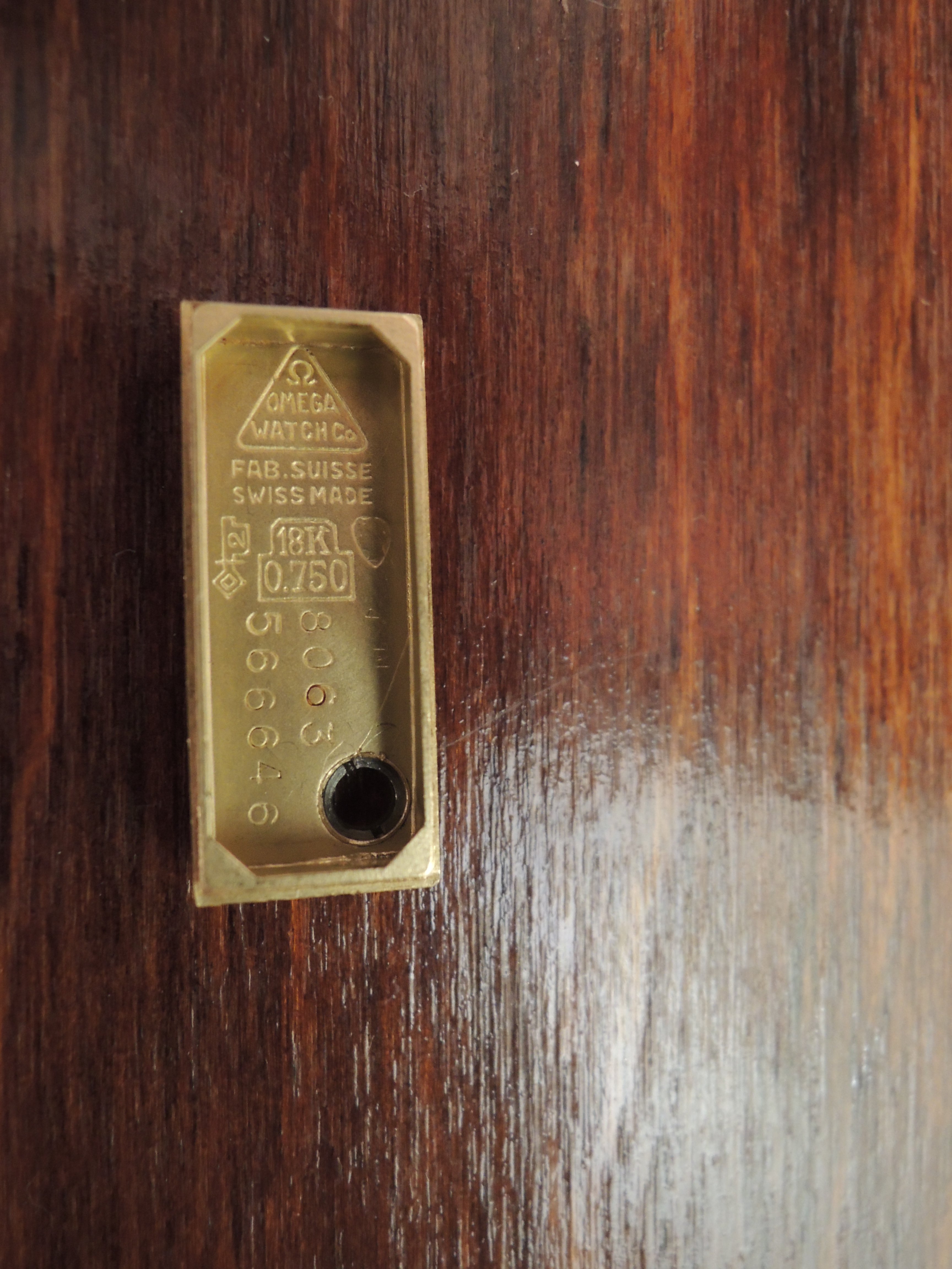

You have the reference number on the inside of the caseback and the movement serial with which to date it (plenty of tables on the internet).
Personally, I've never seen an Omega with the crown on the back like that. Pretty neat.

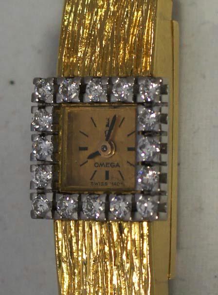

That style of movement has been used by several watch manufacturers on fancy rectangular ladies dress watches. The movement is “back-set”. The case is marked .750 which is 18-karat gold. The integral bracelet is likely also 18 karat gold, and if so, it will likely be marked .750 on the clasp. On a watch of this quality, the diamonds are likely full cut, but this doesn’t show in you pictures.

Thanks! I did not know that the year could be deduced from that number. The number is about 18 million and according to the tables, it's from 1961.

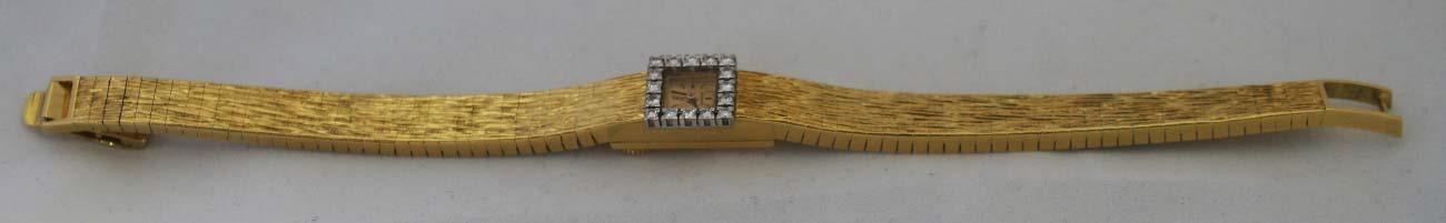

I would go out on a limb and say stylistically, this is totally late 60’s and was about as much of a statement piece as you could get. Think Betty Draper (Madmen). Any woman with great retro style could pull this piece off with the right evening attire.

Wow- that’s earlier than I guessed- the scored gold is atypical of early 60’s. Very dramatic piece

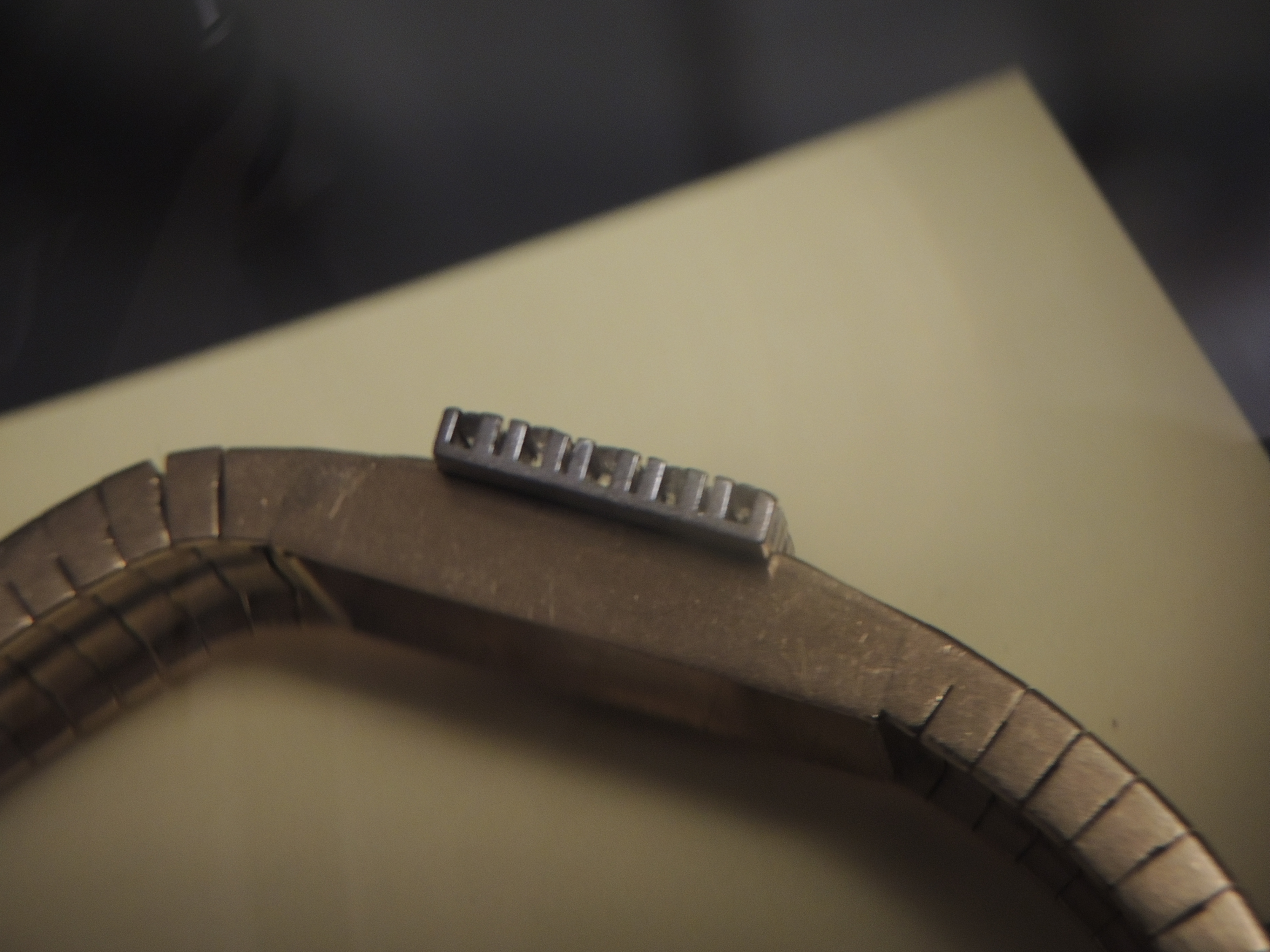

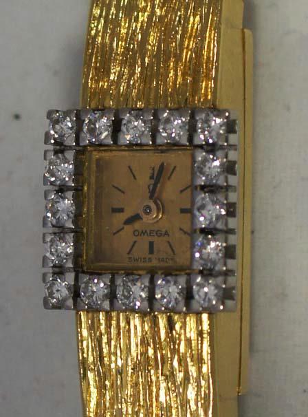

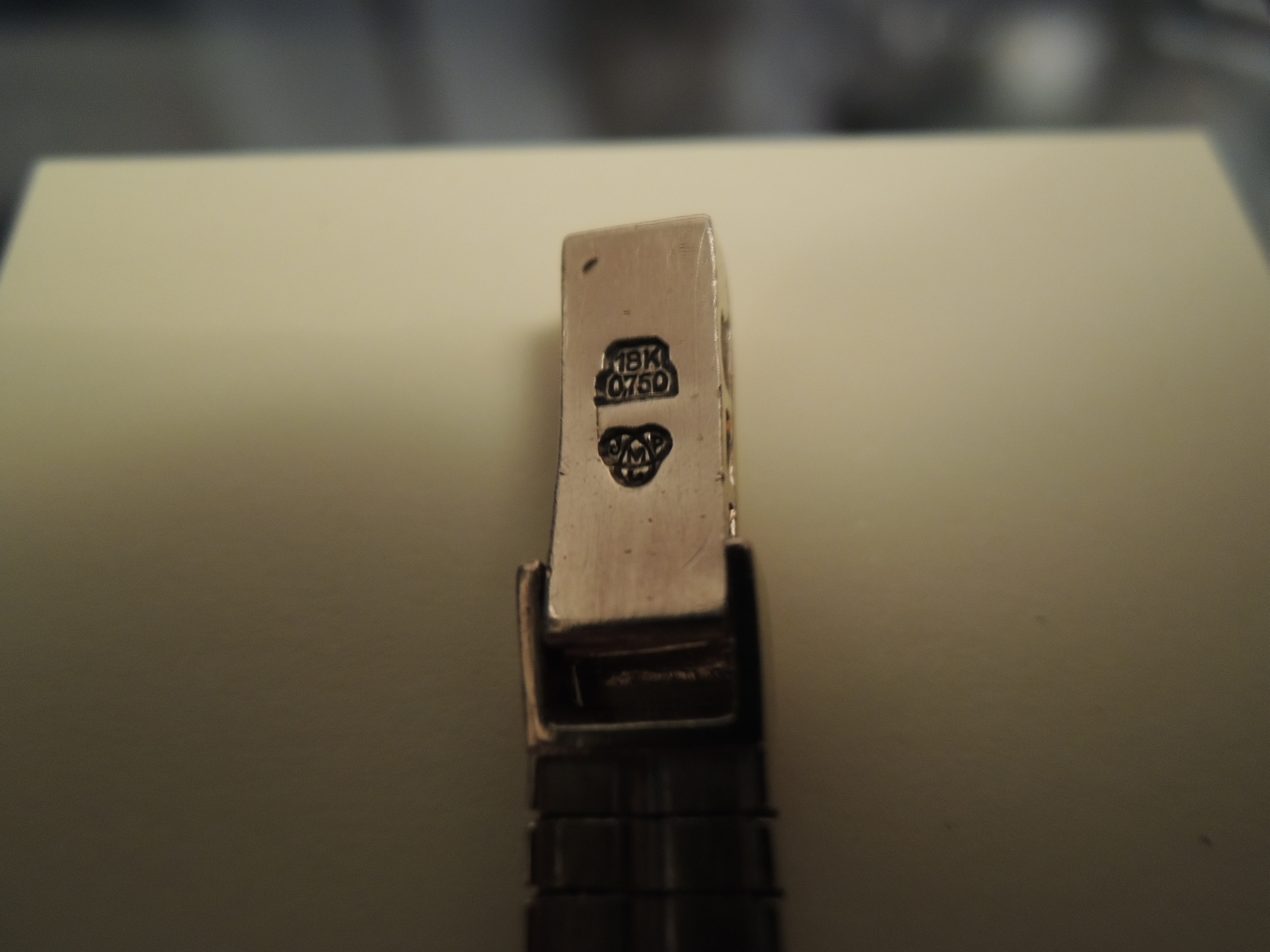

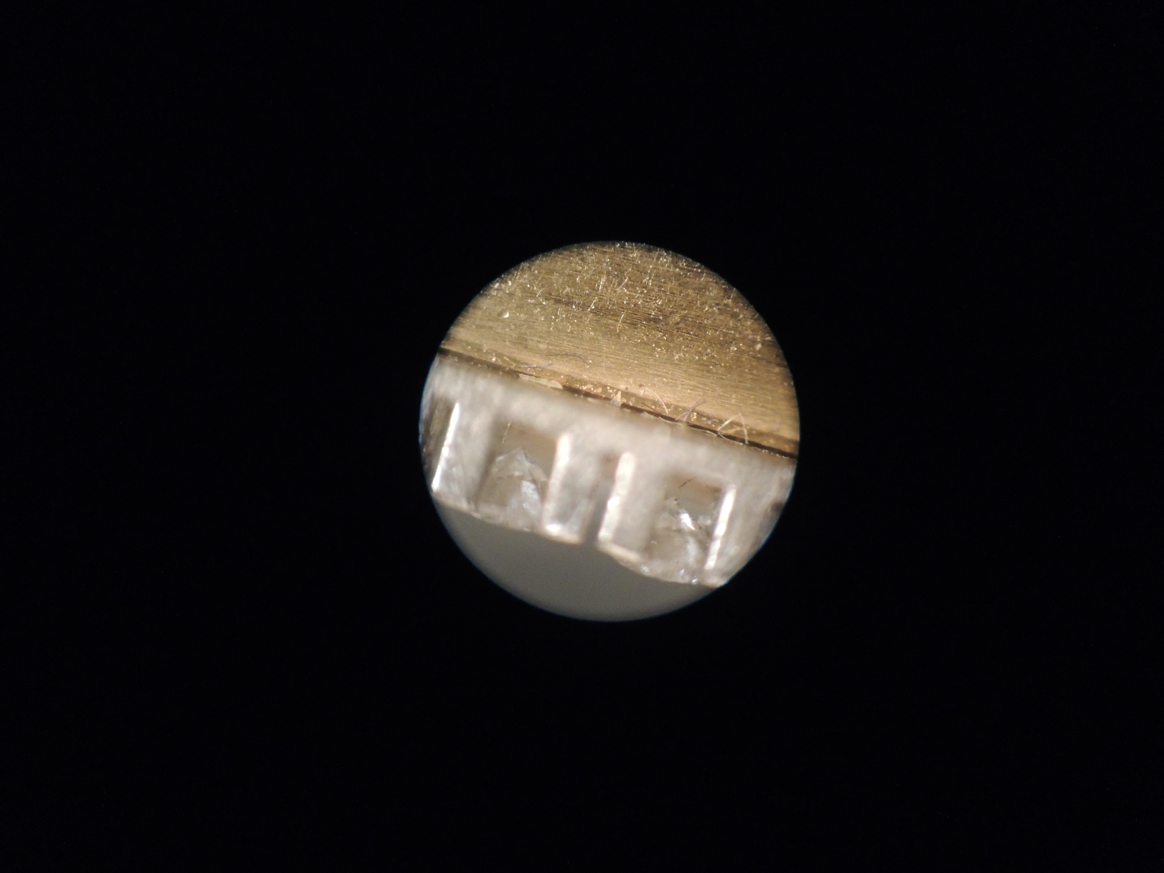

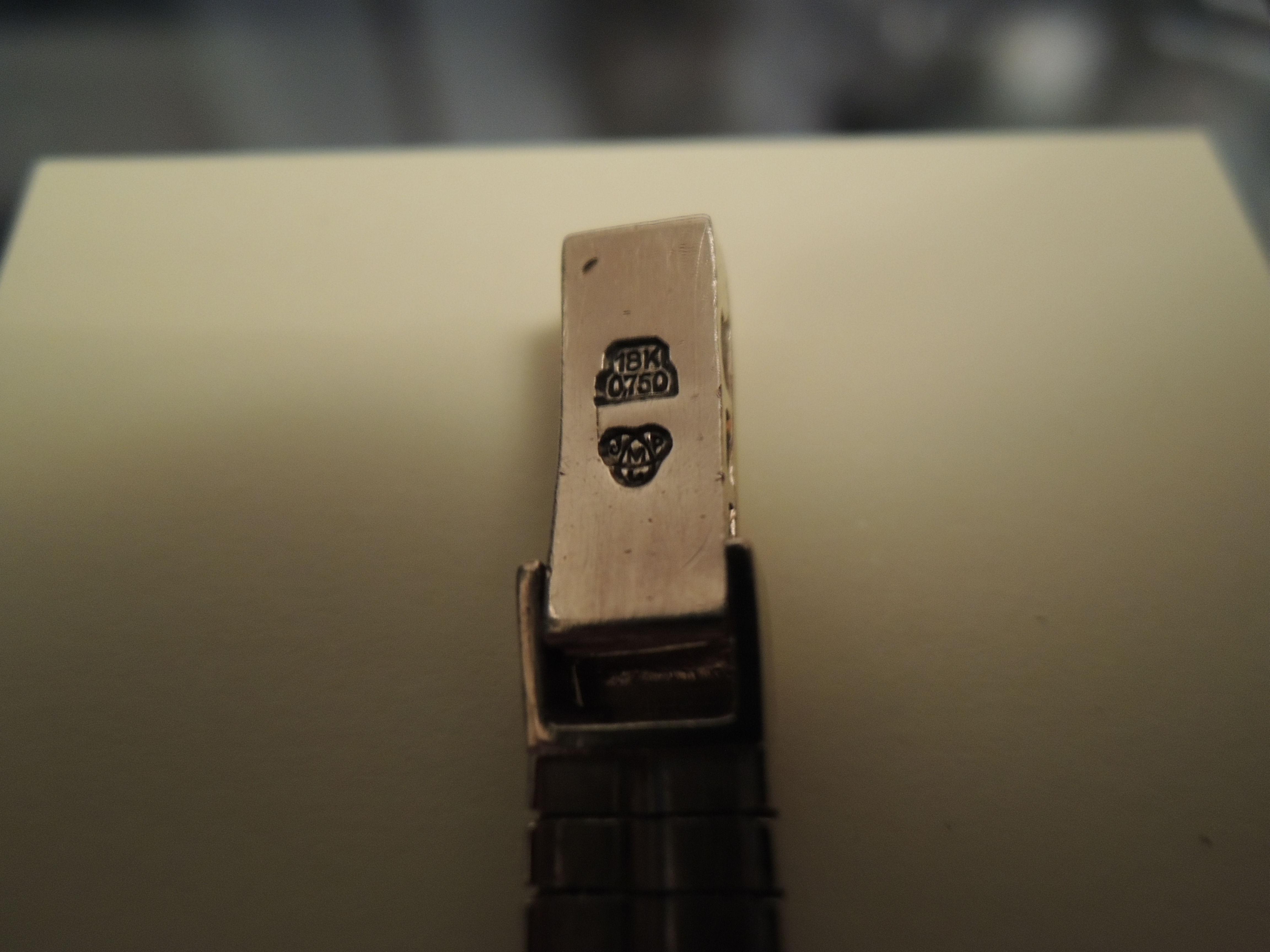

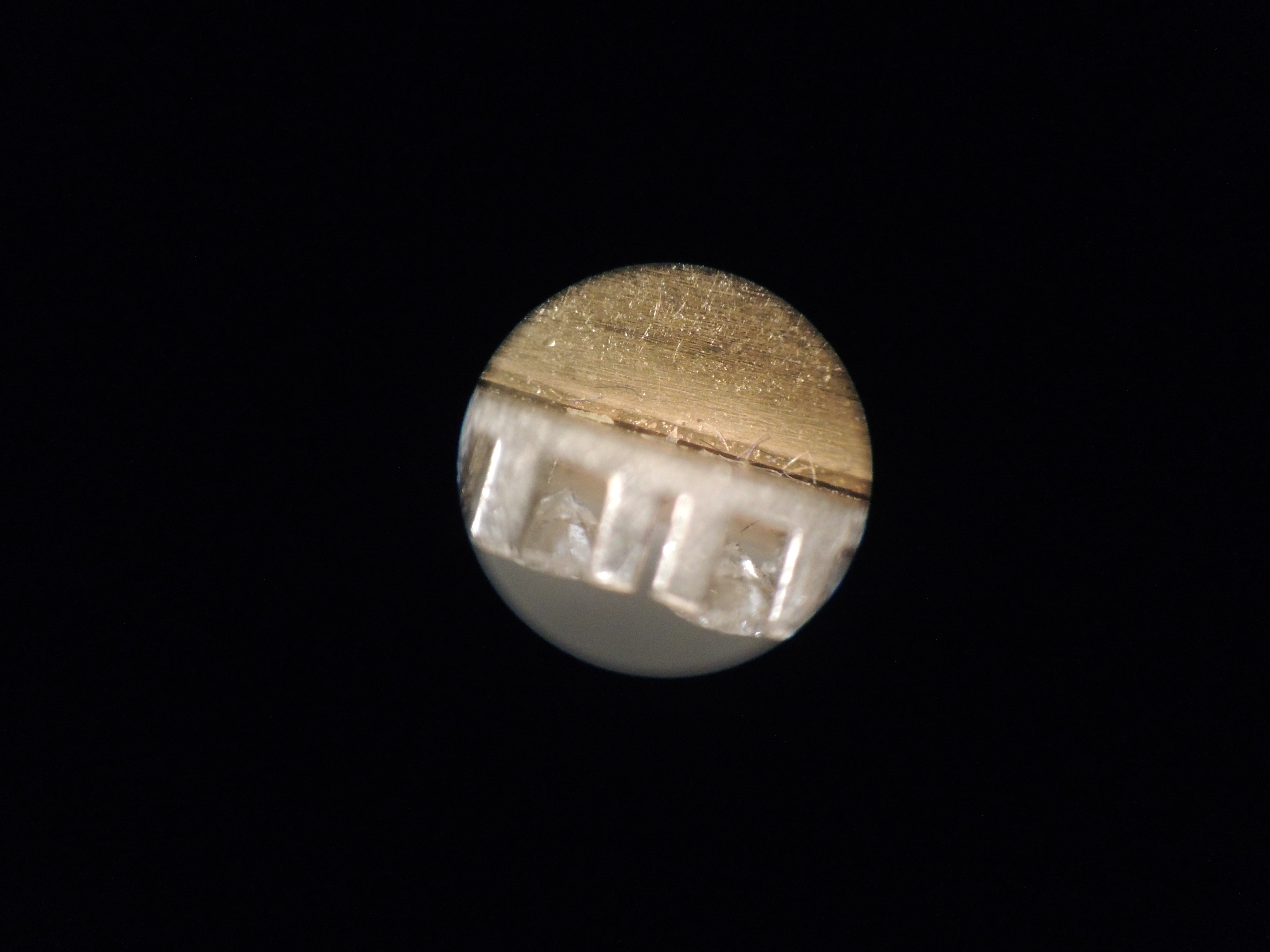

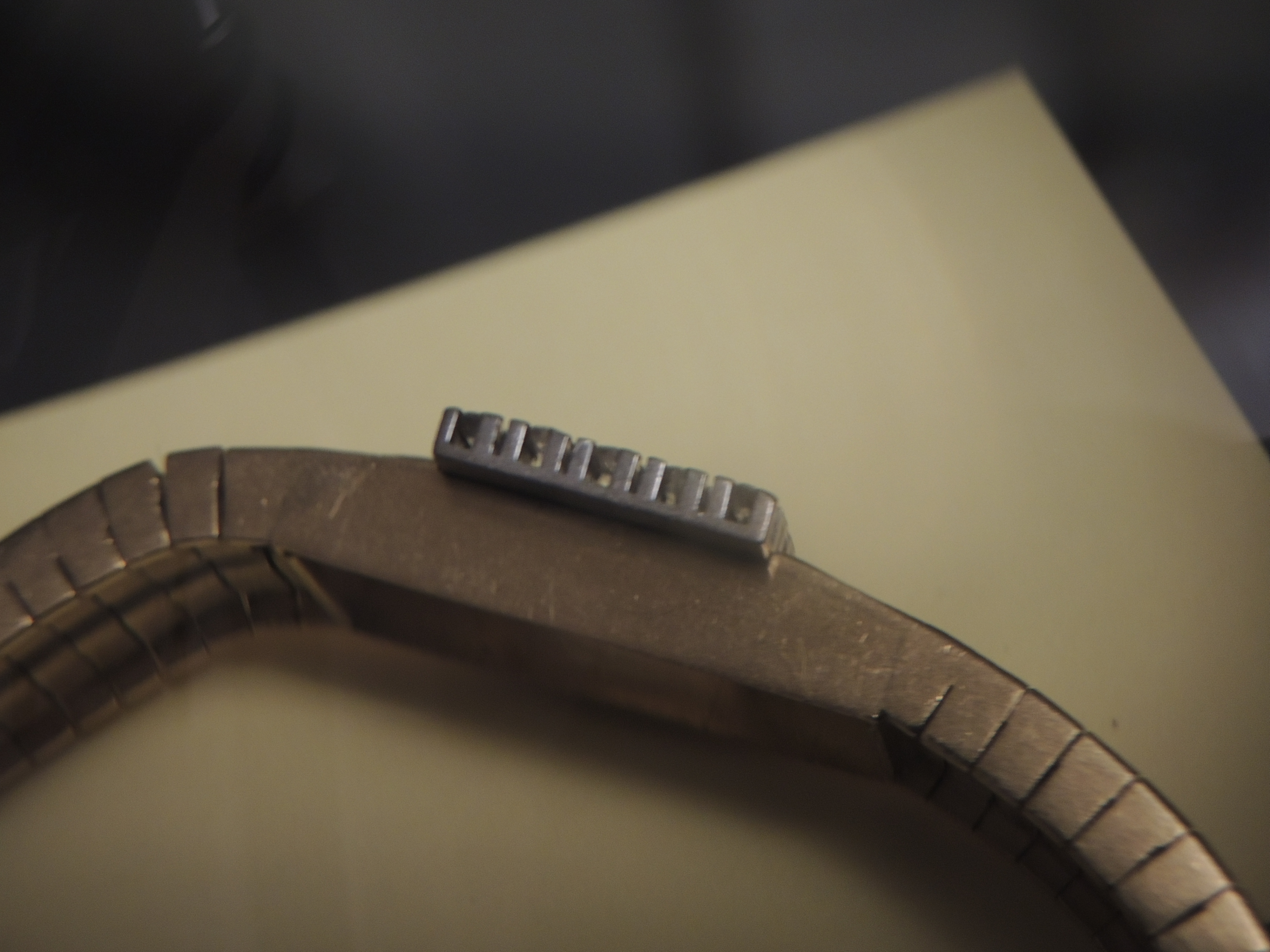

The bracelet is also 18k, a mark (JMP) appears that I assume is the manufacturer's. I put a photo of the diamonds, are they full cut?
15,995
48,111
Your pictures aren’t of high enough definition to help me determine if the diamonds are full cut. I’d lay odds they are, but there’s only one way to find out. Have an appraisal done.

Thank you very much for all your appreciations and advice, they are very useful to me. Thanks to the mark (Geneva Key) that appears on the caseback, I've figured out that the manufacturer of the box is F. Baumgartner SA.
The watch works but it gains 15' in an hour. Why shouldn't I send it to Omega?

Just checked and surprisingly many parts for the movement are still available, so good chances of bringing it back.
No one has mentioned this, and yes just a watchmaker thing, but I think this is the first Omega I've seen with Kif shock protection....at least that I can recall.

Omega doesn't do minimal. They will often swap out more parts than the owner imagines, polish instead of clean. The idea seems to be, make the watch as new as possible. Many owners feel that this destroys the vintage charm & heirloom value.
