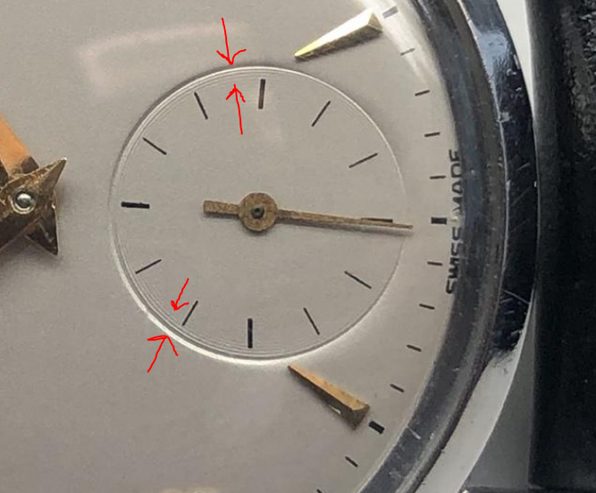

I received this omega reference 2505 in a trade recently and im starting to doubt the authenticity of the dial. The previous owner is not sure of the dial either. So i'm asking you guy's help. Is this a redial?

I believe it to be a redial, but I'm far from an an expert! The middle of the "M" doesn't seem to be on the same like as the edges/legs of the "M".
Additionally, I find the font to be too "thin"

Redial, the sub dial is filled with paint and the rings are almost gone.

Yeah that's what I was mostly concerned of. All the other markings seems consistent imo. Thank you!

Yes, the sub-dial is the most obvious clue in this case.

Dial is real. Just refinished. I think it looks fine Everything seems to line up OK.
Small second hand could replaced. Snip with a pair od sharp scissors

ss hand seems to line up with other examples and the hand set seems to be fit together both in the aging and the color, so i dont think theres any issues with it

As noted, the seconds hand is too long.
