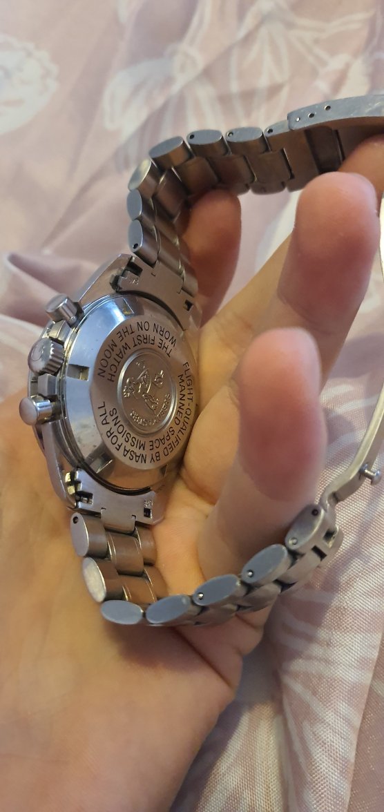

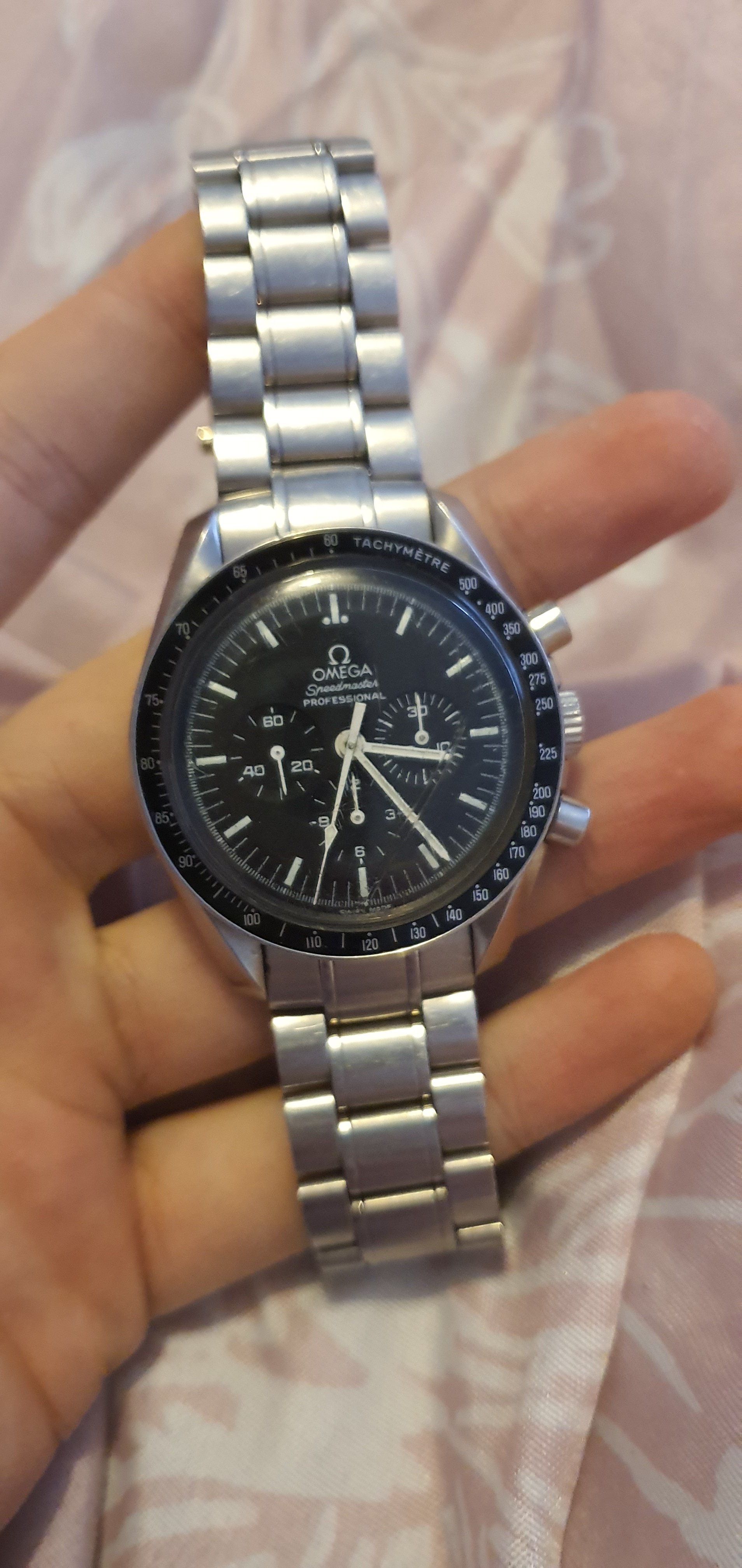

Hello all,
Recently bought a speedmaster 3570.50 off ebay was described as not holding a charge, lasts 8 hours, but everything else is fine...
Anyway I've received the watch, and doesn't seem to hold charge for even 20 minutes, also pressed the chronograph button, chrono worked, then stopped the chrono, went to press the reset chrono pusher... didn't snap back, pusher doesn't click, and get no reset.
Go to start the chronograph again and now the chrono start doesn't work pusher seems jammed and doesn't even want to push in, moves a little bit, but that's all.
Anyway, getting to the point, I'm in fear that this is obviously going to cost a lot more than expected.. didn't mind getting it serviced.. but now I'm really worried as this is my first 'premium watch' and got a good deal on it (probably to good to be true in retrospect)
Just wondering if anyone has any idea of what the problem may be, and also how much a independent might charge to fix it, also if omega set service price of £630 includes all inner mechanical parts? (Common sense says probably not..)
Thanks for all the help in advance

Hello, also now noticed that when I tilt the watch in a side to side motion, the chronograph hand moves about 2 seconds..
Also it does seem to somewhat hold a charge, when the second hand stops (small dial at 9 o clock) if I pull out the crown, it will start again.
I can also hear an audible tic tock from about 6 inches away, don't know if this is normal?

If you wound it for 5 minutes then I'd suggest you have a broken mainspring.
The best thing you can do is get it to a watchmaker ASAP.
As it's not a classic "vintage", sending it to Omega for a service/repair would be an option.
Otherwise STS or other companies with access to Omega Parts Accounts would also be OK.
