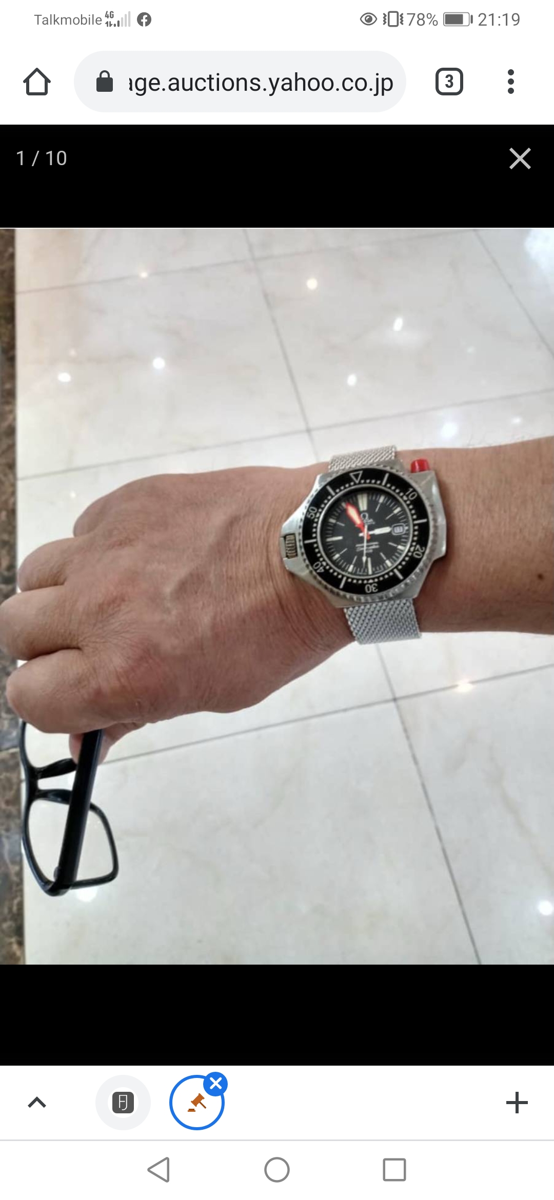

Hi all,

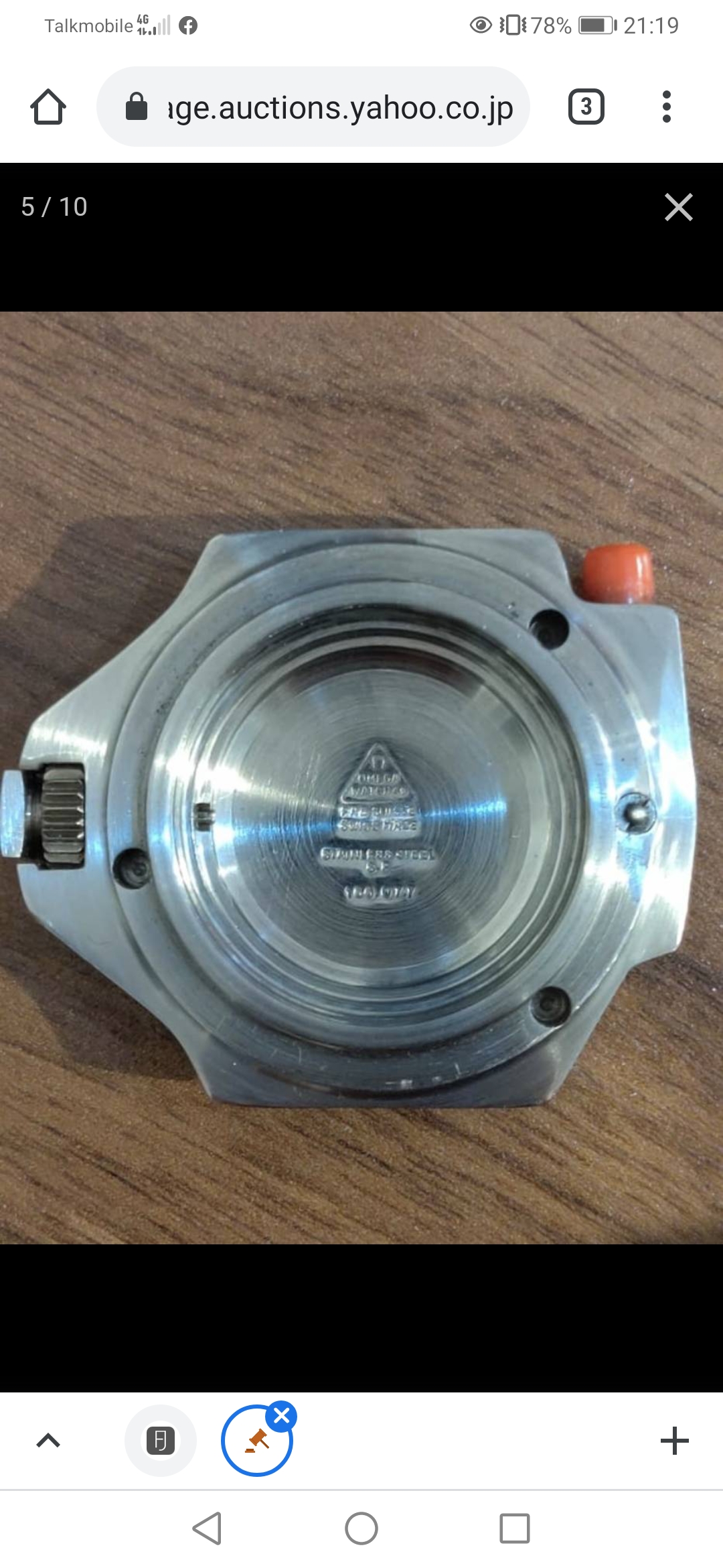

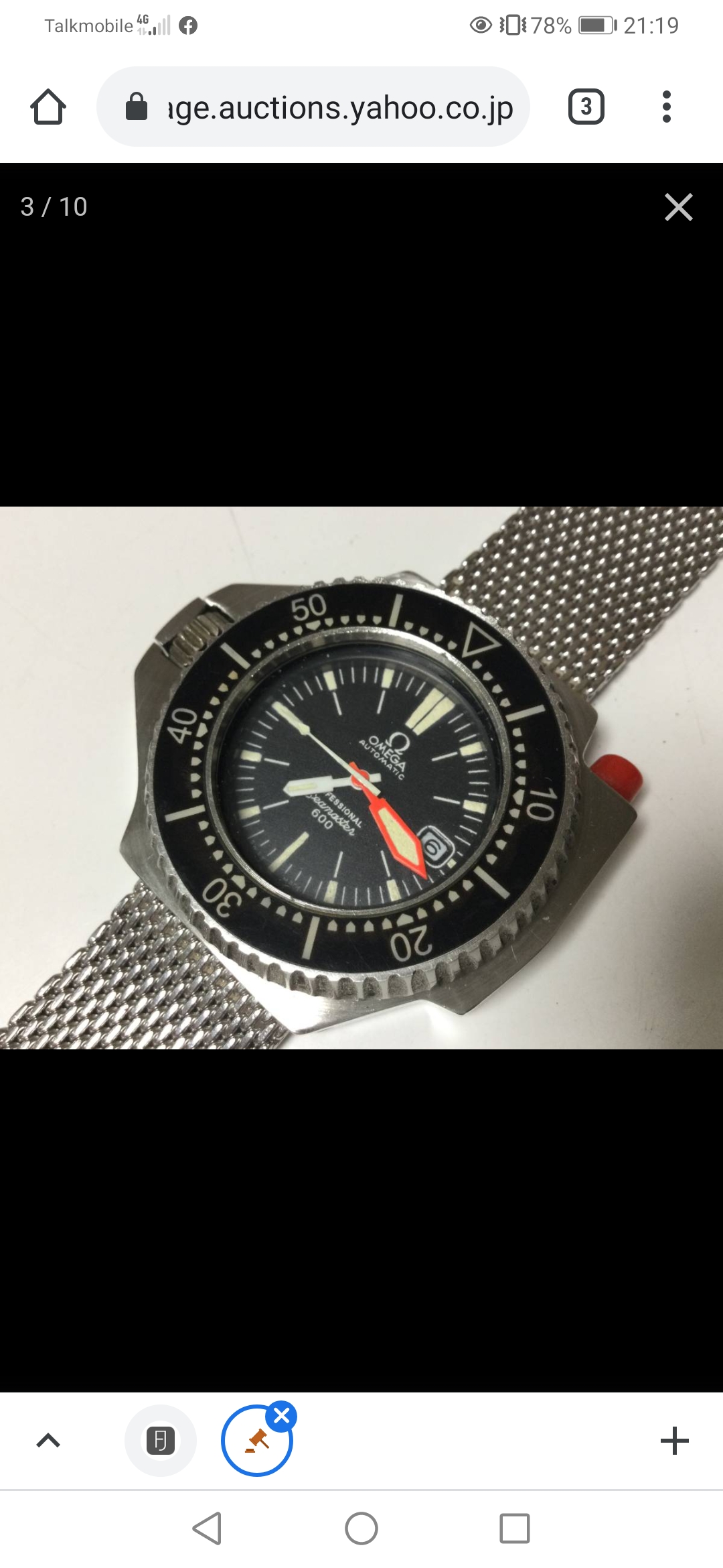

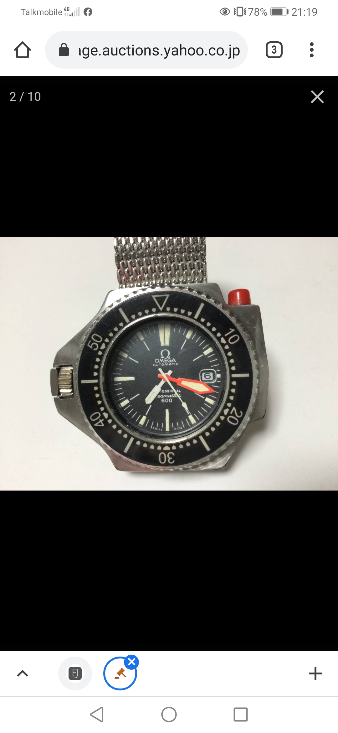

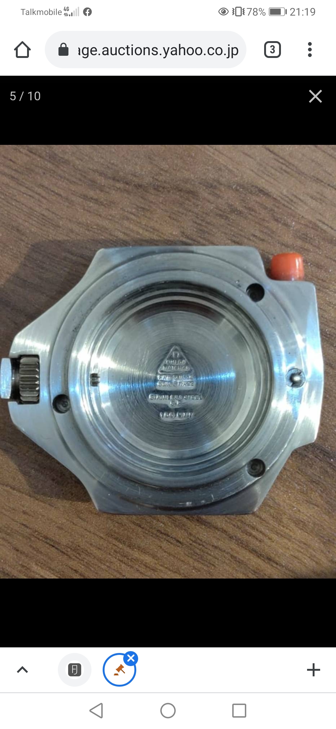

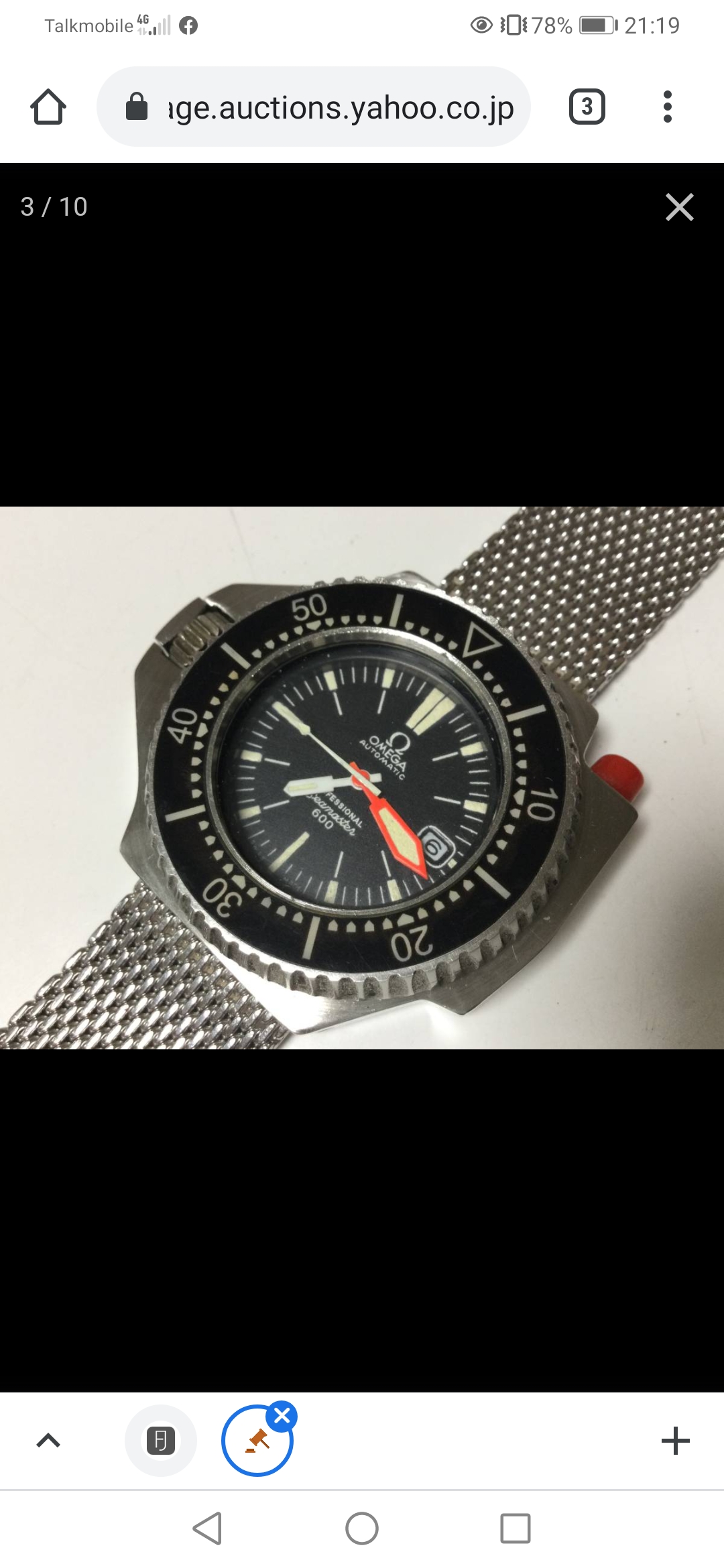

I know first posts shouldn't be fake or not threads but I don't have much choice when I could be lots of money down the loo... I bid and won on a Ploprof on Yahoo Japan and missed some tell-tale signs that it's probably a fake, or at best, a franken watch.
The two main signs are the second hand, not boxed, and the poor quality of the bezel edges and bumps and dips not being uniform. I've started proceedings with the Proxy company and also Visa but both really aren't interested too much... I've also emailed Swiss Time Services here in the UK now who have kindly said they will have a look, using these same pictures, and let me know what they think.
I'd say currently my best case outcome would be that it's a frankenwatch and if I can get replacement hands during a service, that may have to do. I doubt I'll get a replacement bezel if needed and I bet they're much more than the hands. Worst case, it's all crap and I'm down lots of money....Please let me know what you think.

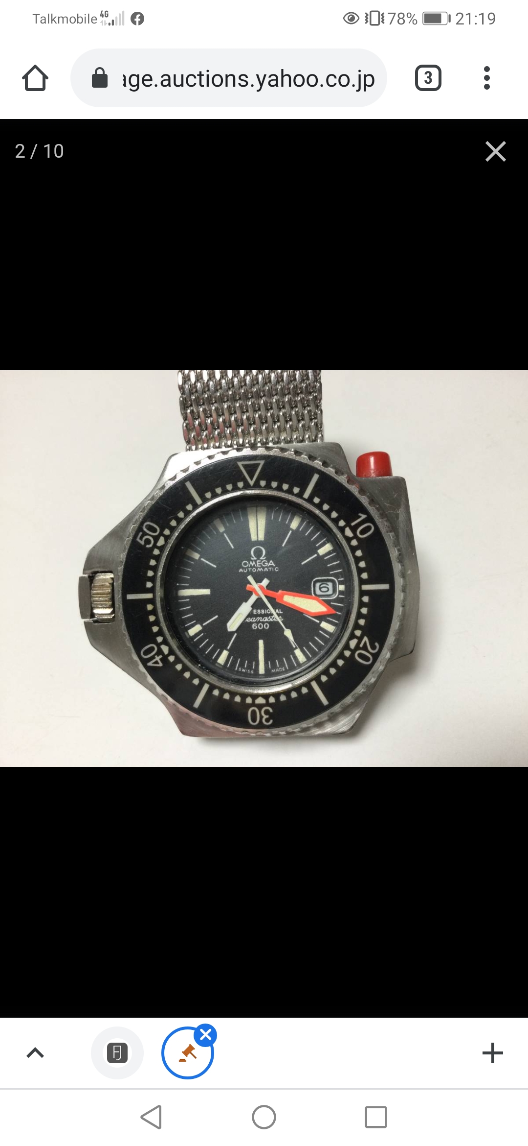

Welcome to OF. I am not a specialist for the movement, so there will be answers to follow.
1st I doubt the seconds-hand. 2nd the lines of the triangle (bezel) are quite slim 3rd: which confirmed reference did you buy?
atb, Jo

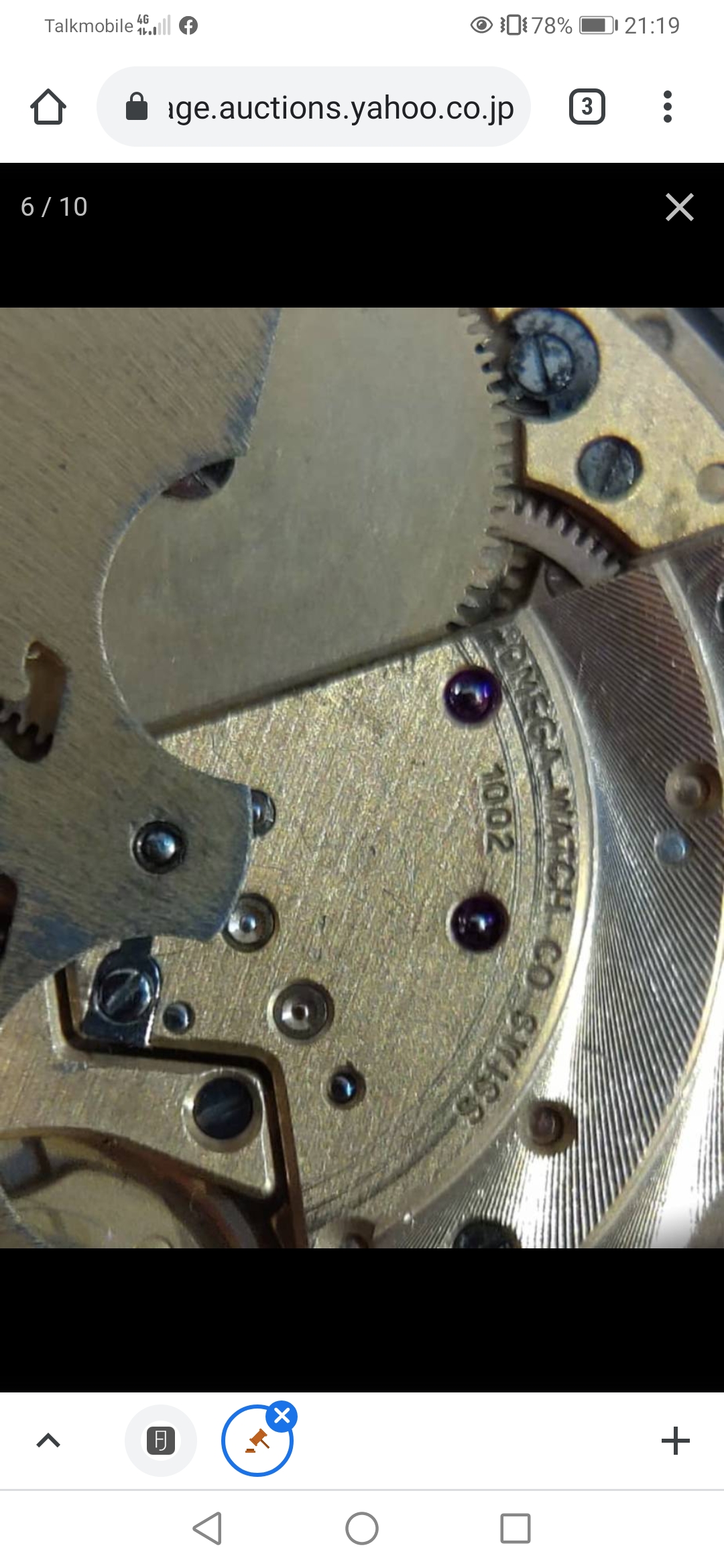

Sold as a 166.077 with a cal.1002.

Your pics. or seller's pics ? Sellers name/ID? You see, that the hands are glossy painted Orange. That dial is not ok. Is the crystal sunken in a lot in regards to the bezel surface ? If so, remove the bezel and you will find, that the screw in crystal threaded ring will not fit and not one rubber seal is present......have seen that before. Hopefully I'm wrong.....

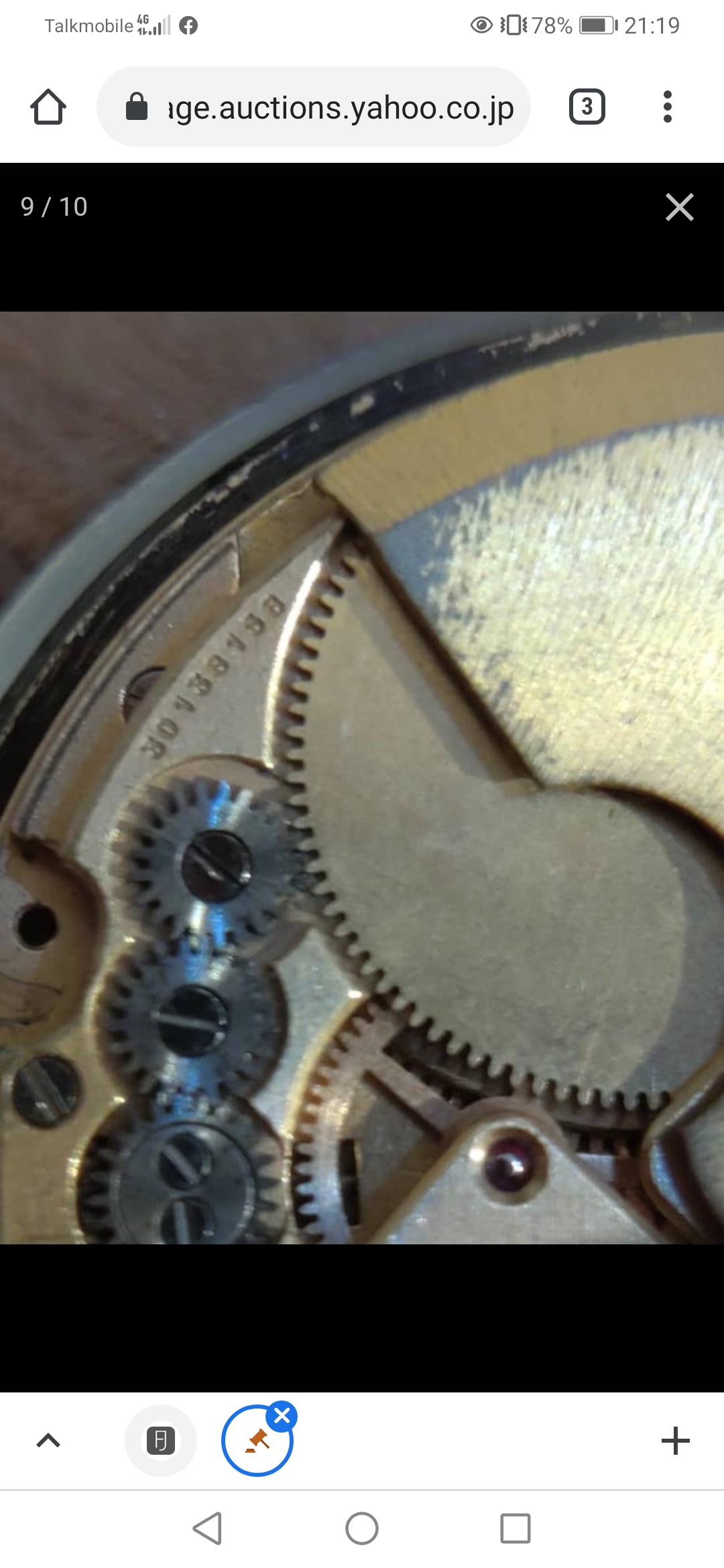

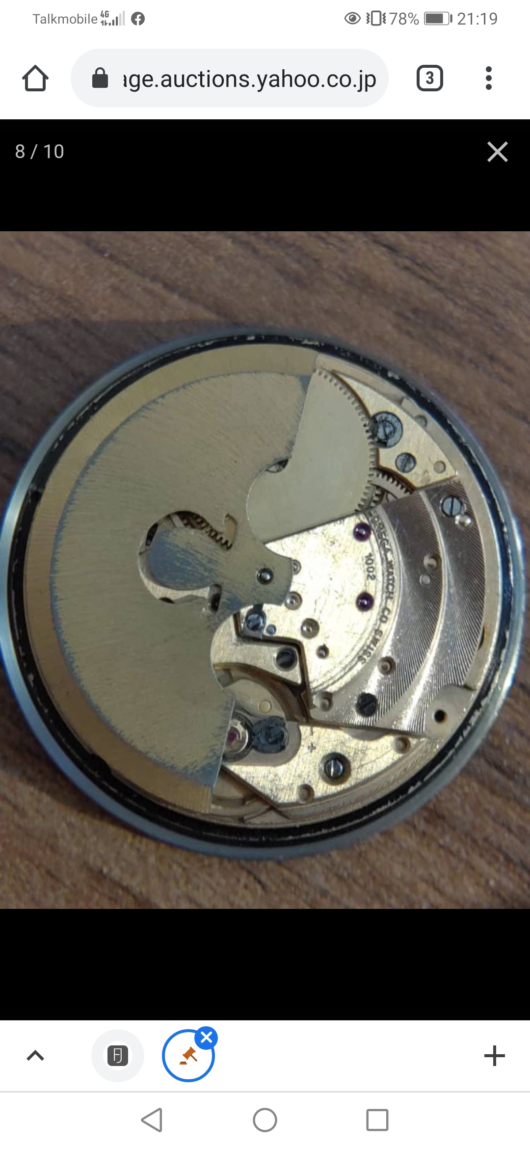

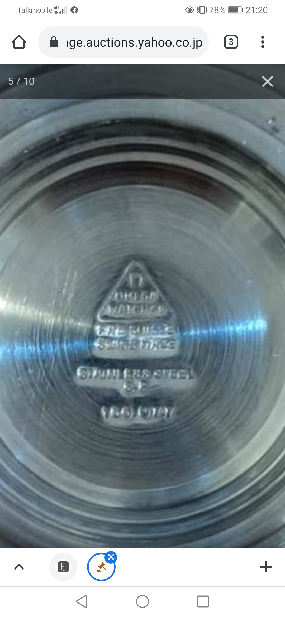

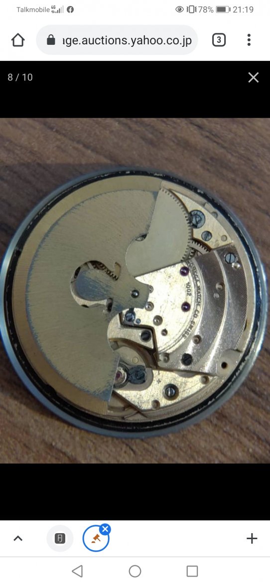

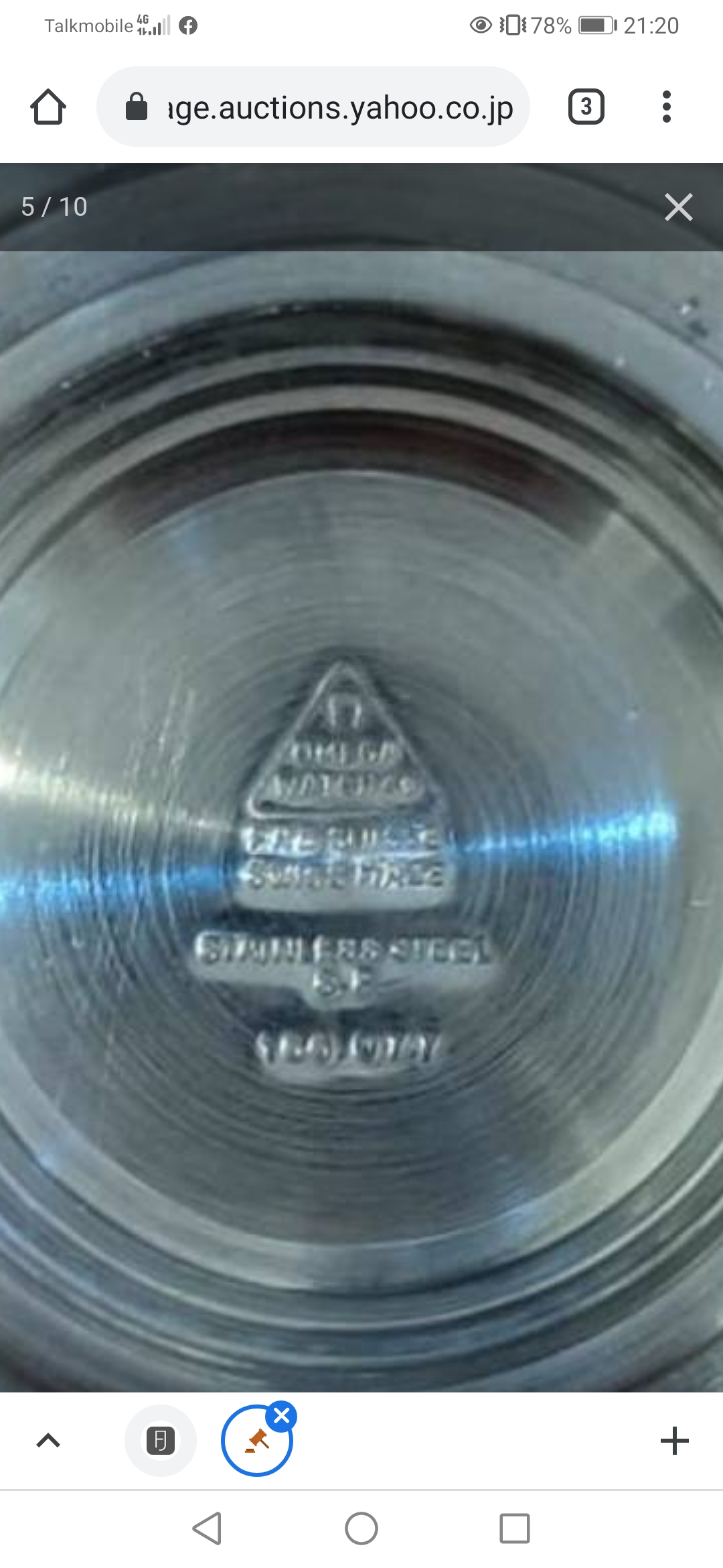

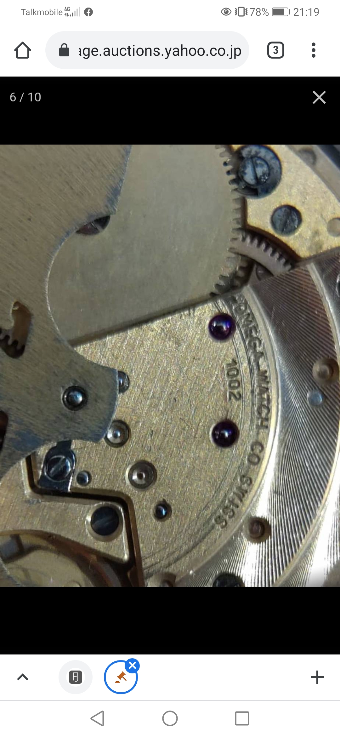

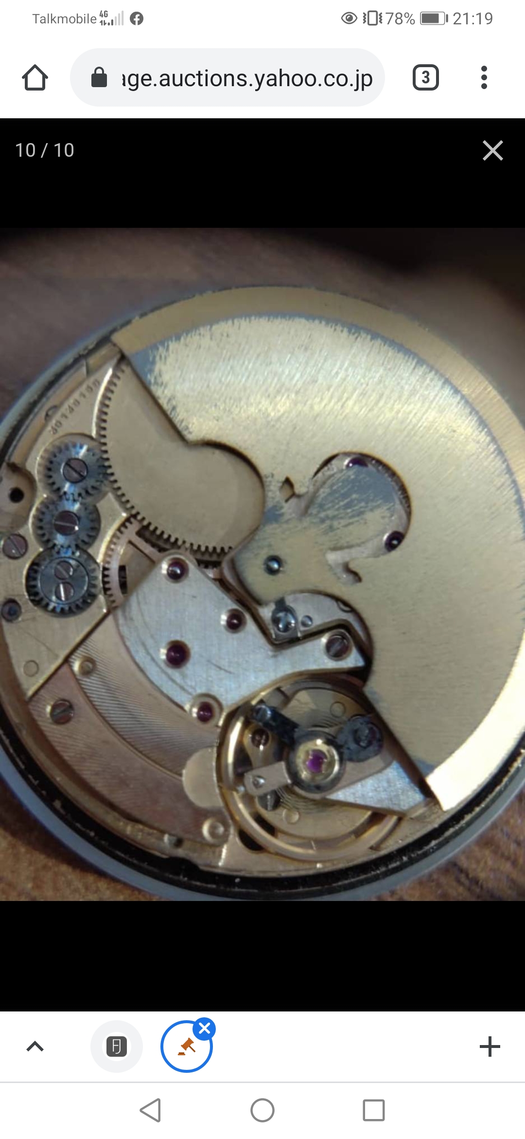

I am sorry to say that case looks very fake. Sloppy case stamp, bearing holes look to big/close to the bevel edge. The bracelet is not omega and the movement is too early for 90% of ploprofs. Dial is also not Omega. I hope you can get your credit card to cancel and stop the purchase now.

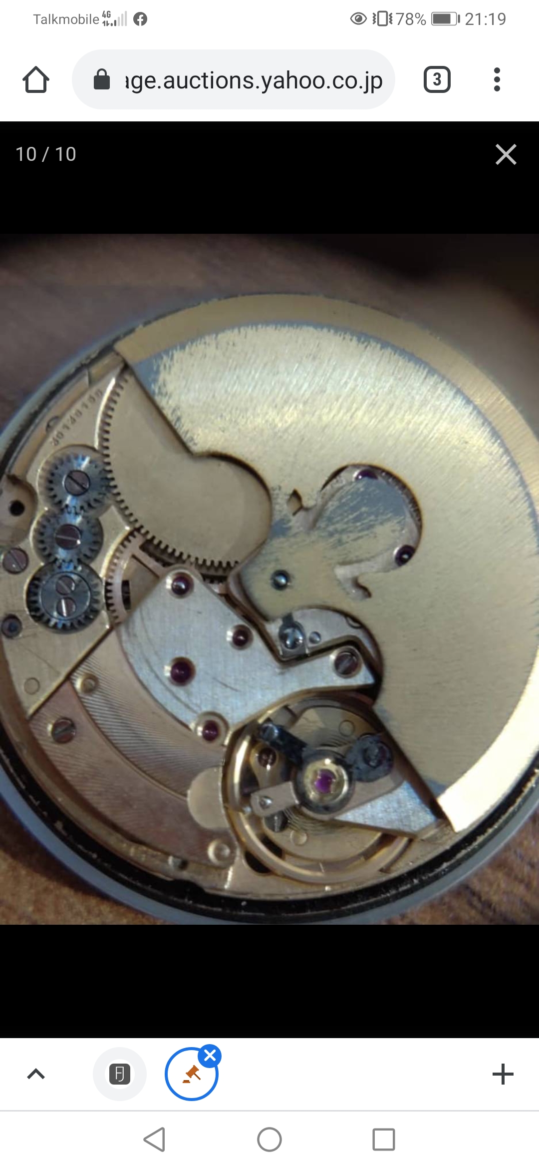

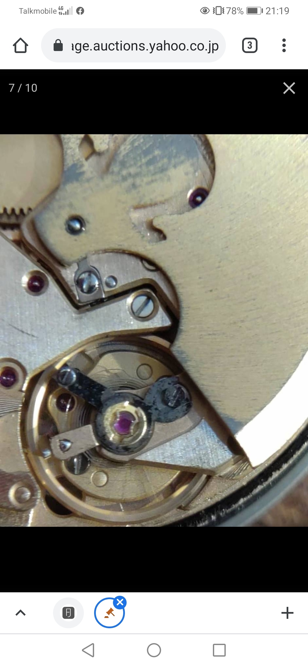

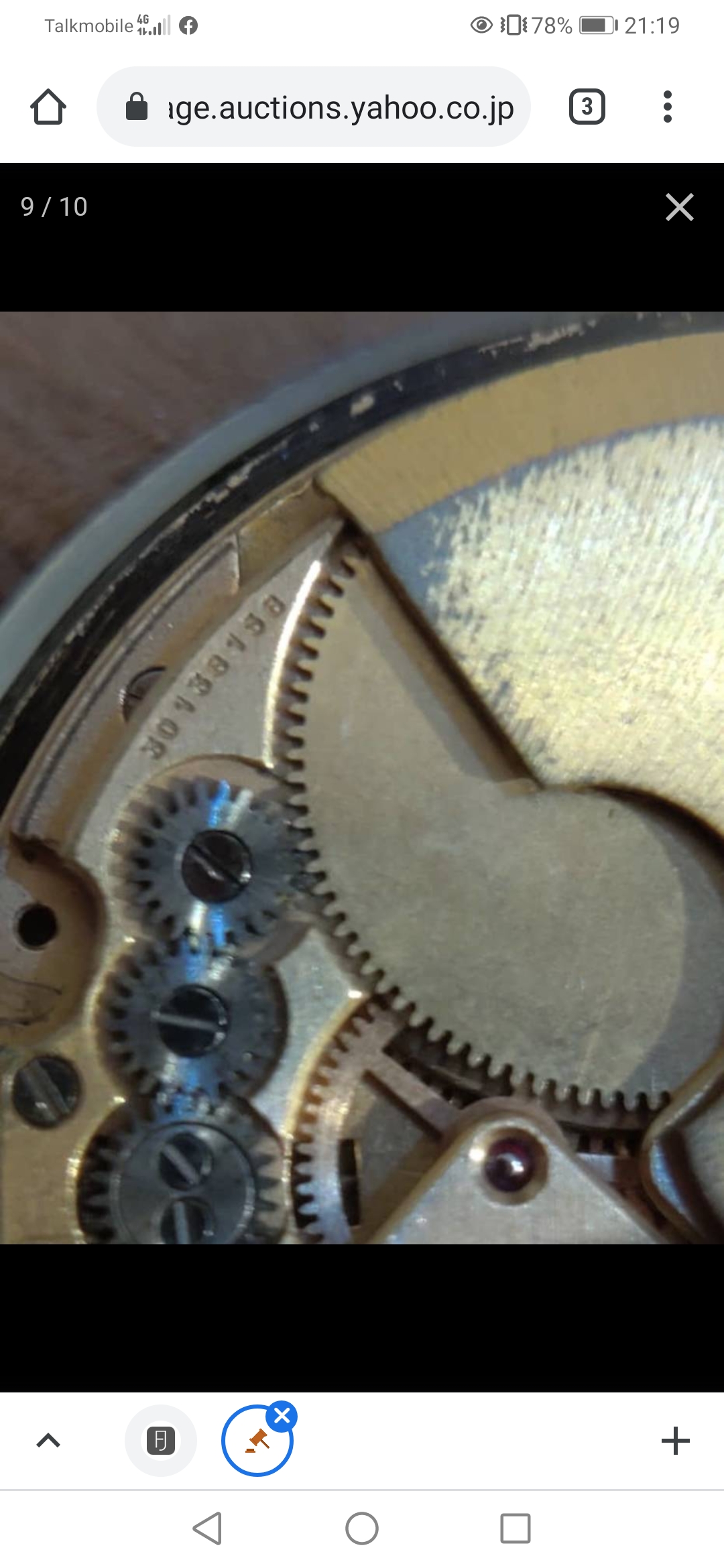

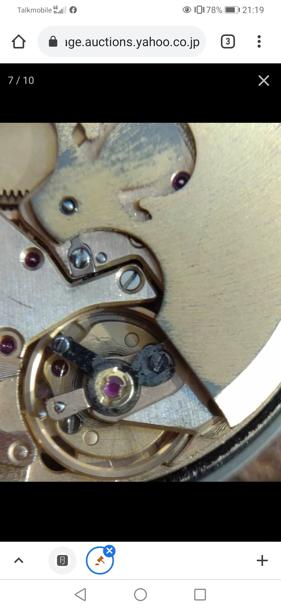

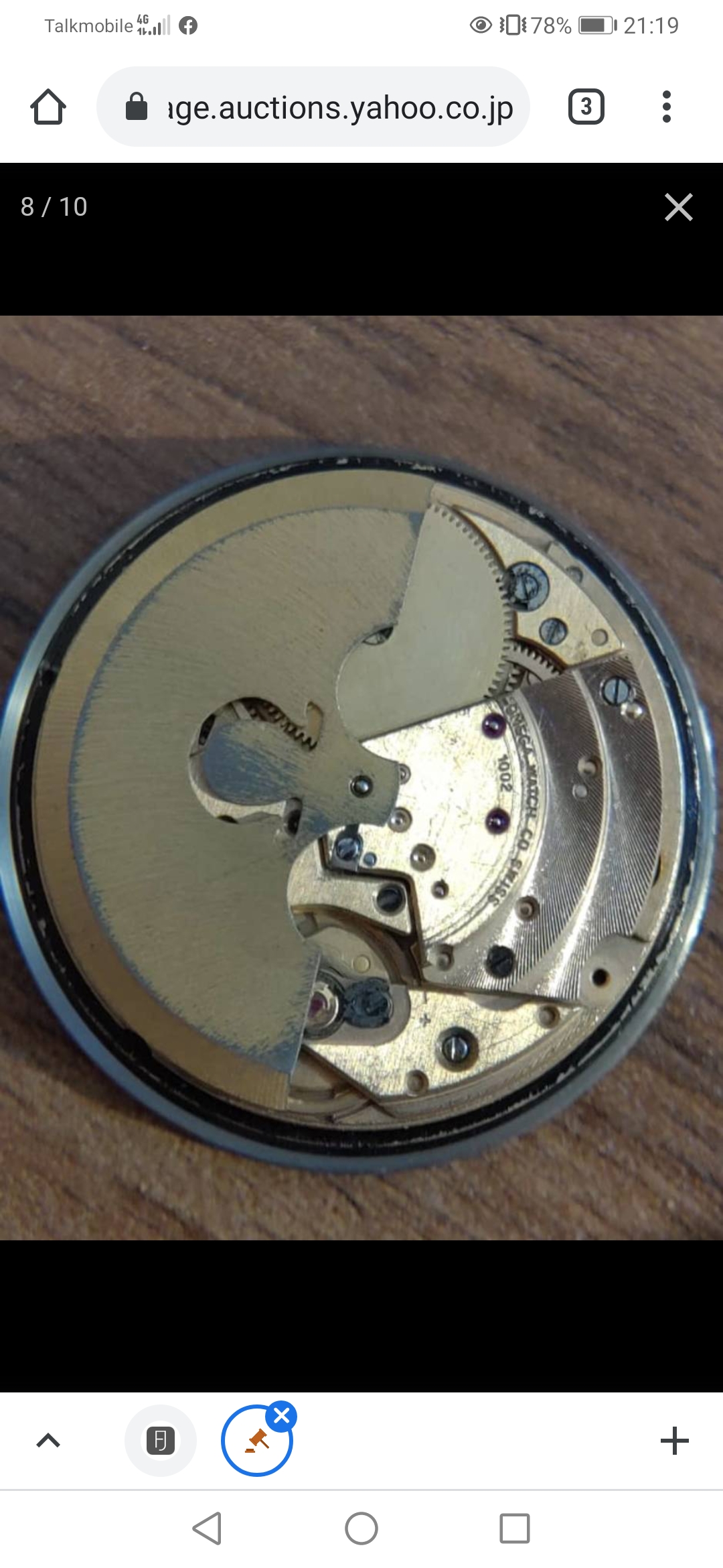

what simonsays..... you will find your example in the watchuseek link above. the case stamp says it all. just label it a fake and get your money back from the credit card company. tell them, you will report to the police . and, again, who is the seller ? his auction ID pls. 5 (!) movement close ups with a mvmt. number that might not show up in the EoA as a PLOPROF number. all detailed. out of focus case inside ...... no side shot from the bezel in focus.....
