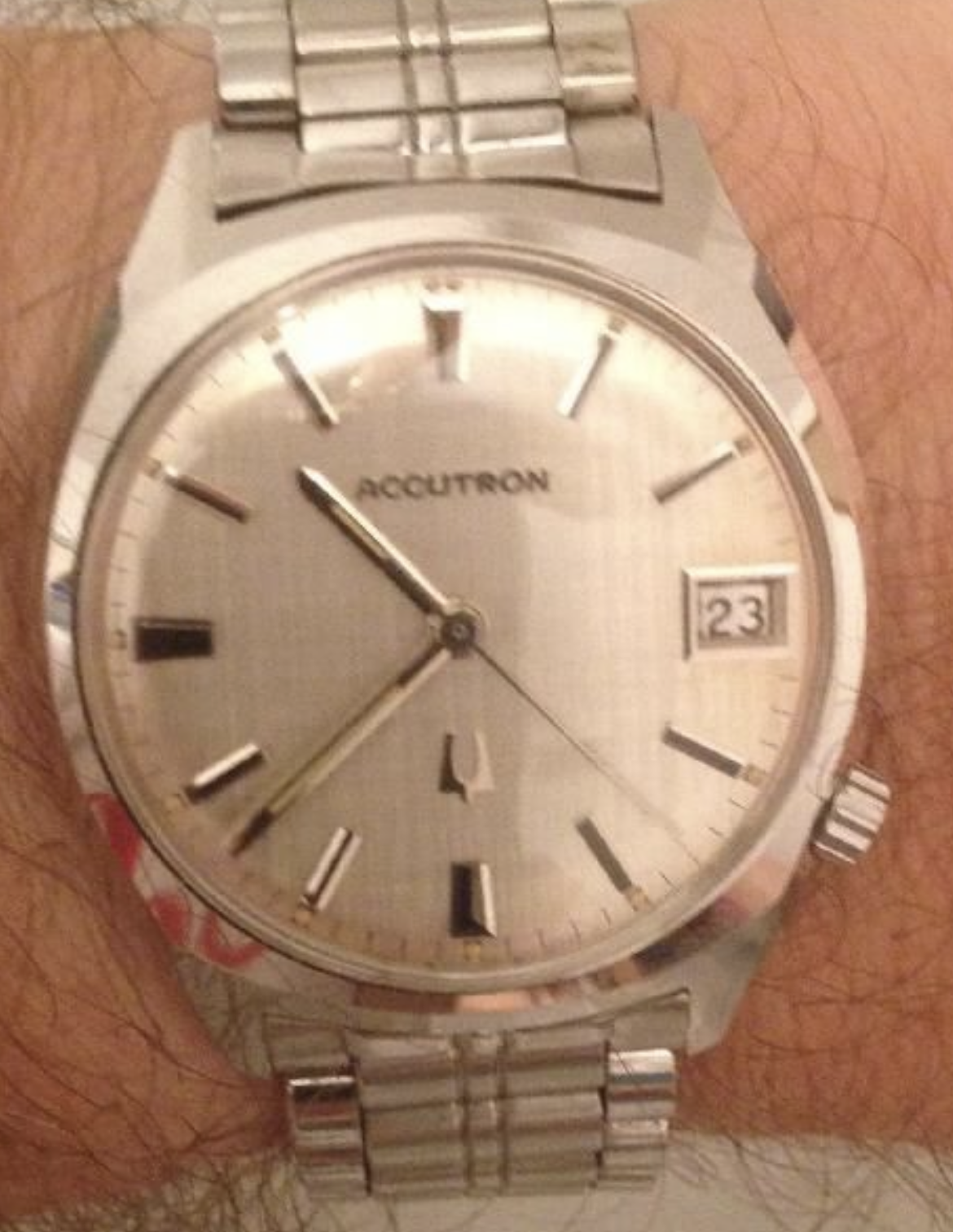

Highly doubtful the watch is that old.
These linen dials were fashionable in the late 1950's through the 1960's. So probably around 60 to 65 years old, but could be a bit younger. I have a Bulova Accutron from around 1970 with a linen dial.
I would have it checked out again. Even less expensive movements should be capable of better timekeeping.
