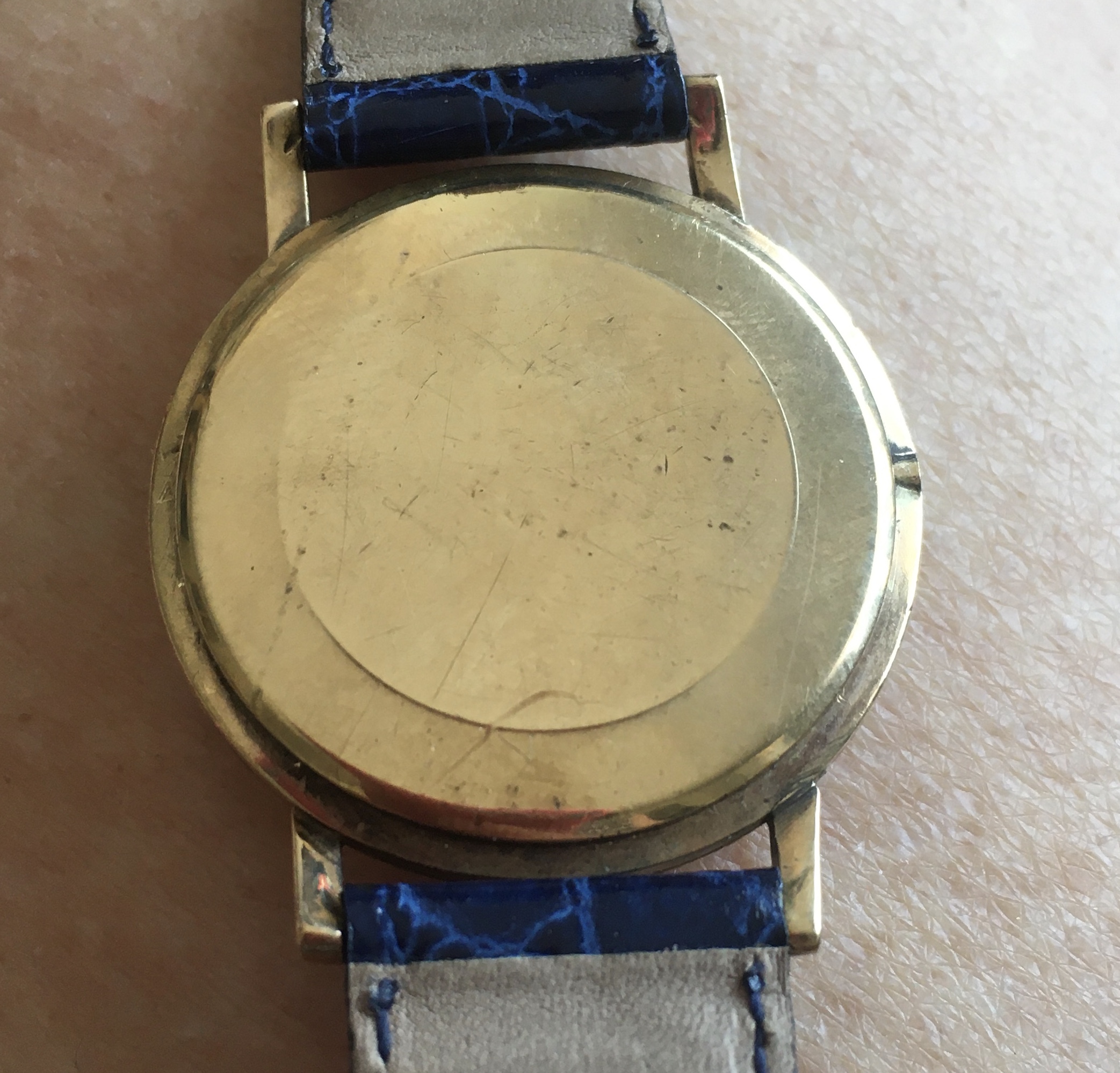

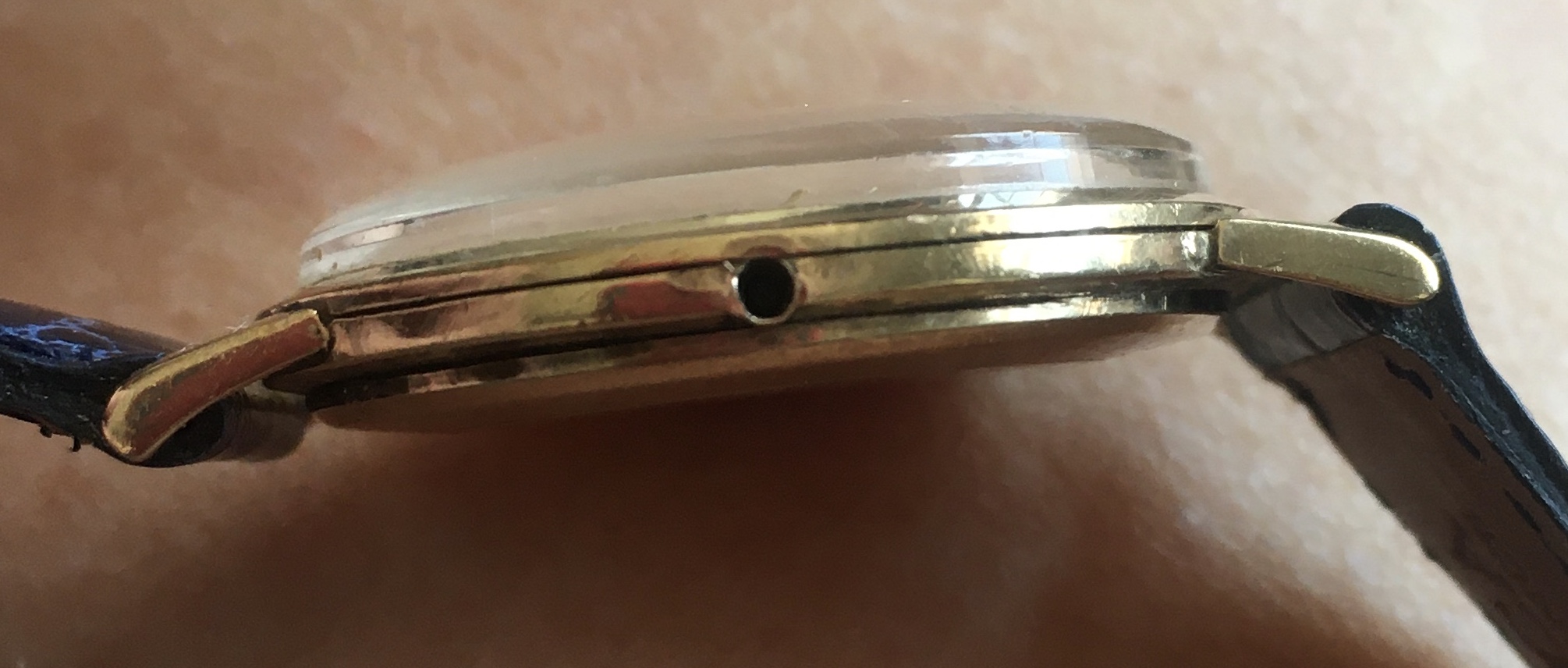

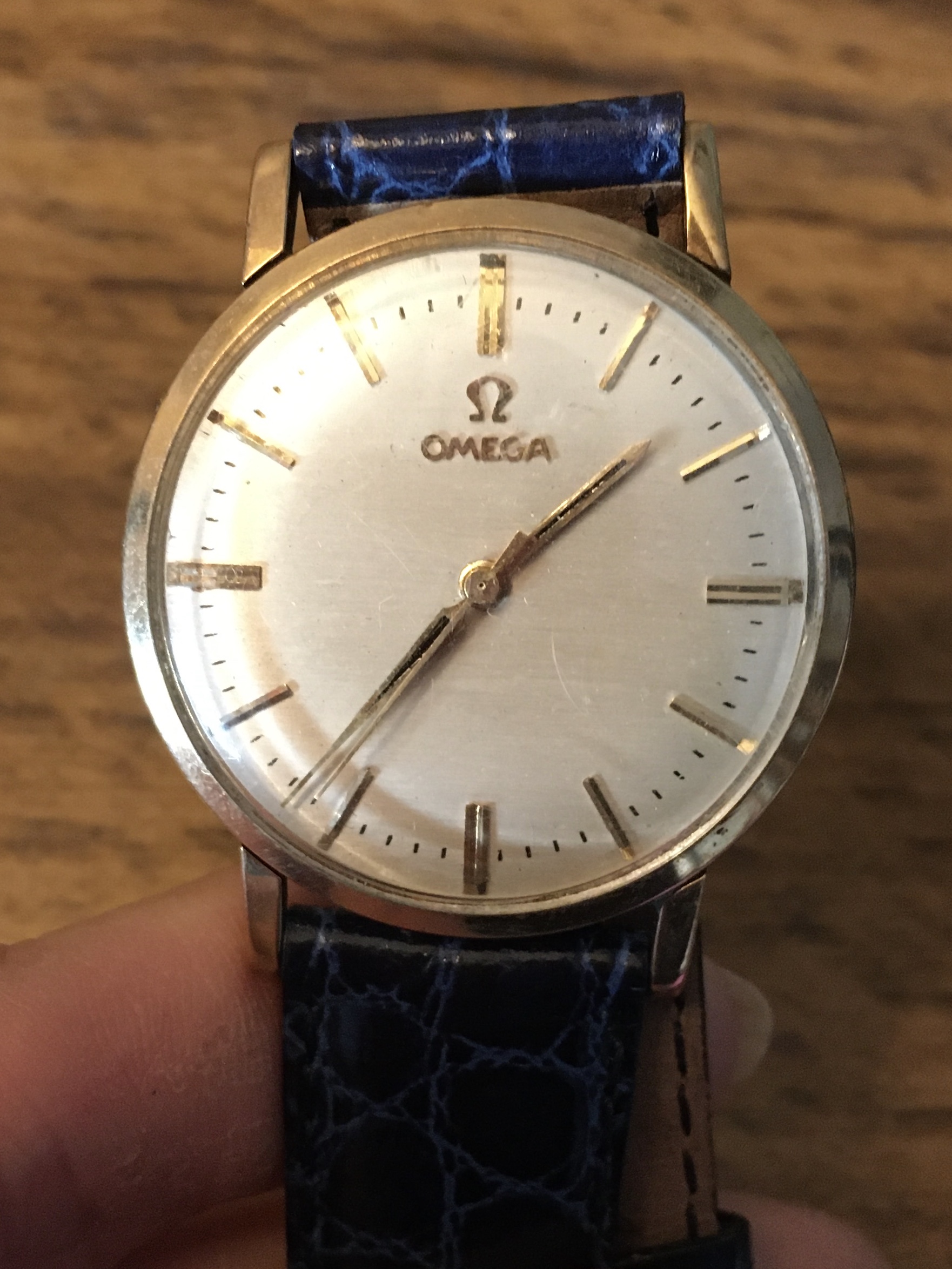

Hi there, here is mum Dad’s watch that was given to me after he died in 2002. He found it in the 80s in a changing room, and after handing it in, had it returned to him as nobody claimed it.
I bought a new strap as the brown leather one was worn. I don’t know what the original strap was.

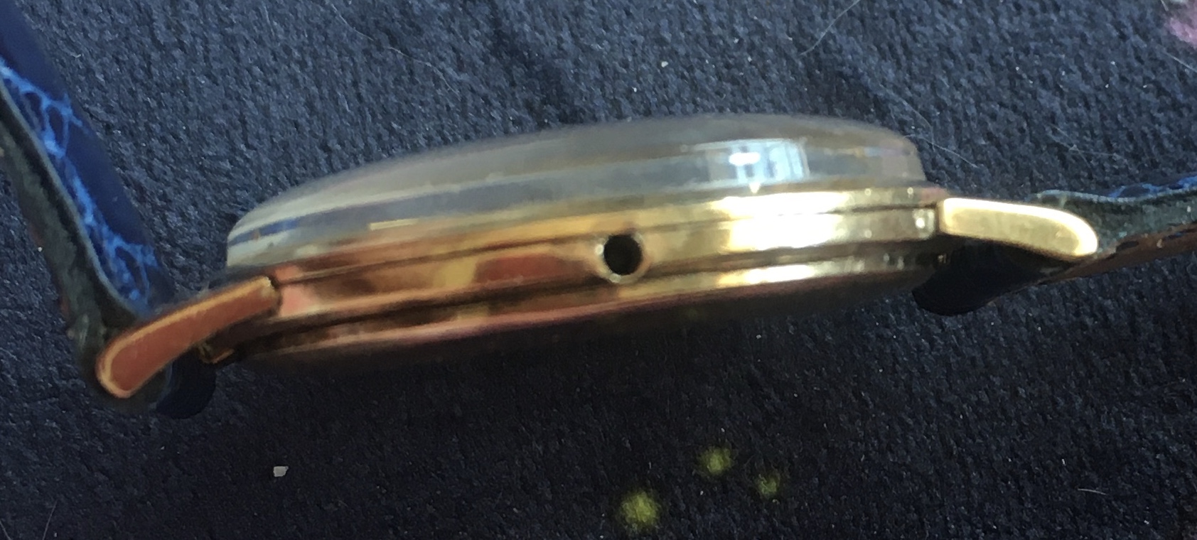

My brother went to wind it and the winder came off in his hands, I saw it happen so don’t think it was over wound, but can’t say for certain. (I have the winder safe).
I wondered if anyone could tell me nything about it please? Does it have a specific name? Value when working?
Also, I obviously need to get it fixed/restored, so was hoping some advice could be given on that as I’ve heard horror stories re Omega? I live in Lincolnshire if that helps.
Thanks a million, Sarah

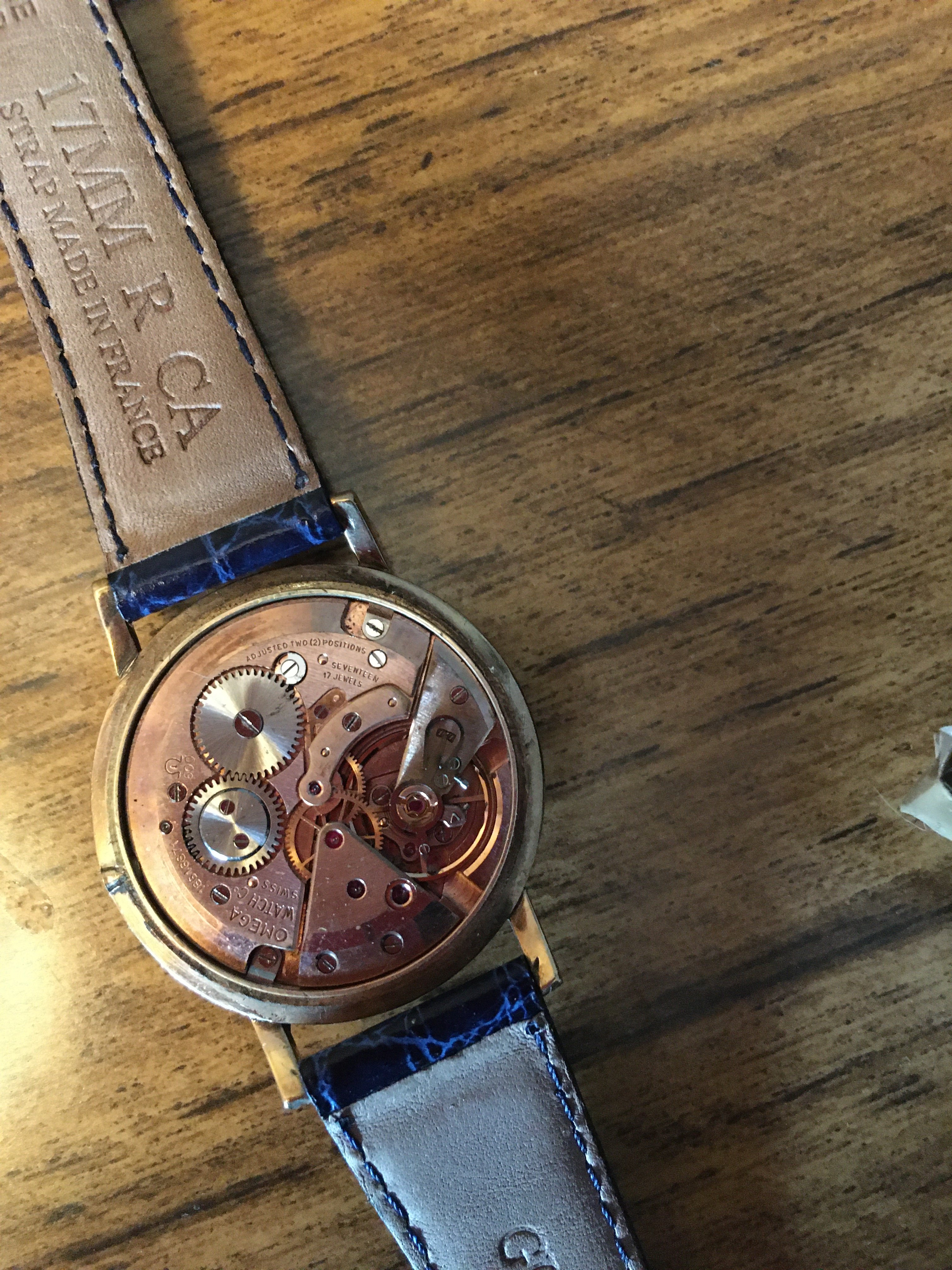

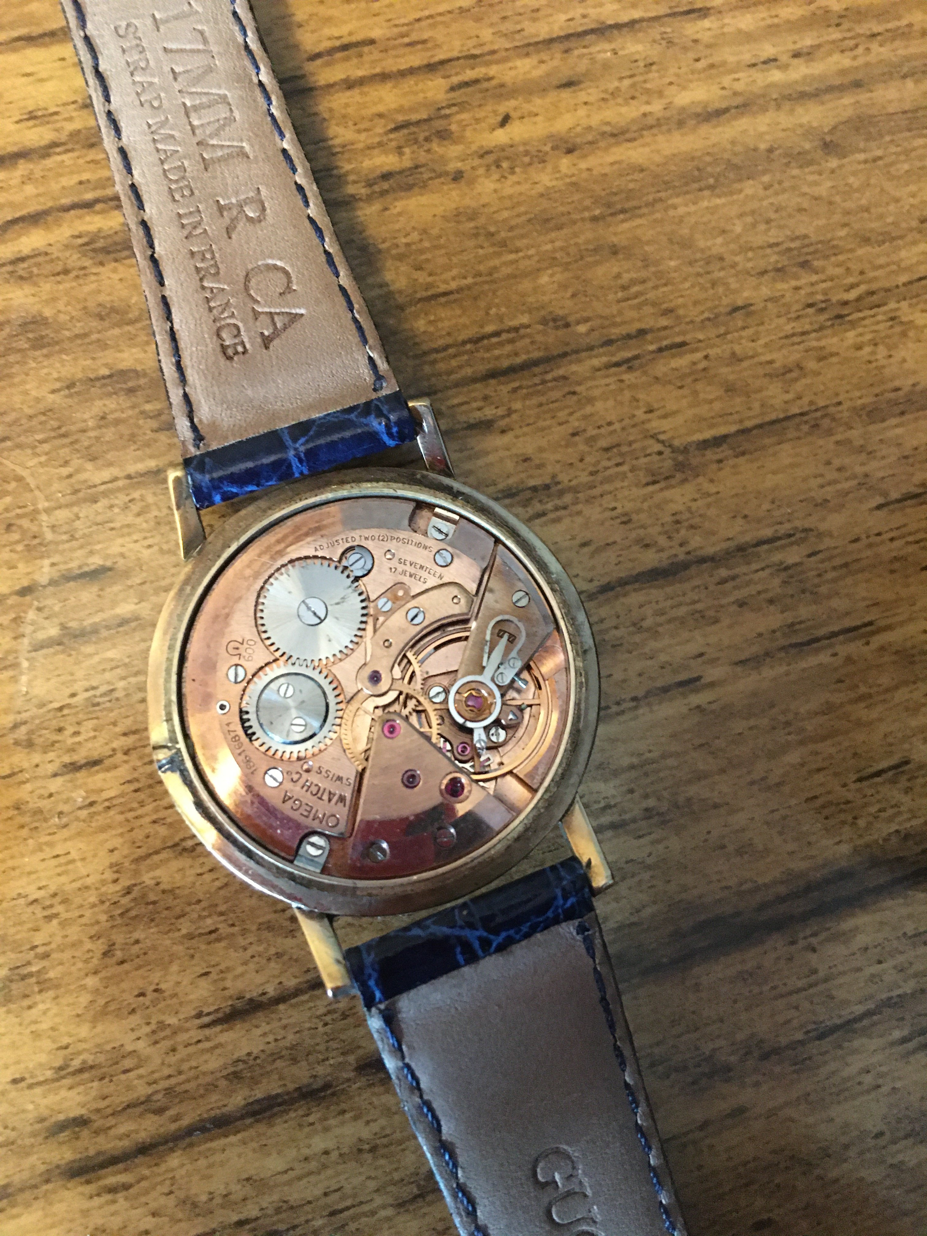

Omega licensed local companies (in places like the UK and France) to produce precious metal cases for them (it was all about import tax)
yours is an English cased 9 carat gold watch made in London.
Date letter for around 1961, which ties in nicely with the serial number on the movement.
It has a calibre 600 manual wind movement.

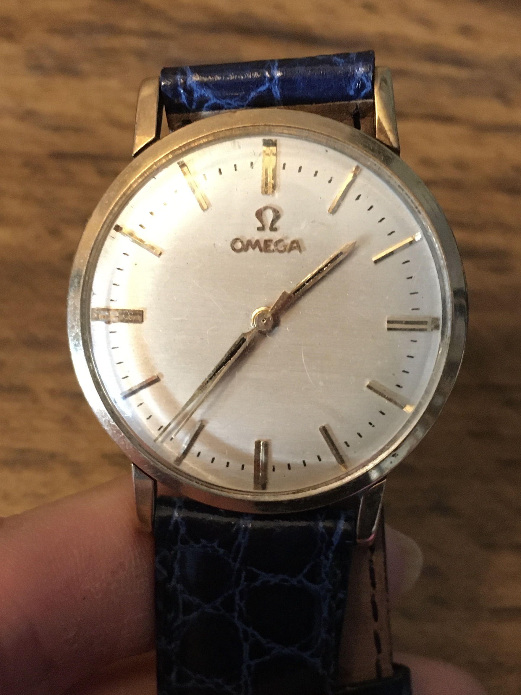

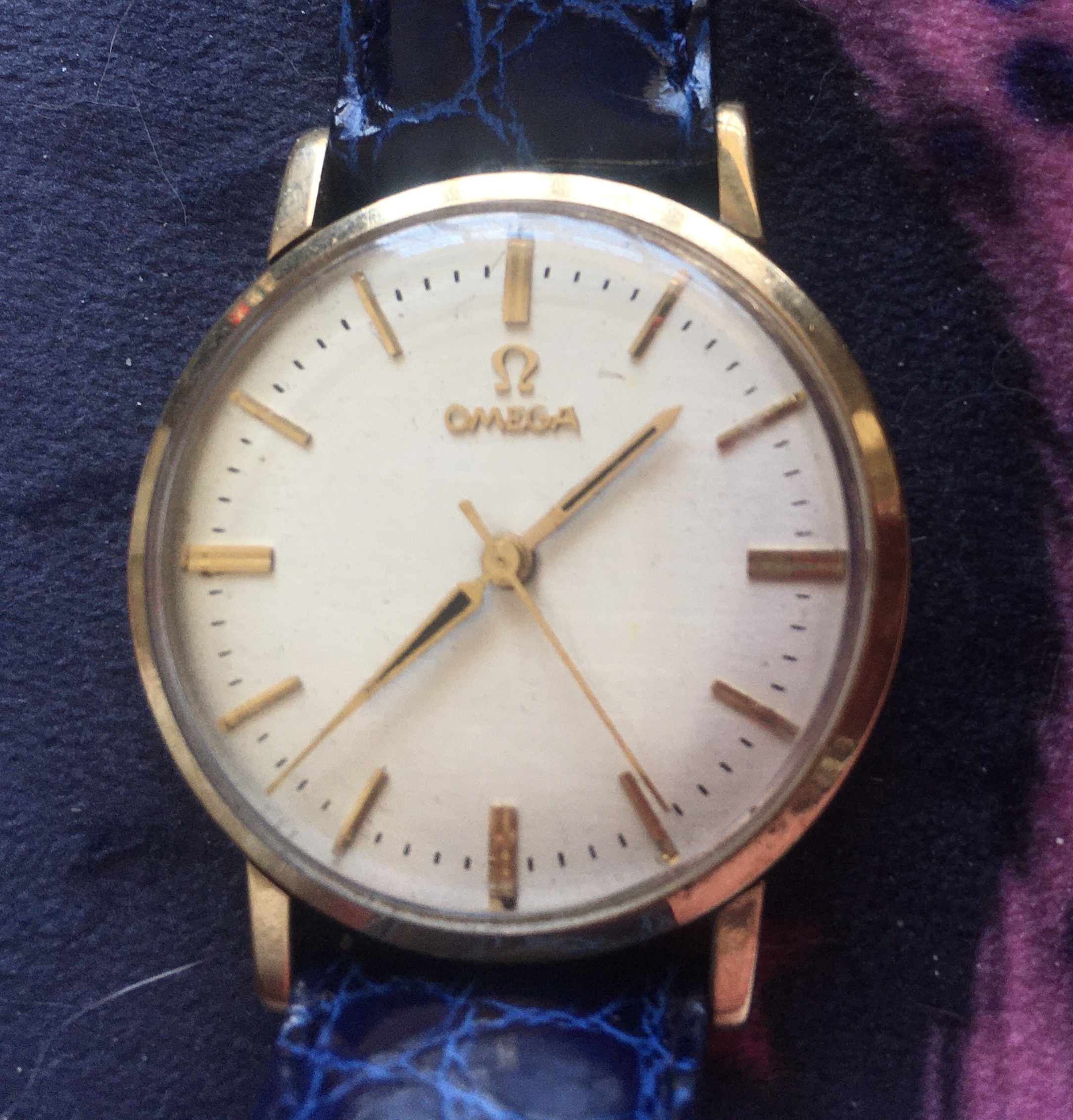

I suspect that dial has been repainted and the hands replaced. so it may have been replicating a named line but just as likely to be a no-name Omega dress watch.
Hope that helps.

to me the hands look replaced, its quite common that lume can be found both on the hands and indices and vice versa
that's not the case here

This watch will have a value due to the gold content alone. It is in rough condition though and due to the none original condition a collector probably wouldn't touch it. You say it was your dad's watch. Did he simply own it or was this his daily wearer? If it was I would definitely get it fixed up. Watches are a lovely reminder of people who have passed.
Hope that helps.

You have a couple of options.
Local Omega-authorized service, clean/lube and not much else.
Or you could send it to an Omega service center, and they can update some of the parts.
Or (don't do this) you could send it to the factory in Bienne to have it truly restored as it had left said factory 60 years ago.,
Because the case is "nothing special", the dial is refinished not as original, and your hour and minute hand don't match, I should think that the least expensive intervention is the prudent choice. That would be the local Omega-authorized service; if I were you I would at least replace the hands so they match.

I look forward to seeing updates on this watch. Aside from the winding stem issue (not uncommon) the movement otherwise looks pretty good. It’s encouraging that the regulator is set to about the middle of its adjustment range when it was a running watch.

Well that’s good to hear... not that I know which piece you mean but I’ll have a quick google..
This piece. The pointer on the index scale inside of the Swan Neck loop. It’s how a person fine tunes the accuracy of the watch to make it run a little faster or slower. Yours is set at about the mid point. Always an encouraging sign on an undisturbed watch that nobody has fiddled with in a while. Regards.
