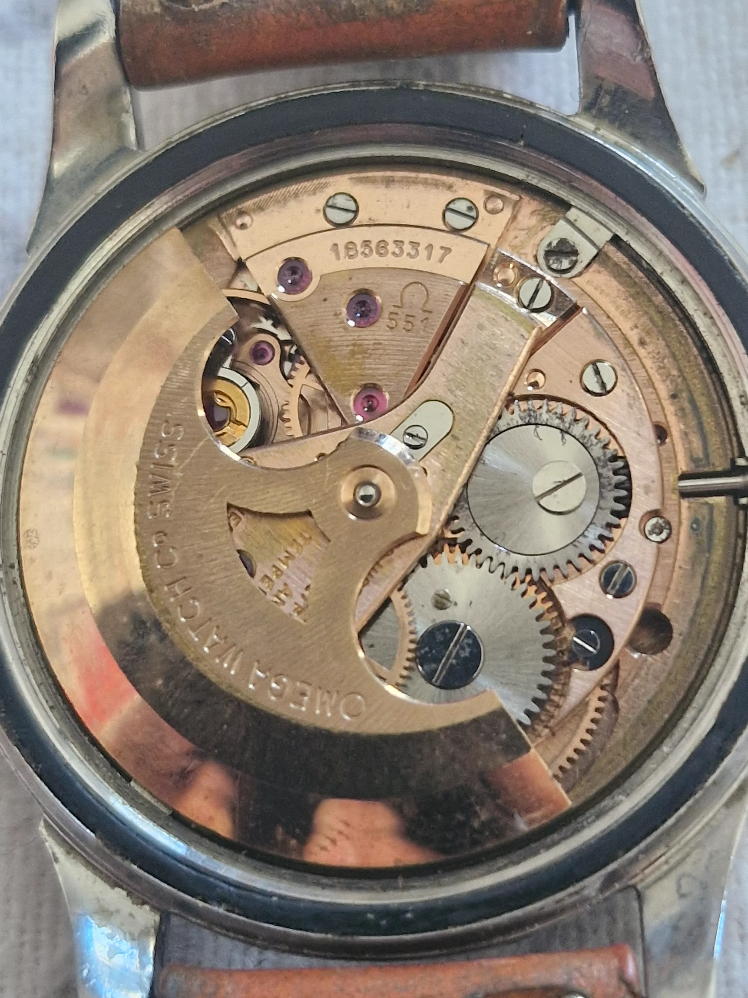

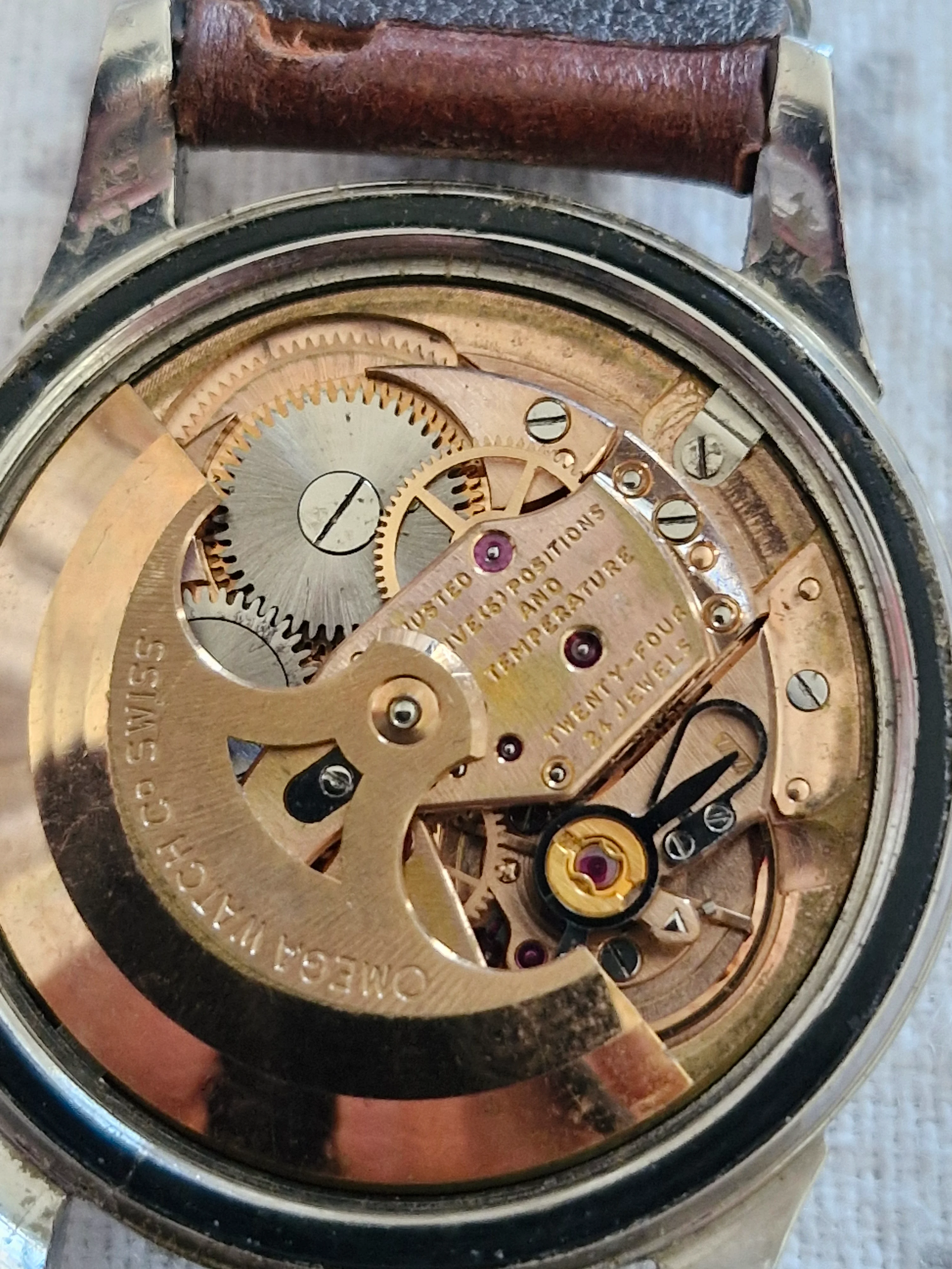

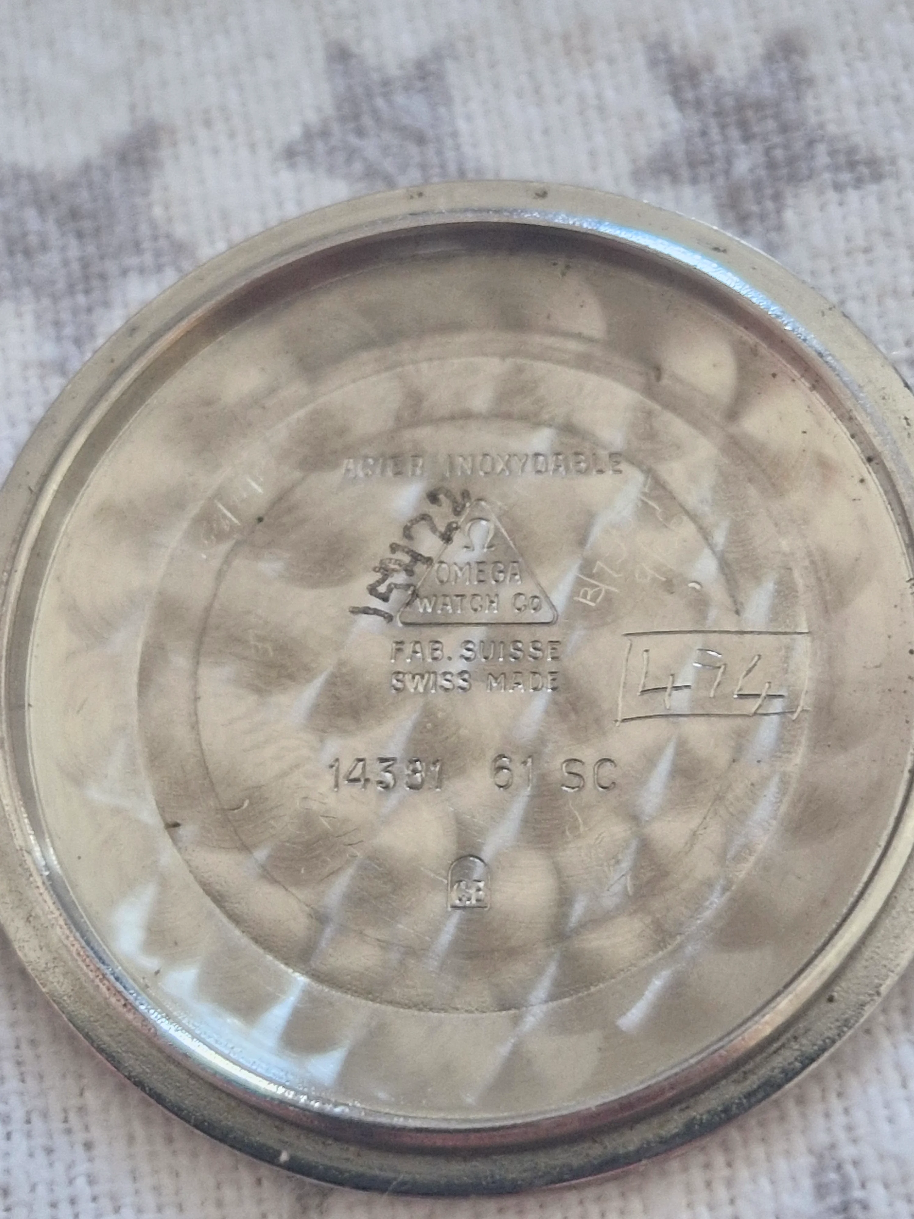

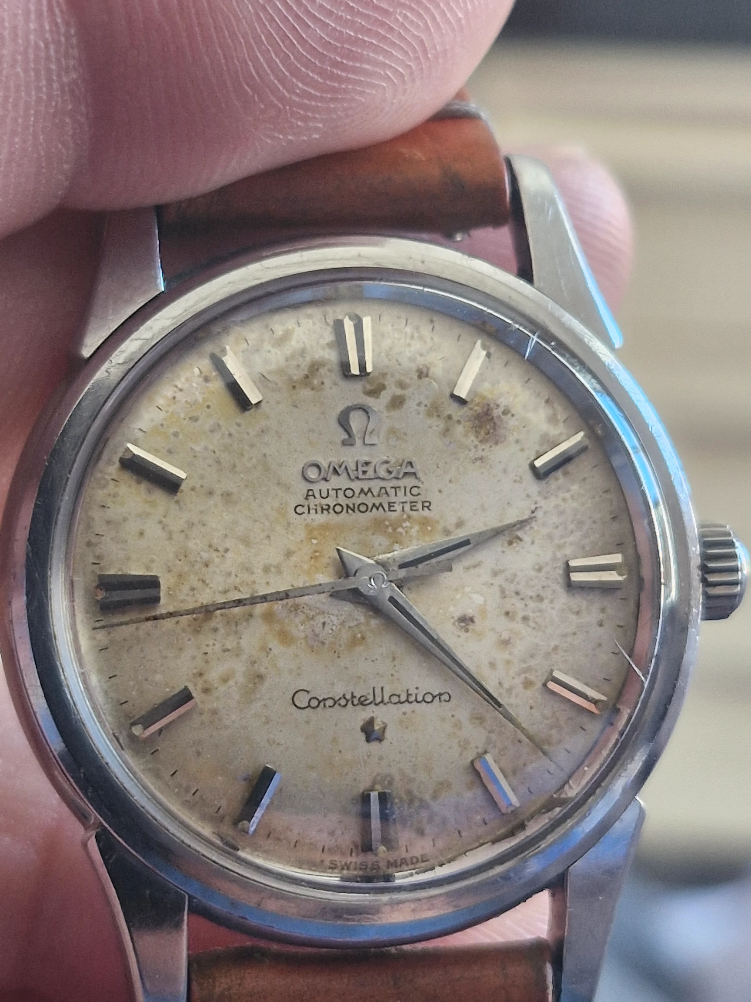

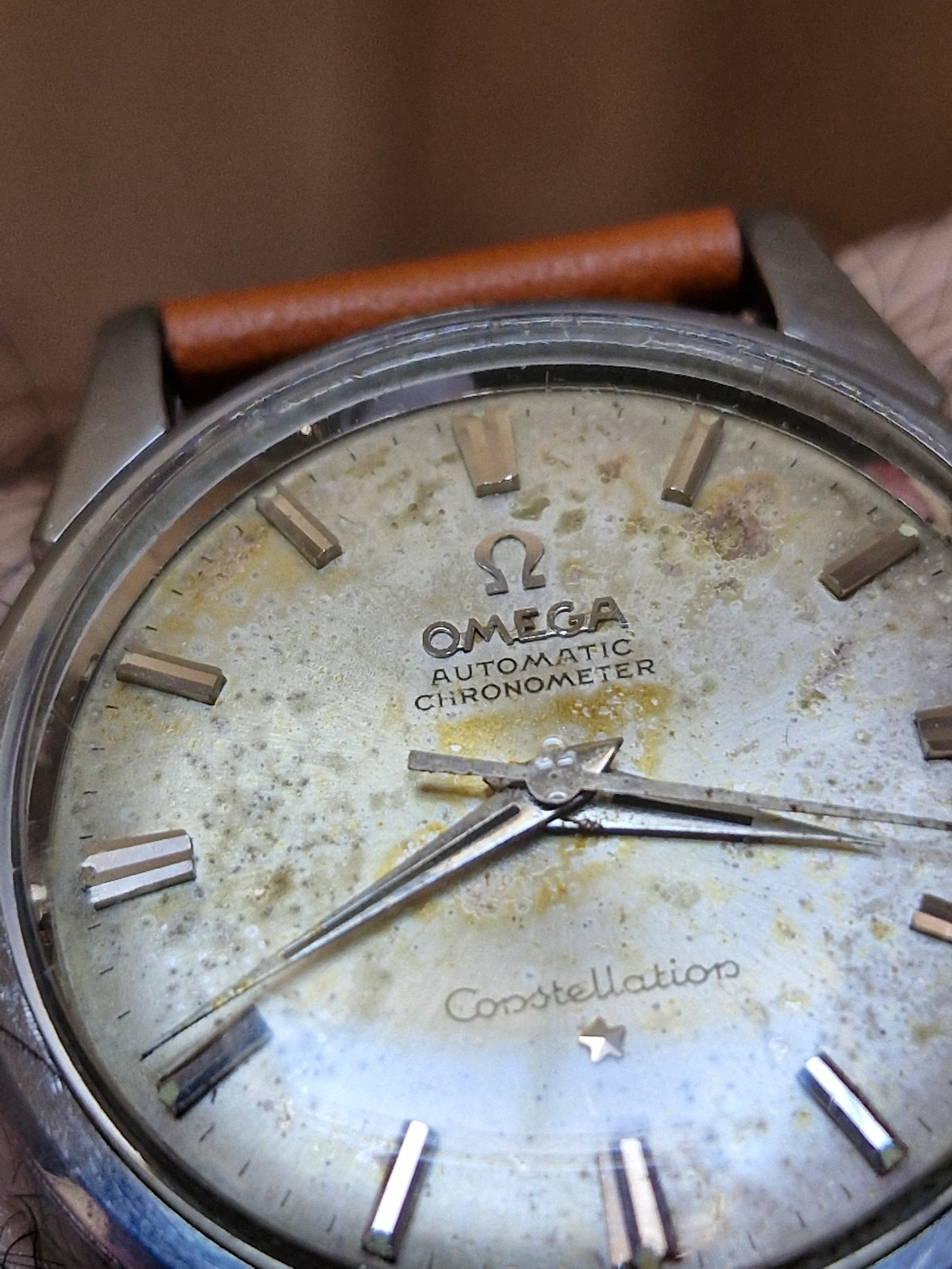

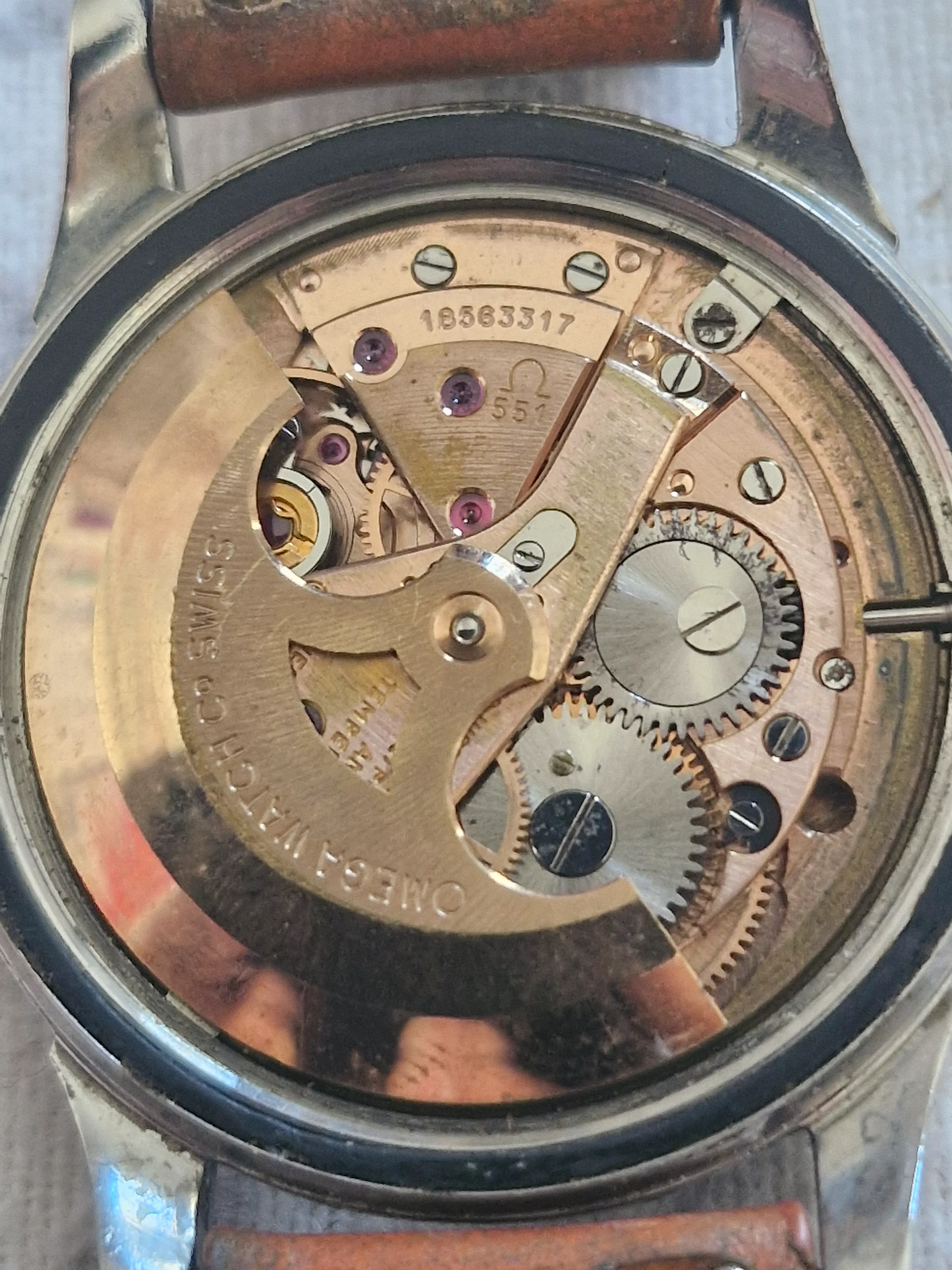

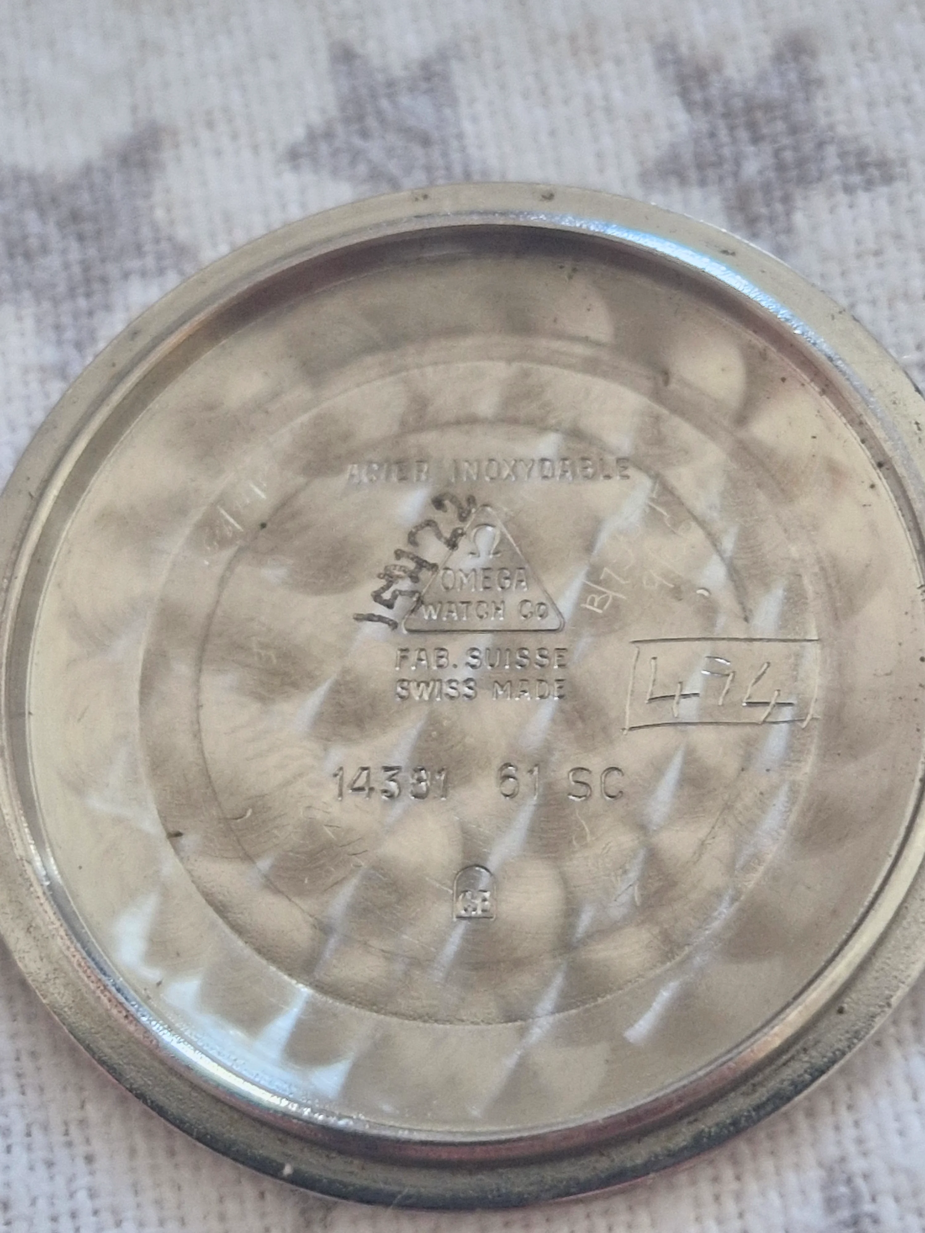

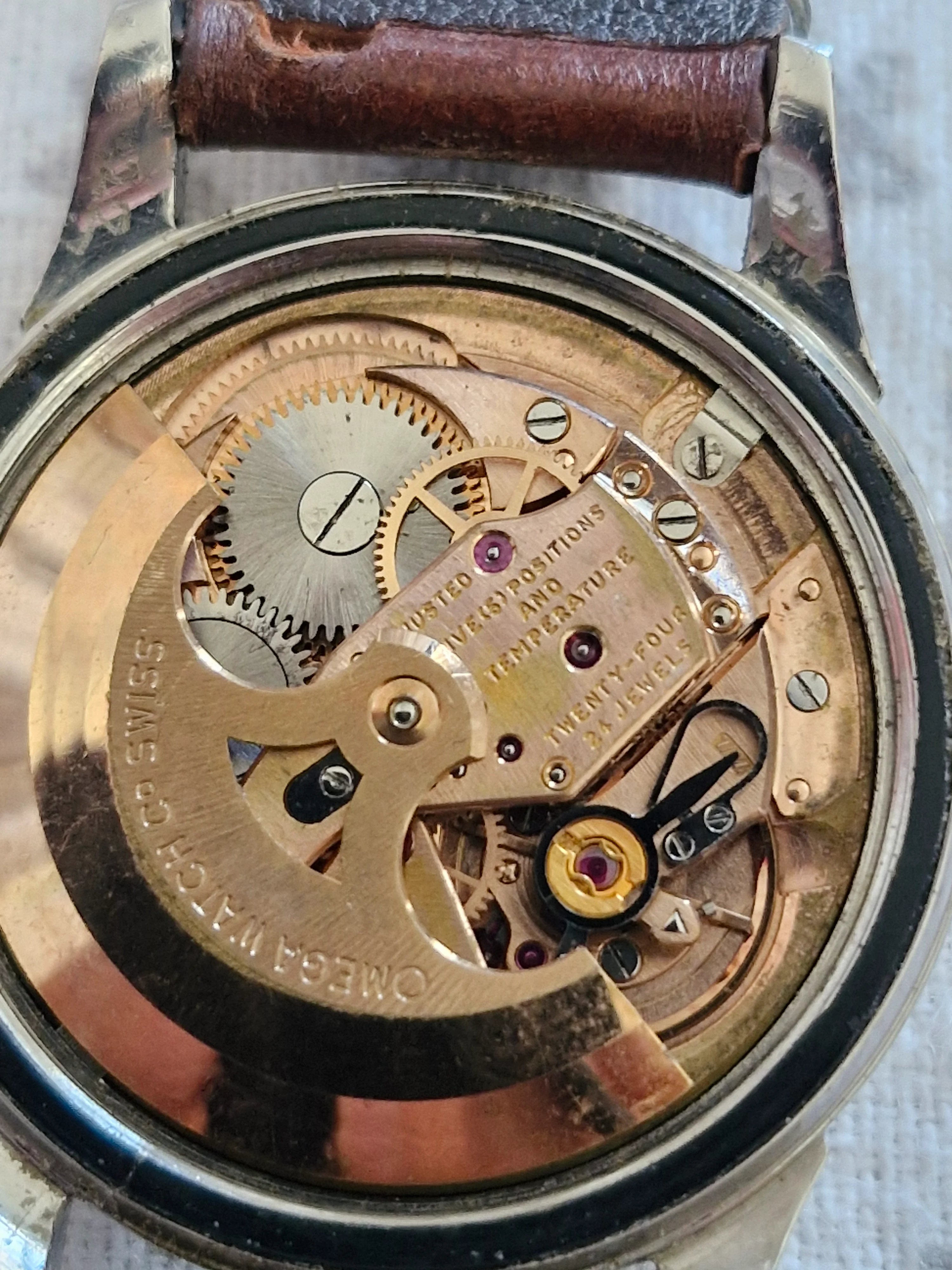

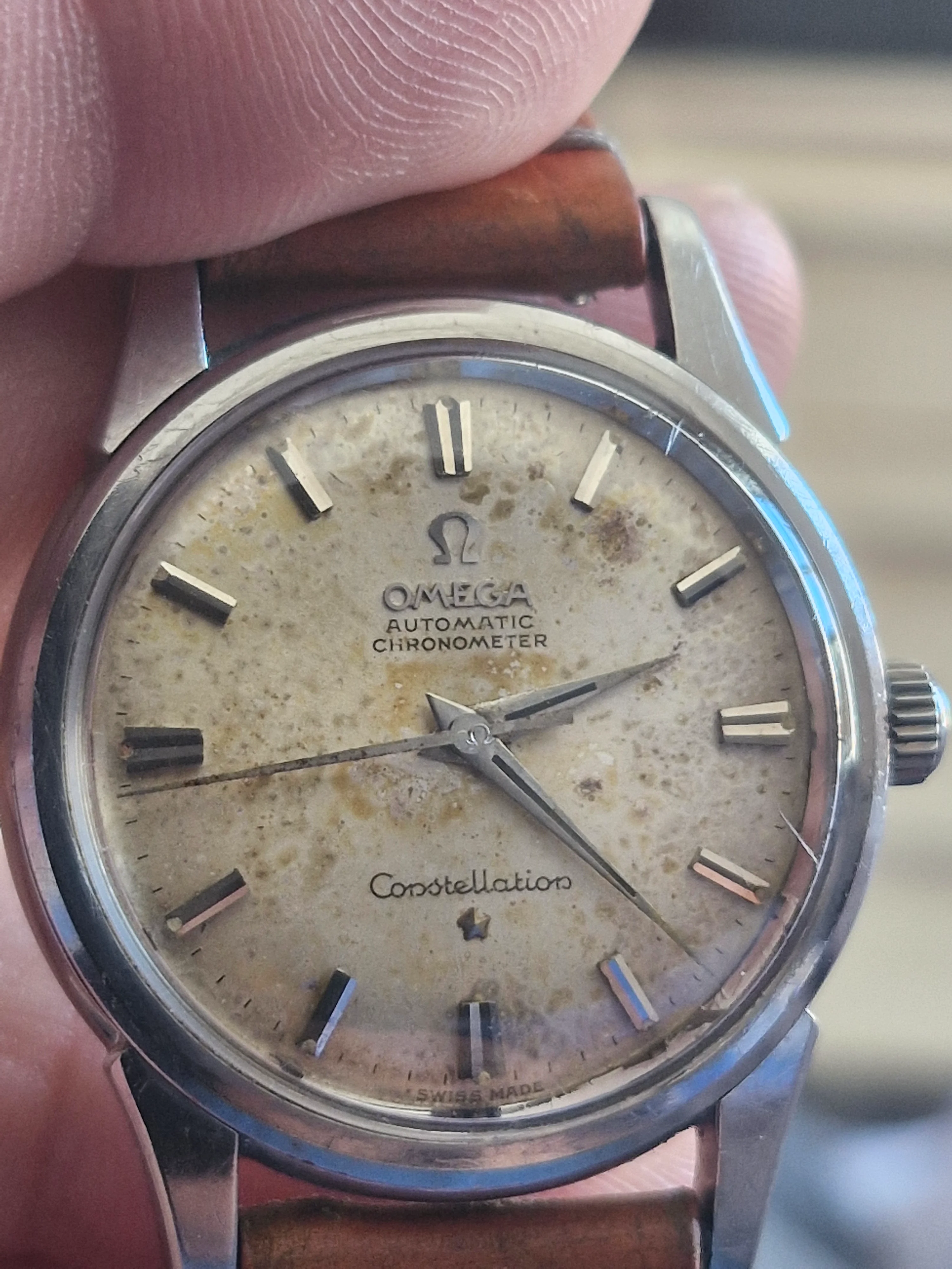

Hi,
Got this watch few months ago from Ebay for £350. Just wondering if everything is original.
All the best, Cristi

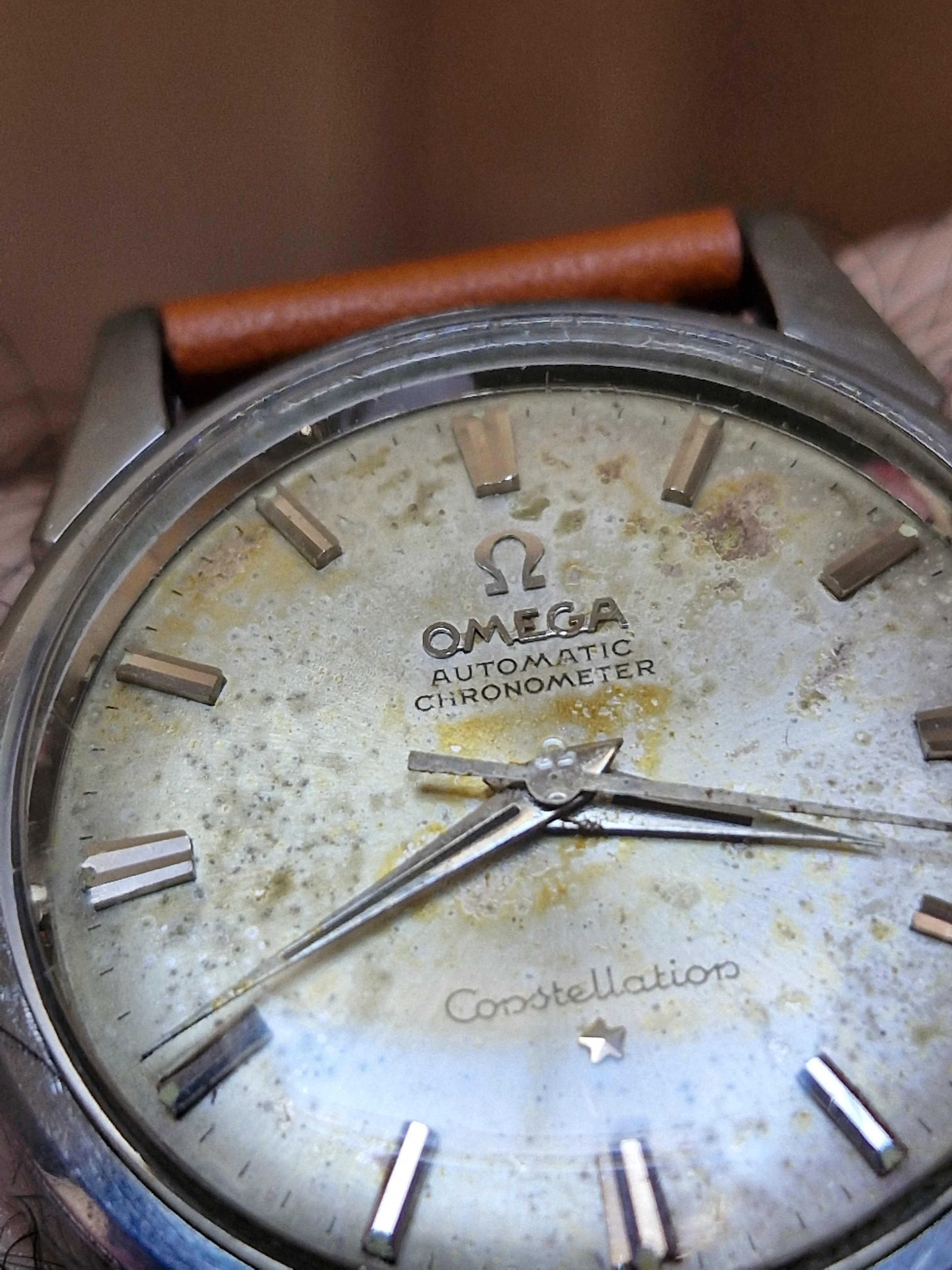

Looks pretty much all correct except for the crown.
The watch has had a hard life with evident moisture intrusion which has affected the dial and movement- but I guess you knew that from the pictures when you bought it.

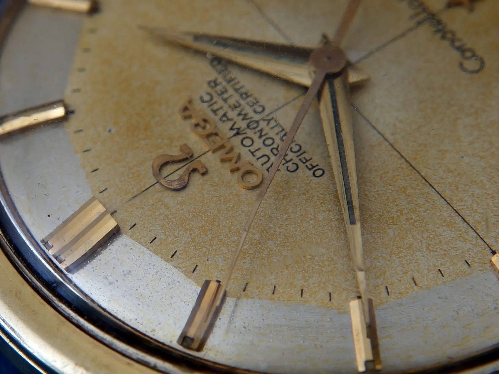

Sorry @Peemacgee but there is hands/dial difference concerning lume: Looks like the hour markers have lume dots but the hands don't have lume. Hands look off in general IMO
6,671
10,307
I think the lume on the indices has been replaced on the OPs watch.
