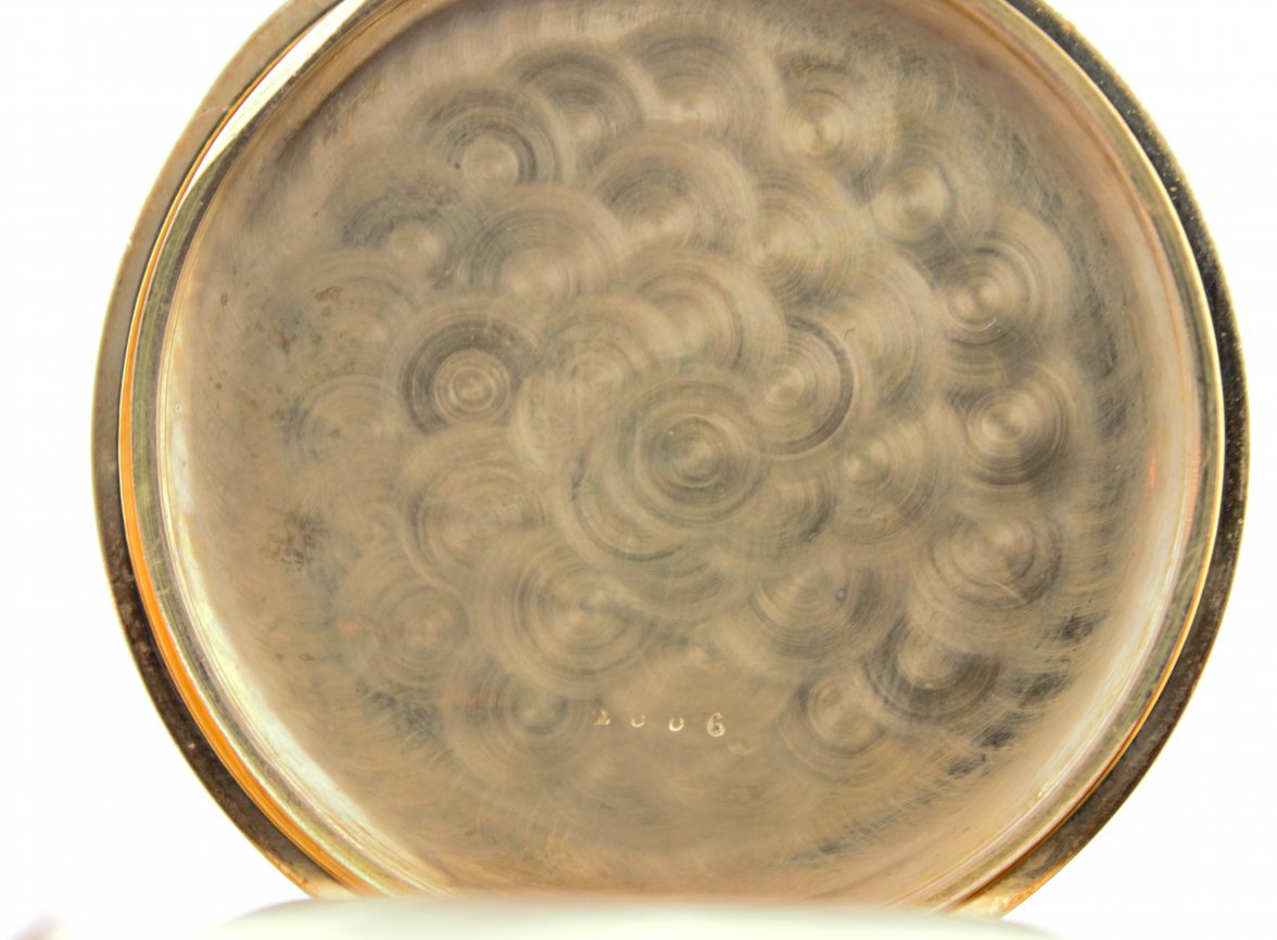

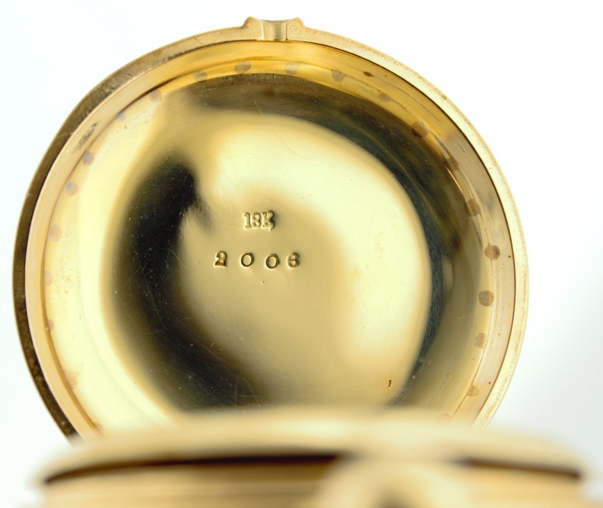

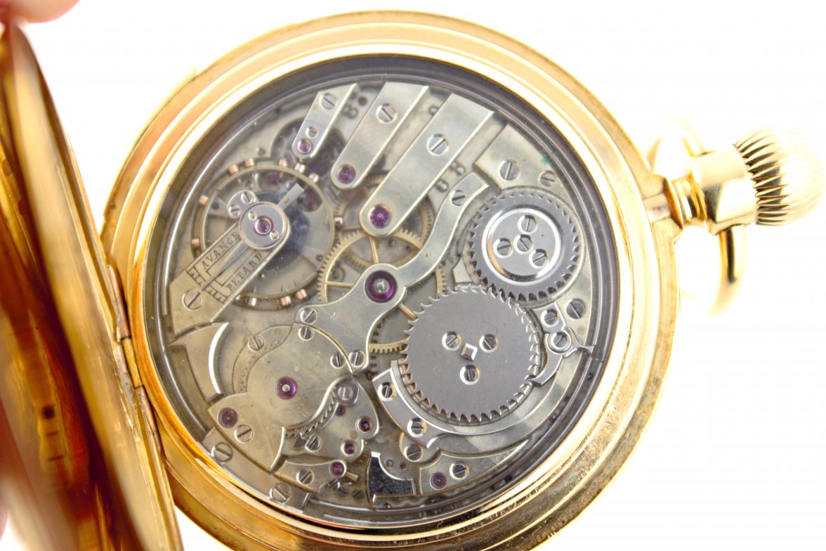

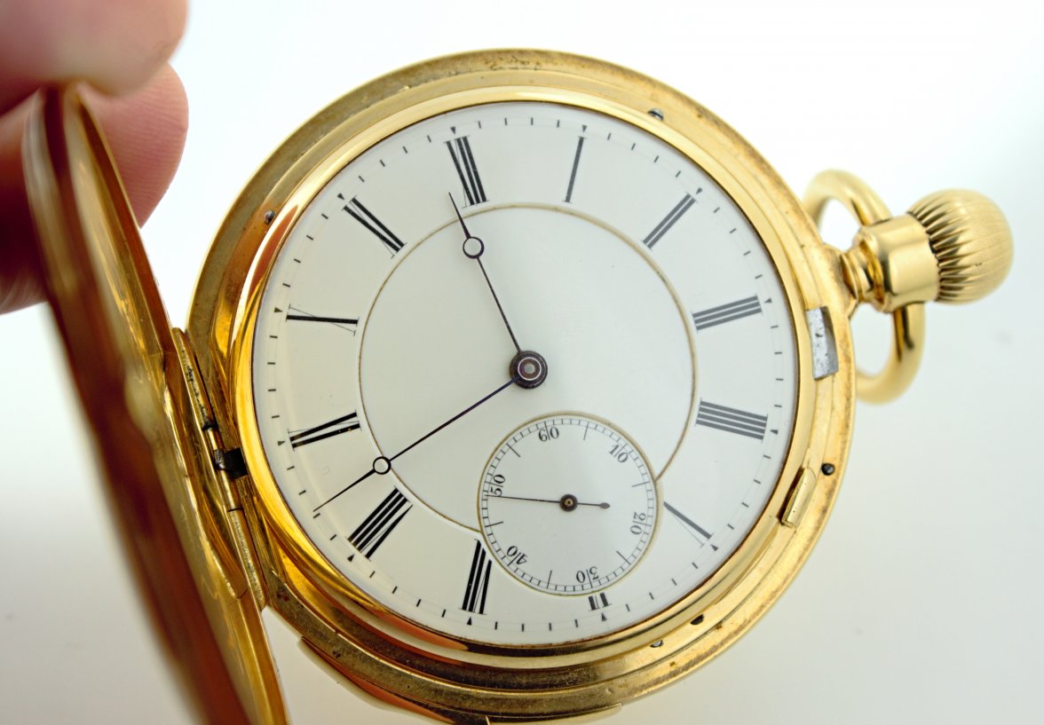

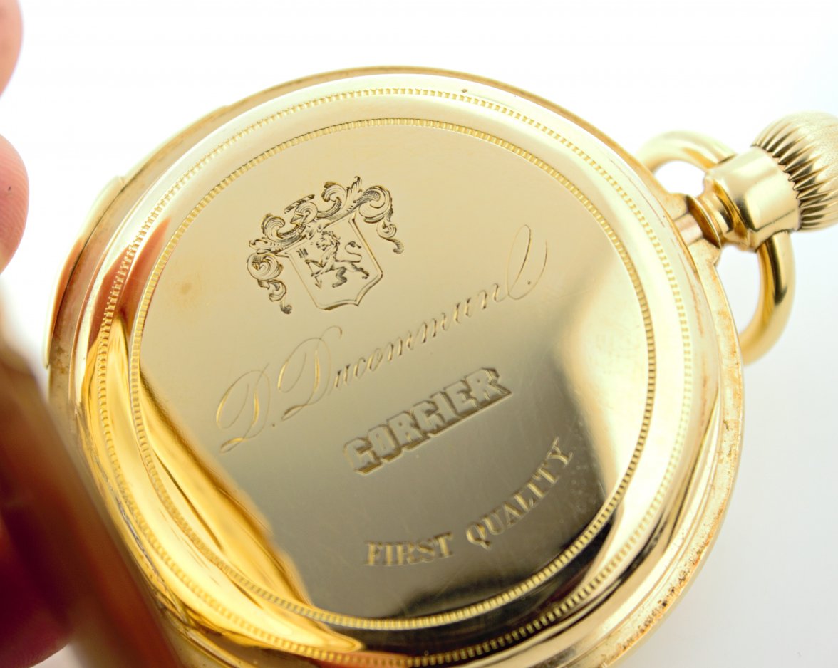

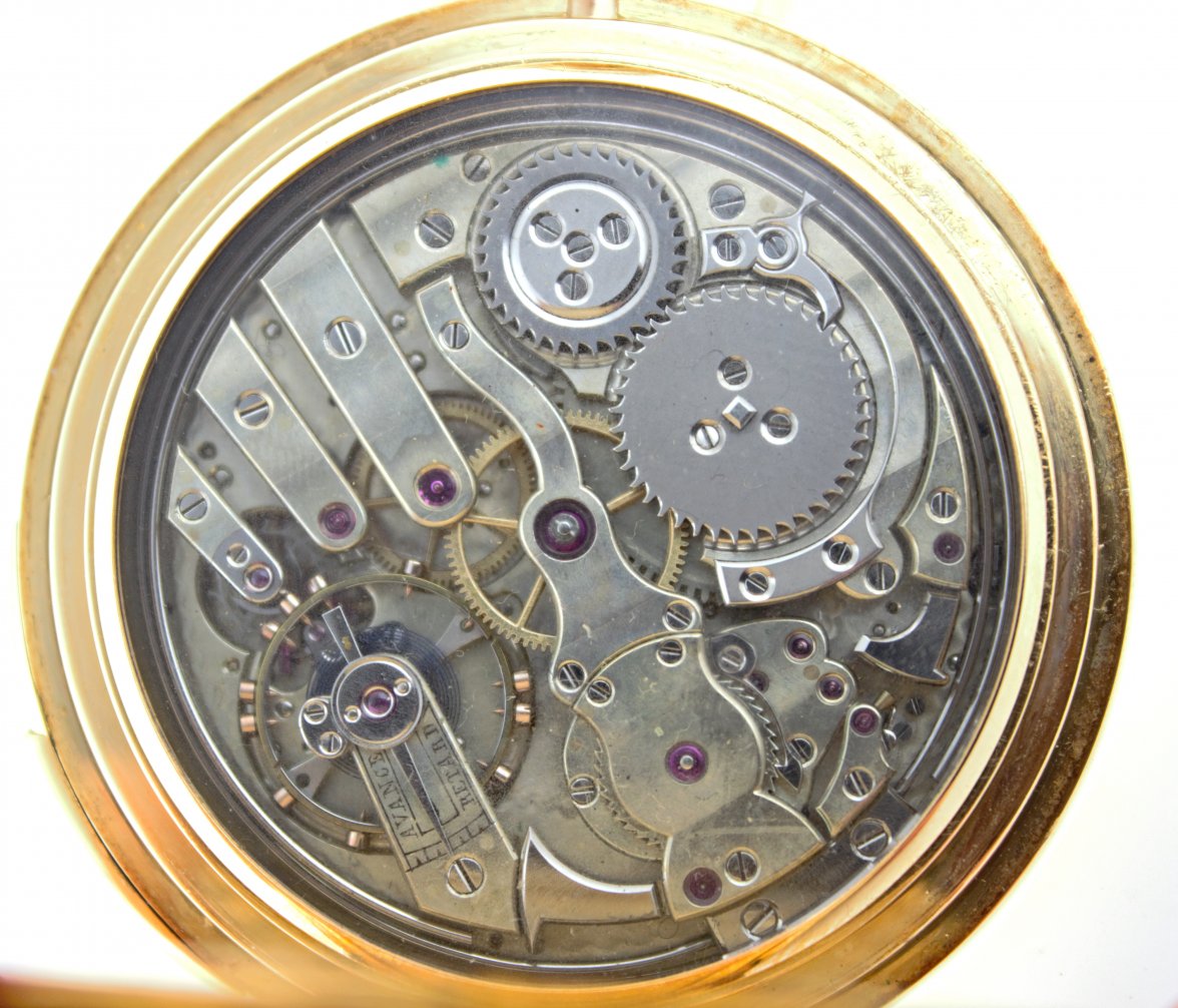

E Posts 10 Likes 0 estates4 ·May 20, 2021 Can someone please help me to identify this pocket watch? I tried searching online but some minutes repeaters movements are very similar. has 2006 and 31014 marked under the dial.

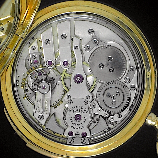

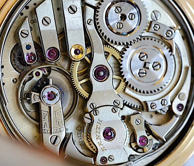

Posts 18,776 Likes 39,021 JimInOz ·May 21, 2021·Melbourne Australia It has a very "Patek" or "LeCoultre" look about it, but the barrel bridge setup is different. There may be a maker's stamp under the hammer, or else it may just be a blank movement. At a guess I'm going to say it is closely related to the Gallet and Zenith minute repeaters in that the maker has used the same ebauch. To get any close the watch would have to be partially disassembled to access any marks on the plate and/or the cocks.
