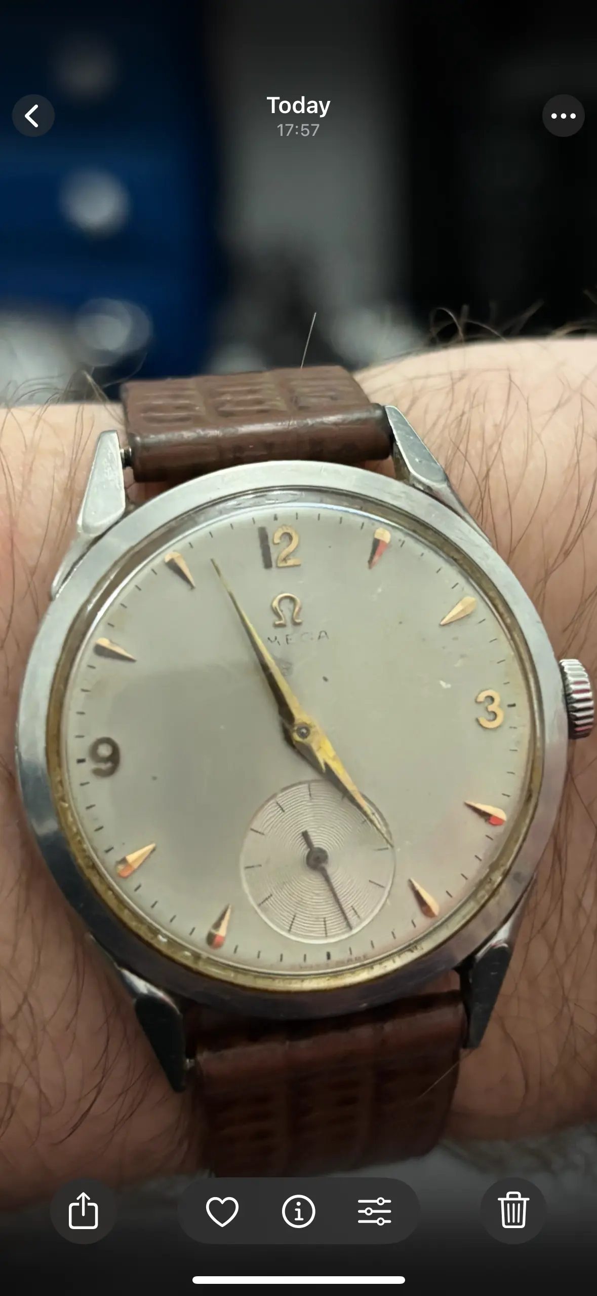

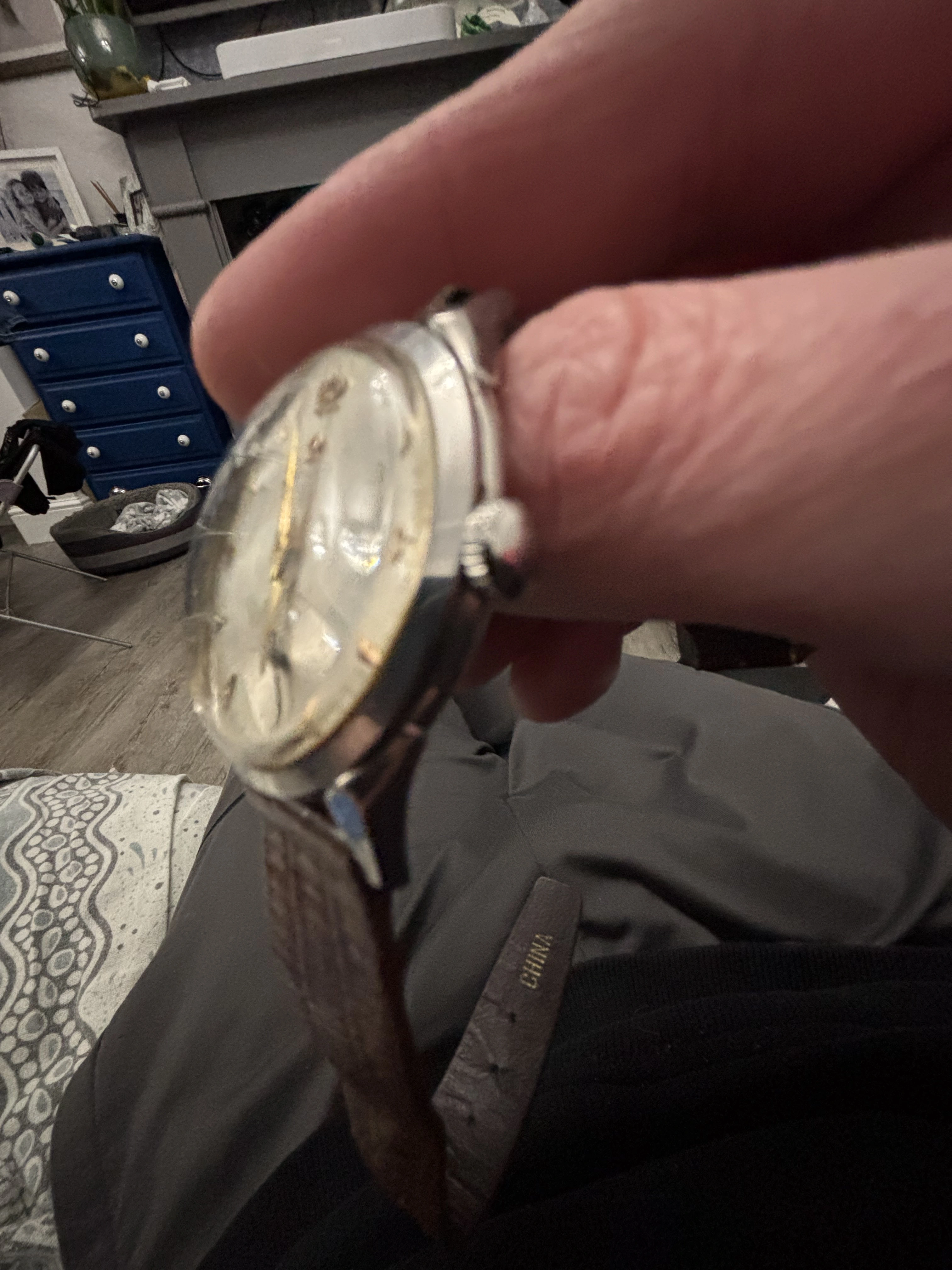

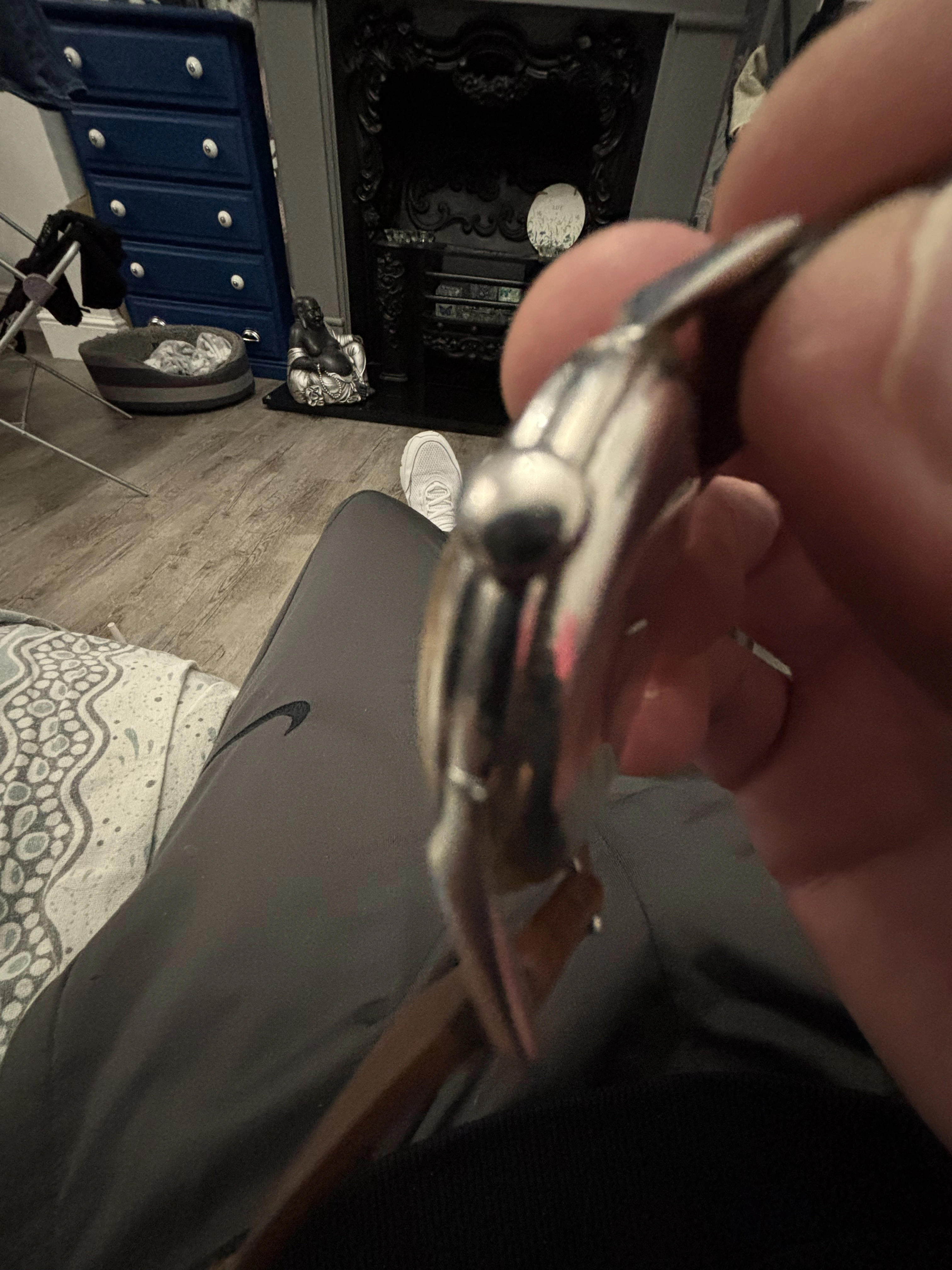

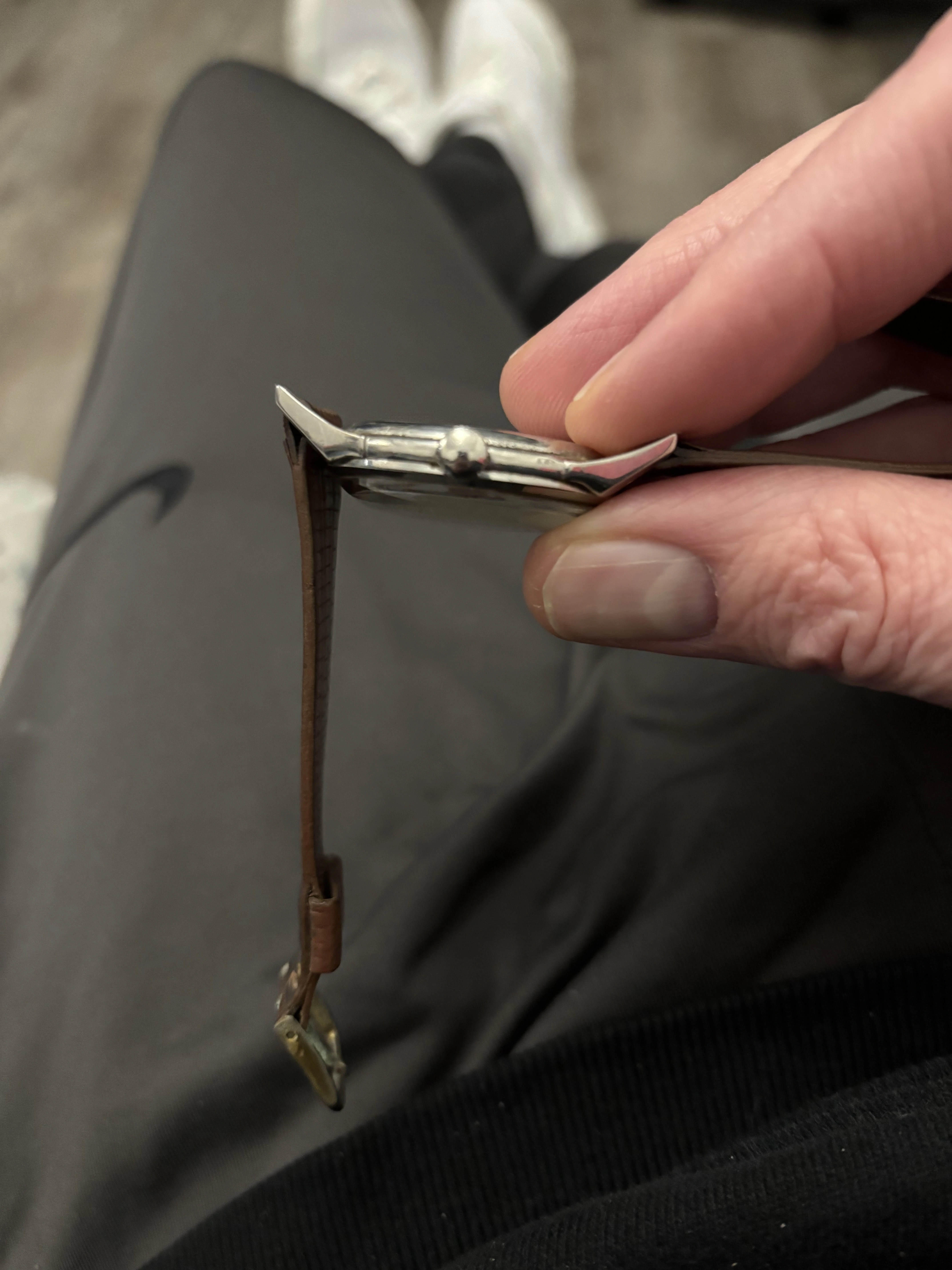

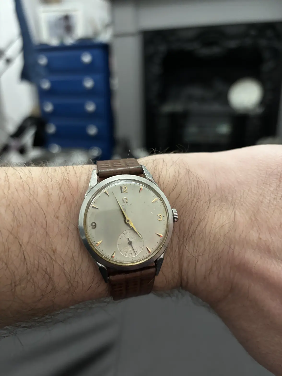

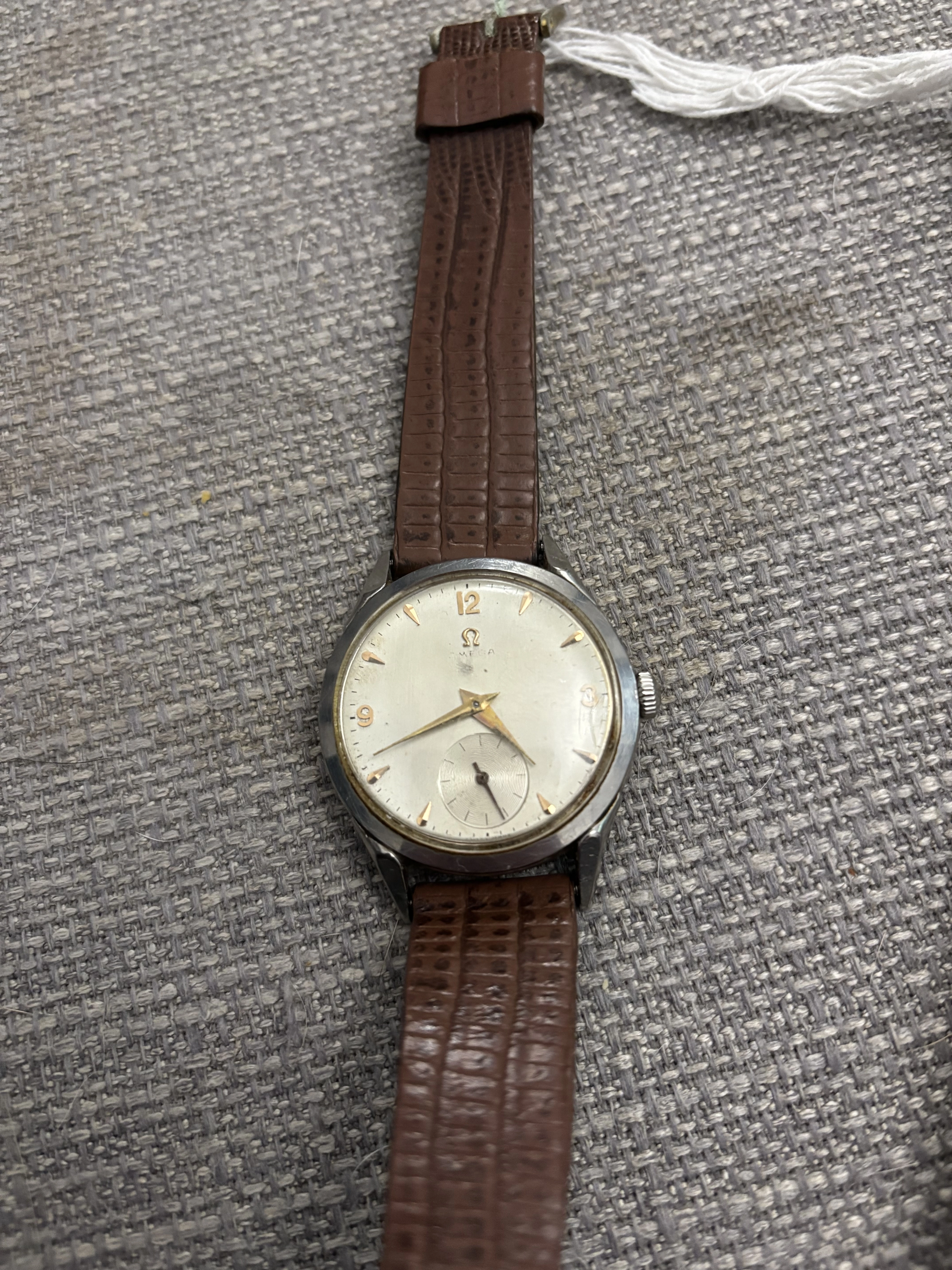

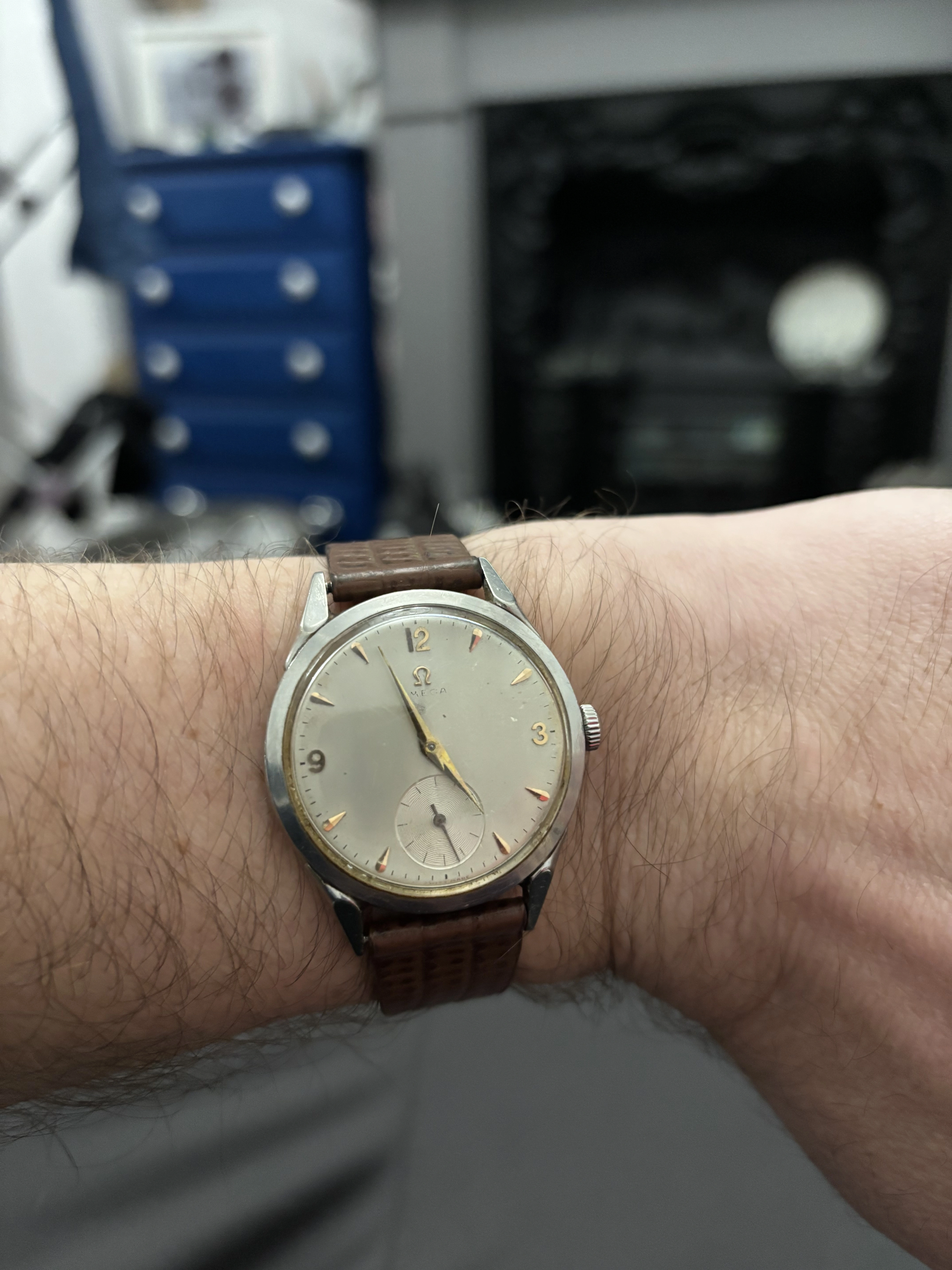

As it’s Remembrance Sunday in the UK, I decided to get my late grandfathers RAF logbooks and medals out to show the kids.

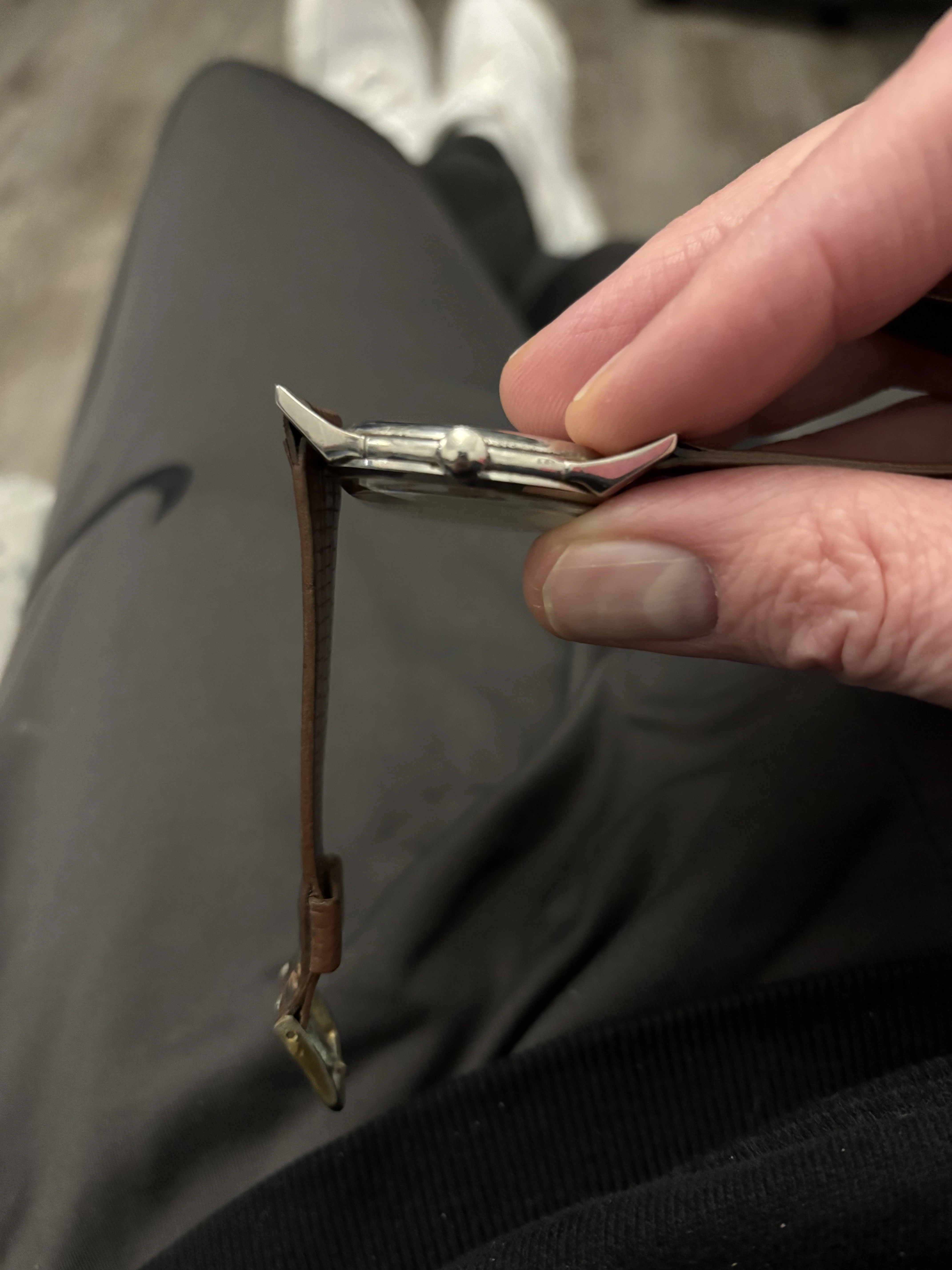

While digging through the box, I came across this watch. It appears to be a 1950s? Omega but from doing some quick searches with Google Lens etc, I can’t seem to nail down exactly what model it is.
I am intently interested in restoring this piece where possible and adding it my collection.
Does anybody have and thoughts on what this is and if restoration is a viable option
Many thanks in advance!
24,525
54,494
Welcome to the forum. I've seen this watch before, but I'm blanking on the reference at the moment. If you could have it opened and post photos of the inside, all will be revealed.
Regarding restoration, the challenge is that someone appears to have attempted to clean the dial, and unfortunately washed away some of the printing. It will not be easy to find someone who can do a good job fixing that. However, if you're ok with the dial as it is, you can certainly have the movement serviced and the watch will be ready to wear. Because it is not water resistant, you will want to avoid even incidental moisture.
3,566
7,599
It is a reference CK 2605 with a claiber 265 or 266 inside.
It is a well know model with interesting lugs.

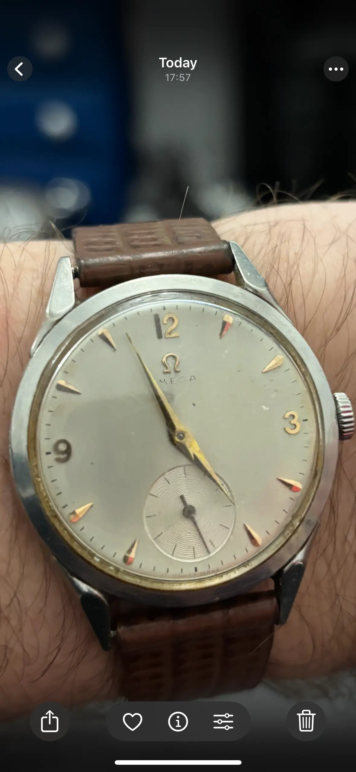

Thanks both, appreciate the fast responses. The Omega text is ok, it’s a blemish/scratch on the glass that makes it hard to see (apologies not the best photos). Do you have any idea how much restoration would cost? Looking on the omega website it’s citing £2000. Which feels excessive
18,085
37,743
No need to send it to Omega as, although they may do a good job, it could come back looking nothing like it was before, which is what your father saw when he looked at it.
There are a number of independent watchmakers in the UK that would be able to service your watch.
Our UK members can help with some recommendations.
24,525
54,494
Really you don't need to use the word "restoration" because that is going to cause confusion about what you want. What you want is a movement service, sometimes called an overhaul or a COA (clean, oil, adjust). They can polish the crystal for you, but I really wouldn't recommend anythings else.
Search the forum for similar threads, there have been many in the last couple of months asking for recommendations for independent watchmakers in the UK. Budget a few hundred GBP for a basic service.
