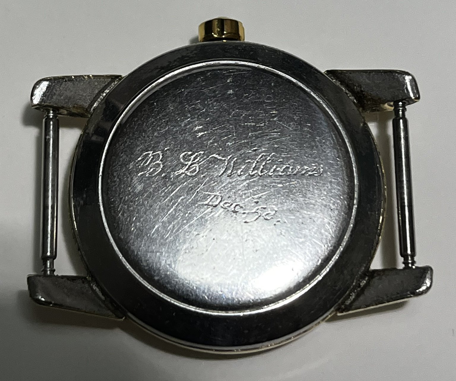

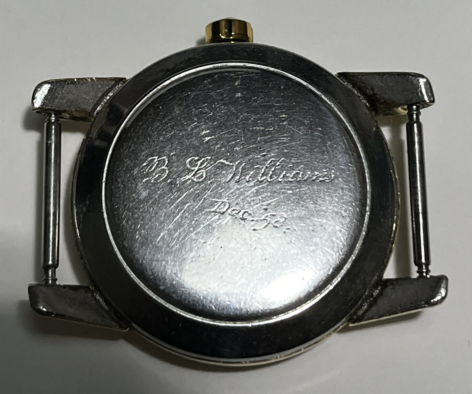

All information inside Caseback for reference and movement serial number.

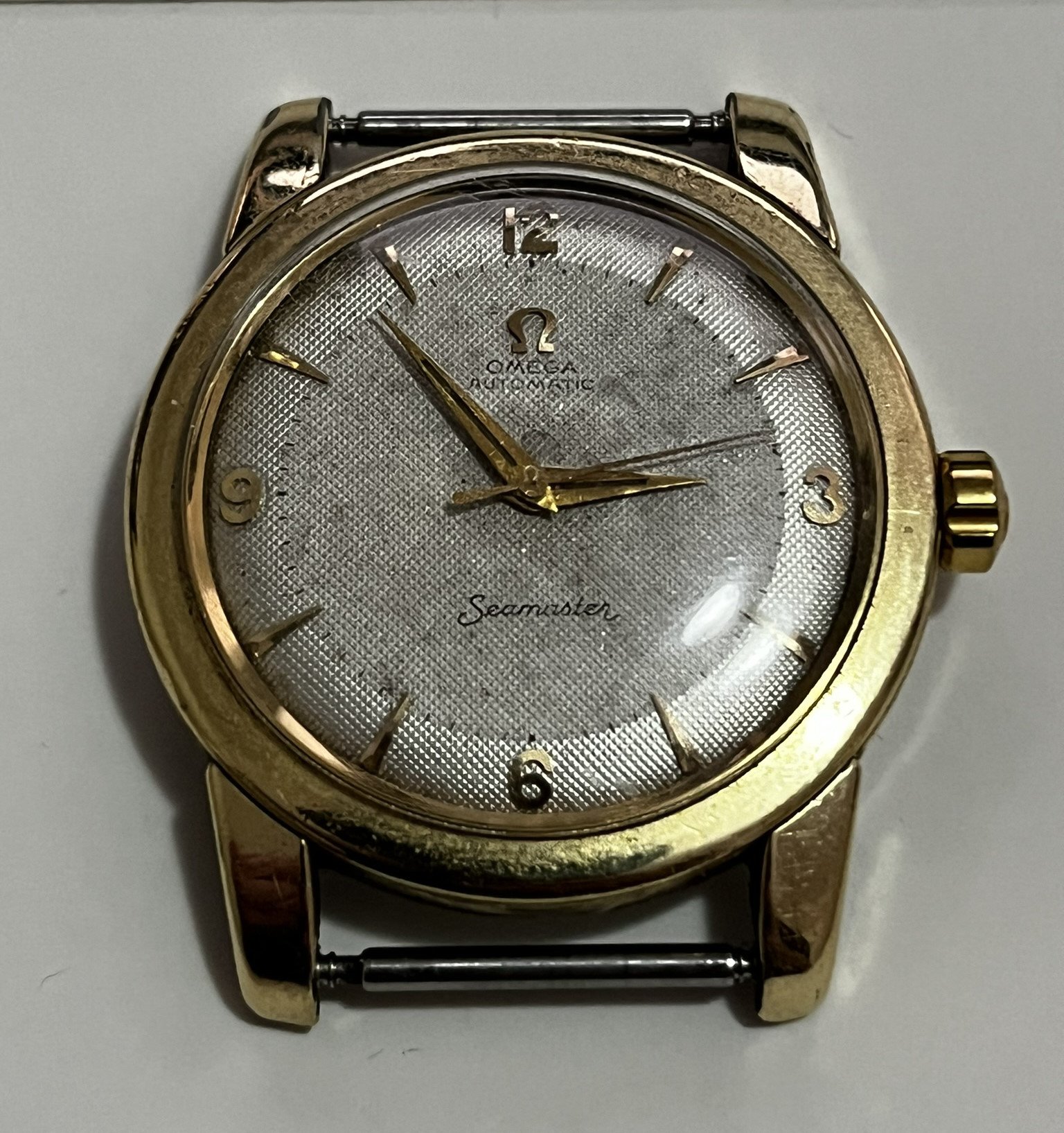

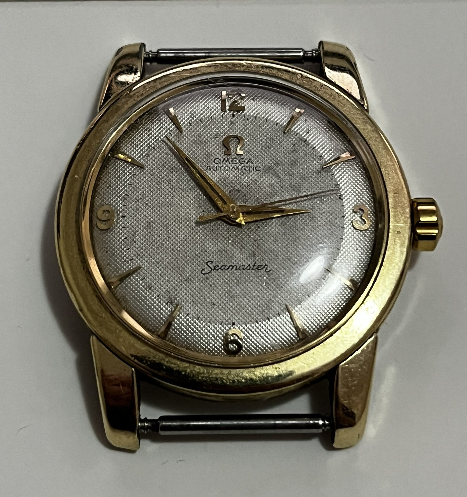

The minute markers look irregular particularly between 5-6 and 6-7 and several of hour markers look misaligned raiding question of old redial but can be hard to tell on waffle dial. See what experts think.
Thanks! I think the irregular markers are an artifact of the camera zoom. They look aligned in person to my untrained eye 馃榾

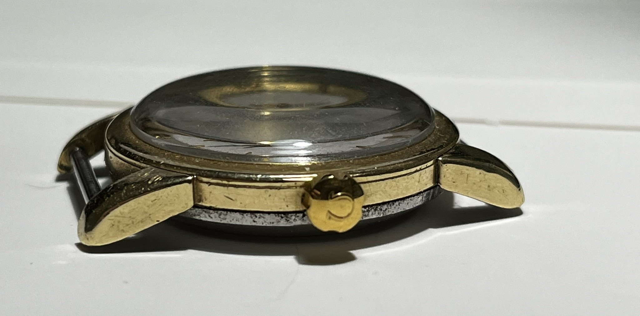

Gold cap case. Incorrect crown, but it's fine as it appears to be gold filled/capped to match case. Crystal is genuine and not a replacement
Do you feel a bump if you turn the case? Possible bumper movement or full rotor
SOG53 was talking about the 56. 57 and 58 index marks which appear to be angled and sitting into the outer ring. 9:00 index mark seems longer than 3 and 6
Based on dial condition. Could be an old re-dial

It looks like a clover crown from the side view, so should be correct.
The lugs look like a ref 2848, with cal 490/491, but we need to see the inside case back to be sure.
Correct. Top image made it look like multi thread/facets

Should be a 2846. Cal 501. As others stated the crown has been replaced with correct style in the past. This model was released in ~1956 so 1958 purchase date would make sense.

I think it鈥檚 as 2767 with a caliber 354 bumper movement. Caseback matches other examples of the reference.
