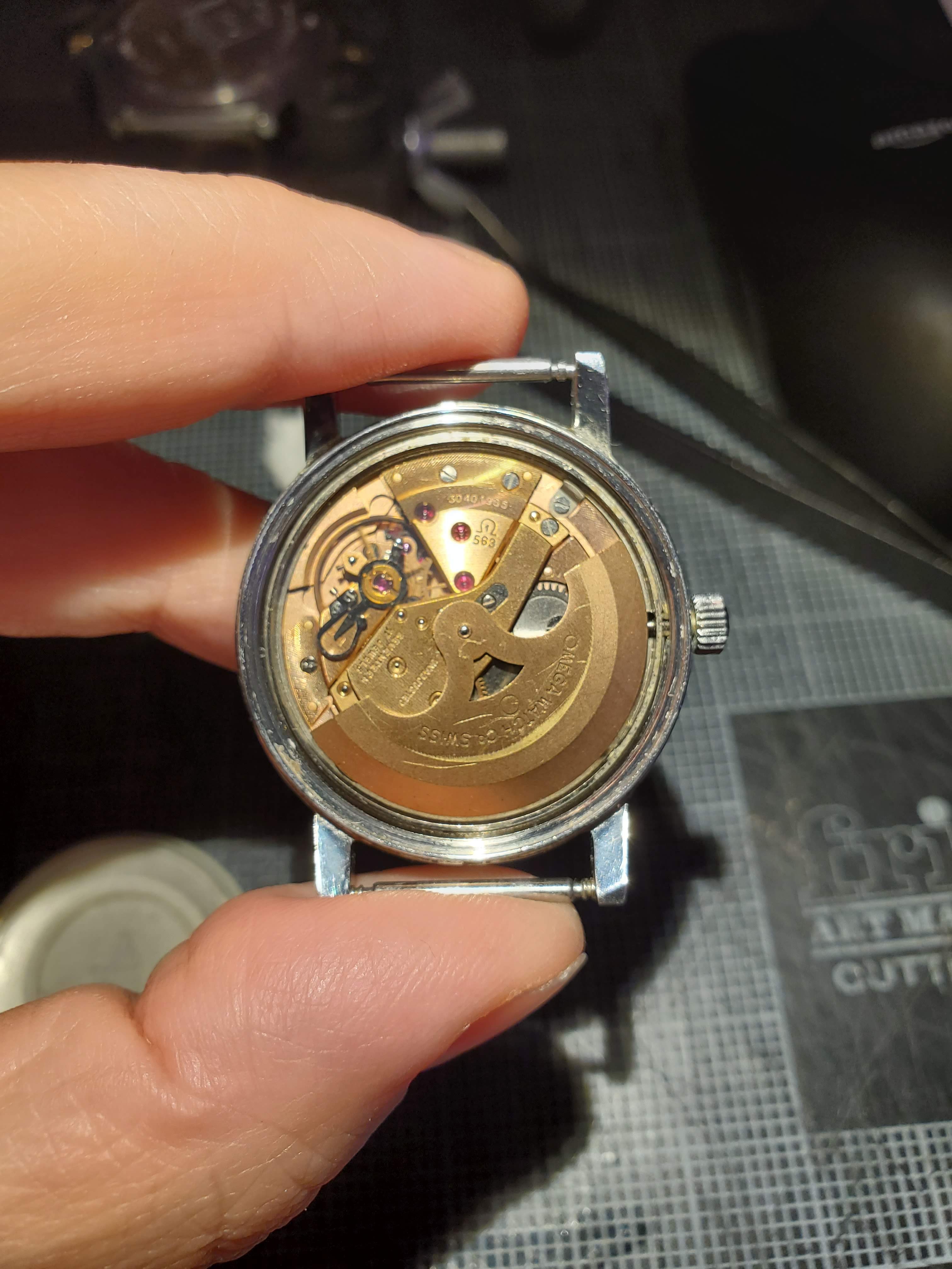

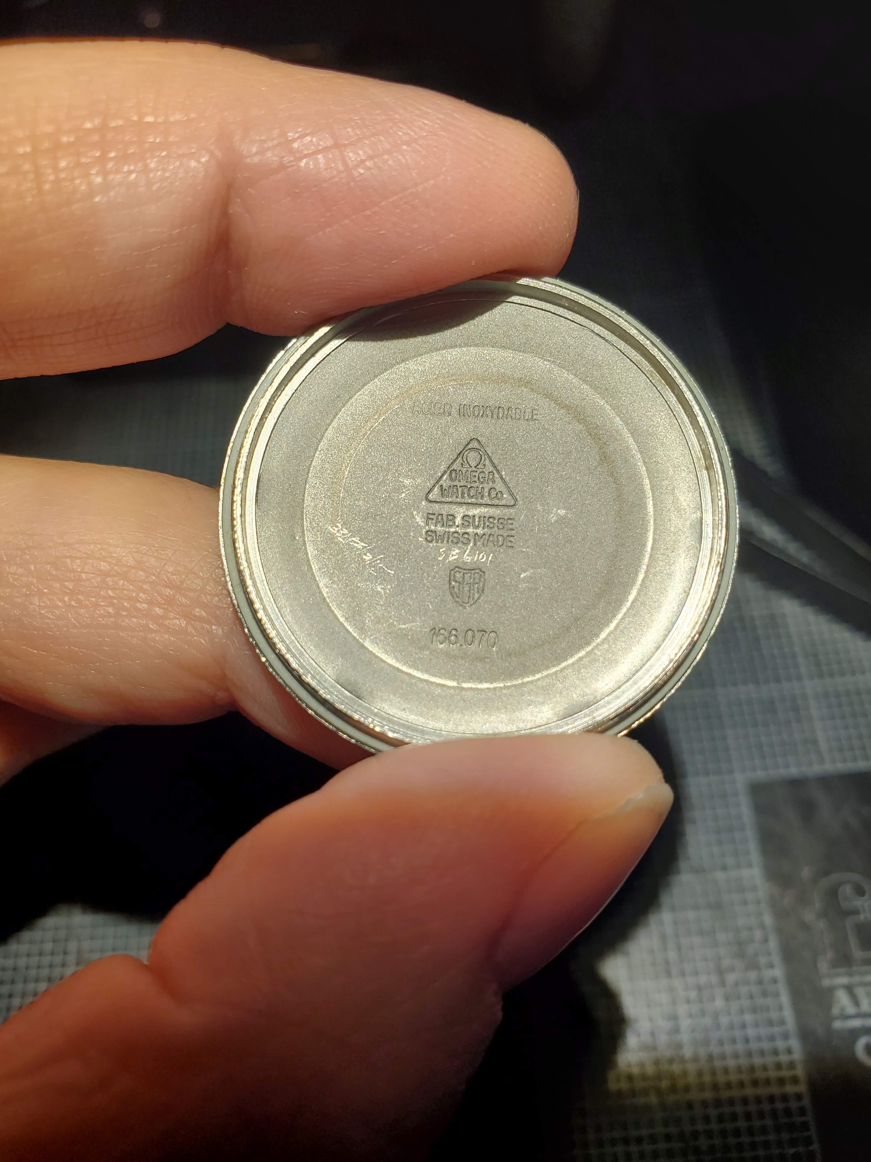

I have a 1969 Omega that I needed to replace the crystal on.. well, because life happens.. I took it apart at some point literally a couple years ago, and it had been sitting disassembled since then. I finally replaced the crystal and reassembled it yesterday, but the movement now rattles around a bit. I realize there must have been a gasket/o-ring or something that I've misplaced but I can't remember. Can anyone help me out? I see otto frei and others sell o-rings but I have no idea what size I need and whether it was flat or round. Anyone have experience with this case?

Well, the watch really needs a service, so I would get it to a watchmaker and let them service the movement and get the correct seal. Serious wear on the rotor where it’s been rubbing the case back...

The wear on the back of the rotor might be because the watch back has been put on and the watch was wore without a gasket for a period of time which would mean the back when screwed down tightly would then be sitting to close to the rotor and it would rub on the case back.
Like Archer said a service would be a good idea thou.
Even if this is the case, wear like this generates debris, which is now in the movement. This needs a service ASAP.

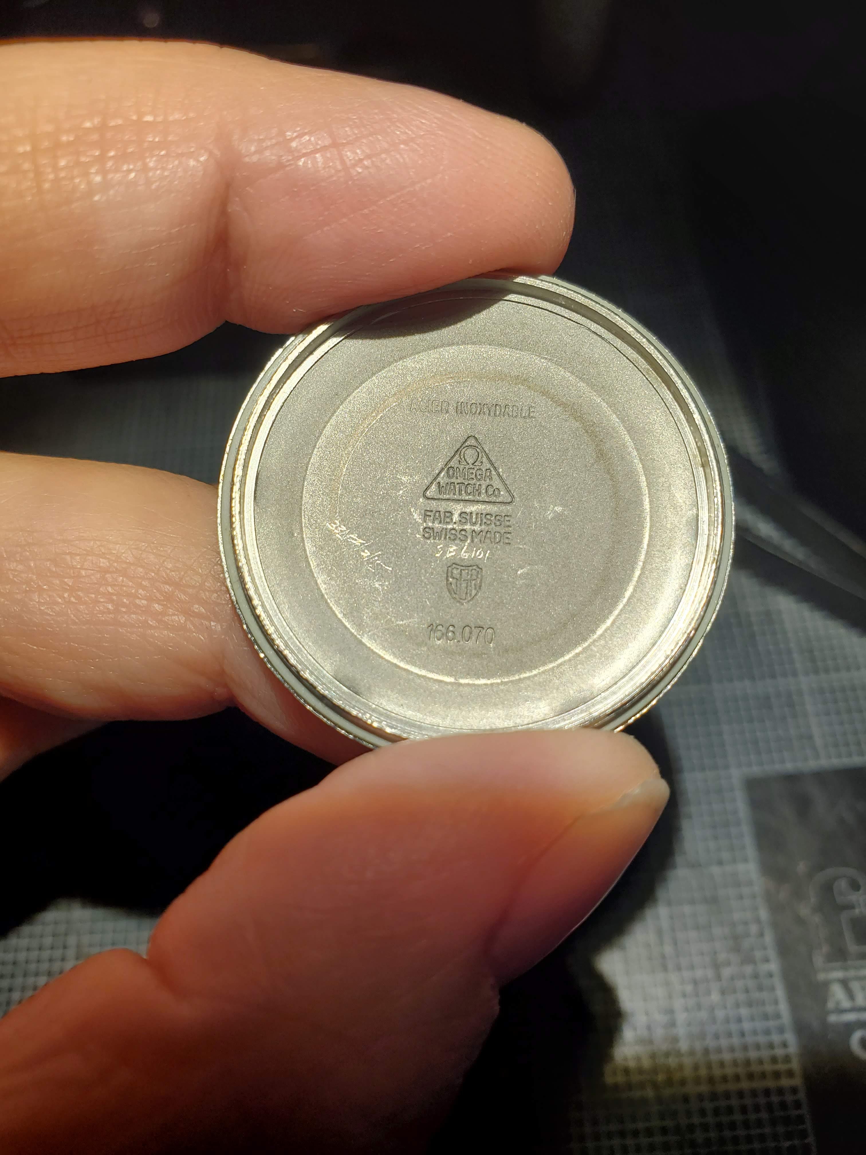

I assume your concern is based on the ring of discoloration on the caseback that seems to correspond to some wear on the rotor? I hadn't thought about that being damage until you mentioned it. (that's why you're the watchmaker I guess 😀)

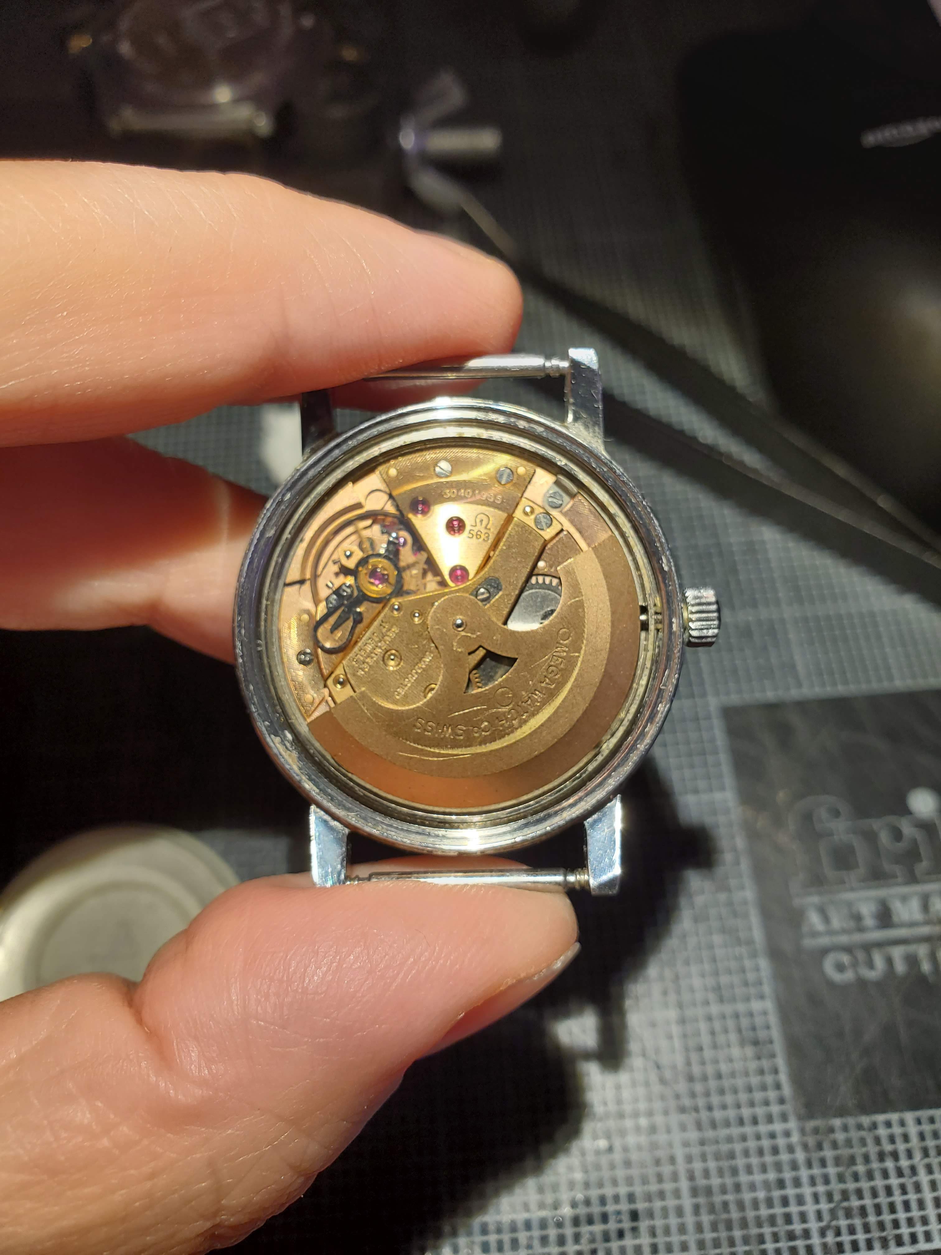

My go-to watch guy has retired and closed shop. I guess it's time to find a new one, but given.. *waves hands at the world in general* I don't know how easy that will be. Is this something someone at a generic jewelry store could do competently?
Well, I see this wear a lot - if you press on the rotor opposite that wear spot, on the far side of the axle, you will likely see the the rotor has a lot of vertical play in it. The rotor pinion wears all the time on these - here's an example:
Ball bearings are not immune to this either:
In both cases, new parts are required, and in your watch this is a new rotor pinion. The old one is pressed out, a new one is pressed in, and then it has to be reamed to size to fit the axle. Special reamers are available from Omega for this work...here's what this process look like:
Pressing the old pinion out...
Pressing a new one in place...
Reaming it to size...
Test fit, clean, and assembly...
I show all this in part to explain why a jeweller is not where you need to take this. Taking it to a local jeweller means that most likely they will send it out to a local "trade" watchmaker. This will be the guy that has bid the lowest prices to the jeweller, who then marks that price up by 100%, and takes no responsibility for the work. This is work that requires a watchmaker with the knowledge and parts access to complete it, so someone who does more than change batteries, but who works on vintage, and preferably vintage Omegas specifically.
Hope this helps.
Cheers, Al
