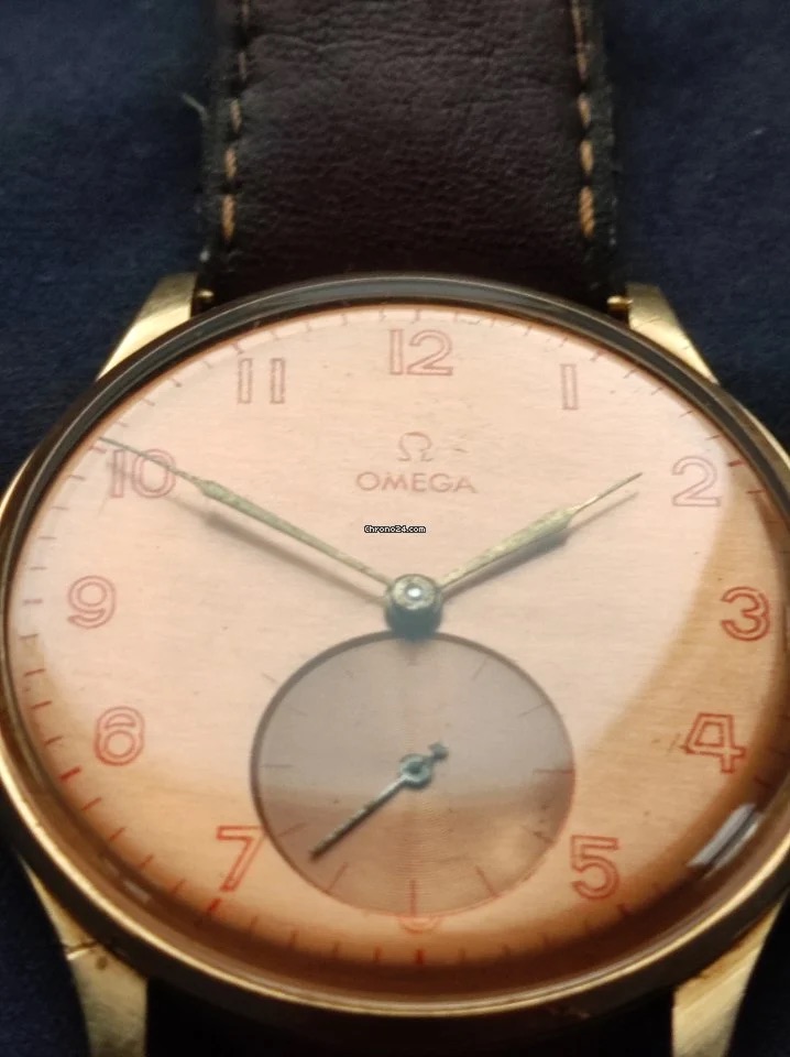

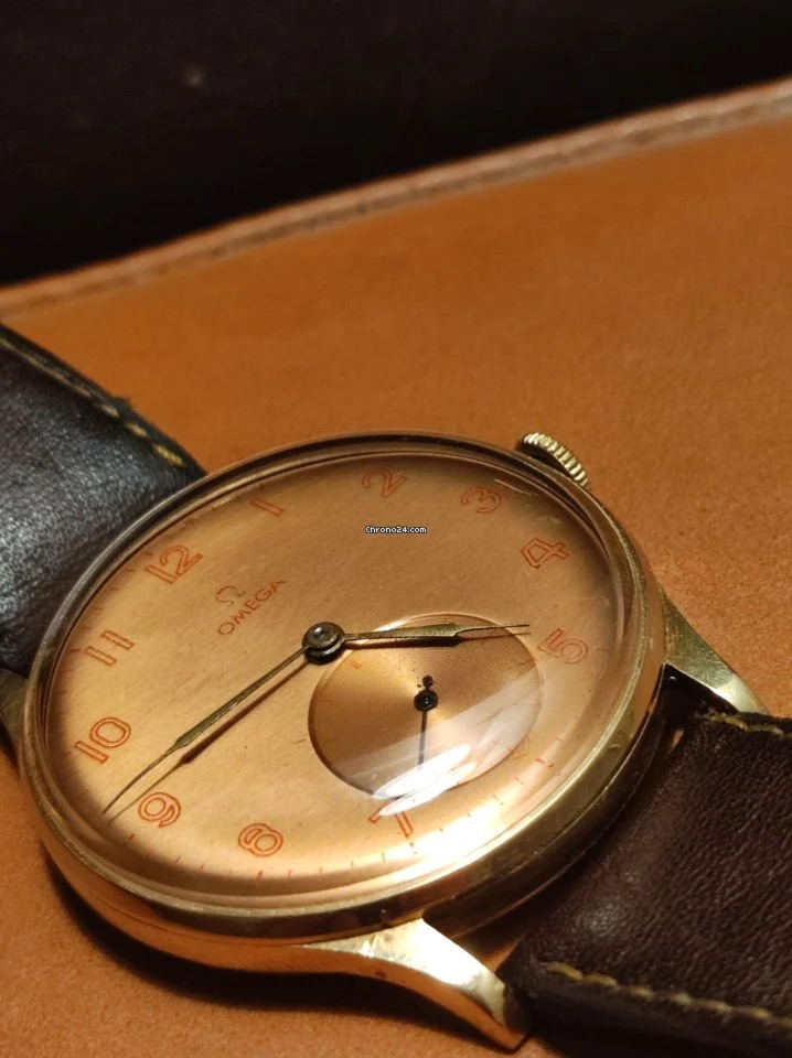

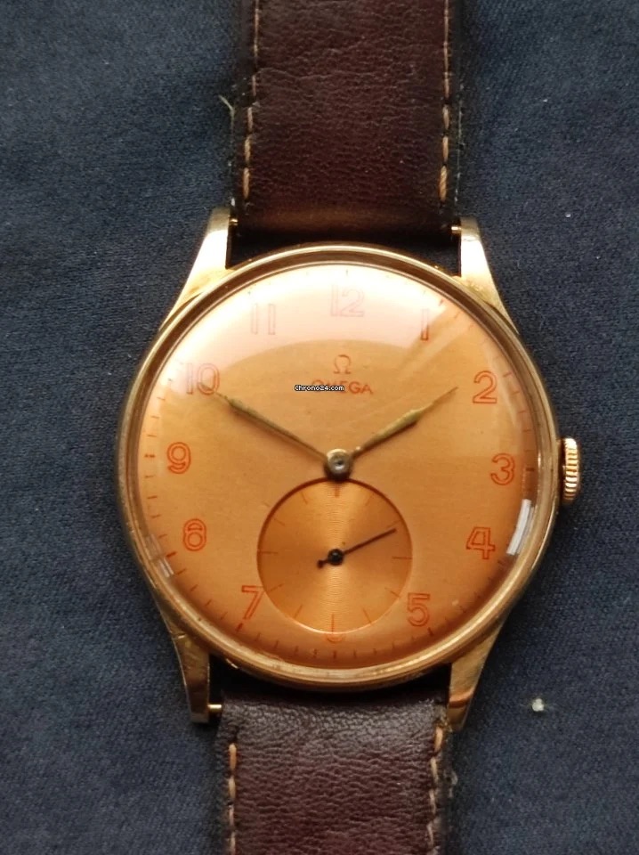

Looking at the watch below and wondering if the intelligentsia here have view on originality of the dial, case, etc. Apologize for picture quality. Thanks OF!
2,346
1,475
Refinished dial inside a generic case. One case screw not original
DON
21
14
Thanks. Saved me from making pricey mistake. Wondering what the “tells”’ are around being a refinished dial here? To my untrained eye, the Omega logo looks off and the seconds markers not as thin and sharp as they should, but the bad picture quality may distort that.
352
308
there is a difference between the state of the dial and the oxidized hands. it doesn't make sense to have a "clean" dial with hands that have suffered from humidity.

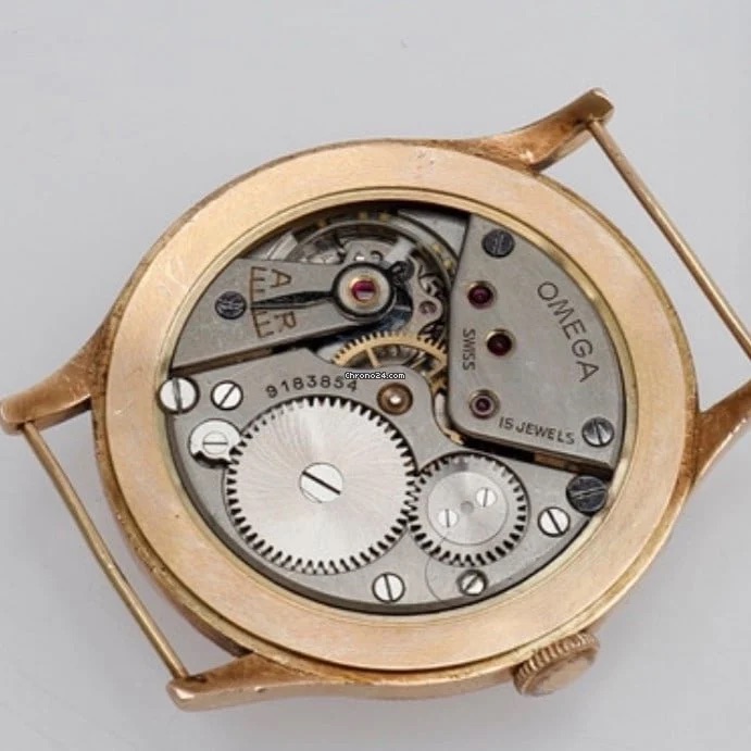

when something is not normal, you have to look for the other elements. there it's easy seeing the back of the watch, we've never seen that at Omega, it's too coarse.
anyway, post the pictures here before buying, there will always be someone to help you. over time, your eyes will get used to detecting fakes. do not hesitate to participate in other conversations, it helps a lot!
