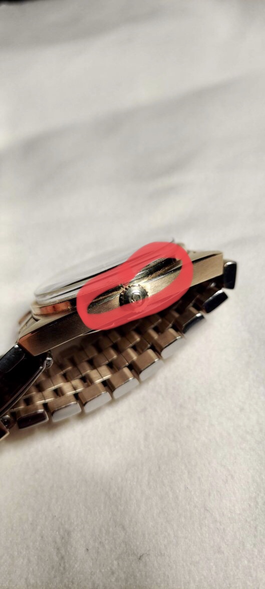

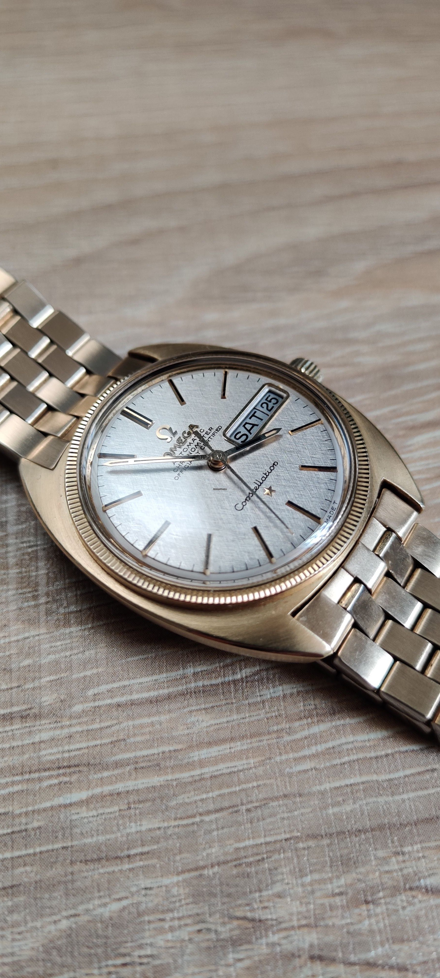

If this is wear of the gold plate in here it’s a no
I would ask for a photo of this exact spot that is clear. If the seller doesn’t agree don’t bother.
4
I will reach out to the seller and see if I can get a better shot of that area. In the description, it’s says the case is gold capped; I wonder if they meant gold plated.. May i ask what would be the concerns to make it a hard pass due to the eroded gold spot? Obviously if it’s a fake then that’s one thing. Just wondering if wear of the gold due to age is undesirable.

I don’t think many collectors buy Gold plated. I think 9 or 14 it may be ideal as they are quite tough. nomercy on this site seems to get nice Connies And kringkily as well and seem to get good feedback. I have looked and looked but not taken the plunge yet. I would pass - it looks too nice. I have noted before that sparkle and linen dial watches seem to be well preserved in general compared w standard.

It is 14ct gold cap - there are no plated Constellations of this type. "Gold plated" is sometimes used as a general term for non-solid gold pieces.
At $1400, I wouldn't look at this, but you'll have to decide if you want to invest time and effort into finding one better and cheaper, otherwise you're pretty much at the mercy of those who are best at marketing the watches they are selling.
It looks that way 🙁
Probably the victim of some enthusiastic polishing/refinishing.

Thanks I would have thought plated would wear off quite badly - do you Ever buy them?

Any wear through of gold on a case is a no to most here.....
13,674
19,043
The watch looks OK to me. Crowns on these were gold plated, even on solid gold cases. They are touch points and designed to be replaced every so often, like tires on your car. However, the recommended OEM replacement will have a different look.
The only issue I have here is that the price is too high.

I don't think it's the crown, but the area just above it where the case facet is. From the pictures, it really looks like it has worn/been polished through.
13,674
19,043
Hard to tell. These facets are polished to a mirror finish and will reflect light. It is difficult to polish through a 250 micron gold cap. The bracelet at 20 microns shows little or no wear through.
Better pictures are needed.

I know, but pictures 1, 6 and 9 in the OP shows the same change in hue in different lighting situations. Have a look at the hi-res version of picture 1, for instance.
My guess is that it has been refinished and was polished through accidentally. Perhaps due to wear from manipulating the crown?

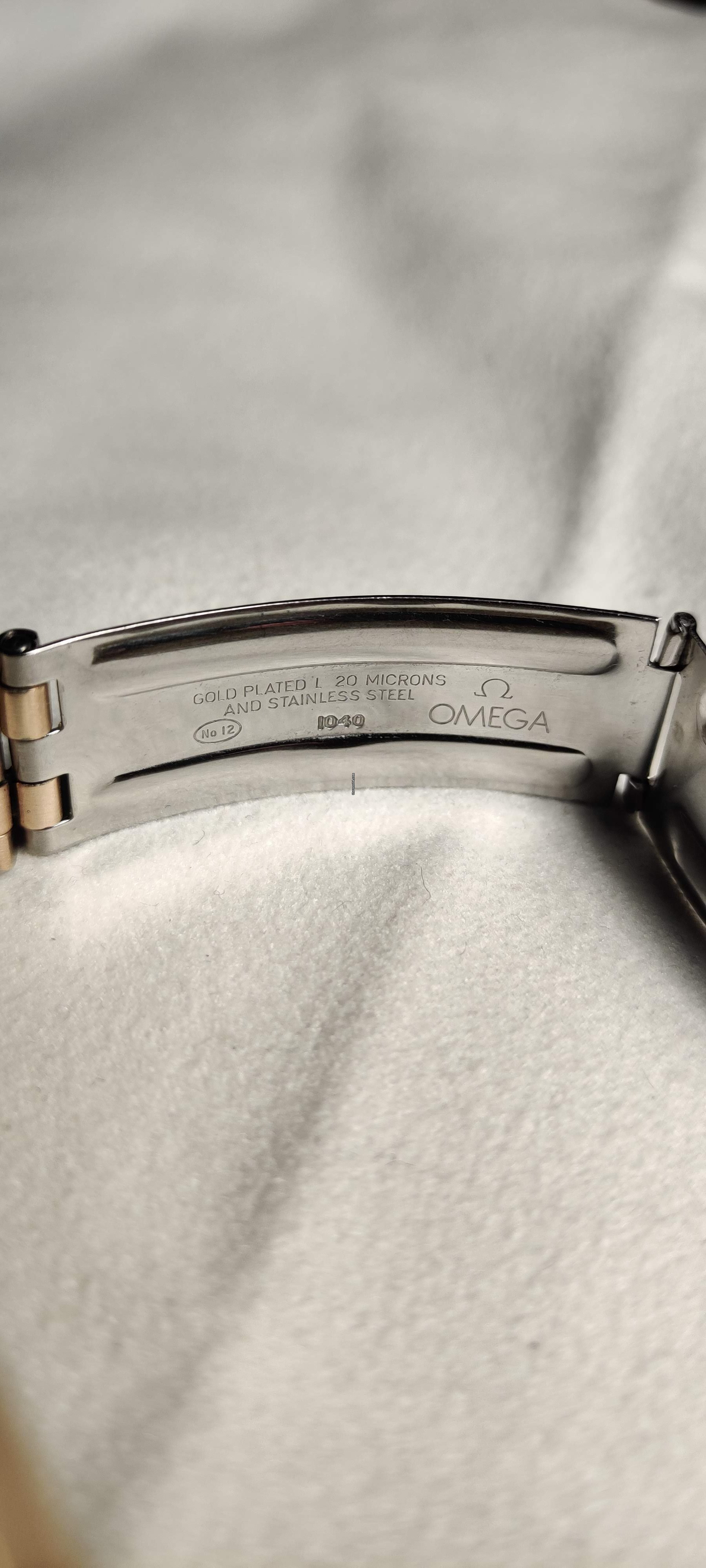

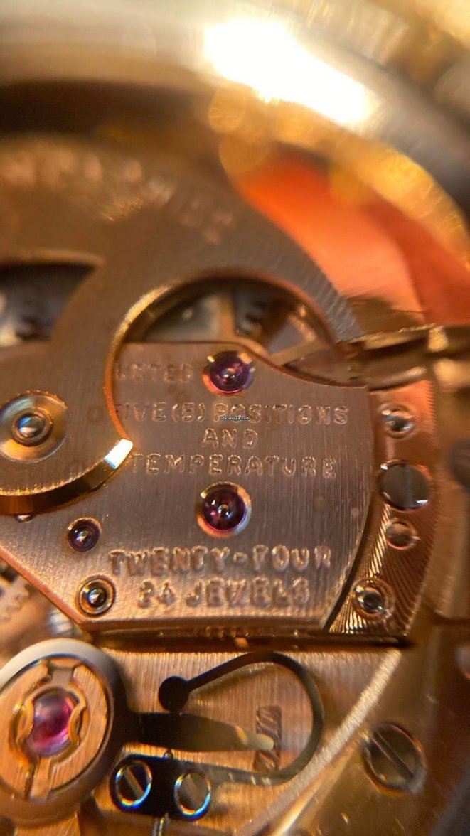

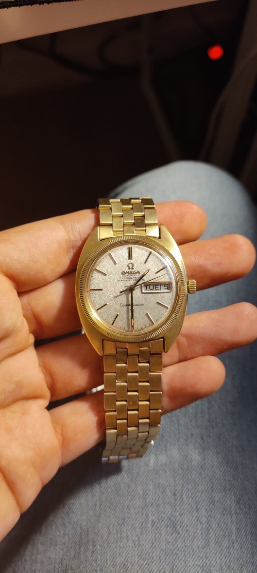

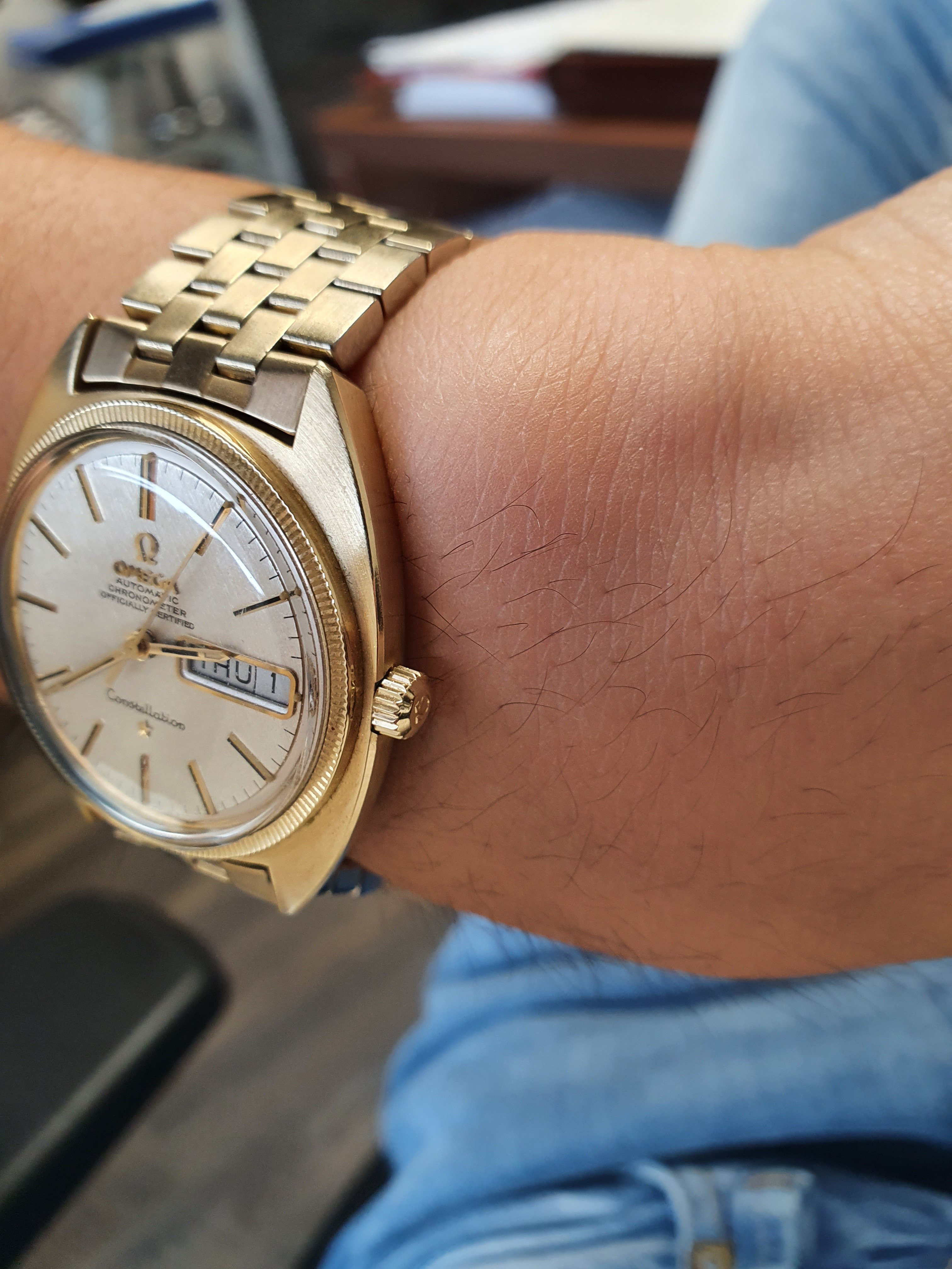

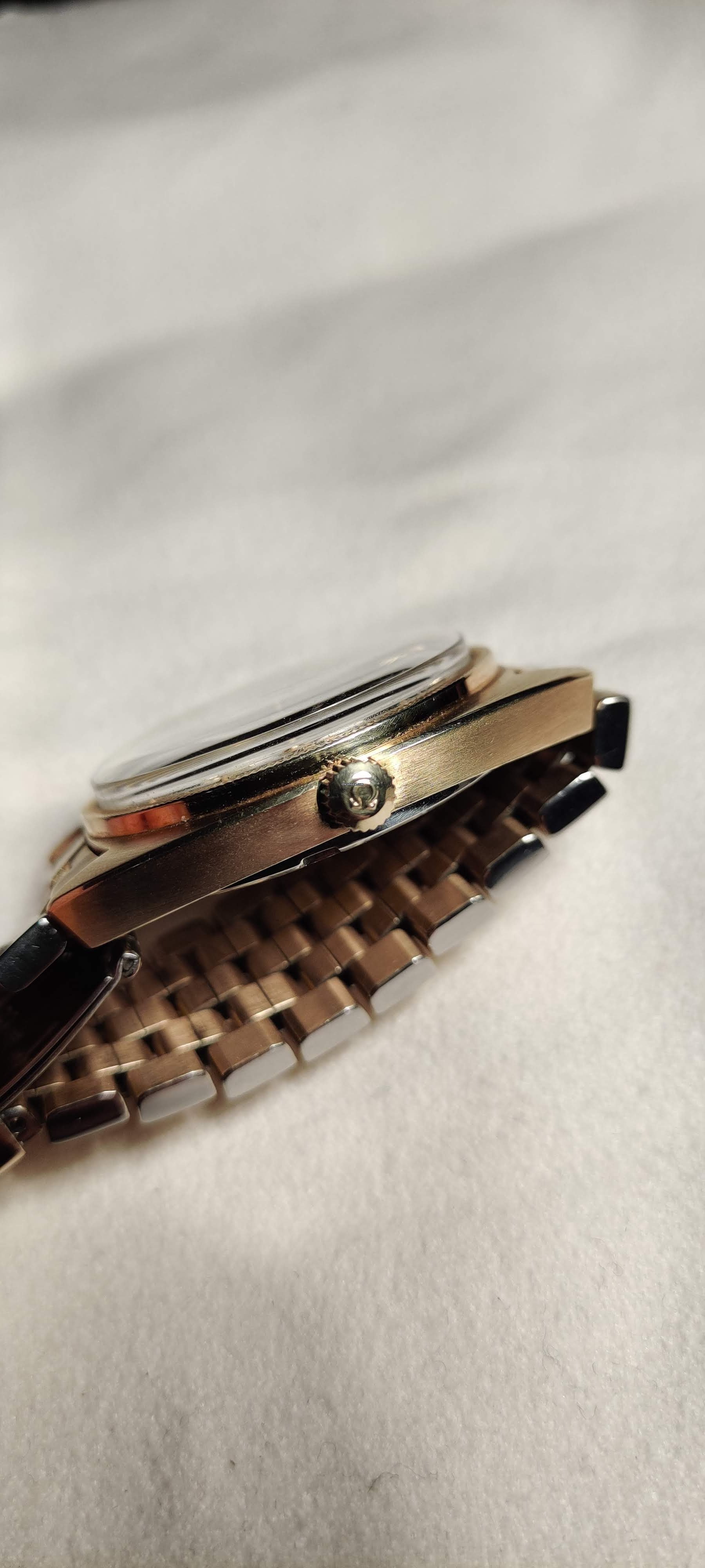

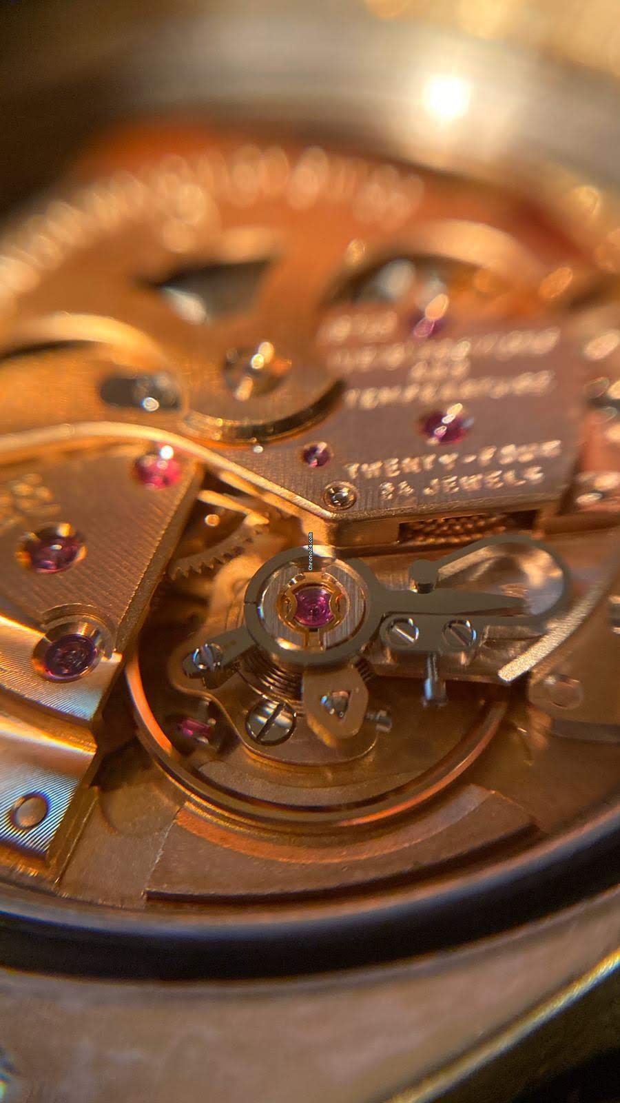

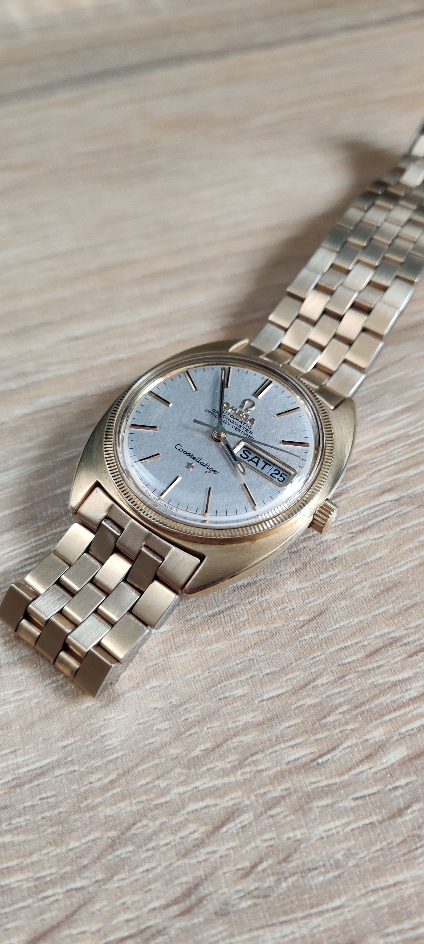

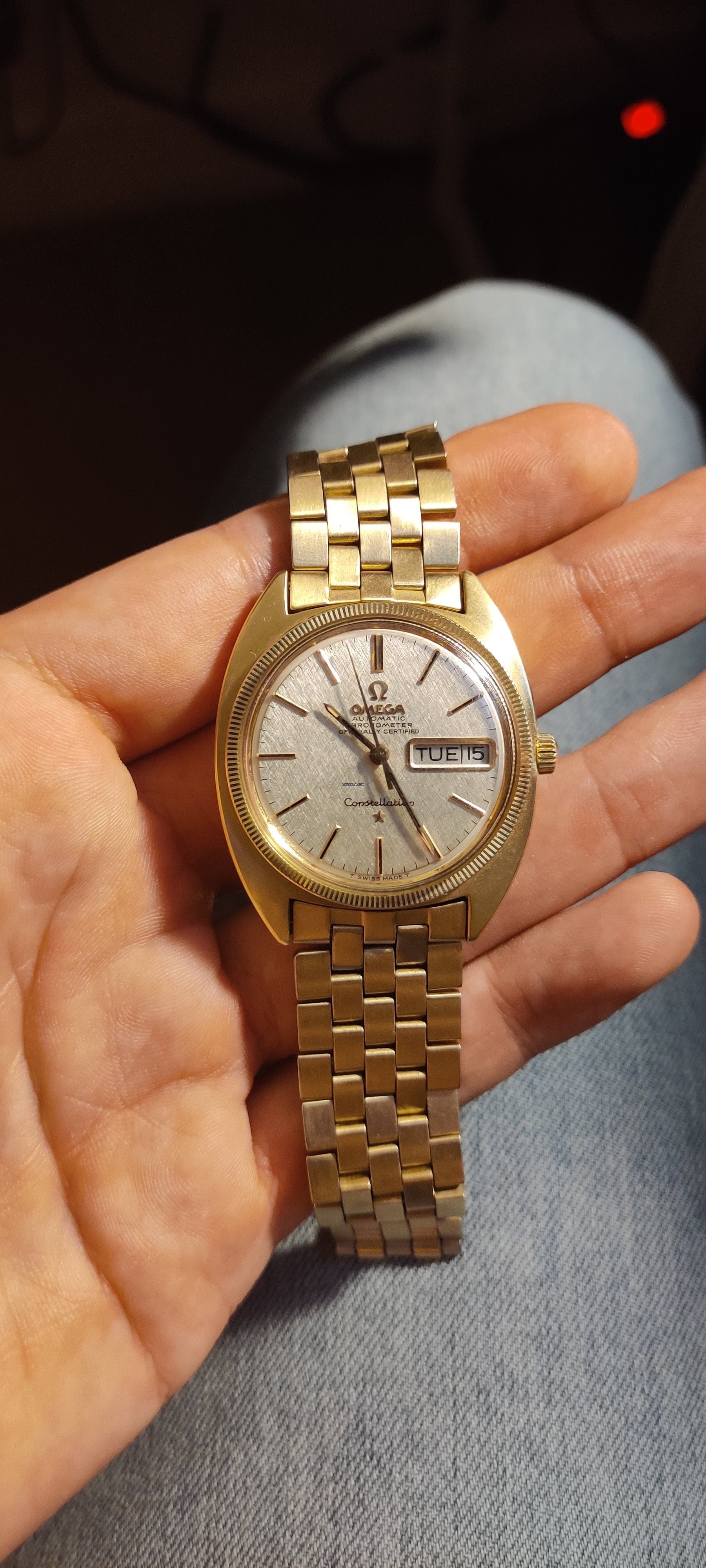

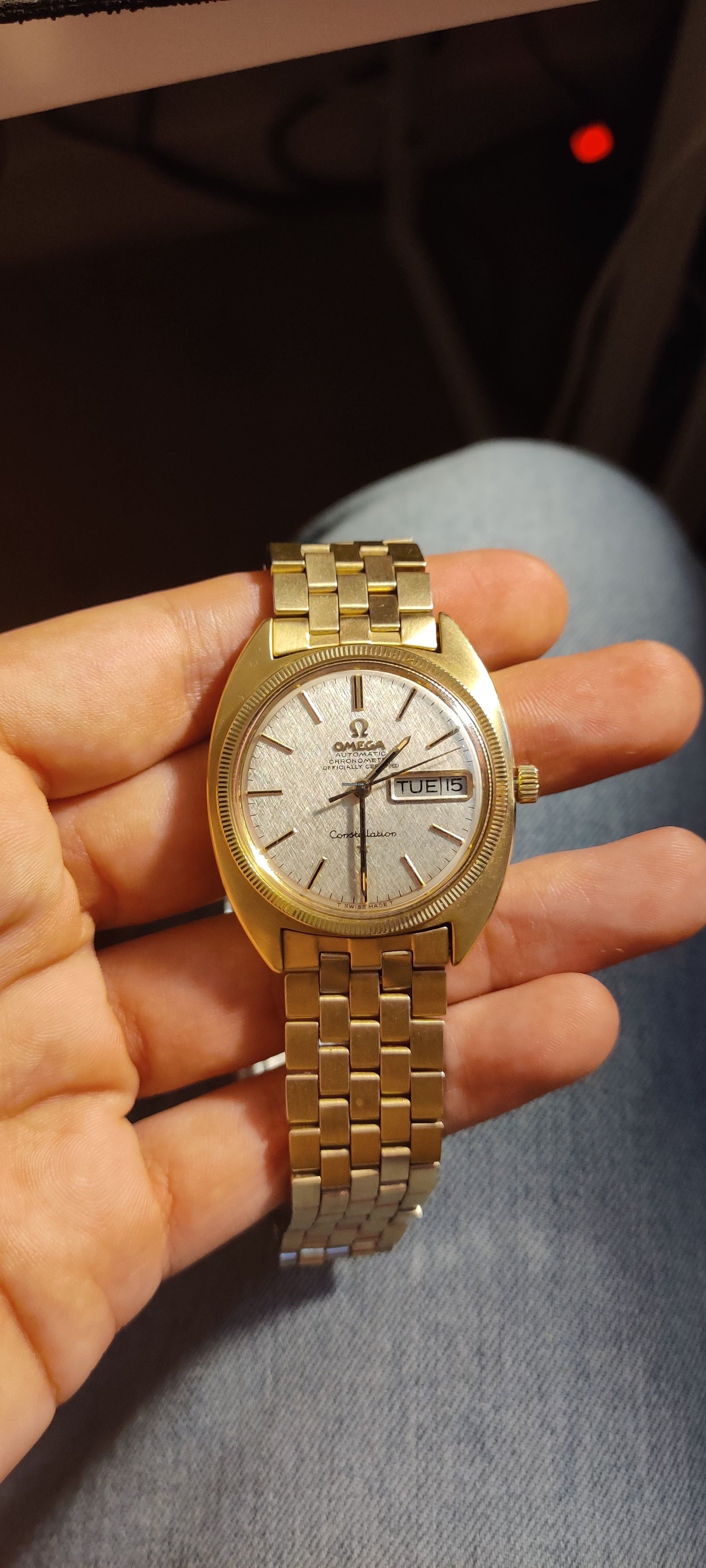

I am happy-end to find this thread. I purchased the watch! The light is killing the polished surfaces but you can see on the photo that the polished edge is the same color as the bezel(solid gold).
A photo of the actual state, on my wrist.
4,593
10,813
You have a good eye and yep she is a beauty. I am also a big fan of those Gold capped C case models with bracelets. Pure snazz!
