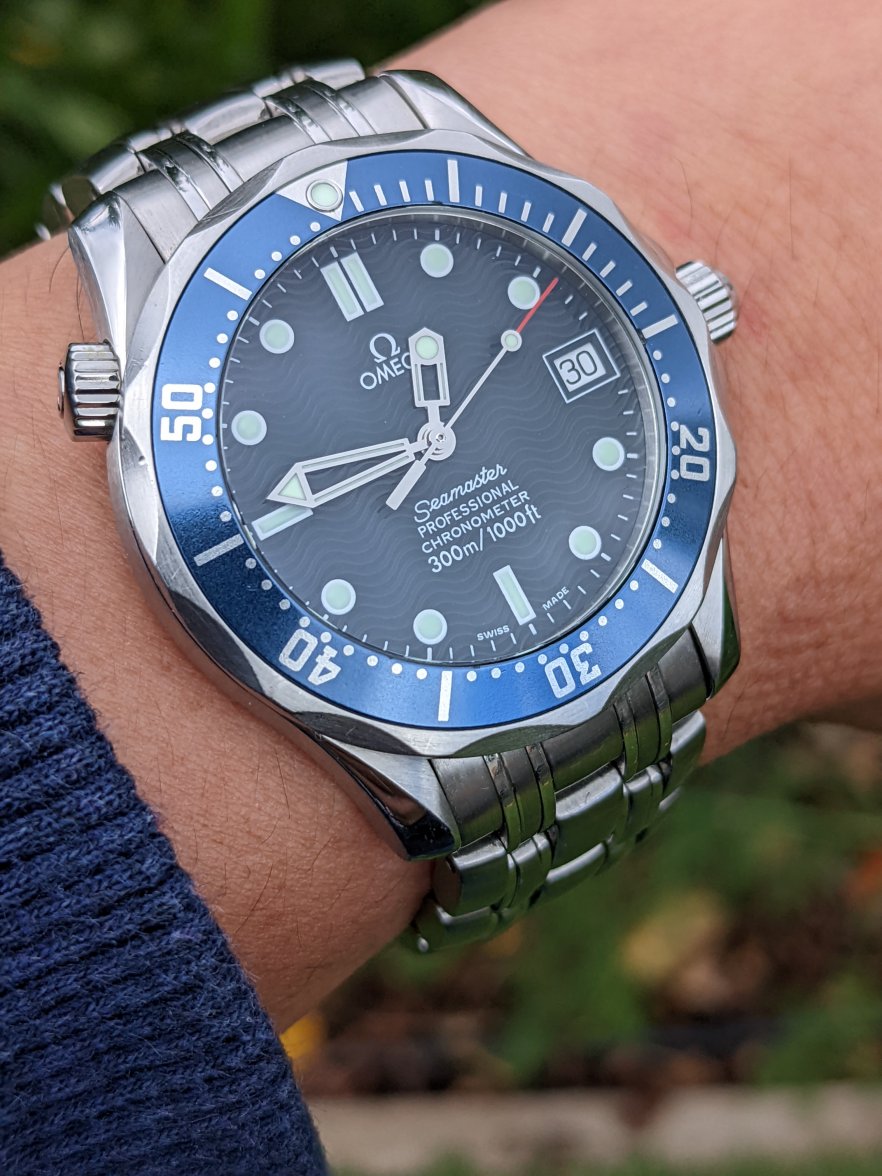

Obligatory watch pic:
They really are great watches.

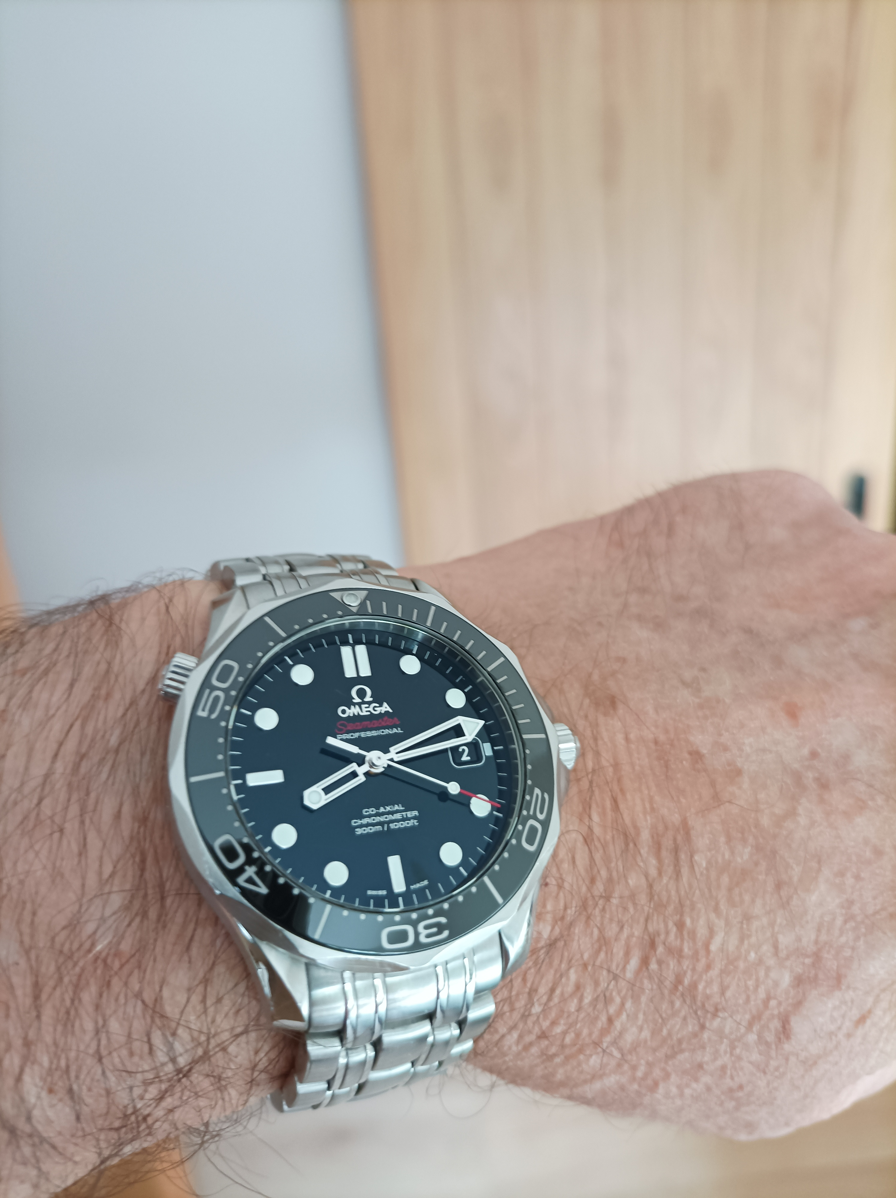

I have one of these, bought new in 2016. I love it and it is my go to watch for all activities, I have been very remiss in some of the things I have done with it, DIY, engine servicing, gardening, boat maintenance, skiing, etc, etc, and it deals with it in its stride, it is very robust, despite all the abuse I have subjected it too it remains accurate, -4sec a day all day everyday since day one. It has its battle scars but not too many. The bracelet has probably the worst wear but nothing that affects it's functionality, there is no stretch so far.
It also looks great in the office or at social and dinner events, It even has enough bling to be noticeable to the younger Instagram generation, a 23 year old friend of my daughters was all over it last Saturday.
So, in answer to your questions, I have no doubt that this watch will last a lifetime, it will see me out and I also plan to leave it to my 19y.o. son.
I haven't serviced it yet but plan to do so next year when it is 7 years old, servicing I would recommend for sure.
I'm afraid I don't have a micro adjust clasp so can't advise on that.
Regarding whether you get the newer one with the Metas cert, again, not sure I can answer that I could answer that, I'm not that focused on accuracy, a few seconds a day doesn't bother me.

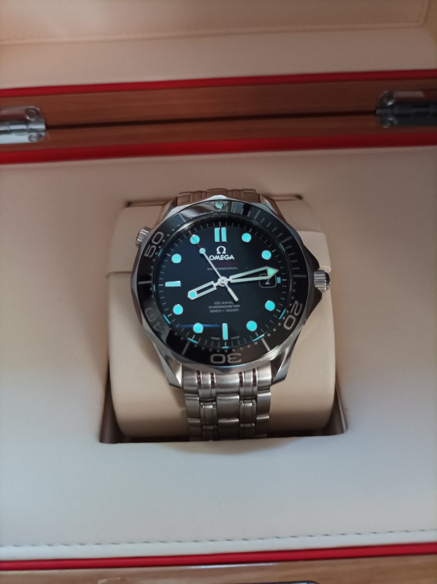

It's a great watch, the dial is amazing, deep glossy black, sometimes bottomless if that makes sense, great lume, the case is amazing and bracelet very comfortable, it wears very well indeed , I really do think it is nicer than the newer generation but I am biased, one thing I can say for sure is that you will not be disappointed with it.
And as no post is complete without a couple of photos
