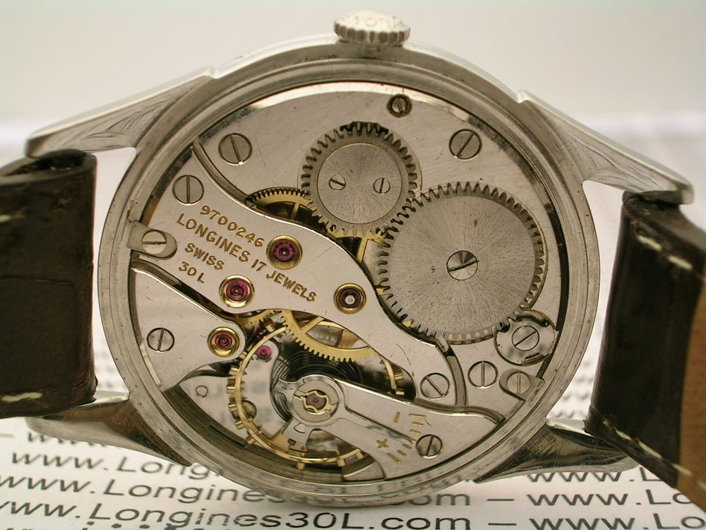

810
1,654

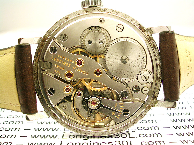

Serial Num: 9693340
Reference: 6691
Invoice Date: 10/21/55
Importer: Girod
Serial Num: 9700246
Reference: 6692
Invoice Date: 11/11/55
Importer: Girod

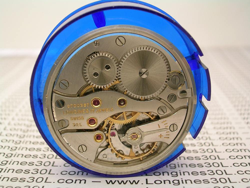

Serial Num: 9700387
Reference: 6691
Invoice Date: 3/26/56
Importer: Girod

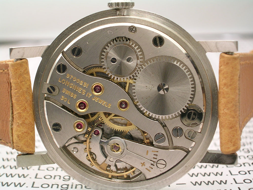

Serial Num: 9700231
Reference: 6691
Invoice Date: 7/20/56
Importer: Girod
Besides my example (Serial 9693860) the above are 4 additional 30Ls with chronometer like movements. All were sent to Girod in Spain in late 1955 or early 1956. There is also an example that was sold by Kaplans in 2014 (Serial 9700526) which I don’t have a movement shot of but am virtually certain would have the same traits as it matches my watch in every way.
Taking these additional examples into account, I don’t believe these are just random occurrences:
1. Same importer / same country / same reference / same timeframe - if these were leftover parts or movements, similar examples should be popping up in other locations and in other references but there are none that I’ve found.
2. There are watches from roughly the same time period that do not have the truncated regulator arm. This reaffirms the period advertising that I posted above, which shows the elongated regulator arm and suggests the difference between movements existed from the beginning of production.

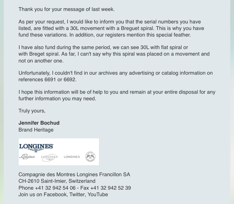

Well, I believe this is the first time they’ve confirmed this. I know Havi from 30L had asked previously with no success.
The archives confirm at least the six examples I have found were fitted with Breguet overcoils. It also confirms that 30Ls from this period were shipped with flat coils, meaning the variation existed from the beginning of production. And, to my knowledge, all of the examples pre-date the first certified 30L chronometers.

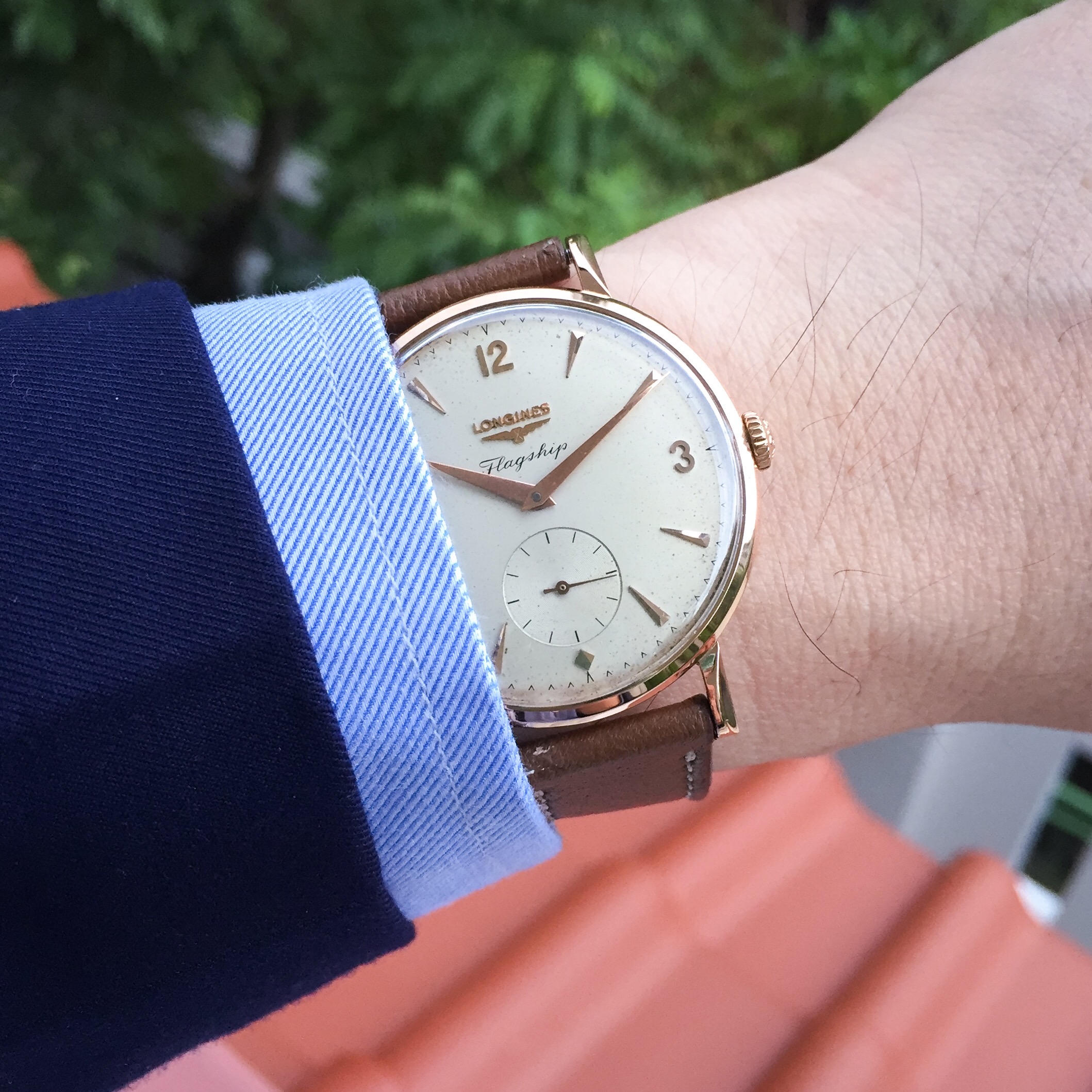

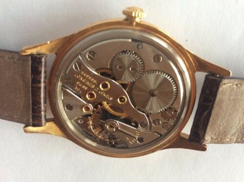

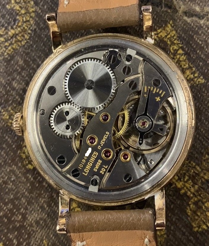

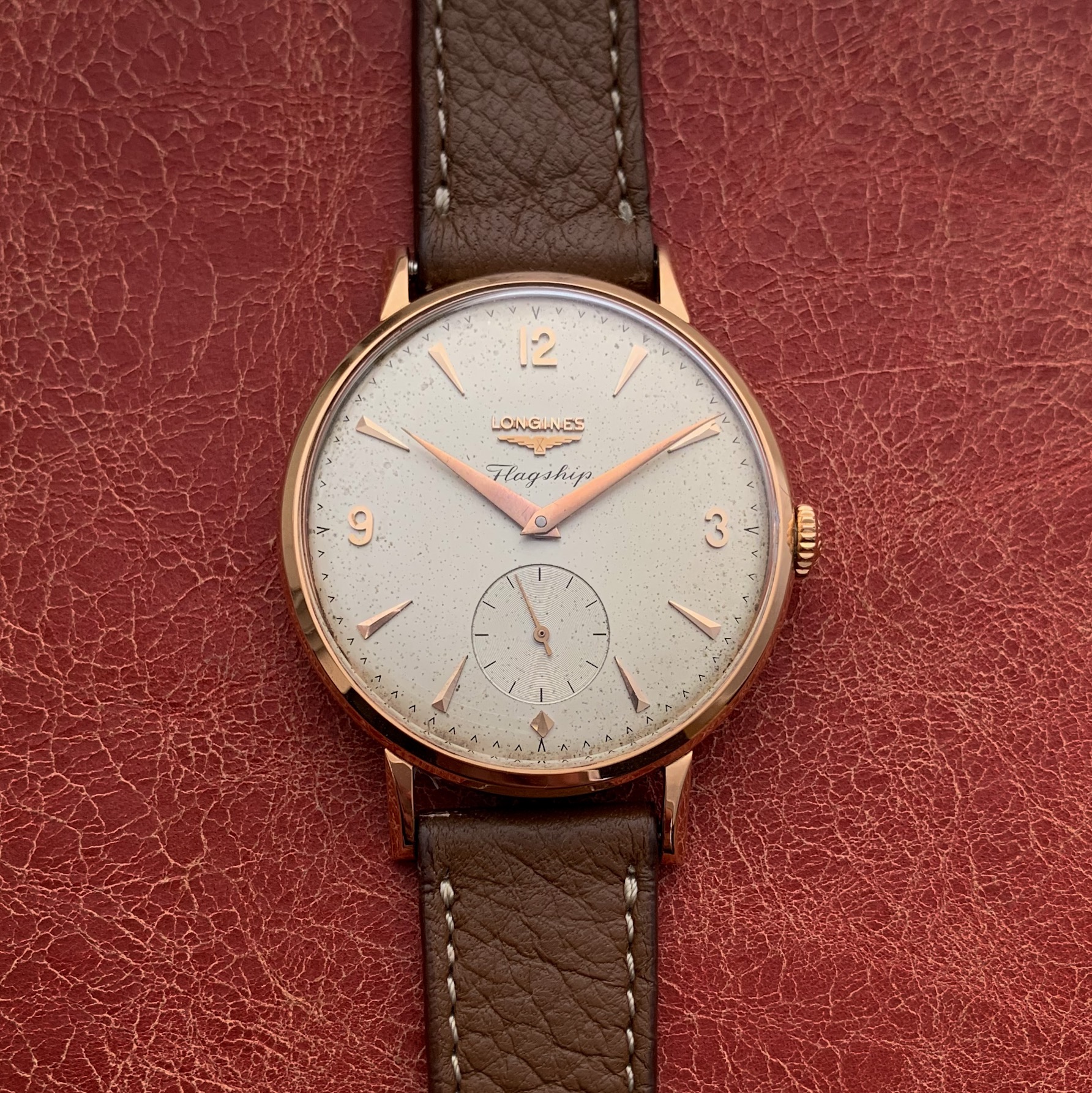

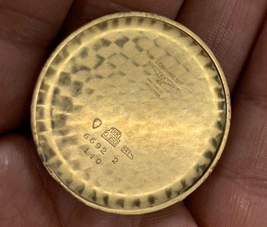

hi everyone,
I recently got a Longines Flagship ref 6692, and since there's little info on the web, I thought I'd try to add on to what's been said in this thread about the ref 669x watches.
Like @Rumar89 's 6691 & 6692, my 6692 has a 30L inside, movt 10.19 million. Case size is a jumbo, 37.6mm, in rose gold. Similarly, the Longines Archive has informed me that (1) my case and movt match (whoopee!) and (2) the watch was invoiced to Girod in Spain on 5 Jul 1957.
seller's pics
It's pretty nice on the wrist, given it's jumbo size.
2,936
15,043

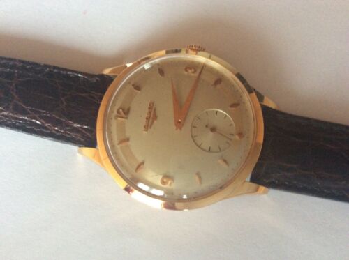

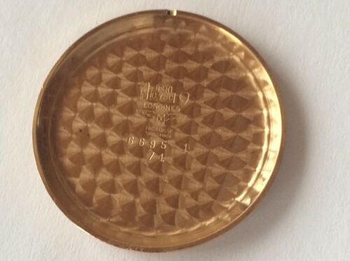

Another interesting one - a Rose Gold Longines 6695-1 popped up on Ebay.
Seller's pics aren't the best, but it's supposed to be 37.5mm (like mine), and has a serial number of 9.69 milllion , very close to the ones @Rumar89 posted. So perhaps another one from Girod? Anyway, thought I'd add to the info about the 30L ref 669x watches!

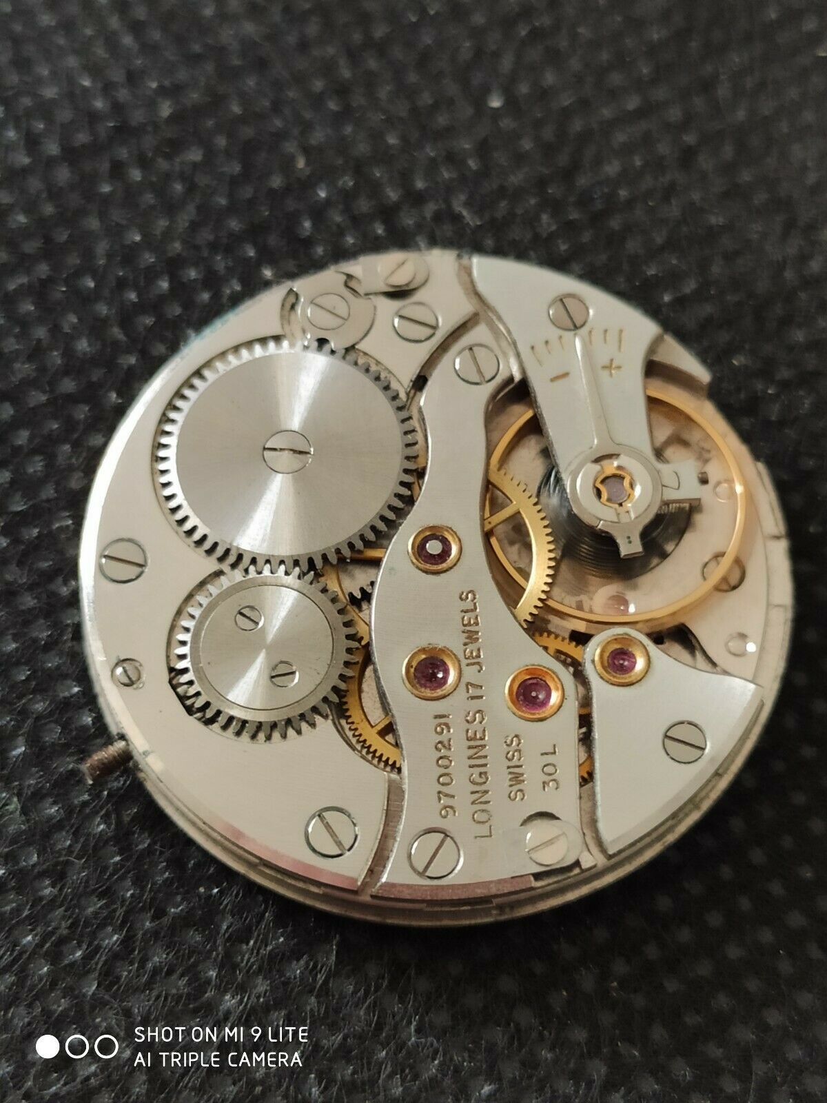

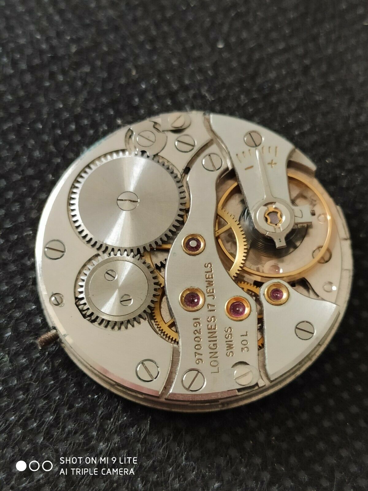

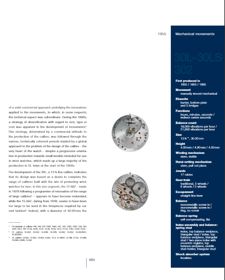

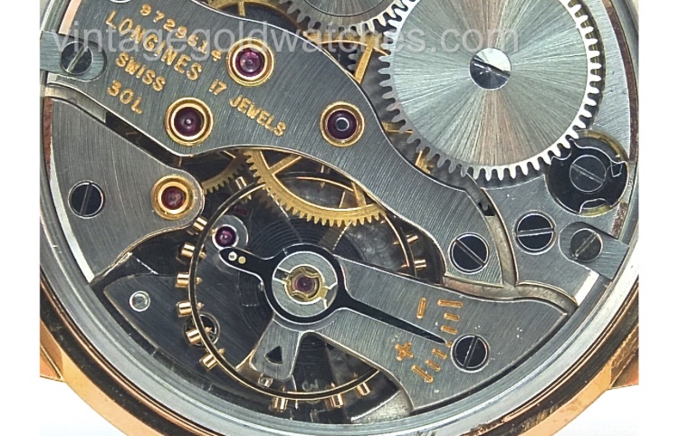

Another lovely cal. 30l member of ref. 669X, Girod, Spain, chronometer parts, # 9 700 291
Thank you for your message and the information provided.
Further to your request, we are pleased to provide the information contained in Longines' handwritten registers.
The original serial number 9'700'291 identifies a wristwatch in 18ct gold bearing the reference 6693. It is fitted with a Longines manually wound mechanical movement, caliber 30L. It was invoiced on 11 November 1955 to the company Girod, which was at that time our agent for Spain.
For your eas reference, please find attached an extract from the book by Patrick Linder "At the heart of an industrial vocation - Longines watch movements (1832 - 2009)", with the pages dedicated to the caliber 30L.
We trust that we have responded satisfactorily to your request and remain at your entire disposal for any additional information.

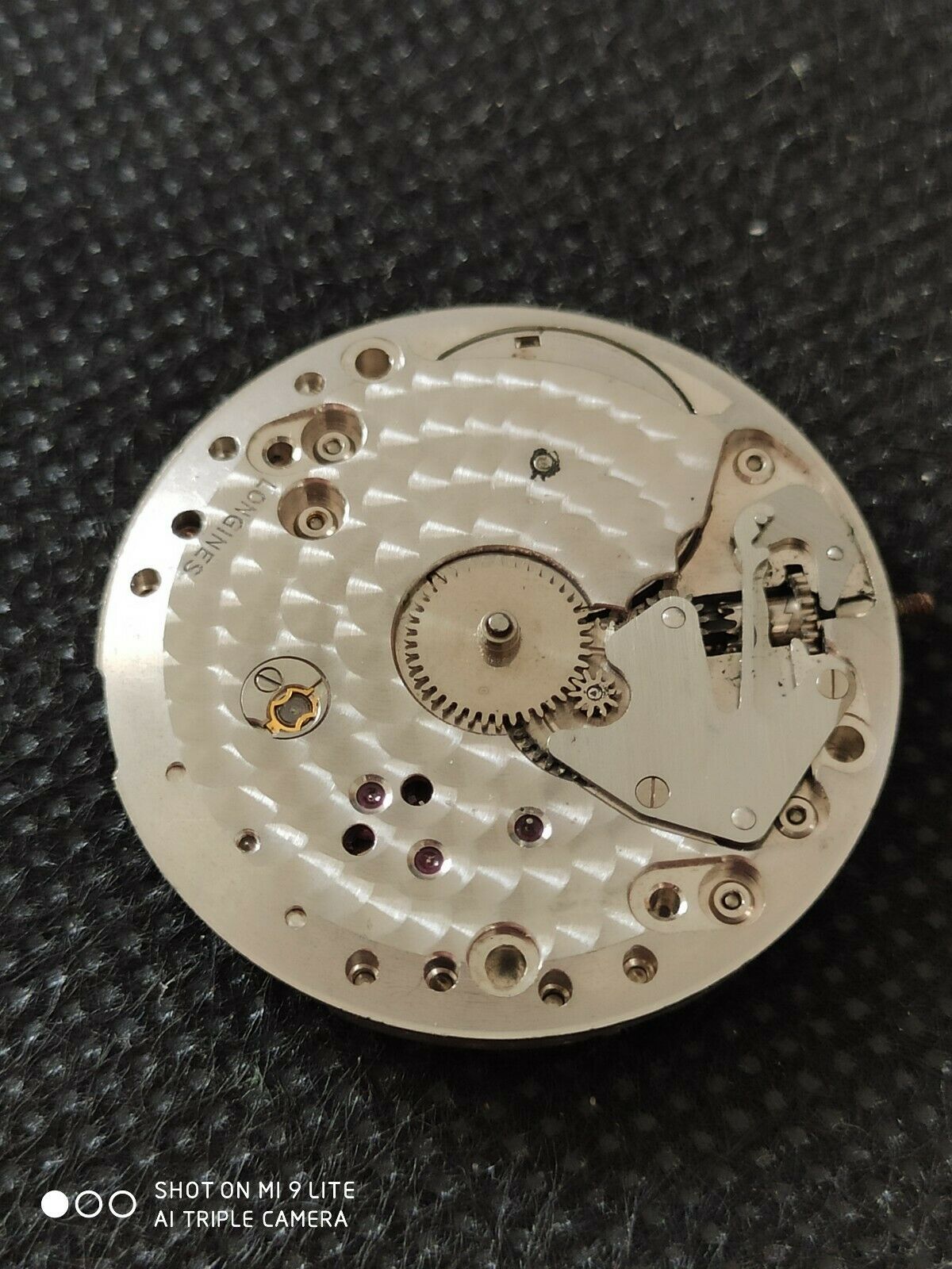

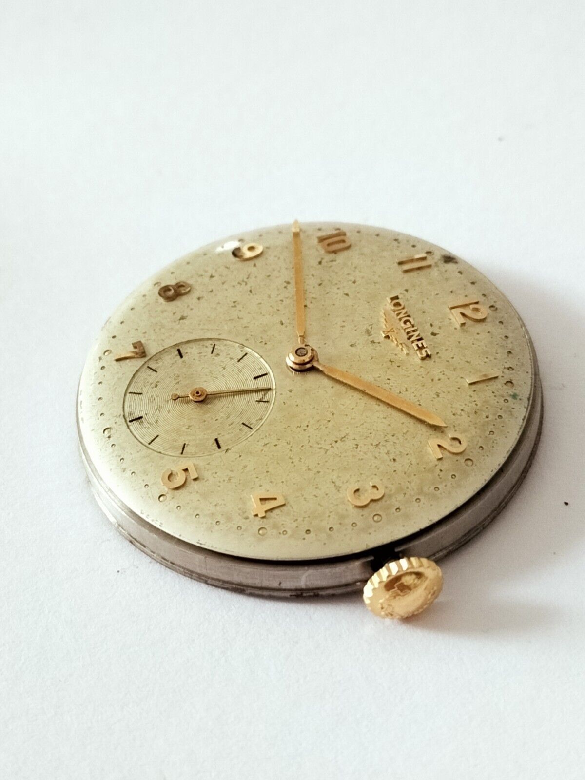

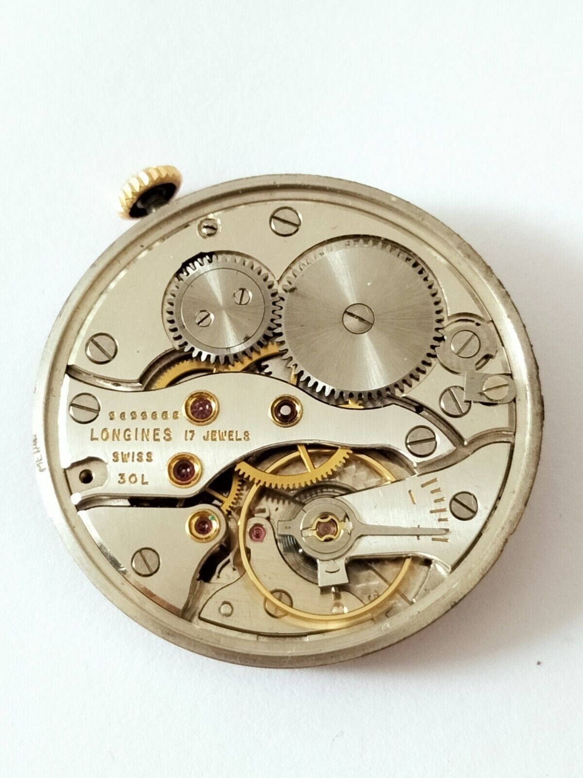

4
3

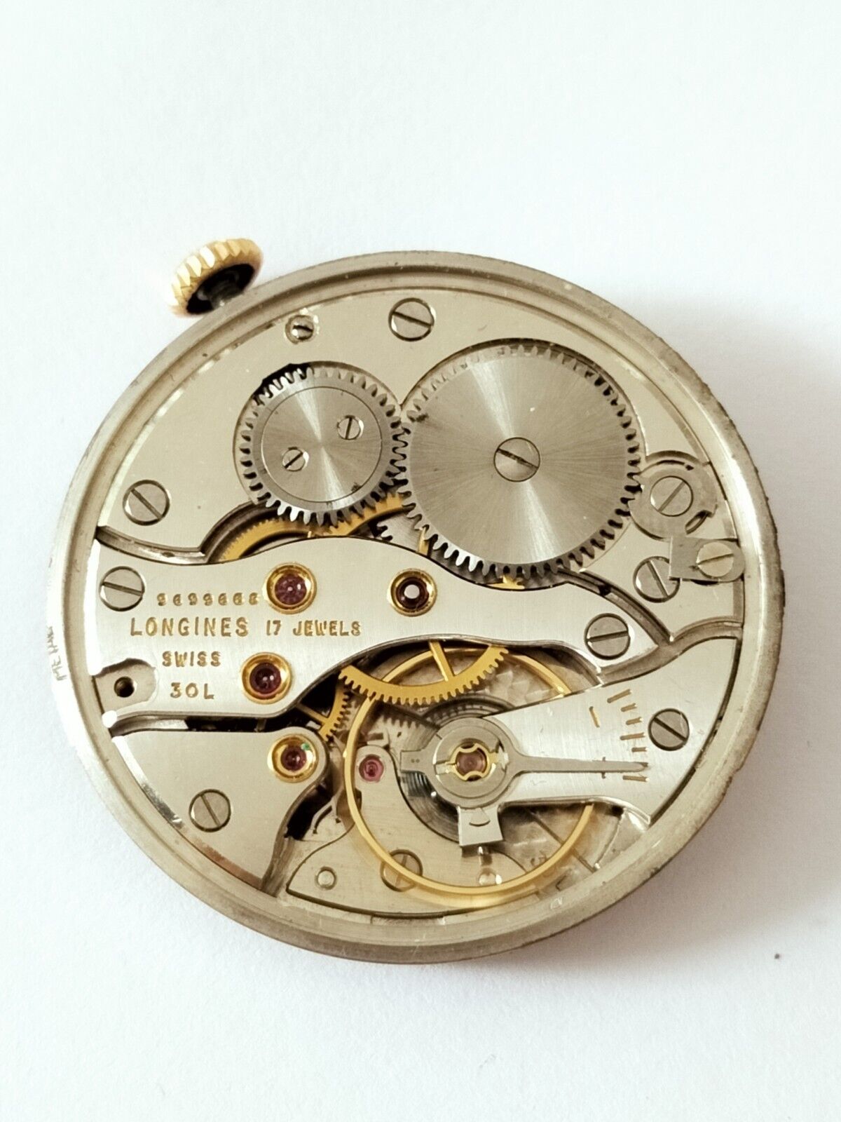

+ 1, same quality, from ref. 6691 in gold, Girod, invoiced March, 19, 1956, # 9 699 668. A question - in golden vintage watches of 50's - what are numerals and hands made of ?
