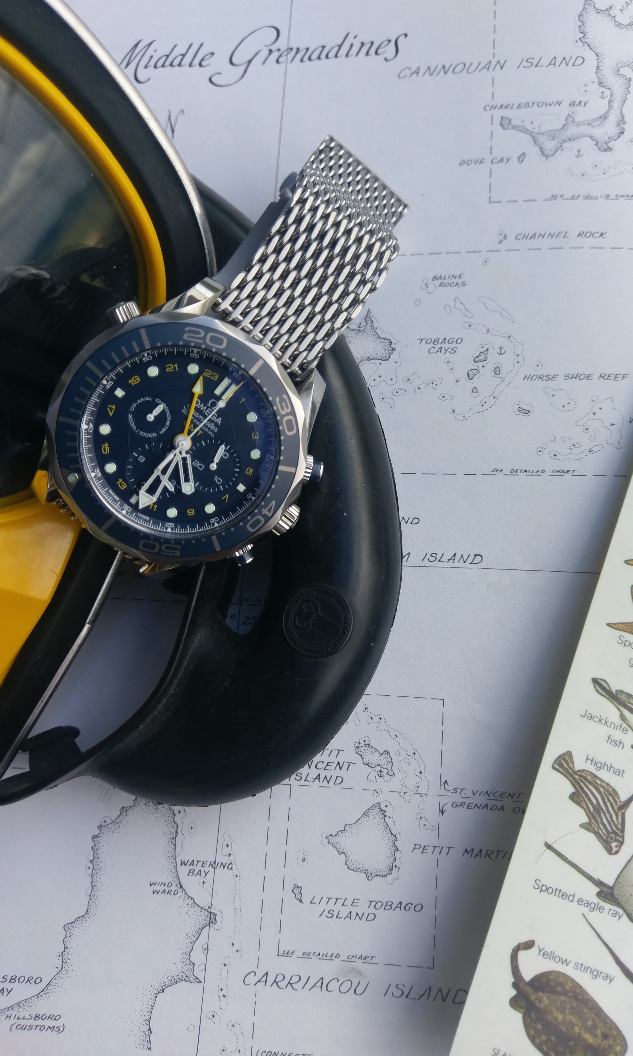

Yes, this is a good explanation on setting the GMT and then your local time. I believe I have the same watch.
Omega Seamaster Diver 300m Co Axial GMT Chronograph 212.30.44.52.03.001 Calibre 3603.
It took me a few reads of the manual and tries to get it right.

Looks good on the mesh
