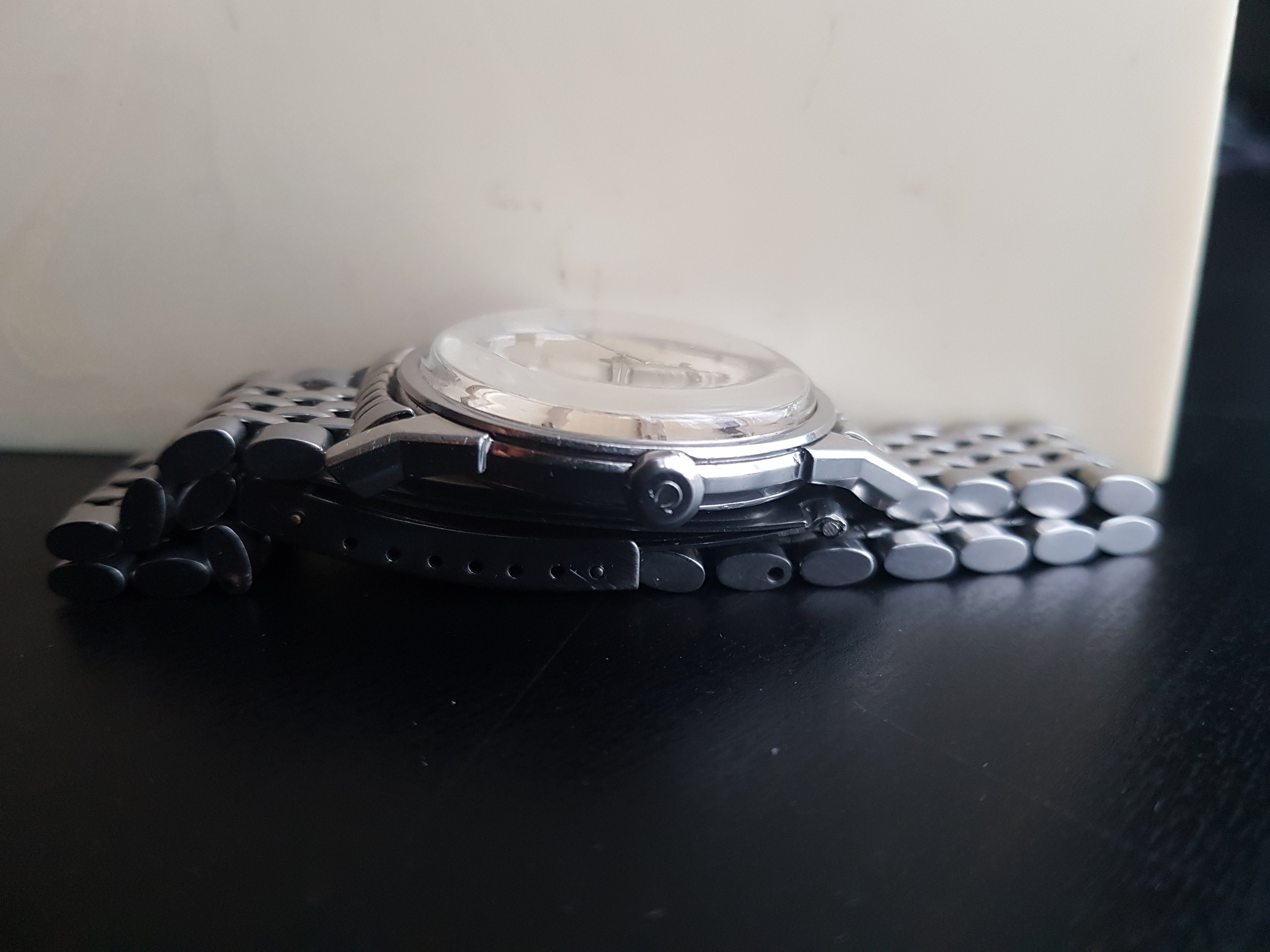

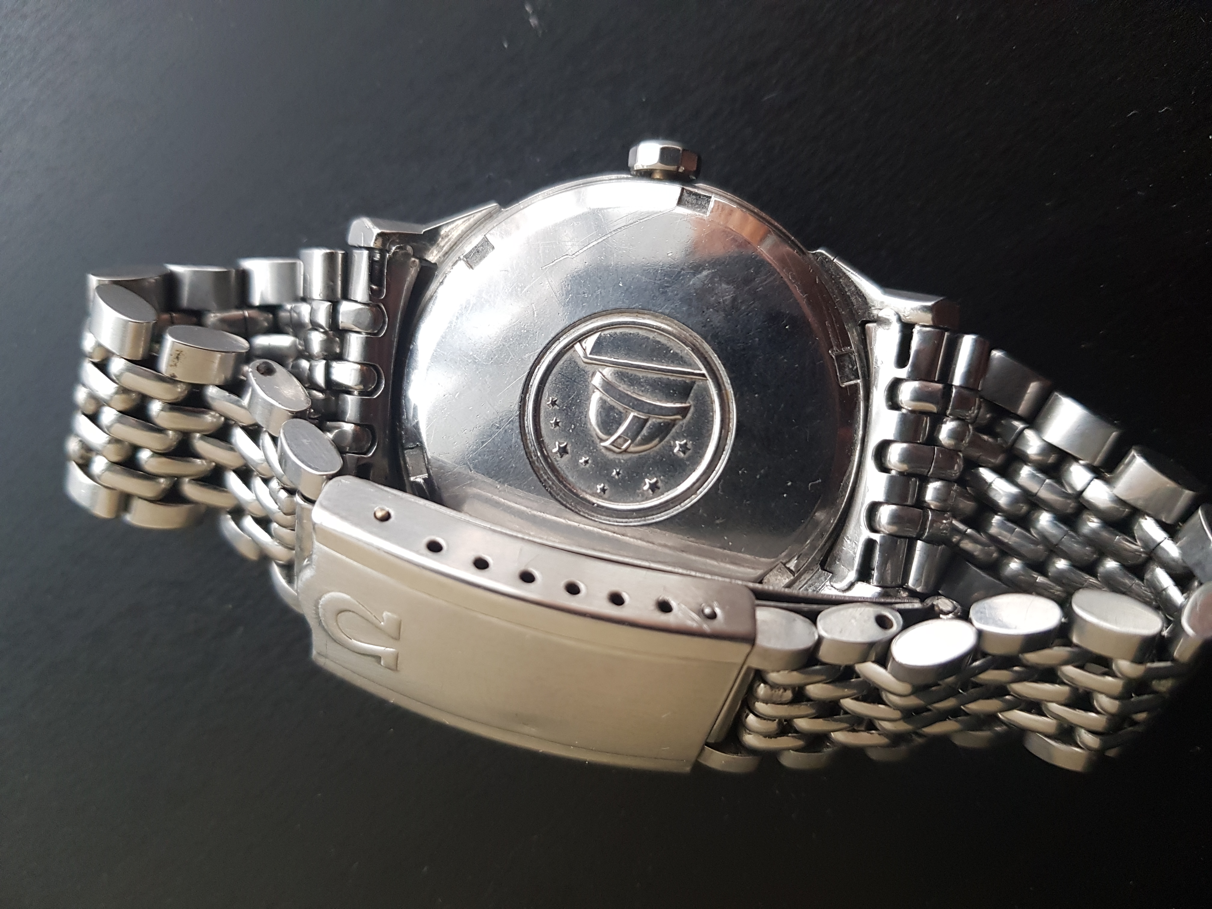

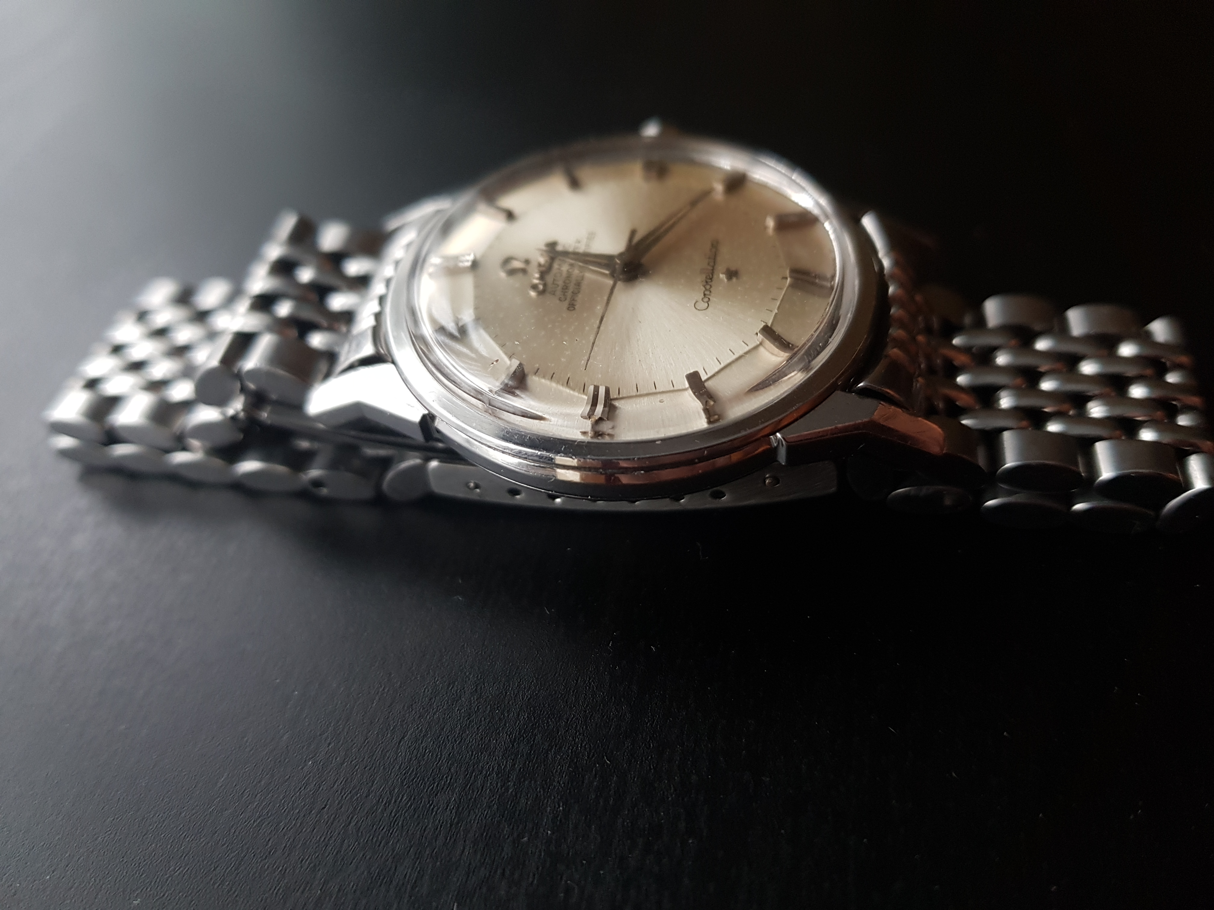

My wrists are 7.5"/ 190mm and the braclet when closed just about fits on my wrist. I wouldn't be able to wear it as the bracelet pinches my skin. I would like your collective advice on whether I should source a band link to extend the bracelet or am I better off fitting an after market BOR bracelet to the watch?
Your thoughts and comments are welcome.

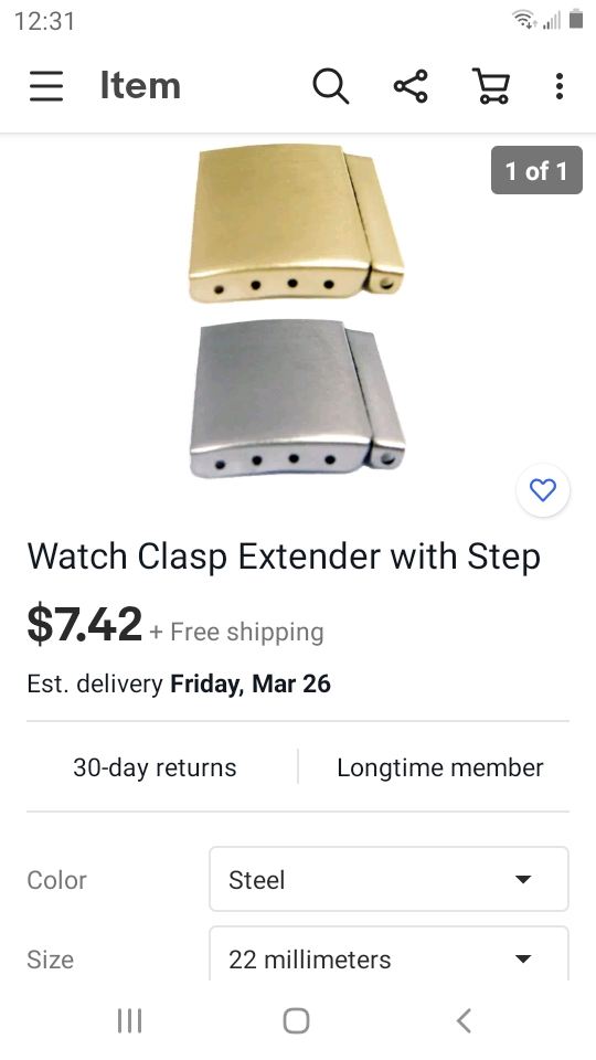

Make sure you get the correct width.
Or . . . If you don't want to deal with all that, I could unburden you. I have skinny wrists and am sure it would fit me. 😉

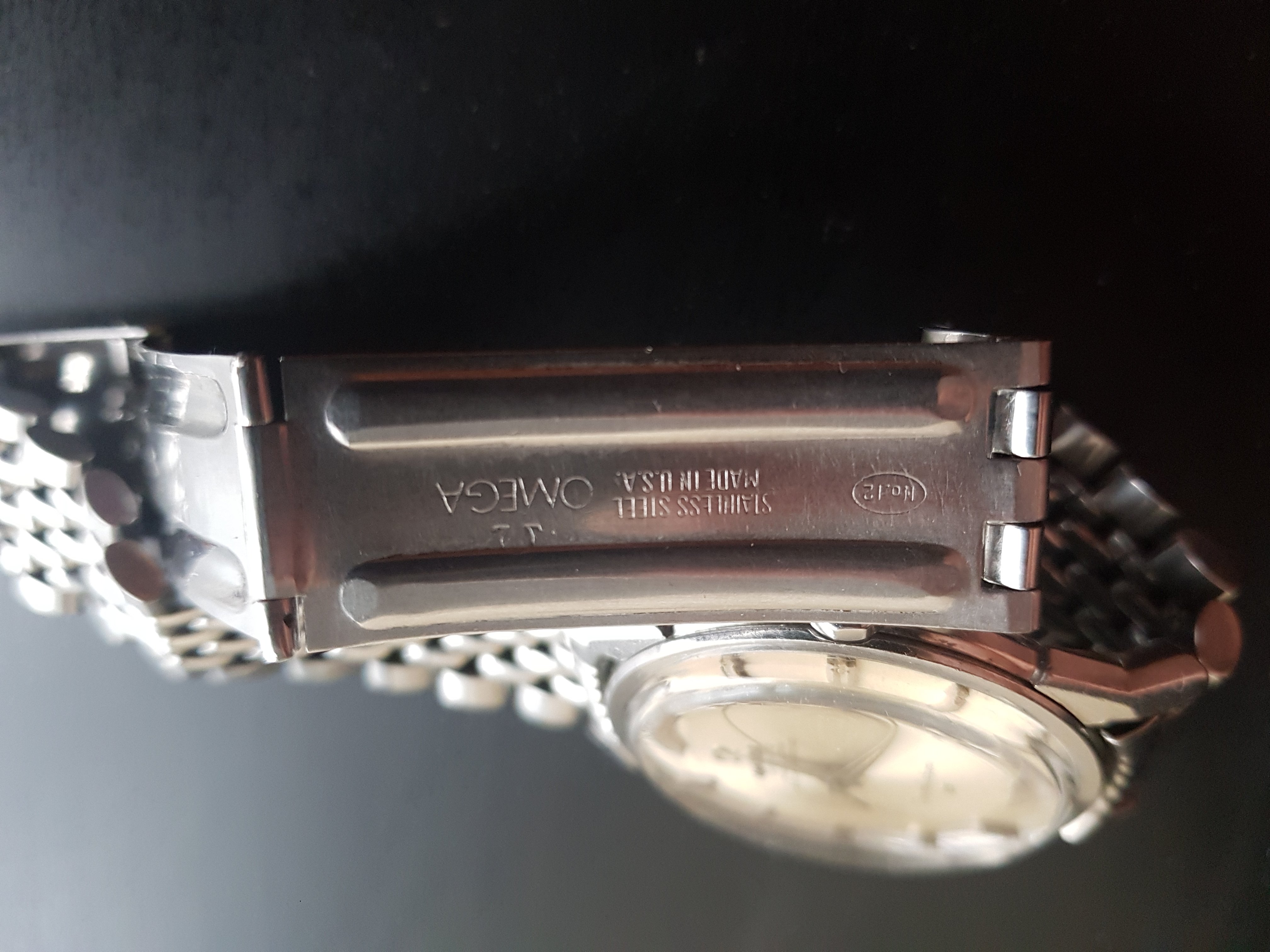

Hi Kit-kat and welcome. We need to see the stampings inside the clasp to know the model of the bracelet, but I fear those endlinks are not Omega- they should be stamped with a number (if from a Seamaster, it would be 11 or 12). I would want to see the inside clasp to verify if the bracelet is factory or not. There were several models of the 5-row BOR and 7-row BOR, the later I believe is what should be on this watch with 70 endlinks.

Looks like you added the clasp pic while I was typing. Made in USA bracelet wouldn’t have the numbers on the eindlinks- I am guessing the whole bracelet is from a Seamaster. You can add links to this bracelet (after the ones with holes) but you need to make sure you get the correct kind.
I would frankly just hunt down a 7-row BOR that is the right length with 70 endlinks- the fit to the case will be much better

Thank you @wagudc, that will be a great short term fix until I can source additional links.

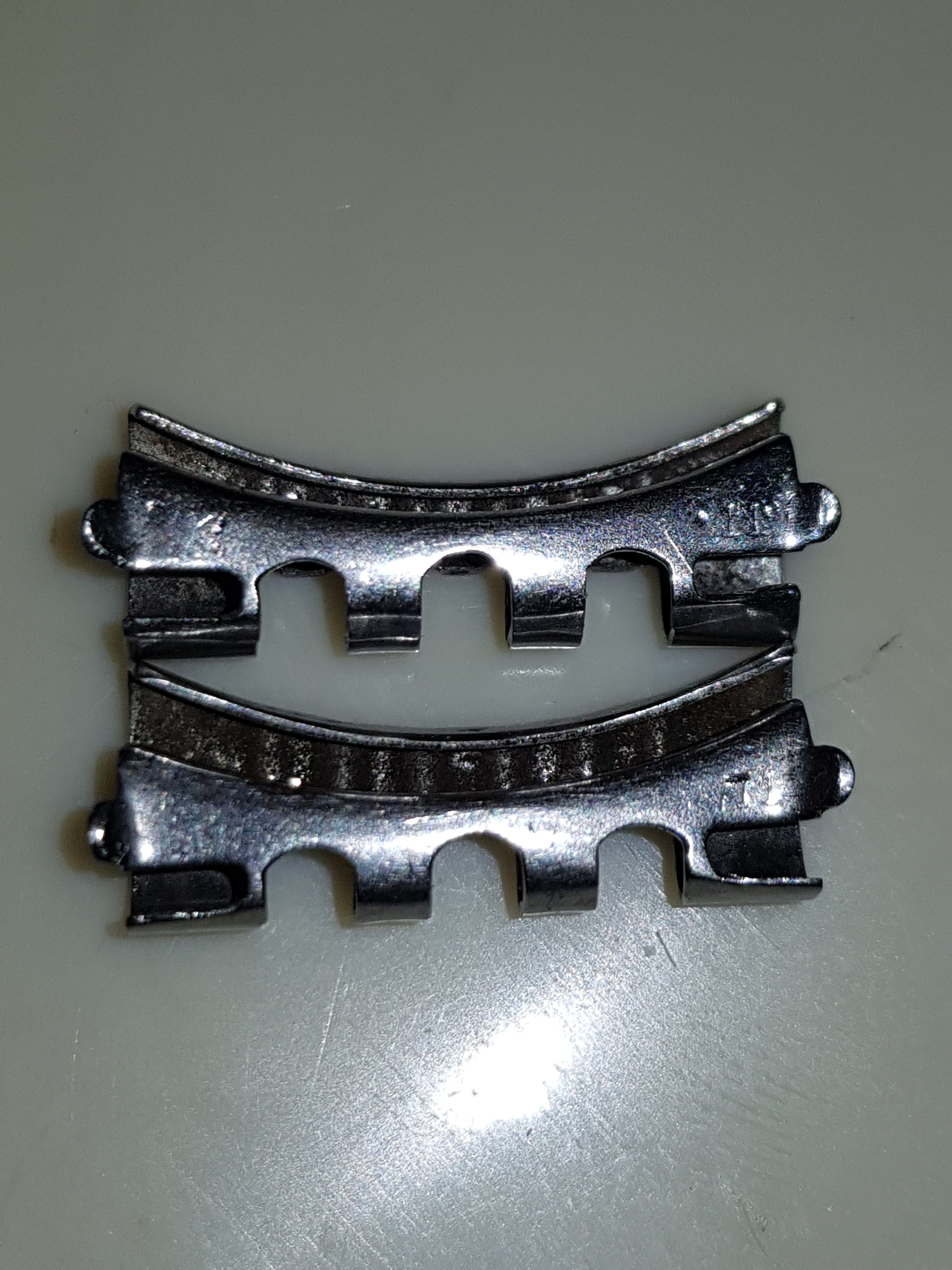

Hi @JwRosenthal, thanks for your feedback, on the endlinks there is the number 11 engraved as per photograph below:
Gotcha- couldn’t see in the pic. It’s a nice bracelet, and additional sections are out there without having to lose the factory clasp or add one of those extenders (I hate them). I would contact @No Mercy and see if he has any sections for that bracelet, or just sell that one to offset the cost of buying the correct bracelet.
