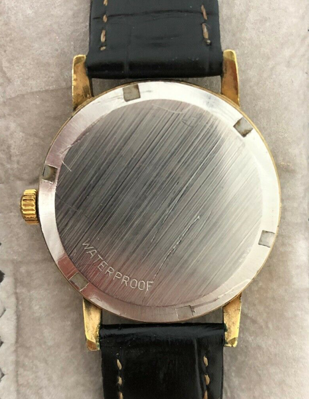

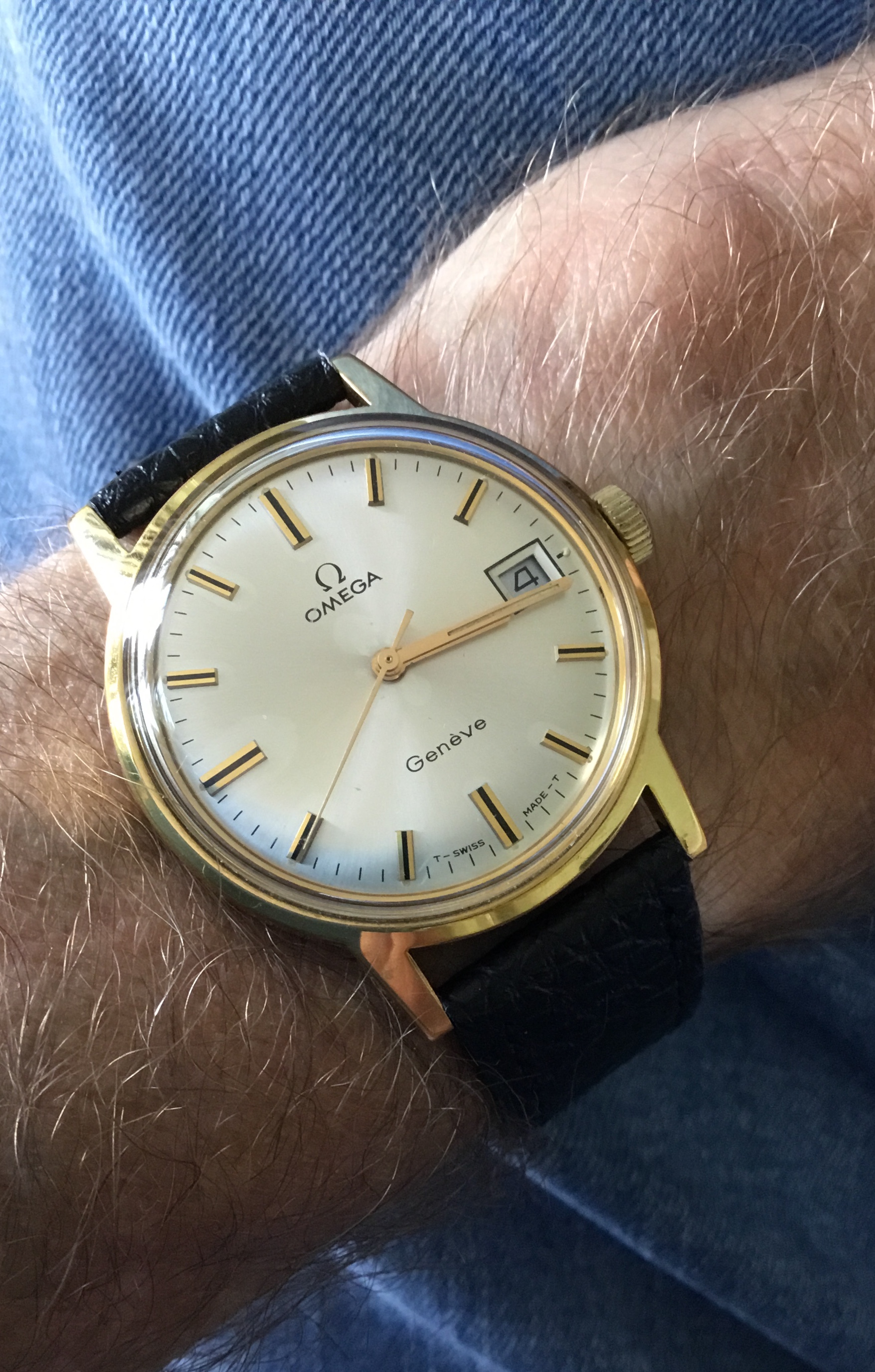

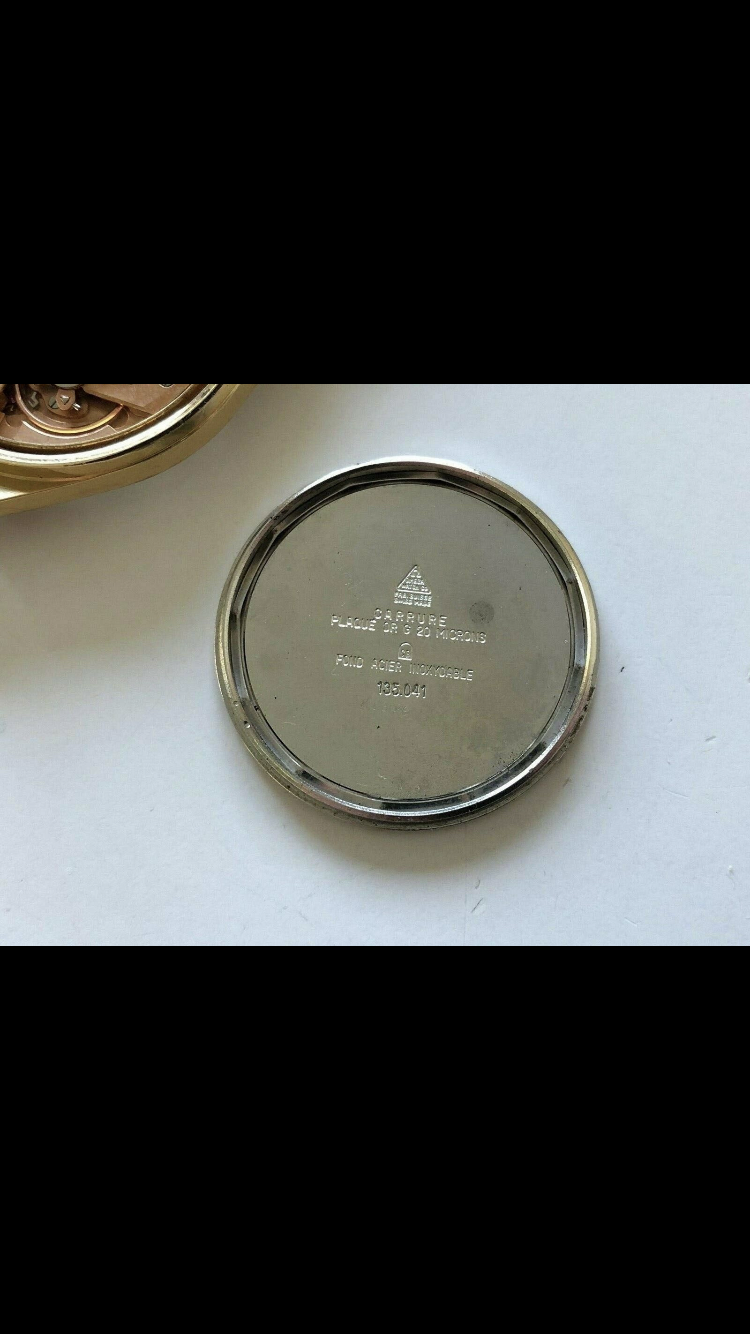

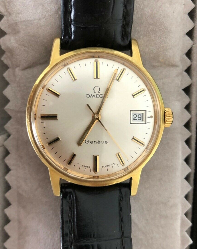

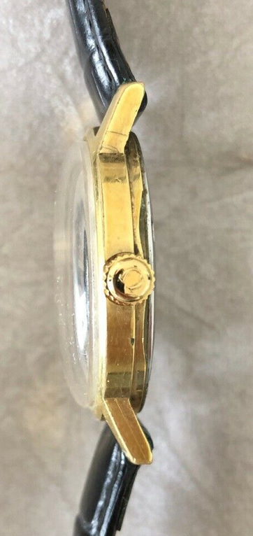

hi

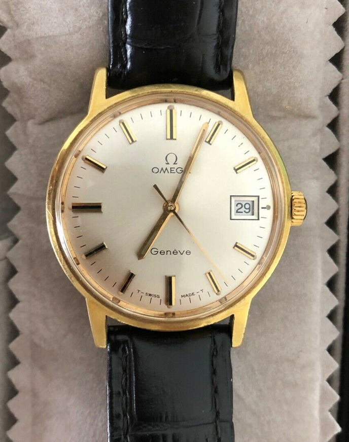

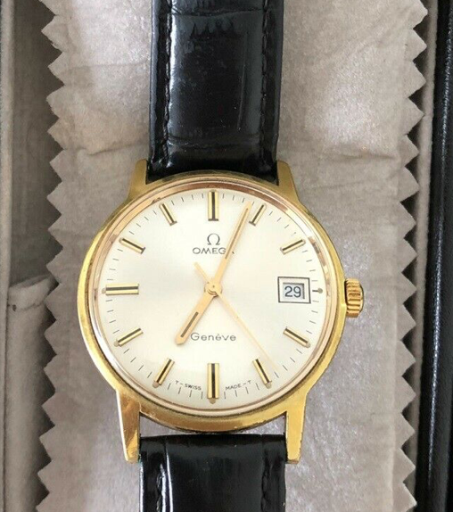

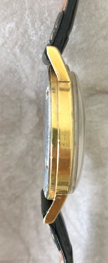

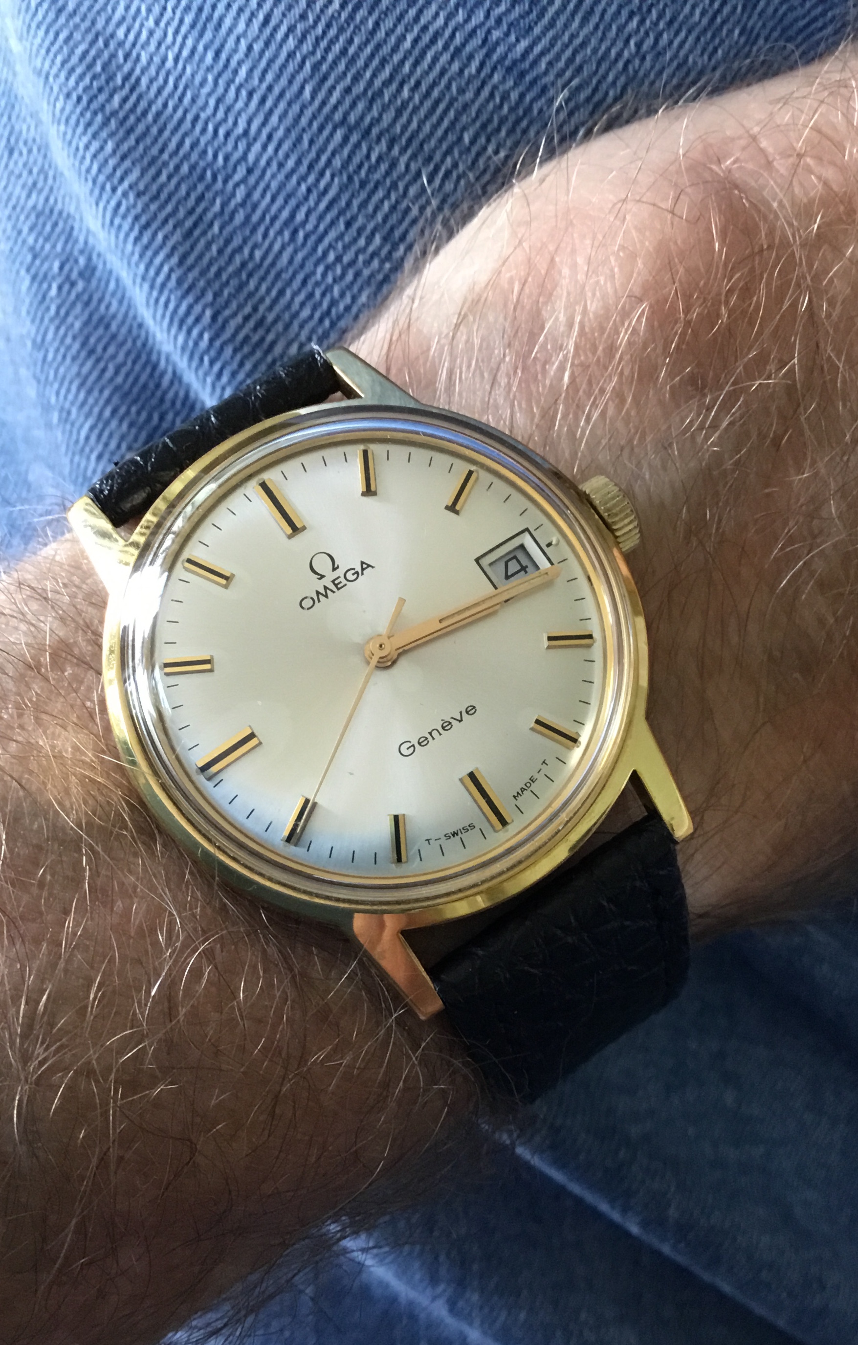

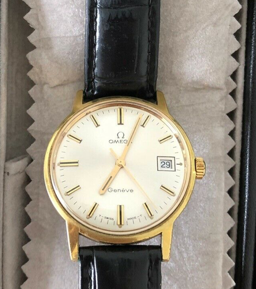

i could really use some help with this omega geneve i do not wanna purchase a redial.
to me everything looks good but i am a bit worried about the swiss made, i have not seen it placed there before but might just be a variation i have not seen before.

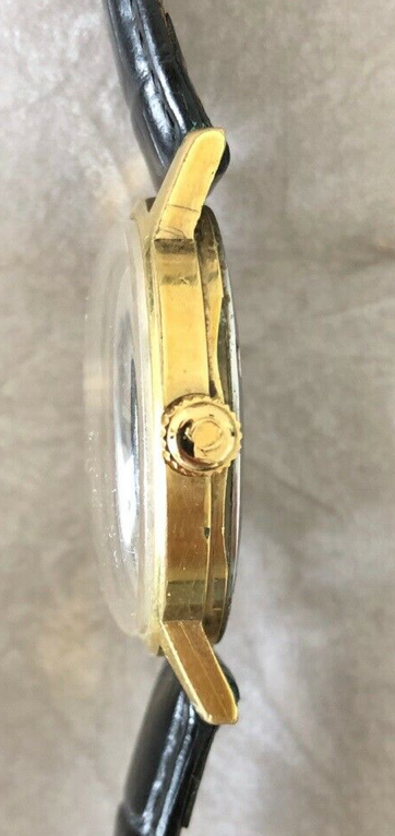

case looks polished, a second opinion would be great.
the crown looks fine and with omega logo so it might be right.
the price is 380€ is that fair?
thanks in advance
1,175
2,459

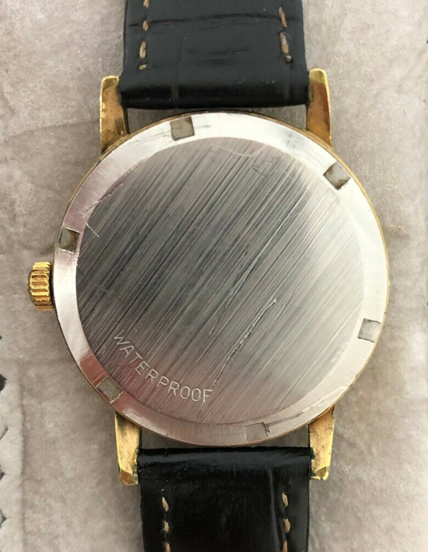

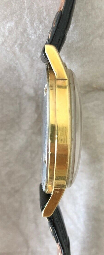

Well the gold plating on the case seems pretty chewed up, not so much polished. I can't comment on a redial but others will know. I've seen your other threads on possible purchases of a Seamaster and Connie with varying prices. What exactly are you looking for because all three of the watches you presented are very different.

my taste are quite broad, so i am just looking for a watch which is not a redial for a decent price 😀
10,283
16,103

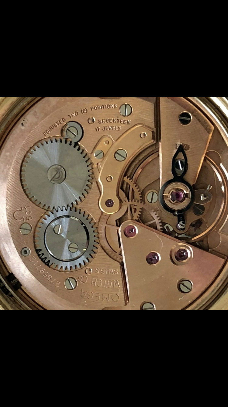

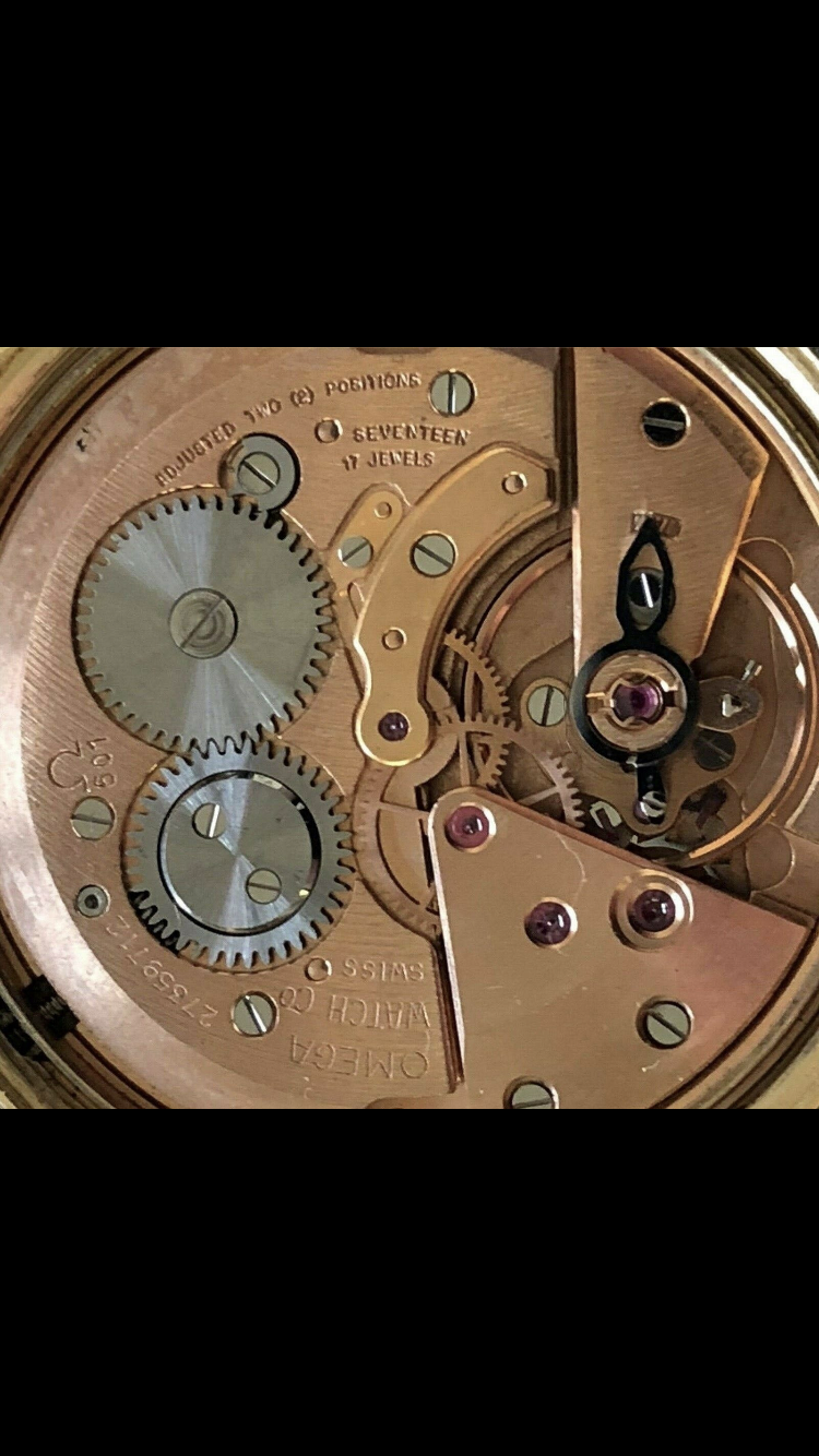

It’s not a redial but it is also an average condition example of a pretty low end model. The price is fair if it has been verifiably serviced at some point in the last 5 years, otherwise it is not. It’s prob a 613 movement which is reliable but not exactly exciting. This is probably from circa 1970-73 so on the cusp of the dark days.

What's your budget? Because you could probably end up spending just a little more for a far better example.
77
43
i think my budget depends on the watch but my max is around 1000€

It looks like a nice 1970 every day wearer.
It’s not a safe queen and has been used reasonably carefully by previous owner(s).
Given the fact that it’s 50 years old, I reckon that the gp case is in reasonable condition and that the price is very fair. 4 years ago, you might have hoped to pick it up for €250-300 but these are sought after now.
I sold this 613 Genève earlier this year on an eBay auction for £350. However, I polished it with a jewellers cloth before photographing it.

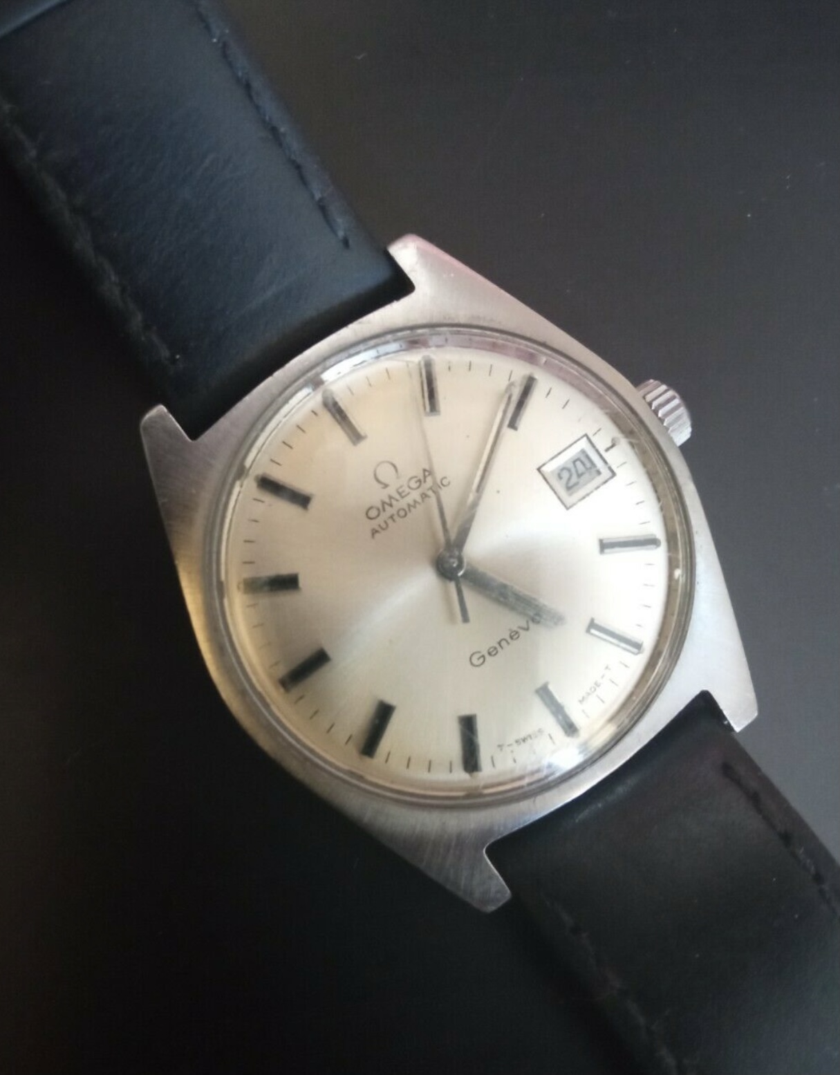

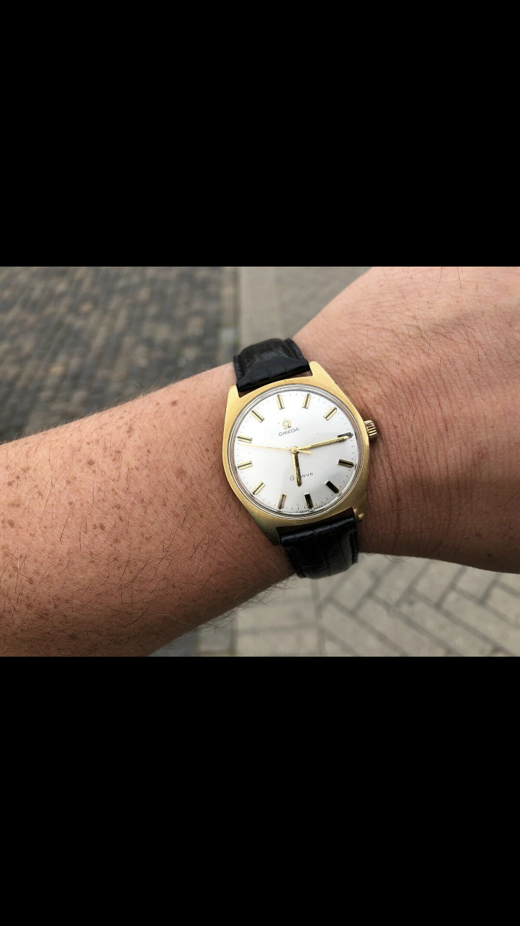

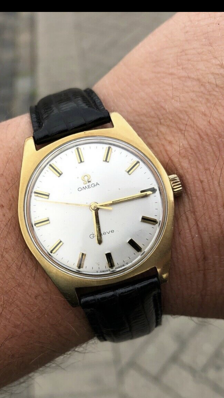

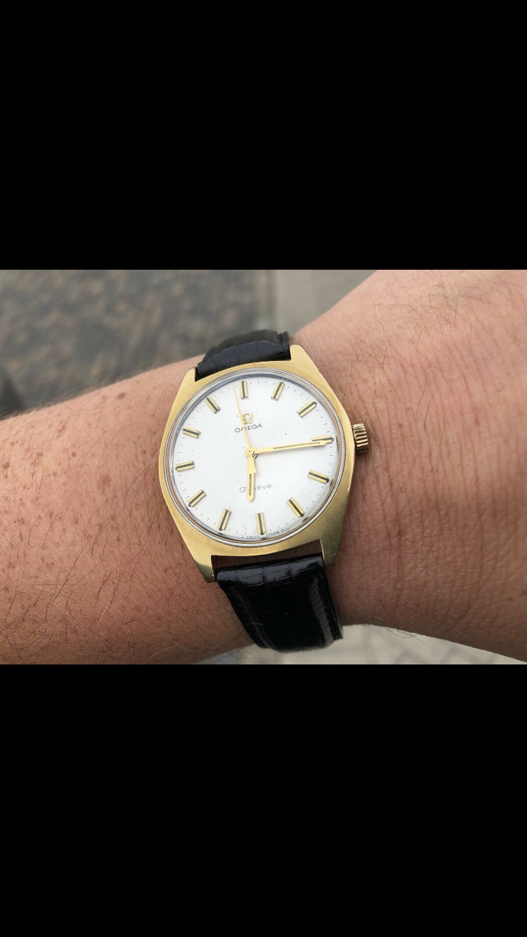

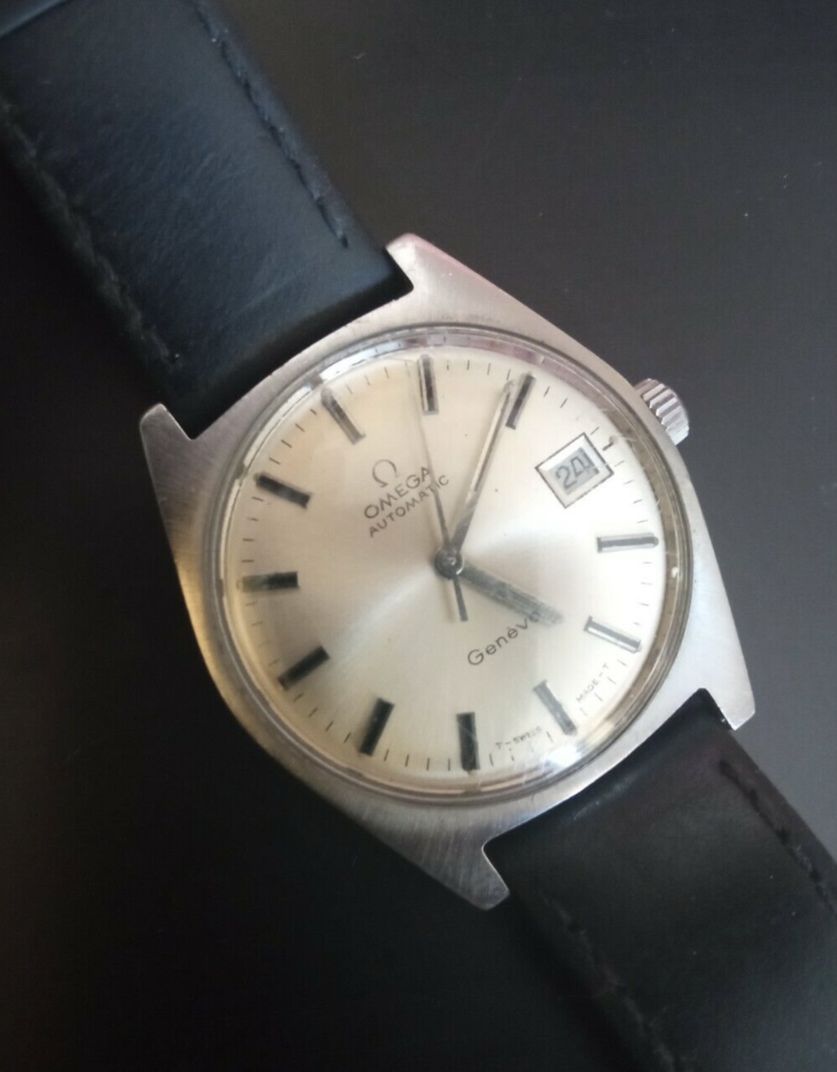

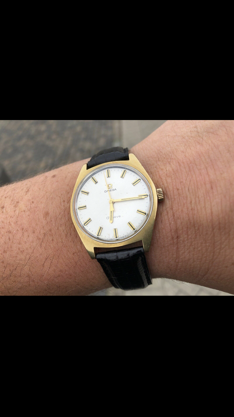

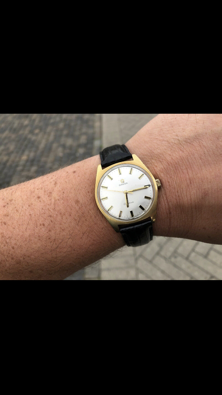

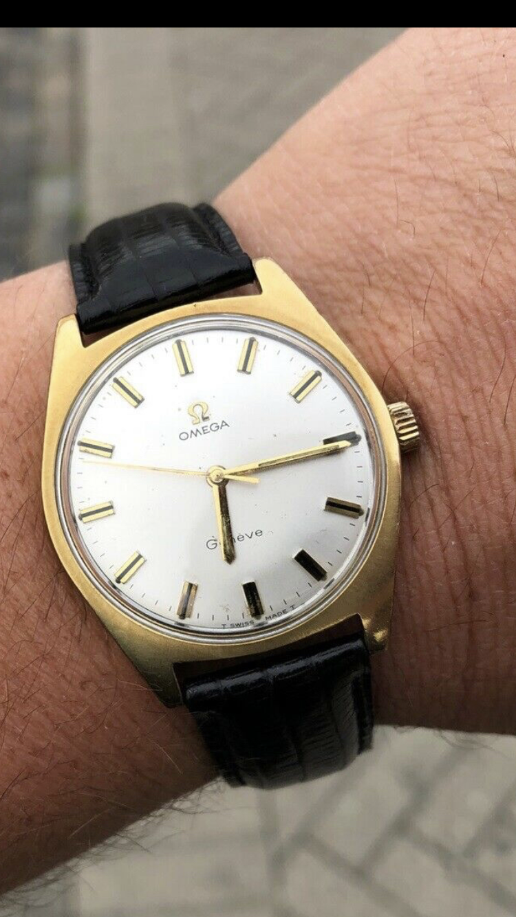

Unfortunately i did not manage to buy it i was to slow but i have found another one for 300€
What do you guys think of that?
8,322
68,267
The photos are poor and, although I may be wrong, it looks like the indices at 6 may not be pristine. On top of this, it’s a handwind. Nothing wrong with a 601 movement but you can do better.
In your situation, and I have been - buying four Geneves and looking at others - I’d go for an automatic with a 552 or 565 movement.
I’d opt for stainless steel rather than gold plate - because the plating on a fifty year old watch rarely looks great and can’t be ‘polished' out.
Above all, I’d want the best dial and hands I can find.
Your questions appear to focus on €300-400 and I’ve skimmed eBay on your behalf.
I suggest you have a closer look at this. It’s a Buy it now for £325; so nice watch, good price, won’t break the bank.
Here’s the link - but you’d better be quick.

Thanks a lot ill take a look at it 😀
112
290
The dial looks really good. I would only repair is the gold-plating. After that, that would be a nice pretty Omega
