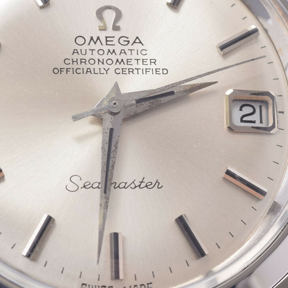

I don't have a great sense of value so maybe some of the other more aged looking ones out that I have found online are overpriced, however if there was nothing wrong with this it seems like a steal at the price and I would purchase.
that being said, it seems too good to be true. I closely examined the dial and it doesn't seem like a redial to me but I'm inexperienced so I'm probably wrong. The case and the bracelet seem shiny as hell so I'm sure it's super overpolished which likely makes it a no-go but would love to hear feedback from you guys. thank you.

The distinctive vertical brushed finish on the side of the lugs seems completely gone on this example, or at least I can't see it in the photos. For some reason there are a lot of these in Japan, and they typically go for about $1k at auction.

To be honest. For the asking price. Why not spring for some new hands and make it better?
Last. No movement shot. Whats he hiding? Bad movement? Aged or uneven finishing?

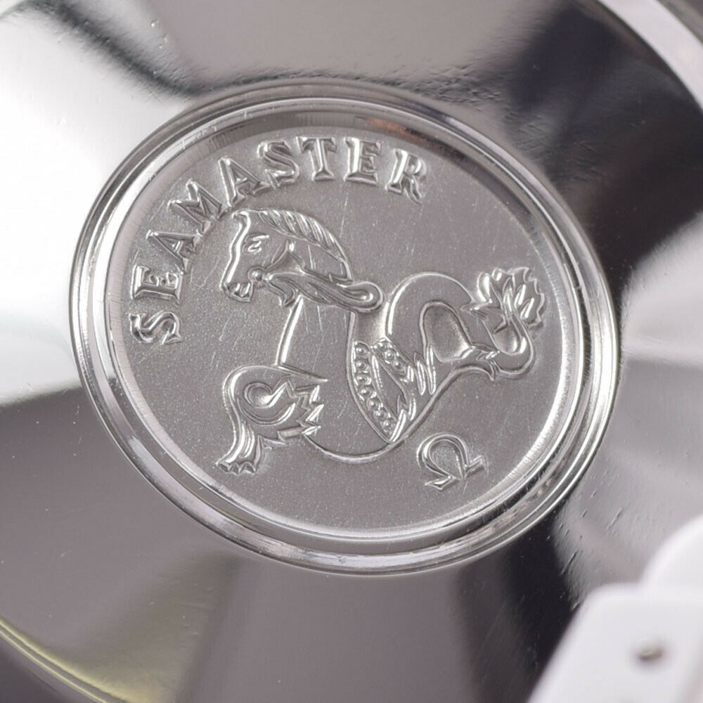

Nice dial. I like the hippo on the back. Hard to tell whether it's just polished or overpolished with that light box.

Vertical brush is there, but the case has definitely been refinished at least once (description says as much). Price is definitely on the steeper end.
If you decide to go for it, definitely get movement shots first. Tbh, for a watch that has been 'serviced' that's the least they could do.

The condition of the hands and the dial seem incongruous. If the hands are original, then seeing what is inside will be very telling. From the outside it looks nice.

I'm a big fan of the reference and I've been collecting information about it into my blog. This particular case is very hard to judge from pictures and it takes (professional) polish well. I'm inclined to say that the case is quite polished, in fact this is quite evident with the caseback picture.
