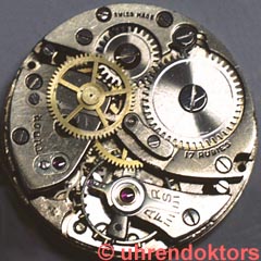

My grandfather left me an Omega watch that he bought in Europe in the 40s of the last century. Now I have this watch and I am interested to know its history. But I could not find any analogs of this watch either in appearance or in mechanism, and even there are doubts whether the watch is a fake.
But the mechanism is similar to the caliber 1158, 1187, 1190, 1213 A. Schild. (I don't have enough knowledge to distinguish them). I found out that such mechanisms called "ebauche from Schild" were supplied to other brands, and found photos of Rolex Tudor and Brevet Henco watches on European antique dealers ' websites and forums.
But I couldn't find information about the Omega watch series like mine. I would like to know the history of this watch, as it is part of my grandfather's history.I hope for the help of forum experts.

If the one of the movements shown in your post is from the “Omega” watch pictured in your post, there is indeed something strange. One movement seems to be marked “Tudor”, and the other appears to be marked “Omega”. Neither Tudor nor Omega ever used these A SCHILD movements. It looks very suspiciously as though there has been some inventive Engraving, mixing, and matching going on. It would have been very helpful if you had provided much better photos in your request for assistance. But I smell a fake or two.
18,825
39,125
The Omega is a fake, Omega never used AS calibers.
Tudor did use A Schild ebauches (also Fabrique d’Horologerie de Fontainmelon ( F.H.F) ) in their early models, although usually finished to a higher quality than the standard ebauche.
They did use FHF calibers, but never the A Schild 1187 1194 models. That “Tudor” marked movement is a fake. The only centre second FHF 150 movement (See image) used were the indirect sweep seconds variety which Tudor called by the caliber # 59.

might be a bit harsh to call fake... it might be a case of creative repair, to keep it working with what was at hand, and no intend to deceive.
i'm sure they have stories to tell.
5,721
9,505
Can't see one single component from omega......case lugs never from omega. Outside engraved back = no. Movement = no. Dial ? Maybe repainted and dial feet cut? Looks like a creative, a lot of time on their hands creation from the Ukraine. Omega carried a lot of prestige in the UdSSR. Kind regards. Achim

I can't see ANY Omega DNA in that watch.

I believe you mean that. What would your view be had you bought such a watch, believing it was actually an Omega. I can’t believe you would express that opinion! 😕

Maks , good luck with your research about your family heirloom. You did ask about an omega watch and the pictures show, that it is not an Omega. Never was. Never will be. No matter how much you research. AS mvmt. were never used by Omega . They are a manufacture, meaning they make their own movements. They bought other movement companies, but never AS. So , here it ends. And Omega in the 40's did not depart from Omega's general standards. Everything was done in Switzerland and only shipped to the Omega agent of the time. So, research about that will not be credible. Whatever your watch is, cherish it for the family history.

Regarding that website (which I personally regard with extreme caution).
Whenever I see verbose, embellished or overly lengthy descriptions of a watch I immediately become suspicious.
If a watch is genuine and photographs display that fact, there is no need to write a five hundred word essay in an effort to convince a buyer that the watch they are viewing is correct.
It often reminds me of the "Big Lie": "If you tell a lie big enough and keep repeating it, people will eventually come to believe it."
If you could provide another reliable source (Tudor or Rolex collector website, validated reference etc) describing such a watch I would be very surprised.

Engraving a movement is not a creative repair.
AS can be decent movements. In fact I own one that is also shared with the Tudor advisor a main stream piece available world wide. Mine is in a Hamilton sub brand from the early 70’s called Vantage.

On the question of the dial. Like A Schild, who provided bare movements (ebauches) to many many watch companies, there were also dial manufacturers who provided dials to many companies. Some were supplied to a customer specification, so they were "unique" to each company.
Others were provided as generic dials and sent to watch companies, jewellers and watchmakers, sometimes marked with the relevant "brand" and sometimes just blank and the watch company/jeweller or watchmaker would stamp the dial.
there is Still a question: my watch is 10.5", and DOXA is 11.5". Is it possible to choose such a case to combine the watch with the mechanism?
If you compare your "Omega" to the Doxa, you can see that both movements are held in large movement rings, these may have been sized to account for variations for the caliber used.
...............And one more question, what is the difference between the "OMEGA" and "OMEGA WATCH Co" labels?
The single word normally appeared on the dial, and the full "Omega Watch Co" on the inside of the caseback and on one of the bridges of the movement. However, there are variations to this rule.
However, I do not understand: selling watches like Omega, having the cost of Swiss movement and dial, case selection, hands and work - is this a profitable business?.............................
A watch "manufacturer" could source ebauches/cases/dials and hands from various reputable suppliers, and many did and sold them honestly.
But there were some who could double, or even triple the price of "their"watch if it was a known "prestige" brand (as Omega and Rolex were in the 1940s), so out would come the engravers and stamps.
