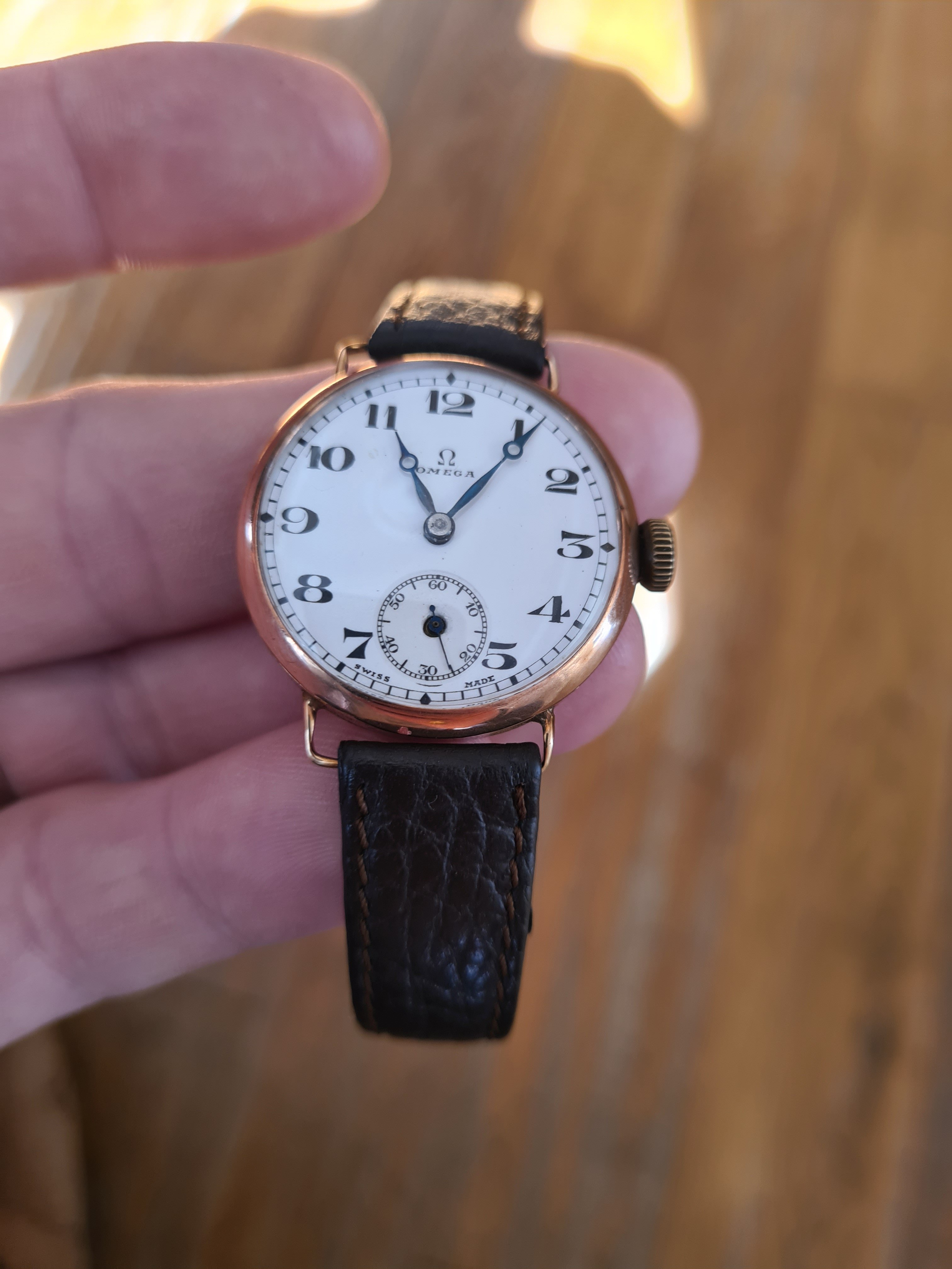

Hi all, following my father's passing last year I have been sorting through some of his things and have come across an old Omega watch, from what I found online I thought the date to be 1923, but a dealer I contacted for further info has said 1928.
Apart from the age I've not been able to find put anything further regarding the watch and was hoping someone on here may be able to shed some light on the details and an approximate value?
Any help appreciated.

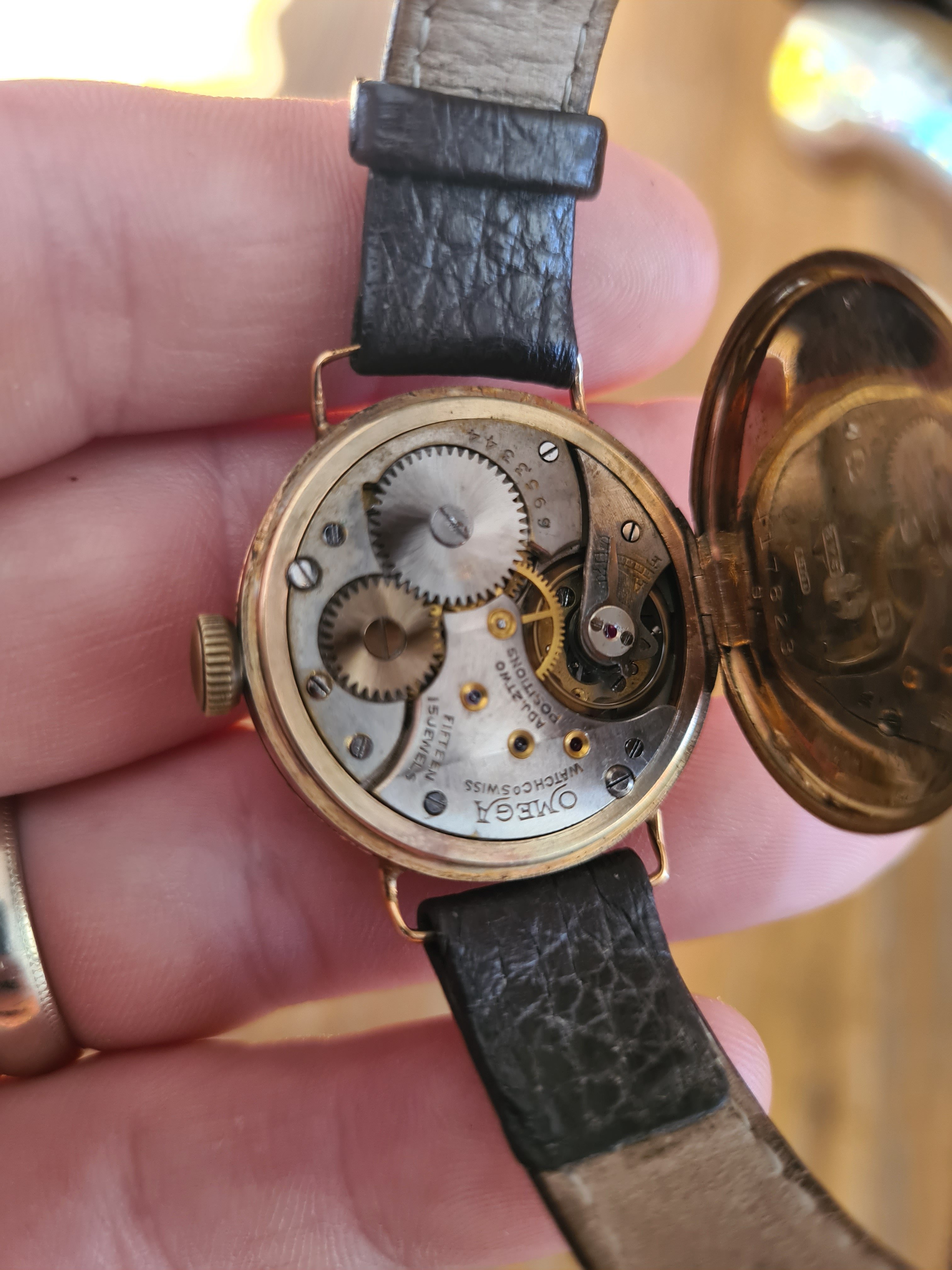

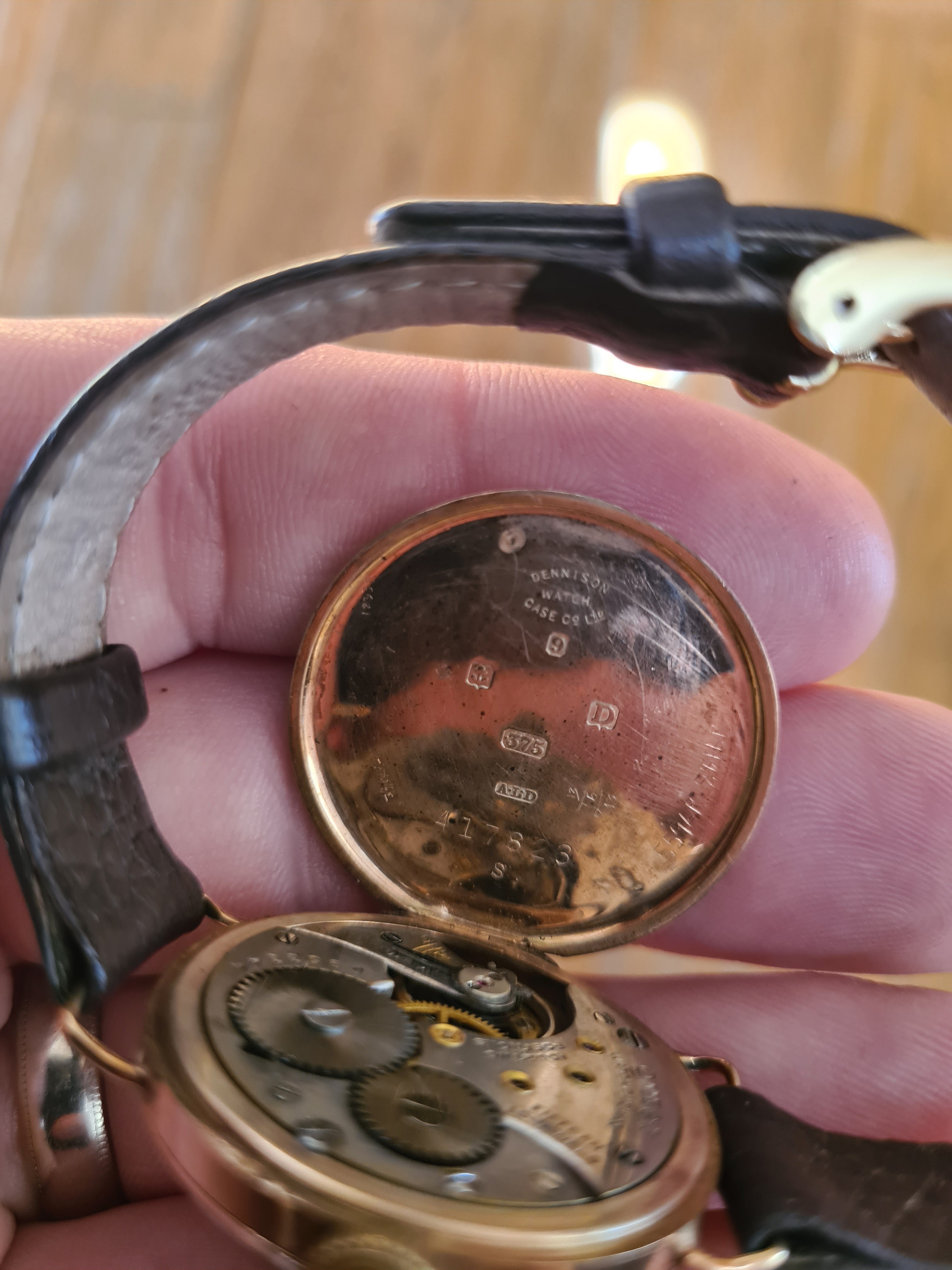

The Birmingham date letter "D" indicates 1928/1929, this would be more accurate than the various Omega charts floating around the internet.
It's an English case in 9 carat gold by Dennison with an Omega caliber 26.5 I think, not sure of the variant (maybe a 26.5T2?).
As to value, 9ct gold melt value is easily outbid by sentimental value.
