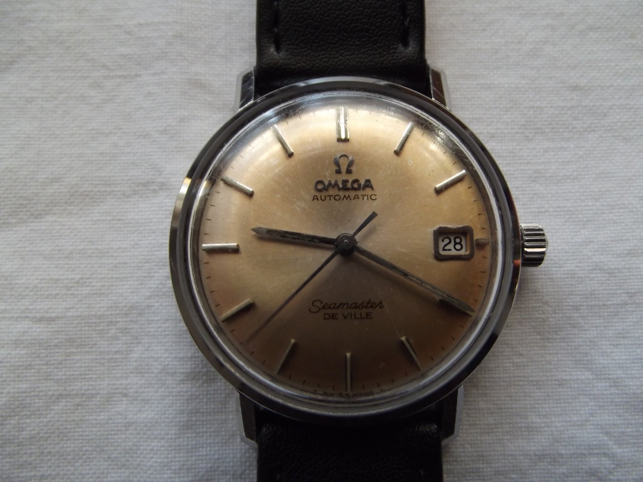

    Hi all,

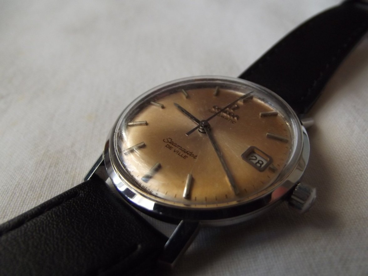

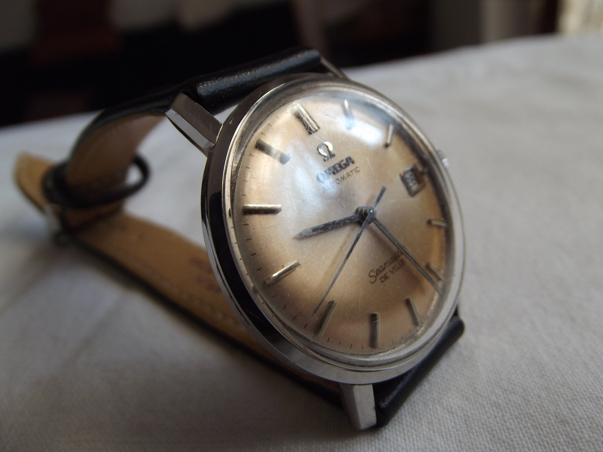

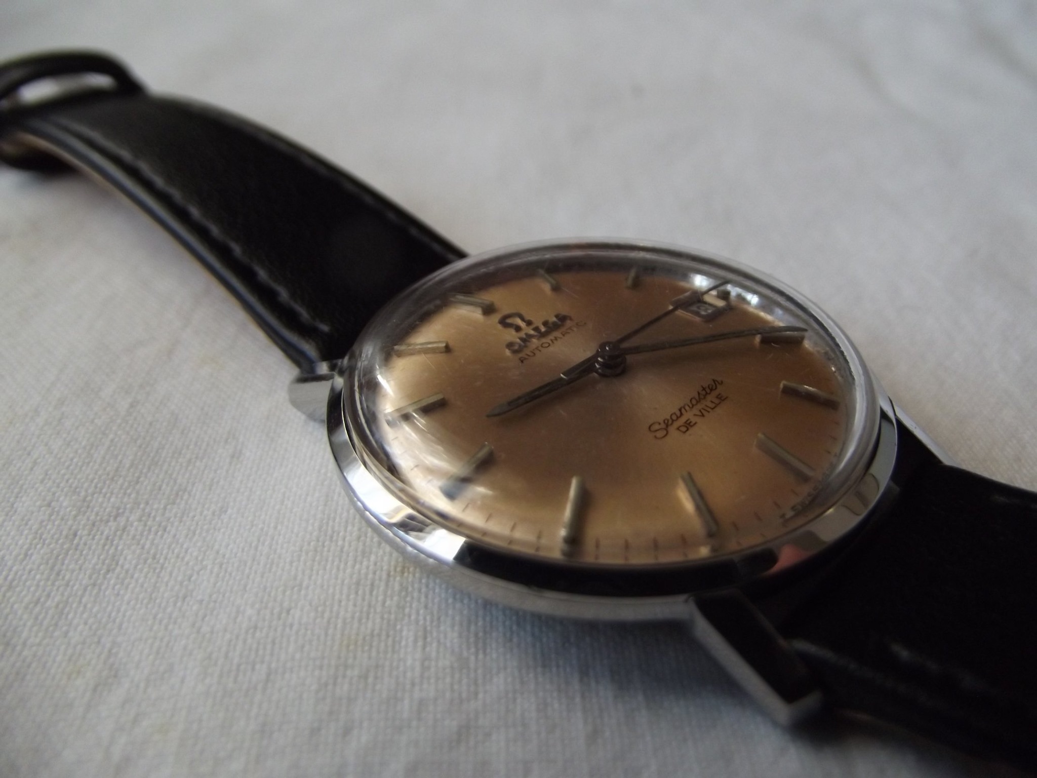

    I've been recently offered this De Ville, could you please share your thoughts on it?

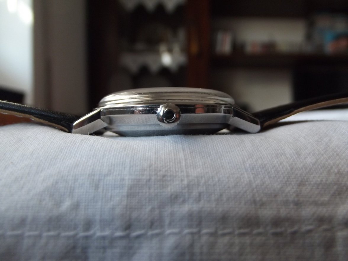

    I quite like the dial, seller claims watch being all original down to the glass, I am a bit dubious about the crown but not sure.
    Thanks for your kind help, cheers
    Alessandro

  2. Ekonomer-Tuomas May 6, 2019
    54
    170
    bit of cleaning for the hour and minute hands, plus a new crystal and you are good to go.

  4. AdInfinitum May 6, 2019
    81
    130

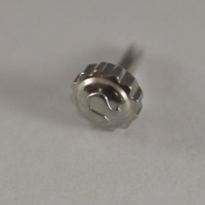

    Having owned a similar model before, I think Seamaster de Villes with this dial + case configuration originally came with a different crown? (Something along the lines of this random photo)
    I never get tired of looking at the iconic hippocampus on the caseback :D
    bardamu likes this.
  5. bardamu May 6, 2019
    1,298
    4,890
    Not at the moment, seller is going to have the watch open by a watchmaker.
  6. bardamu May 6, 2019
    1,298
    4,890
    Actually this is also my impression...
    AdInfinitum likes this.
  7. AdInfinitum May 6, 2019
    81
    130
    Yes it sounded like your gut is sending you a signal about both crown and seller accuracy

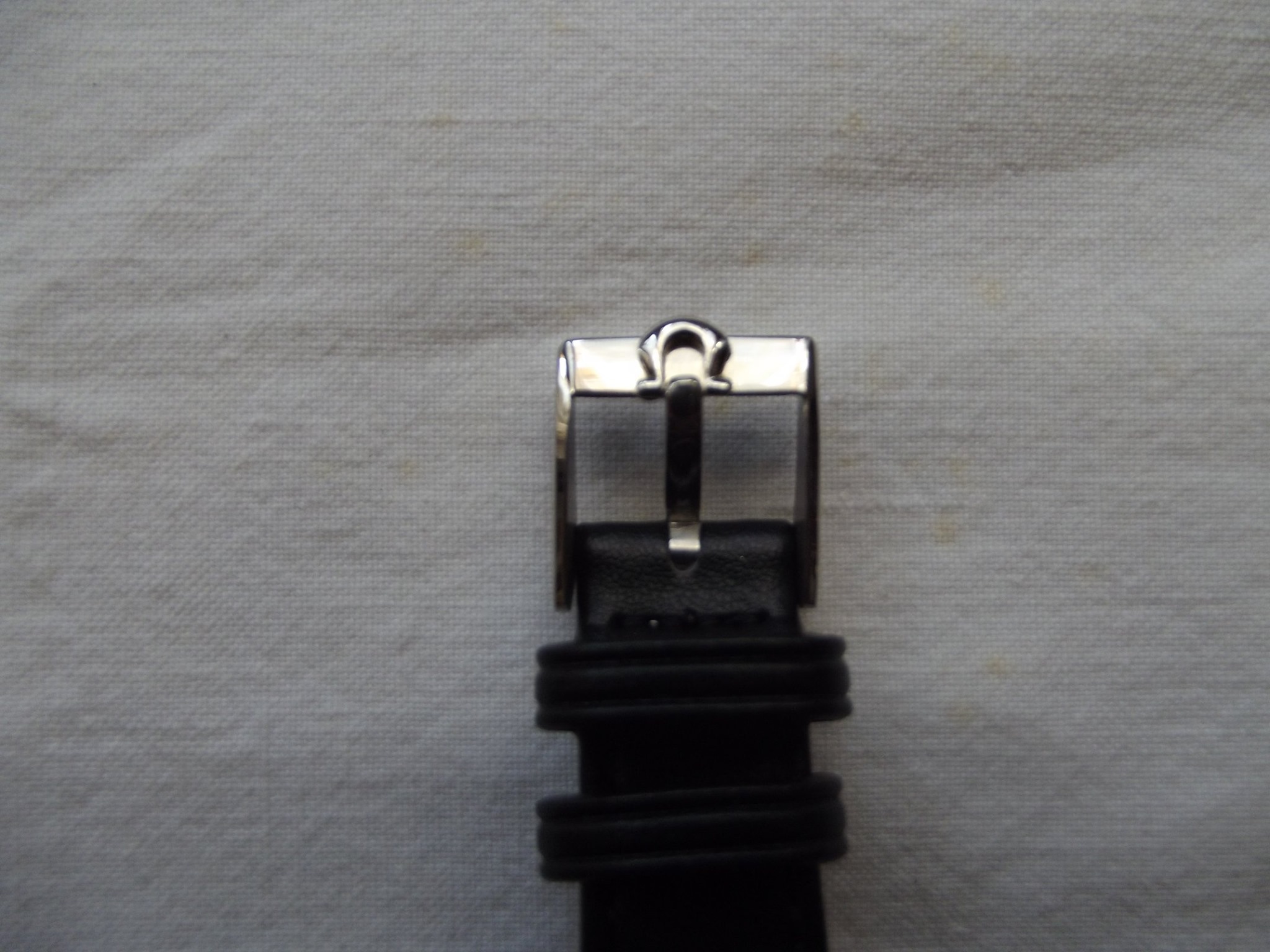

    Also I am wondering if that is a 14mm vintage ladies' buckle, looking forward to hearing from more experienced collectors :)
    bardamu likes this.
  8. Lucasssssss May 6, 2019
    622
    966
    Case seems good condition, crown I think is incorrect, dial also looks to have patninad to a brownish rather than sunbust silver. Personally for me it is a pass. However, depends on how much you like it, and the price.
    bardamu likes this.
  9. bardamu May 6, 2019
    1,298
    4,890
    I think I will took the advice some of you gave me and give a pass on this.
    Thanks a lot to all of you for your thoughts.
  10. Edward53 May 7, 2019
    3,127
    5,384
    The crown is absolutely, definitely, 100% NOT original to the watch.
