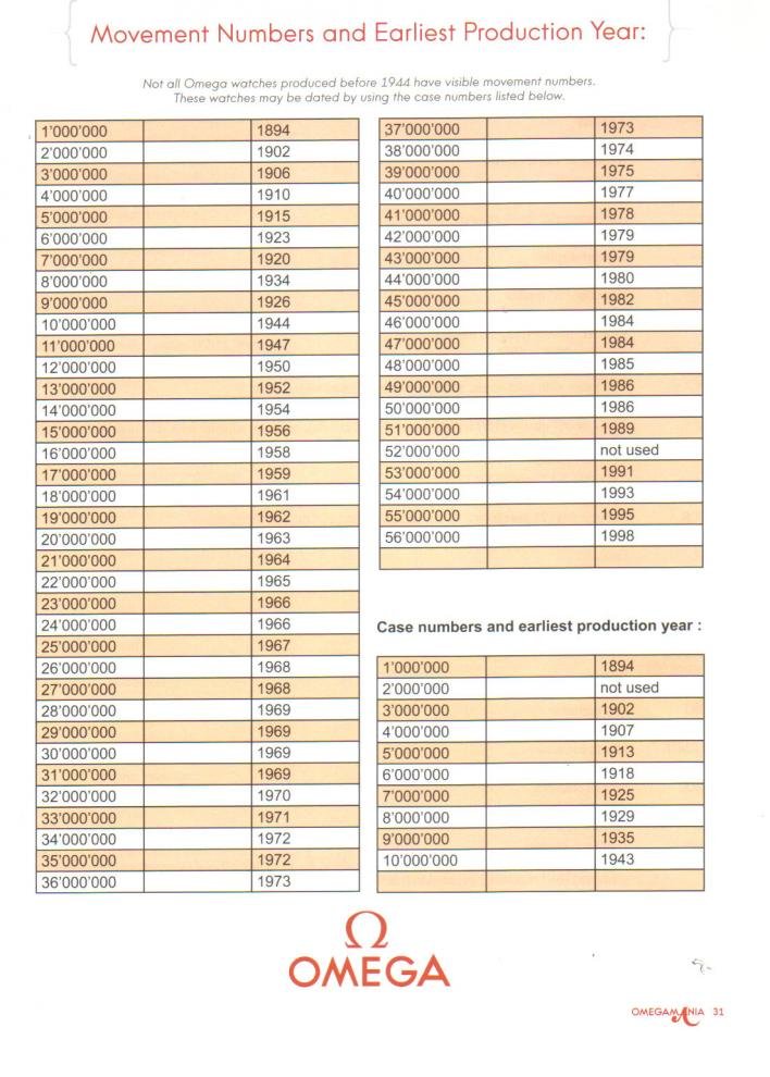

1. After intensive Googling on various sites, the serial number for Year 1988 is missing, can anyone tell me the reason behind it?
2. How can anyone tell whether the watch was made in 1988 without the serial number method?
Extract of the Archives.

Please see this:
The fact there is no entry for 1988 doesn’t mean that Omega watches weren’t made that year. I would say that watches that were made with between a 50.7M and 51.0M are more likely to have been made in 1988.

Don't trust a serial table like the above. They are not remotely reliable and aren't consistent across movement types, especially post 1980 or so. It is perfectly possible that no single Speedy Reduced from 1988 to 1990 has a 50m serial for instance, though I don't know that for a fact. The earliest Reduced models are identifiable by a couple of things. Firstly they have only the word Omega on the snap on caseback, later models have a more ornate hippocampus and secondly they are identified only by the case number as the PIC system was not yet in use. Another way is to do your homework and look at the serial numbers of enough examples to discern the pattern (which works but takes time), but as noted already, your best bet really is to find one with papers dated 1988.
Read up on the Reduced. It comes with servicing complications and buying one in less than tip top condition is a bad idea.
It is very very unlikely you'd find a Speedy Reduced with one.
