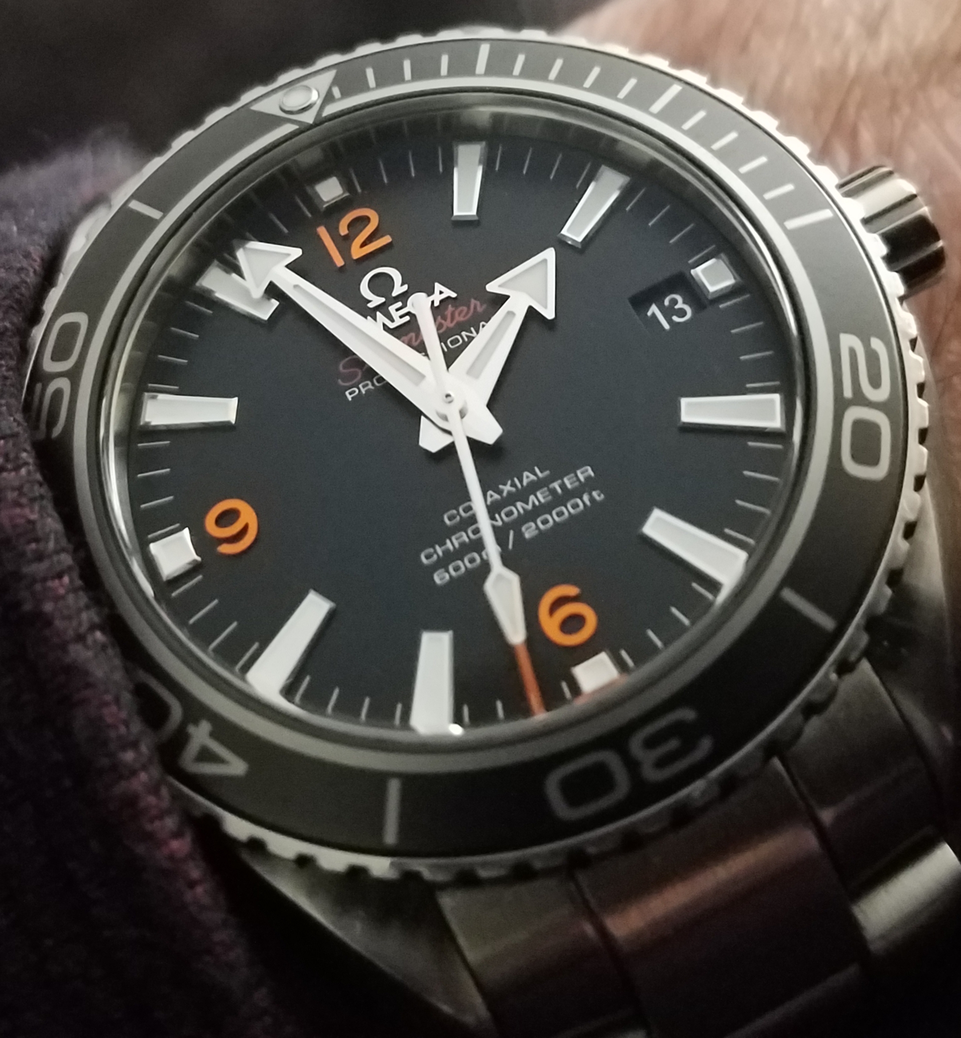

Hi. I could use this forum’s wisdom here: my wife has a Planet Ocean 39.5mm steel on steel (215.30.40.20.04.001). She wears it daily and last night, for unknown reasons the clasp is jammed and, as a result, she cannot take the watch off. Were away for a long weekend so we don’t have any tools with us. Any advice?
We were planning on going o a local watch shop to ask them undo one of the link screw and get the bracelet off that way. Any other ideas? Is this a known issue with an easier, DIY solution that I’m unaware of?
Thanks!

Go to a hardware store and buy an inexpensive hack saw. Carefully cut the bracelet with the saw and purchase a NATO strap.
996
1,865
Try soaking it in very warm, soapy water for awhile? Sounds like something could be gunking it up
2,816
3,747
There have been reports of this happening with Seamaster Pro 300m clasps, and Omega has been replacing these under warranty. Looks like something similar has happened here.
Your idea of going to a jeweler to remove the screws and a link is the best one - please don’t try the hacksaw idea (which hopefully was said tongue in cheek).
Then contact Omega about having a warranty repair on the clasp - assuming it is still under warranty.
Think I’m going to travel with a small screwdriver from now on, just in case!

I had a grain or two of sand stuck in mine some years ago. A little water pressure and a bit of gentle lovin' took care of it in short order.

Sand grains can indeed avoid a deployant clasp to open.
Try to rince with a shower or something similar.

Happened to me with my Seamaster 300 pro. Twice. Once with the original clasp; again with the new clasp Omega sent to replace it (under warranty). It was annoying and scary enough that I ended up selling the watch. Other people here have had no such issues, but I personally would never buy another Omega with a deployant clasp. I’m not clever enough with engineering to judge whether it’s a bad design or just poor qc; all I know is that it’s very distressing having a watch stuck on your wrist and having to remove it using a tiny screwdriver at a funky angle.
I posted about it here on OF and folks commented then that it’s a known issue—you’ll find other such posts here too.

Probably something 99% of any spring loaded clasp can experience, regardless of maker or cost. Also they aren’t handcuffs. These things have a dozen joints that can be easily disassembled, are designed to be easily disassembled, and are easily disassembled all around the world by jewelers, watchmakers, store associates, or anyone with most of their fingers that simply feel like it. Really not a big deal.
