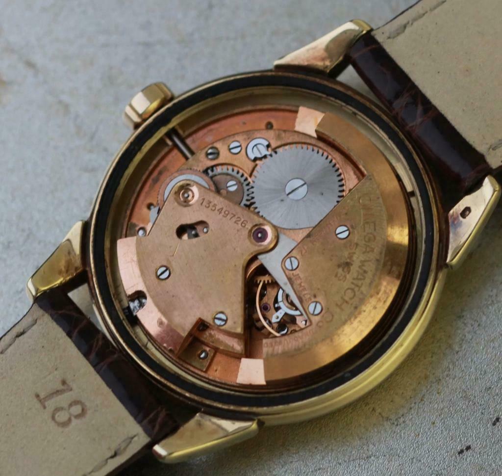

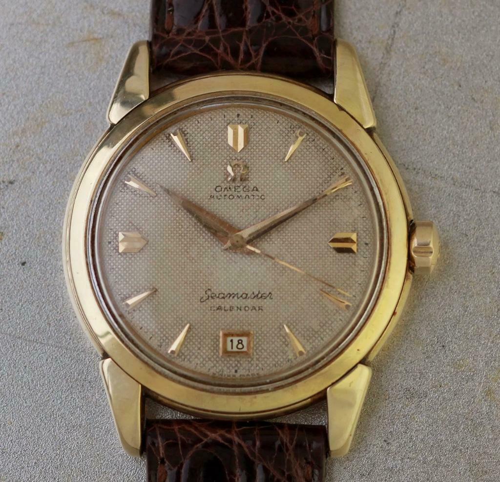

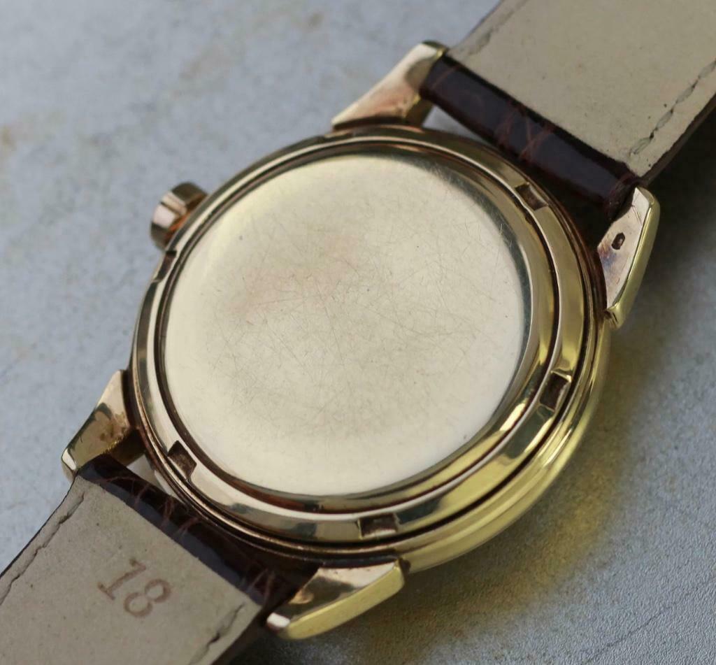

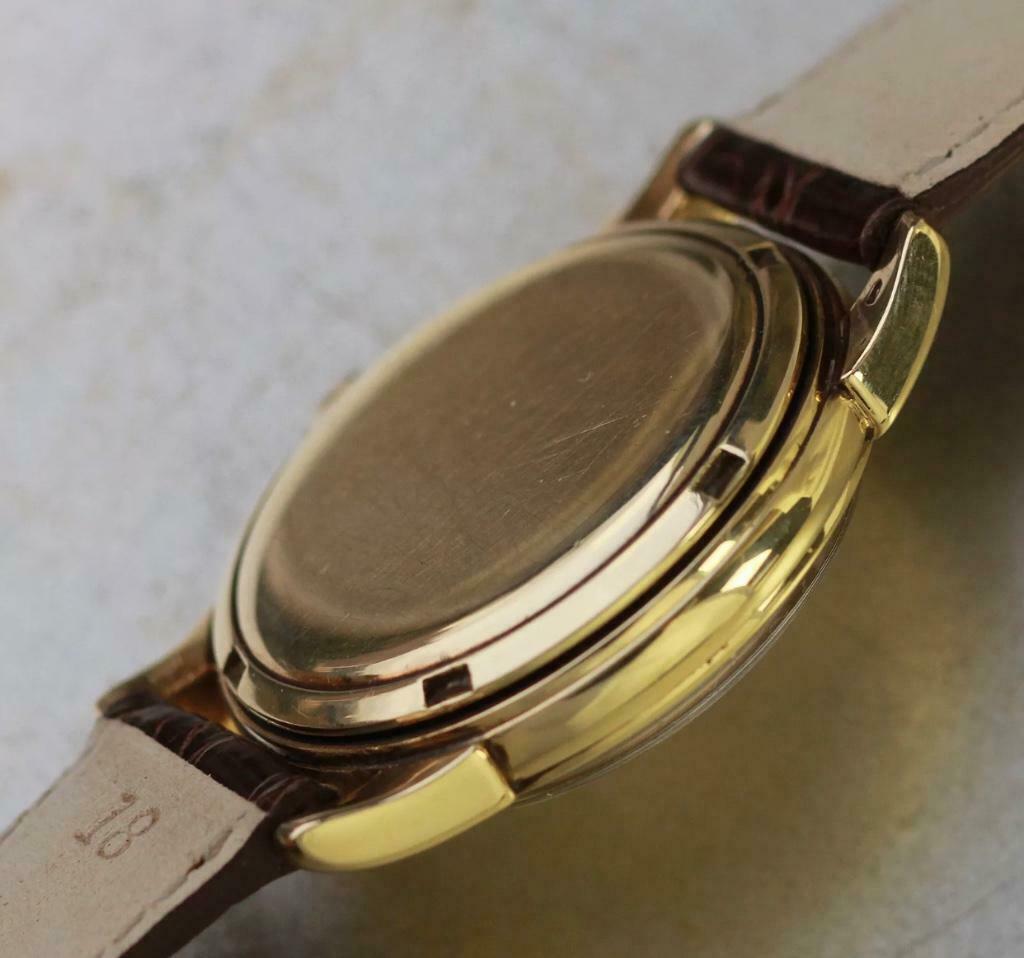

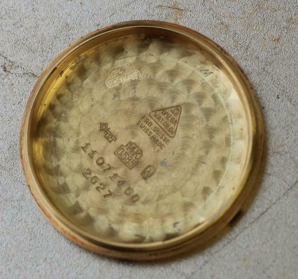

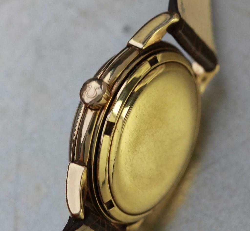

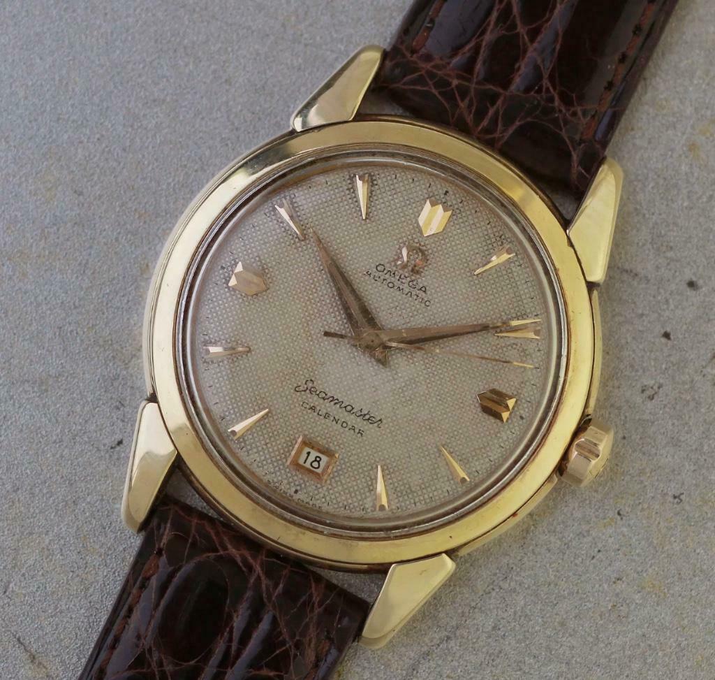

Here are the pictures:
Off course I've done some homework myself. Serial number 13mil dates from 1952, I think it is a ref. 2627 with cal. 353.
I found some examples of Seamaster 2627, and two with waffle (or honeycomb(?)) dial here on this forum:
https://omegaforums.net/threads/seamaster-calendar-2627-dial.14300/
https://omegaforums.net/threads/incoming-ref-2627-seamaster-calendar-waffle-dial-14k-gold-case.6298/
Quite obvious is the state of the dial: worn down, but looks original to me, except I'm not sure about the Omega logo itself. It looks a bit thicker than other models, however, I see different logos with this reference.
Besides that, the "seventeen 17" inscription is really hard to see on the movement. With some imagination I can see something where it is supposed to be, maybe this is due to bad lighting conditions. Besides, it looks like the movement could use a service.
I will ask the seller for more photos and additional information and posts them here when available.
What do you guys think? Are there any red flags? Does the dial/case/movement look original?

I don’t know enough to say whether or not every bit of this lovely watch is original but, as I’ve already said, it looks lovely and I would very happily wear it.
Additionally, it’s solid gold and the case and dial appear to be in excellent condition for a 67 year old watch. As you’ll also have noticed, the movement also looks good and in good condition.
You say that the price is good but not if it’s running well and/or needs a service, which it probably does. If that’s what you’re looking for and you can afford it, my instinct would be to go for it.

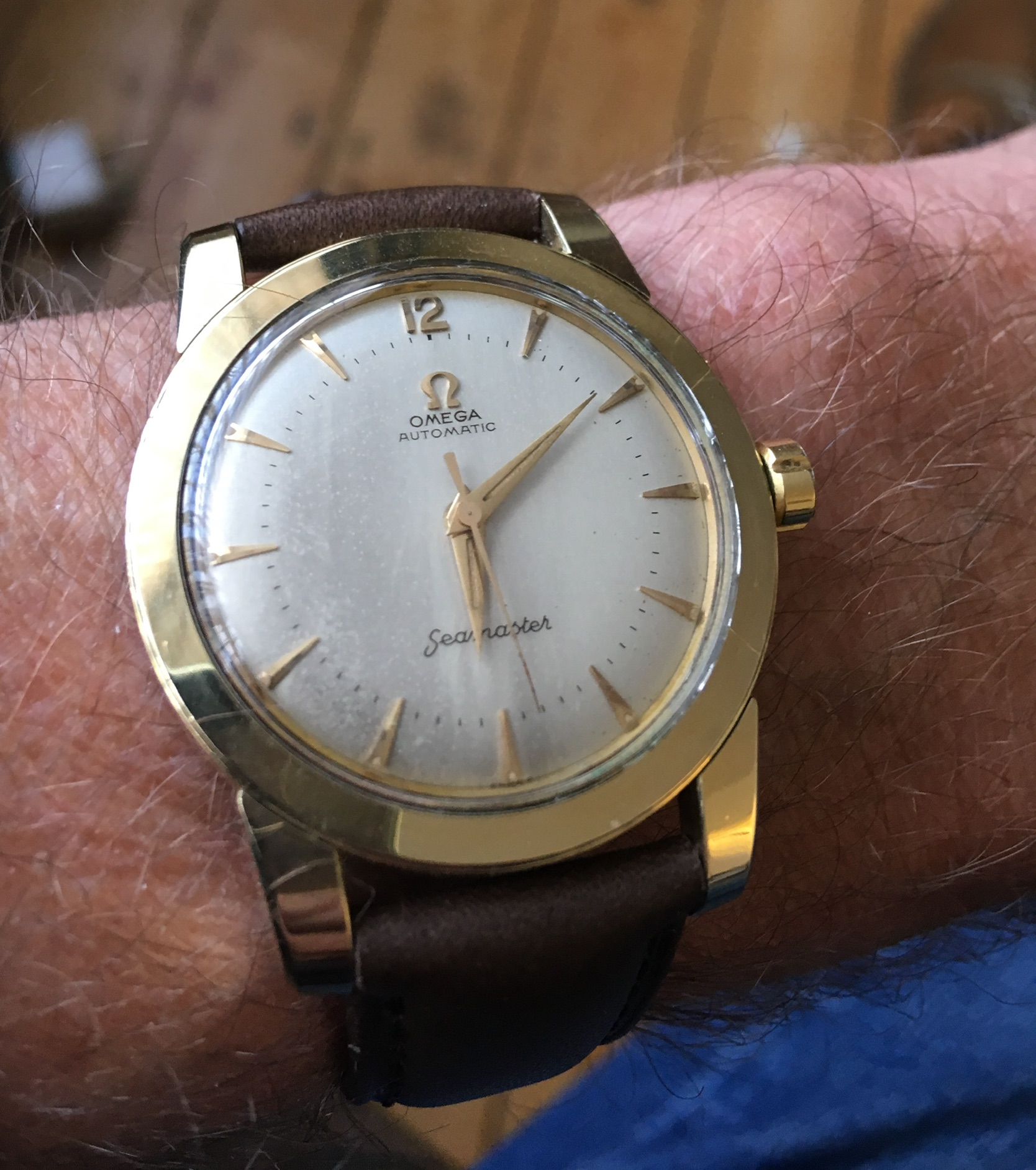

This is my 1954 354 gold capped model for comparison purposes. I really enjoy wearing it.

Case is a bit polished and the movement kind of tired, dial acceptable if you like the patina.
All comes down to price.

The crown is a later replacement but dome crowns are available on eBay. Sure, it's not perfect. As said, price. If it's truly half of what is usual, then maybe?

Thank you, as you said: all comes down to price. However, this looks too good to be true...
Ah, thanks! Telling whether the crown is original or not, is still tricky for me. Mostly due to different crowns shown on same ref. models.

Btw the crown looked ok to me. This model came with the cloverleaf and dome AFAIK
2,326
1,887
Yes, dome early, then slotted later. Slotted frequently used for replacement. I think it’s early enough to need a dome, which you can get on eBay (I bought one there).
