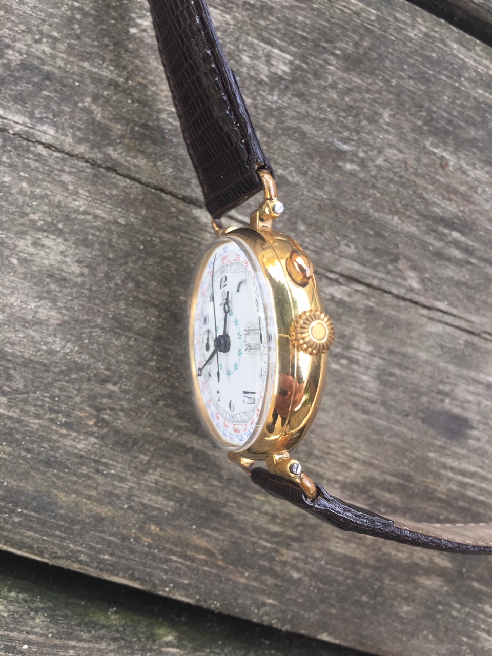

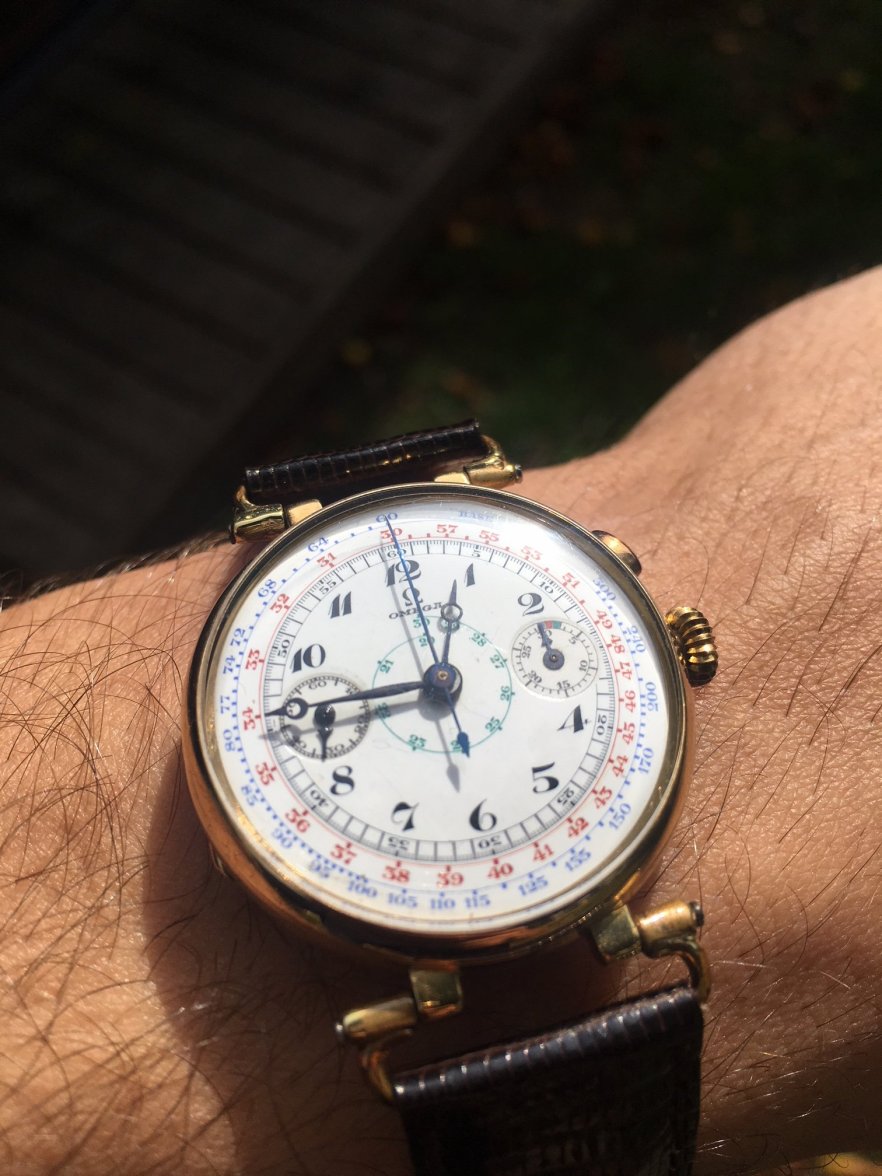

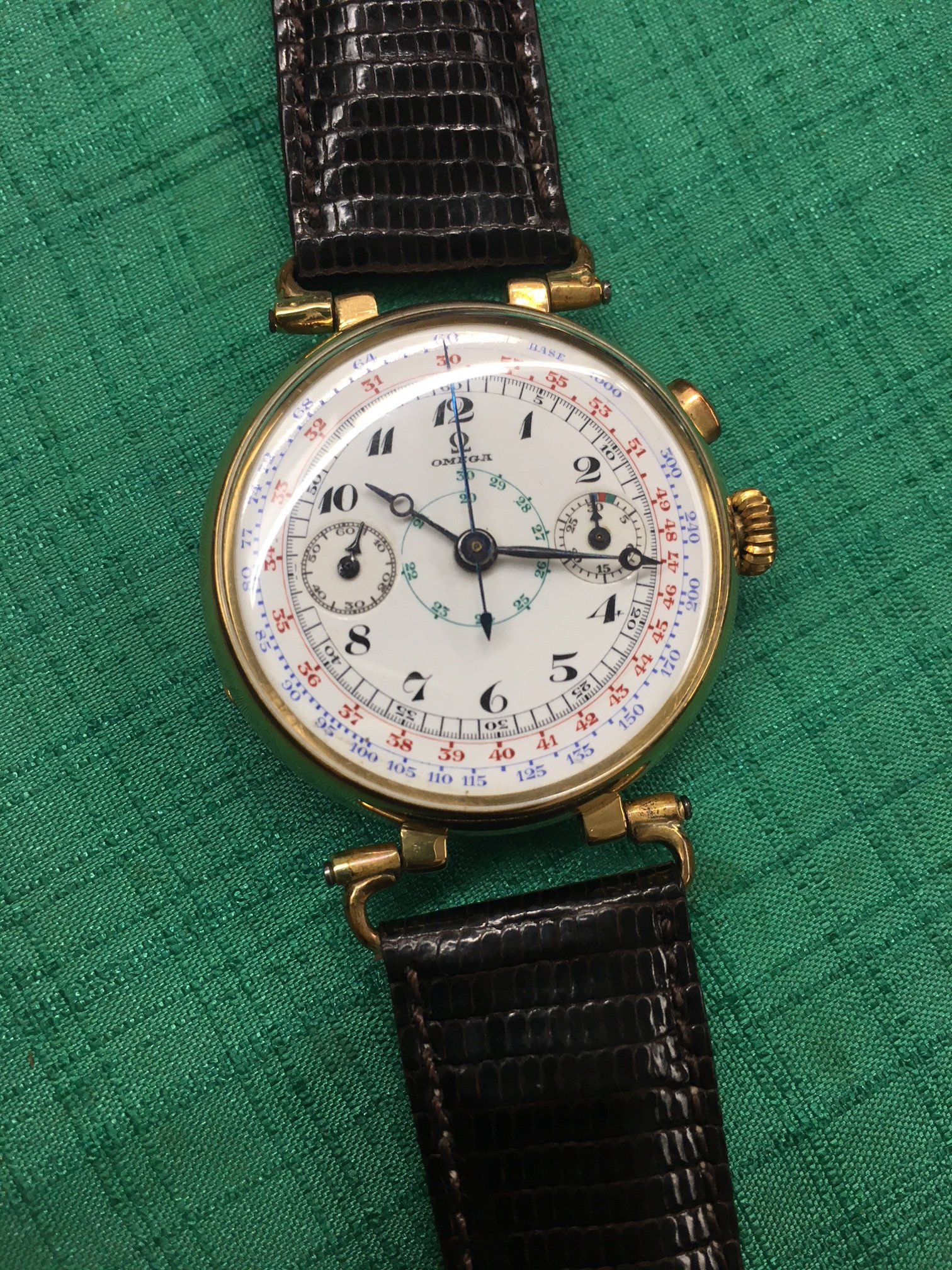

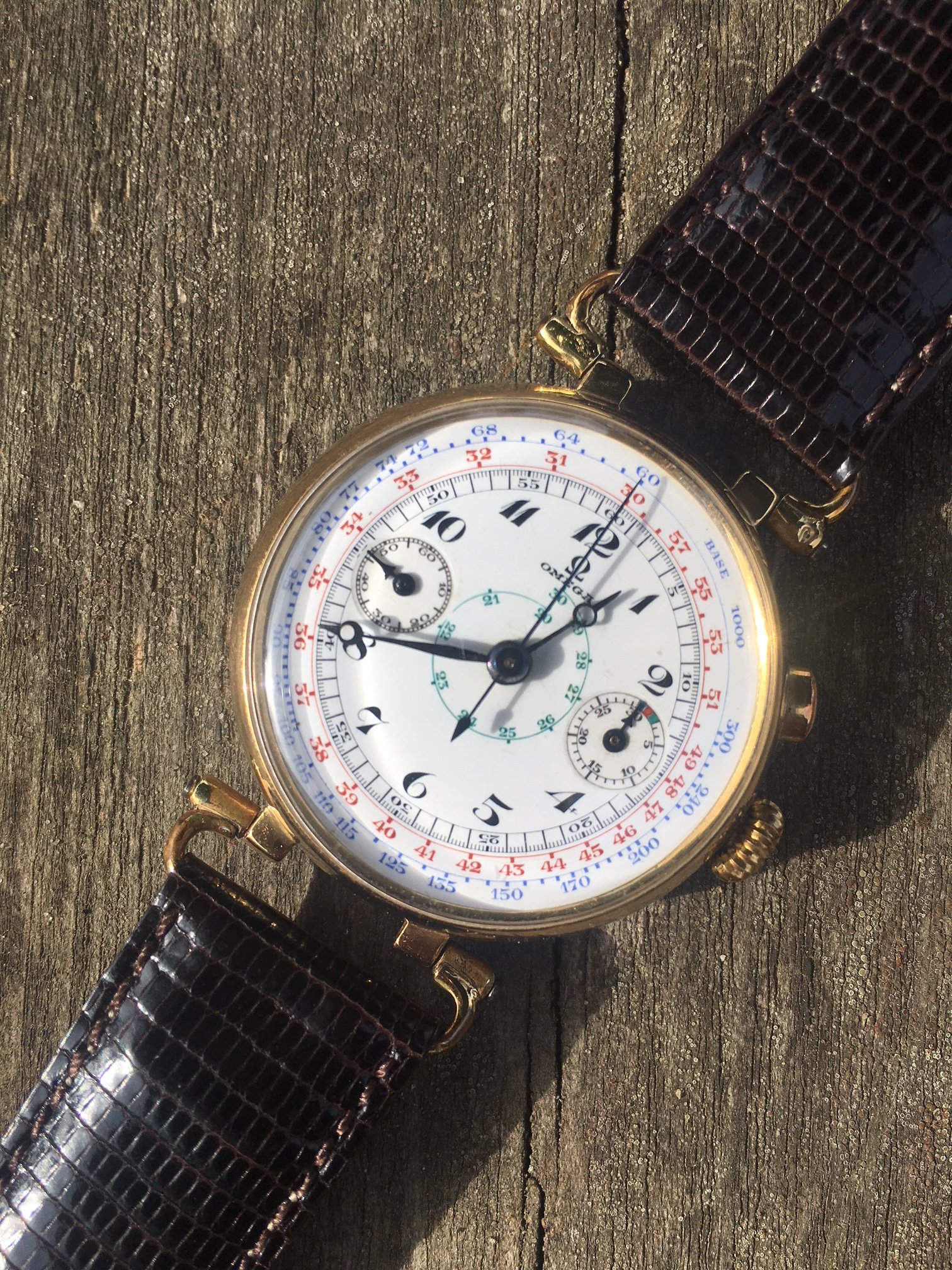

Long story short, I came across a deal that I can't properly assess... After acquiring a few watches from a watch dealer I "earned the right" to pick one from its private collection (you won't see this one online, for sure). After an intense debate this Omega ref KOT 741 As was my pick (really, really like this one). Before closing the deal, and since I could not find too much information about this 28.9 CHRO online, I would like to make you, guys, a few questions:
1. Does everything look as it should? (case, dial, hands, etc)
2. My collection focuses on rare watches. Do you have any idea how rare this one is?
3. Is it related to Italo Balbo Rome/New York raid? (or were it only the steel ones)
4. (this one is important) Does any one has any insight of how much it's worth? (has it made part of any recent auctions?)
In my opinion it all looks correct, however the shape of the chrono bridge, balance cock and other parts don't look to me like a 28.9 CHRO, maybe another Lemania caliber?

3. Is it related to Italo Balbo Rome/New York raid? (or were it only the steel ones).
The Balbo watches were stainless steel with a very plain chrono dials, your dial is more like the "Amelia Earhart" chrono where speeds up to 300 kph could be calculated based on one of the three coloured tracks, depending on where the small hand at 3 was pointing (3 small blue/red/green sections).
As the watch was delivered before Balbo made the Rome/Chicago/Rome expedition, it may have been a tribute watch to celebrate his earlier accomplishments (just me guessing) as the style matches the "Balbo" design.

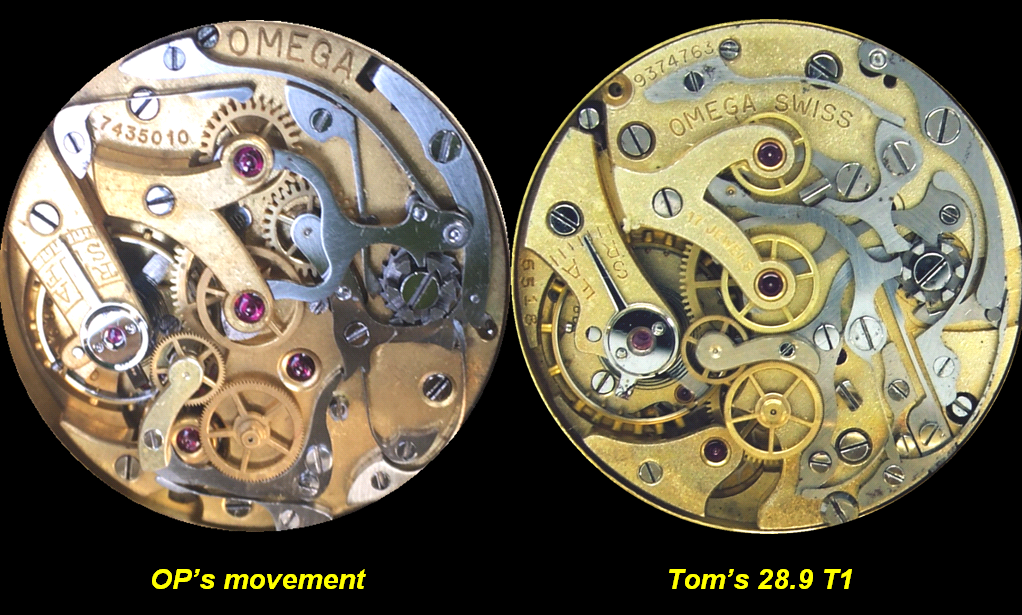

The history of this exciting time in Omega’s history is (to me) not very clear: there was a lot going on. Lemania joined SIHH in 1932 - and the introduction of the 28.9 CHRO and the 53.7 split-second Olympic dated 1932, the 33.3 CHRO one year later in 1933. We can be sure of the Olympic’s date - because it was introduced for the 1932 Los Angeles Olympics (although AJTT tells us that the MG1134 Olympic was 1930). Maybe Lemania were working with Omega on these before they joined SIHH?

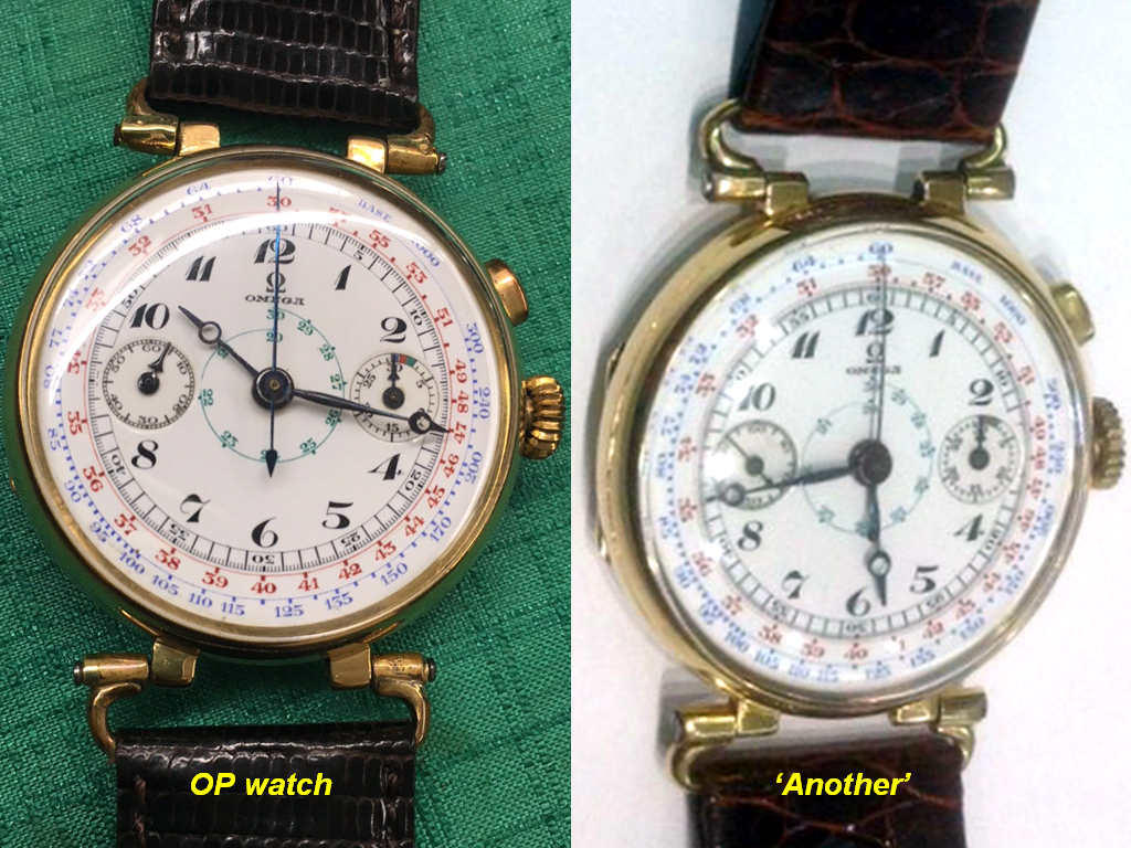

The earliest 28.9 CHRO that is usually found (and discussed) is the T1 - there is little to be found about the original version. I think the OP’s watch is the original 28.9 CHRO. Jim is correct in saying that there are differences from the ‘usual’ 28.9 CHRO - I think for this reason. But I DO think it is an all-original version (a possible query about the hand on the elapsed minutes sub-dial at 9 o'clock). Both this ‘original’ movement and the T1 were single-push and had an independent button - later transformations were two-push but the movements are recognizable, just more involved. This ‘original’ movement appears to be quite different.
The question then comes as to the origins of this first 28.9 CHRO movement. It doesn’t look like Lemania. I wonder whether Tissot were involved (who were also working with Omega at that time). Sadly my researches on this have so far come to nothing.
I show an image that compares the OP’s movement with my (1935) T1 (to show the differences). I also show another ‘original’ 28.9 CHRO which has very similar numbers and must have been in the same batch as the OP’s (apologies, I have partly blanked the number because it is not my watch - but it is of interest to compare). This watch was also sent to Italy.
Although the Balbo watch was steel, because it was so early it is quite possible that the movement was the same as the OP’s. The Earhart watch was a T1 (although with a dial similar to the OP’s, as Jim points out).
Following numbers of these watches is difficult - not least because movement numbers were issued in batches and some Omegas were still made in Geneva, so they are not always in sequence. When production of the 28.9 and 33.3 really got going (after about 1933), the typical case/movement numbers were 884****/937**** - but these numbers (860****/743****) tally with other watches of this period.

Thank you Jim for linking me in. Yes, I think I can offer something - but not everything!
Following numbers of these watches is difficult - not least because movement numbers were issued in batches and some Omegas were still made in Geneva, so they are not always in sequence. When production of the 28.9 and 33.3 really got going (after about 1933), the typical case/movement numbers were 884*/937* - but these numbers (860*/743*) tally with other watches of this period.
