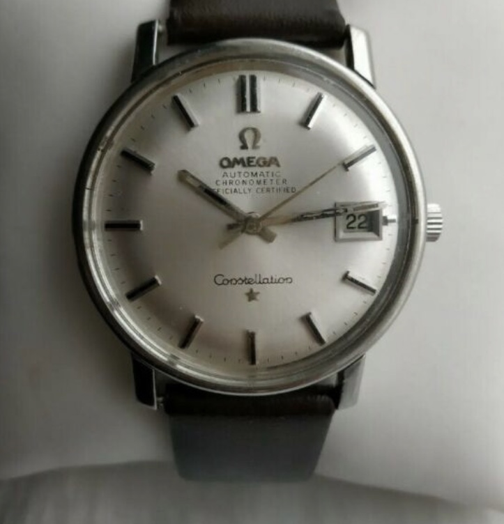

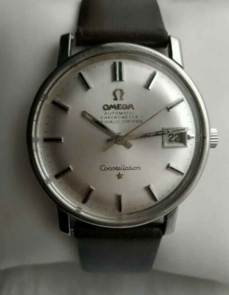

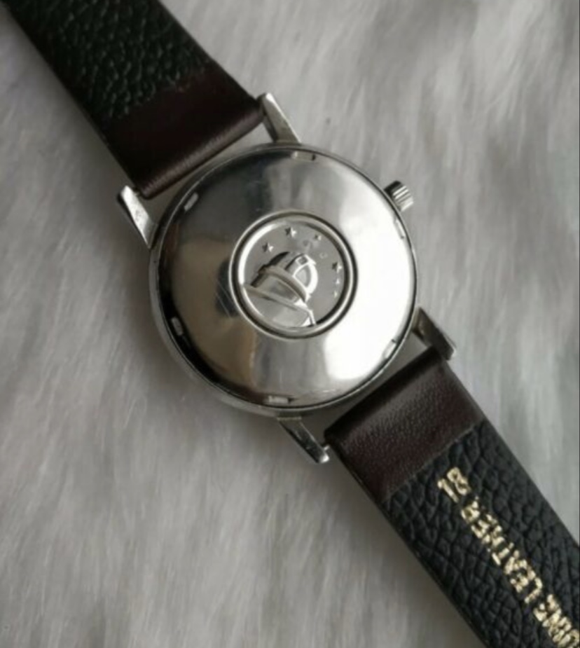

Hi Guys, I’m a new member from Scotland and was looking for some help with a watch I’m looking to buy.
It’s advertised as an Omega Constellation 564 Automatic, but the face looks a bit off. Although it may be the photos.
I’ve been checking out posts on here for a white and comparing it to some of your examples, but I’m not sure.
I’ve read up on the MOY test and the watch seems to pass.
Any help you could offer would be appreciated and if it’s a ‘go’ I’m happy to post pics as soon as it arrives!
Cheers guys,
Brisco
13,555
23,503

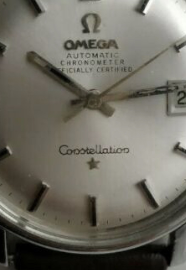

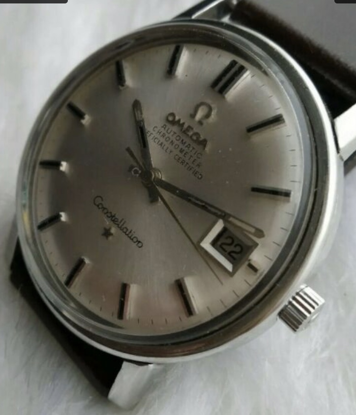

Photos are terrible For assessing any details but it's a redial unfortunately. Crown is wrong as well.
9,355
78,305

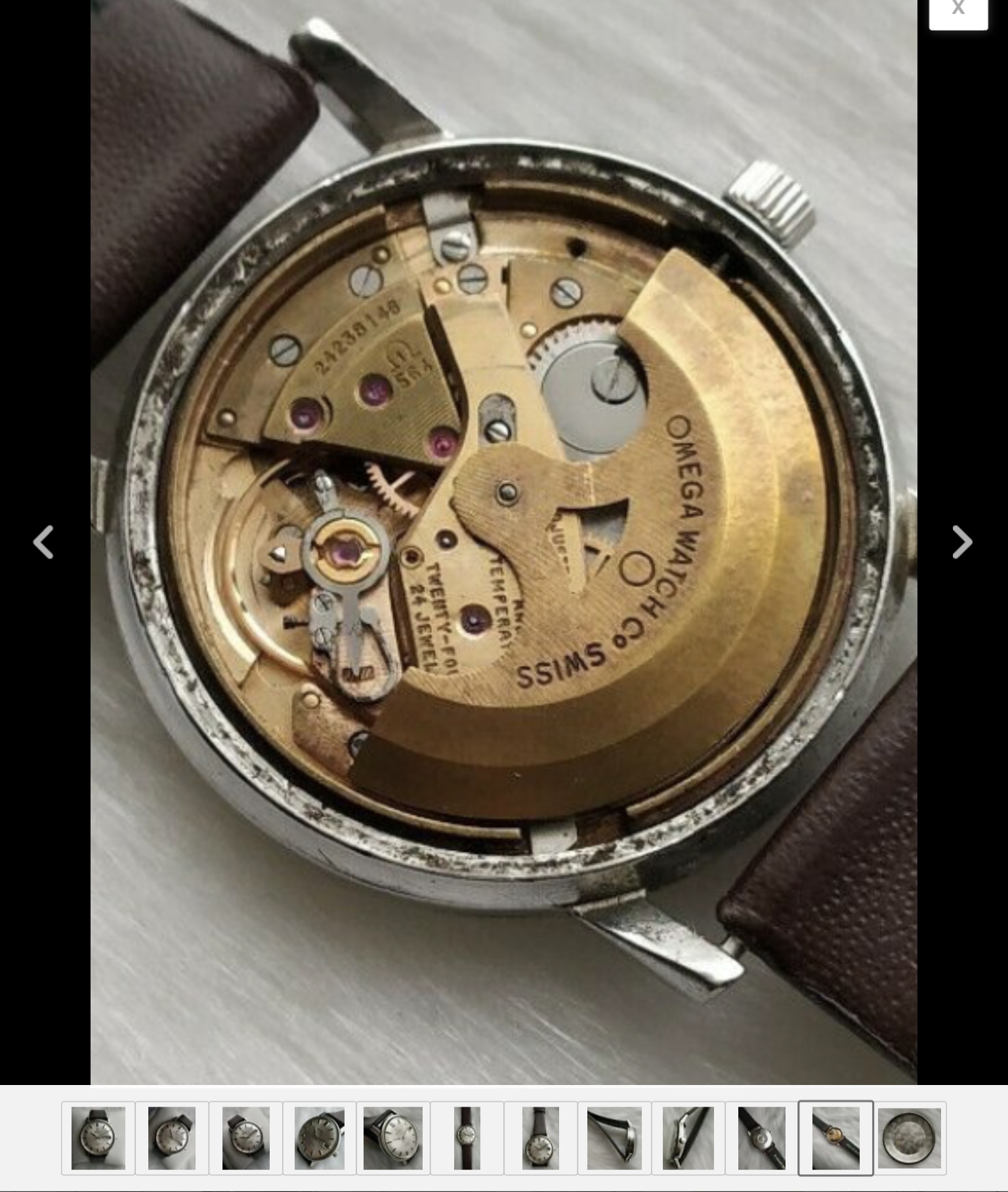

Thanks for this. You should probably be posting photos of the movement and inside case back to obtain worthwhile advice on the merits of the watch.
Superficially, and I’m not into Constellations, from the photos you’ve posted, the case looks to have been polished (which may not be a good sign) but on the positive (from your perspective) the hands look well worn and the marks on the dial between 9 and 12 suggest to me that the hands and dial are in original condition, although the minute markers have vanished. On the negative, to the naked eye, the dial star doesn’t seem to sit true in the photos.
I'd personally give it a miss.

This watch has a very peculiar mix of characteristics.
It looks like a 168.018, which would suit the hands and crown - but it has a dome dial when it should be a flat dial.
however, it has a square date window - which you would usually find on much later Connies and never (to my knowledge) on a dome dial.
the case back is also really odd looking and doesn’t match the reference.
looking forward to see what’s inside.
Still, if there is a 564 under the hood it’s worth the £140 gamble.

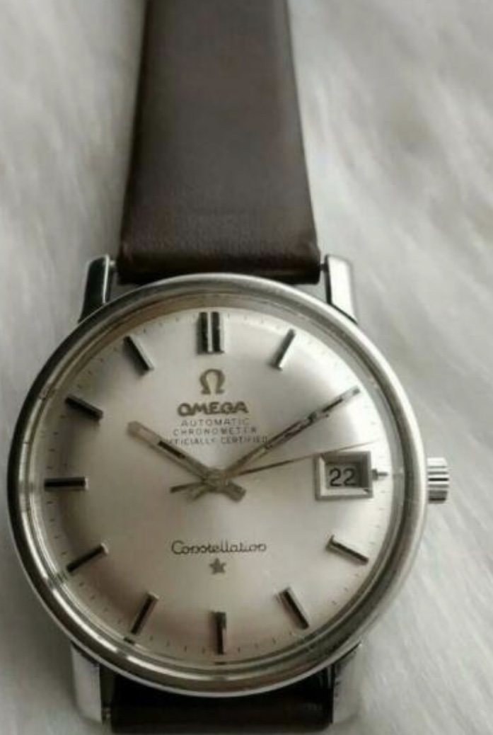

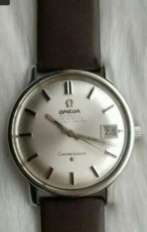

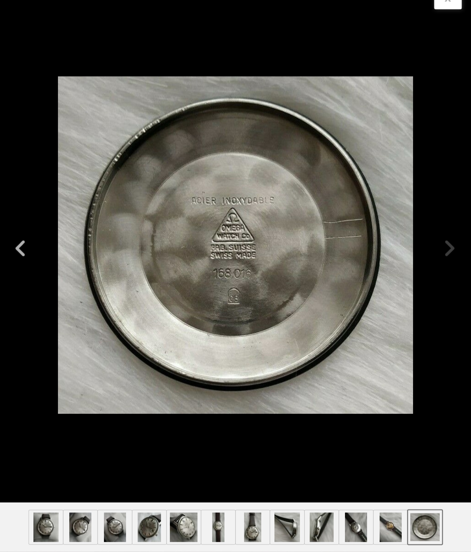

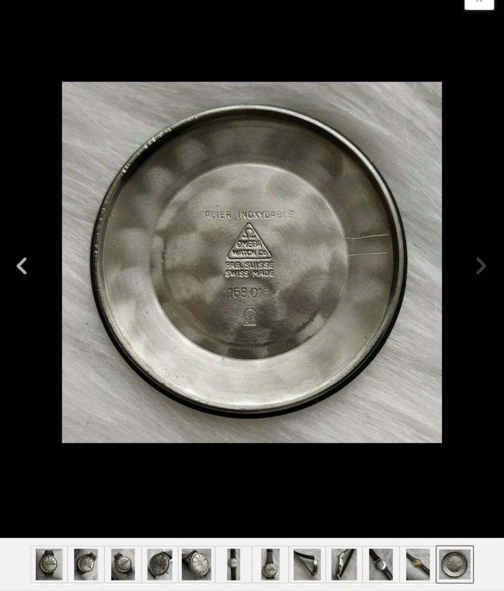

Unfortunately, it looks like the watch I bought is the actually the watch for sale on EBay! Look at the photo of the case back (particularly the reflection) for both my photo and the EBay photo. The reflections are the same. The other photos are very similar (if not identical). I’m not sure who the scammer is, the EBay guy or the Gumtree guy. I have contacted PayPal and they are investigating this. I tried to call and email my Gumtree seller and his mobile number is only 8 numbers long, so it doesn’t work.
6,835
10,503
Definitely the same watch.
Hope you get your money back.
