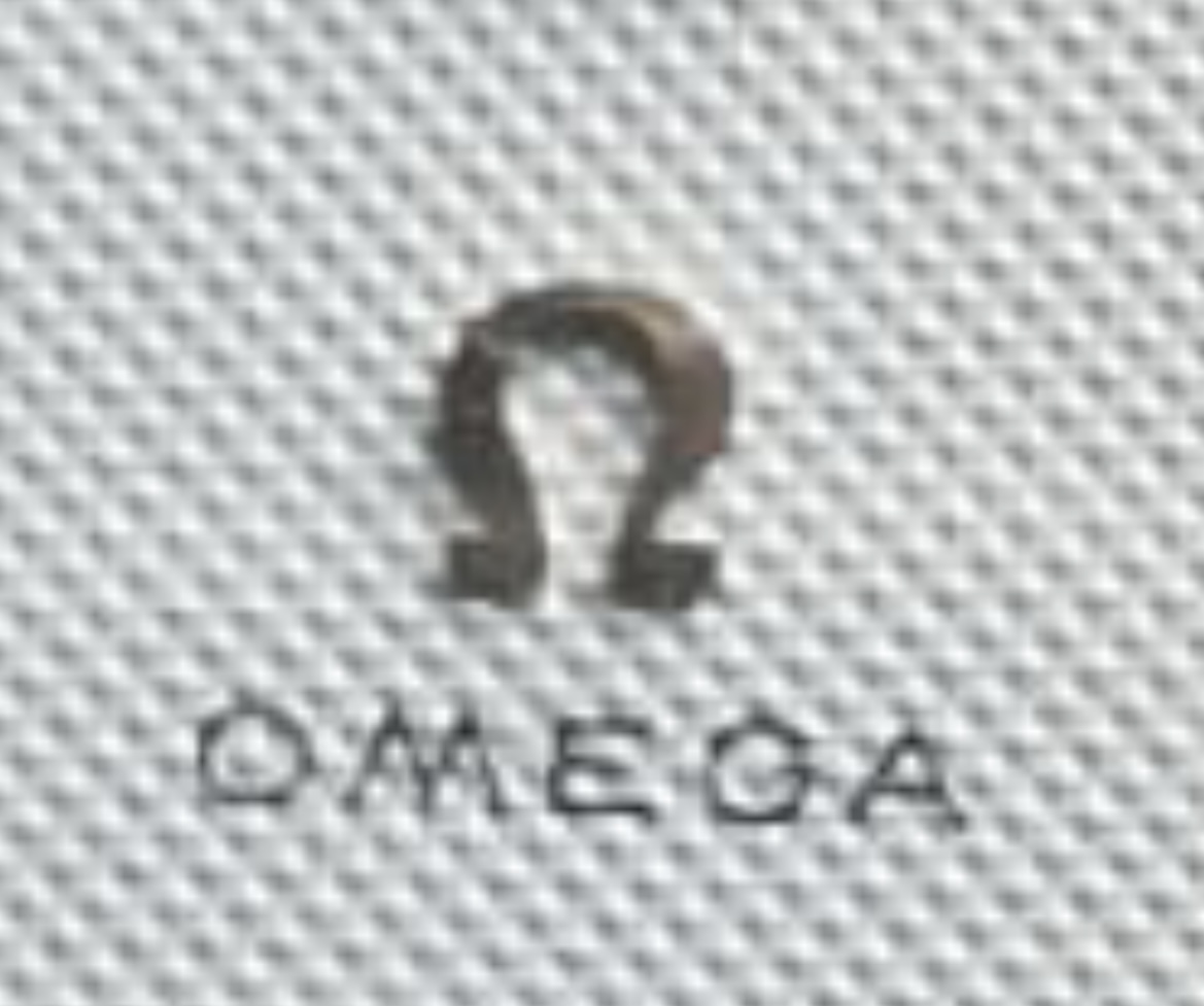

Will save everyone. I am considering the purchase of this gold omega and would like to get your opinions regarding the dial. Is it reprinted?
Thank you in advance

By no mean am I an expert, but would tend to vote repainted, based on the fact that the Omega logo appears not as neatly written compared to other examples I have seen (especially the « E »). It could be the picture quality though as we approach the limit of pixels. There are a few examples in the private sales forum to compare to. Honeycomb dials aren’t perfect in nature, so it’s not always simple to draw the line.
Suggest you wait for other more experienced people to give their opinions as well!
Yours vs. Another example from the sales forum

All I can say is that I would not buy the watch based on those photos.

Better photos would help, but if pressed I’d say the dial’s original

I'd vote redial based on the E and G also the tiny minute hashs between 7 and 8 o'clock.

IMO it's a redial based on the Omega and the minute marks. Many of them are angled and not directly aligned with the radius, as well as being of variable lengths.
It's not a collector grade watch, but if it looks good on your wrist and you like it and can afford it, only you can decide.

Redial, the G is not right, also look at the inconsistency of the minute marks between 1 and 2.

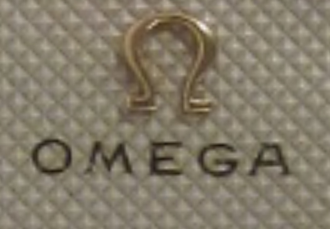

I don't understand what's wrong with the minutiae. In my opinion the font is right,.it has slightly different g but after 70 years I think it is normal. Here are some examples taken from dials claimed to be original

Here is another from a well-known European auction house. Same reference
P.s. the crown is original but has lost some plating.

I would agree with the verdict of redial - the second track appears to be off, as like another user has mentioned the intervals are not all facing the precisely correct direction, and the logo too is incorrect. The G as pointed out is wrong, and there is too great a gap between the applied logo omega symbol and the printed OMEGA part of the logo.
