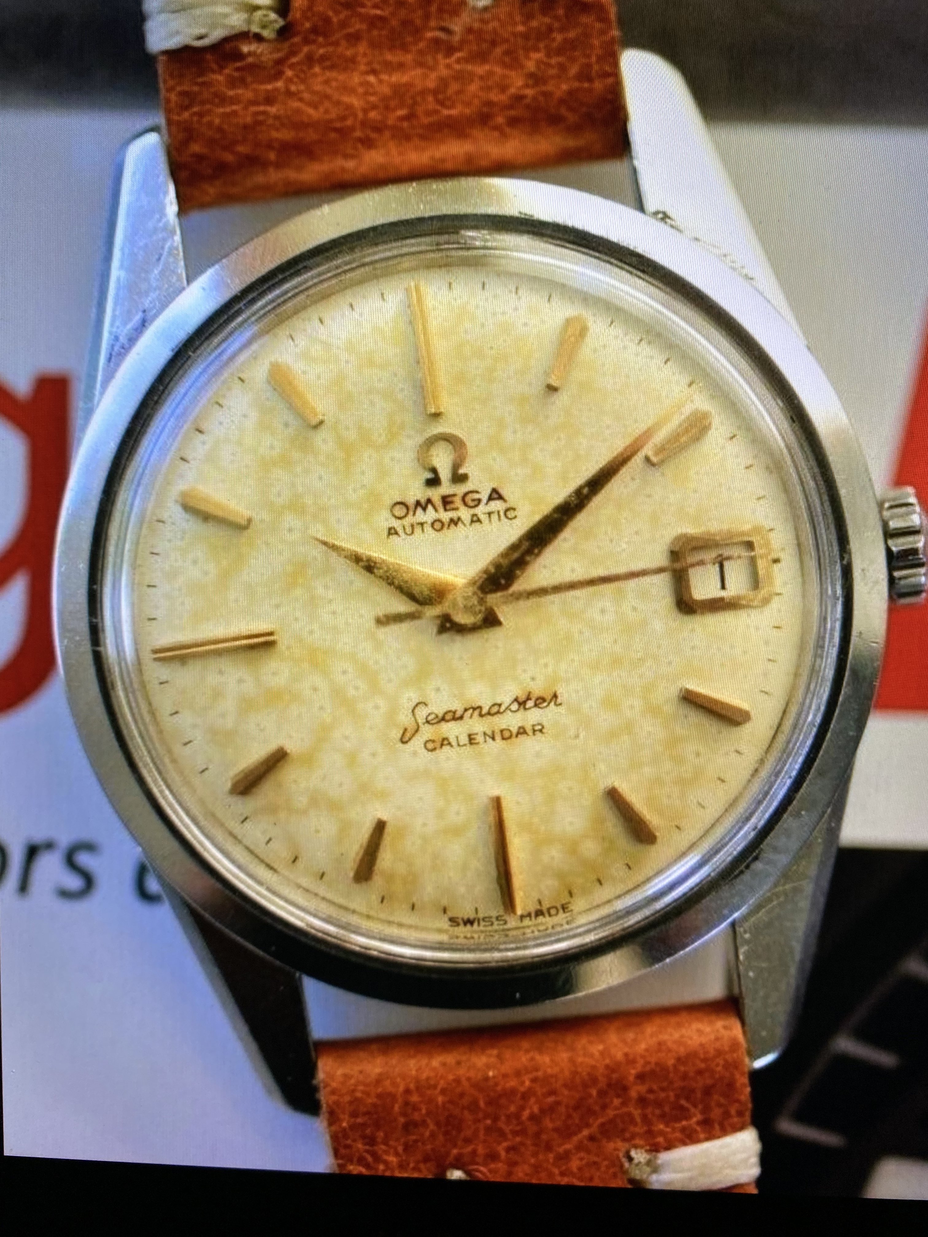

Hello! I am brand new to the vintage watch community and I am trying to educate myself as much as possible before making a purchase. While browsing eBay and chrono 24 I find myself questioning many pieces as I am looking to purchase 100% original seamasters from the 60s decade. I figured I would make this thread for individuals in my similar position to post pictures and ask questions that more experienced enthusiasts could help answer!
8
I came across this seamaster on eBay (ref. 14701 1 sc) and am having some speculation about the 12,6, and 9 hour markers. When I look up the reference # none of them have the elongated markers so I’m thinking they have been replaced? From what little knowledge I have everything else looks original but I could be wrong. Any advice helps. Thanks in advance.

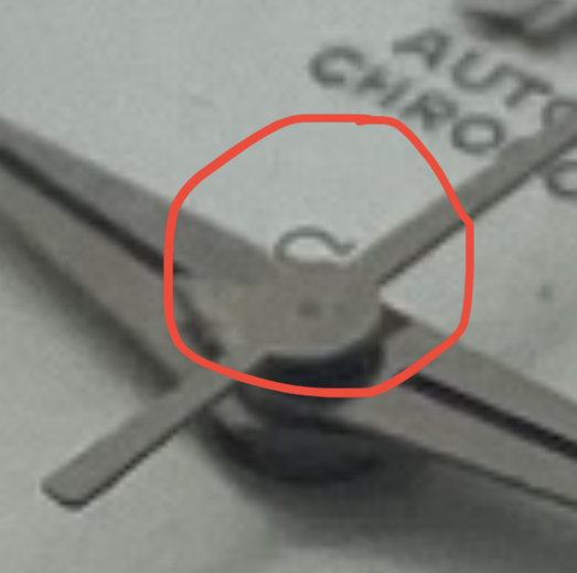

You mentioned the etched logo in the middle of the plexi? What should I look out for when it comes to that?
Omega plexis have a tiny (like 1mm in diameter) etched in the middle of the plexi. Hardly noticeable with the bear eye. I was merely mentioning this as an example for an opinion (vs. straight information) as you were looking for “100% originality”. Personally, a generic replacement crystal could never put me off a nice watch. They get scruffy over the decades and were regularly replaced at services. Sometimes, people are a bit cheap (or Omega didn’t offer the plexi anymore) and a watchmaker would simply use a generic one. It’s very common.

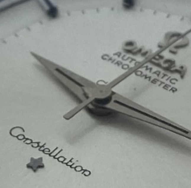

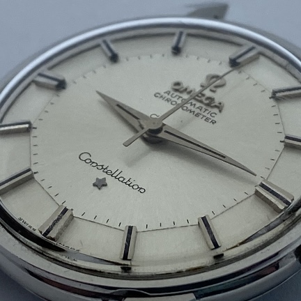

Not the best pictures, but have a look if you can spot it:
