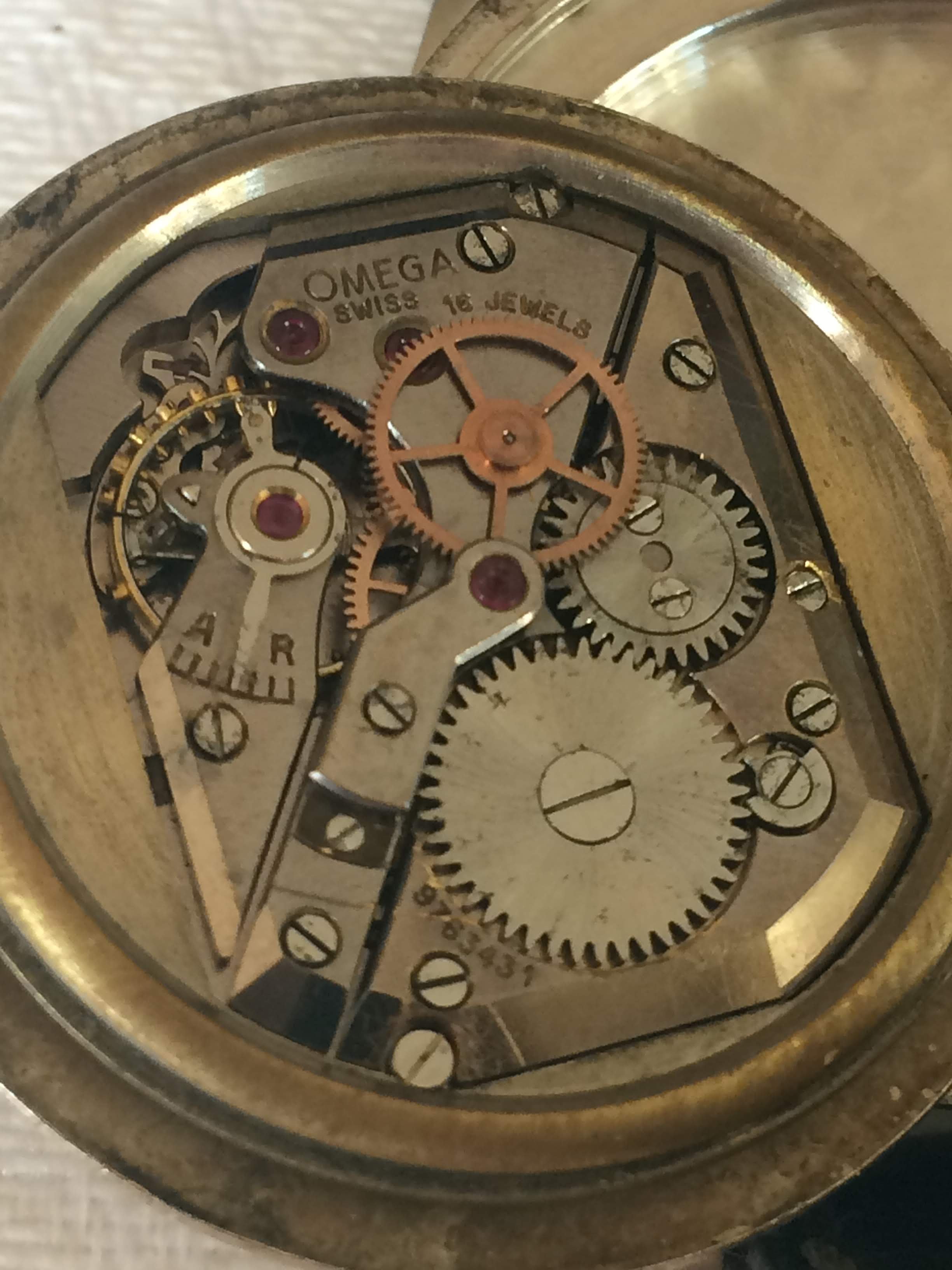

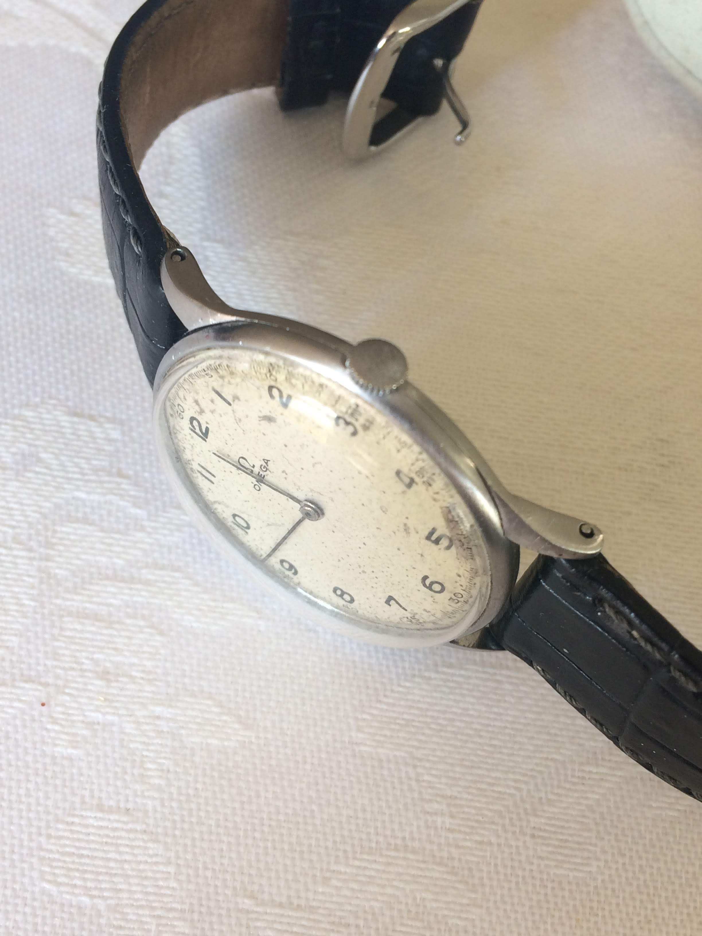

Hi guys,
I need some help identifying the correct caliber on my watch.

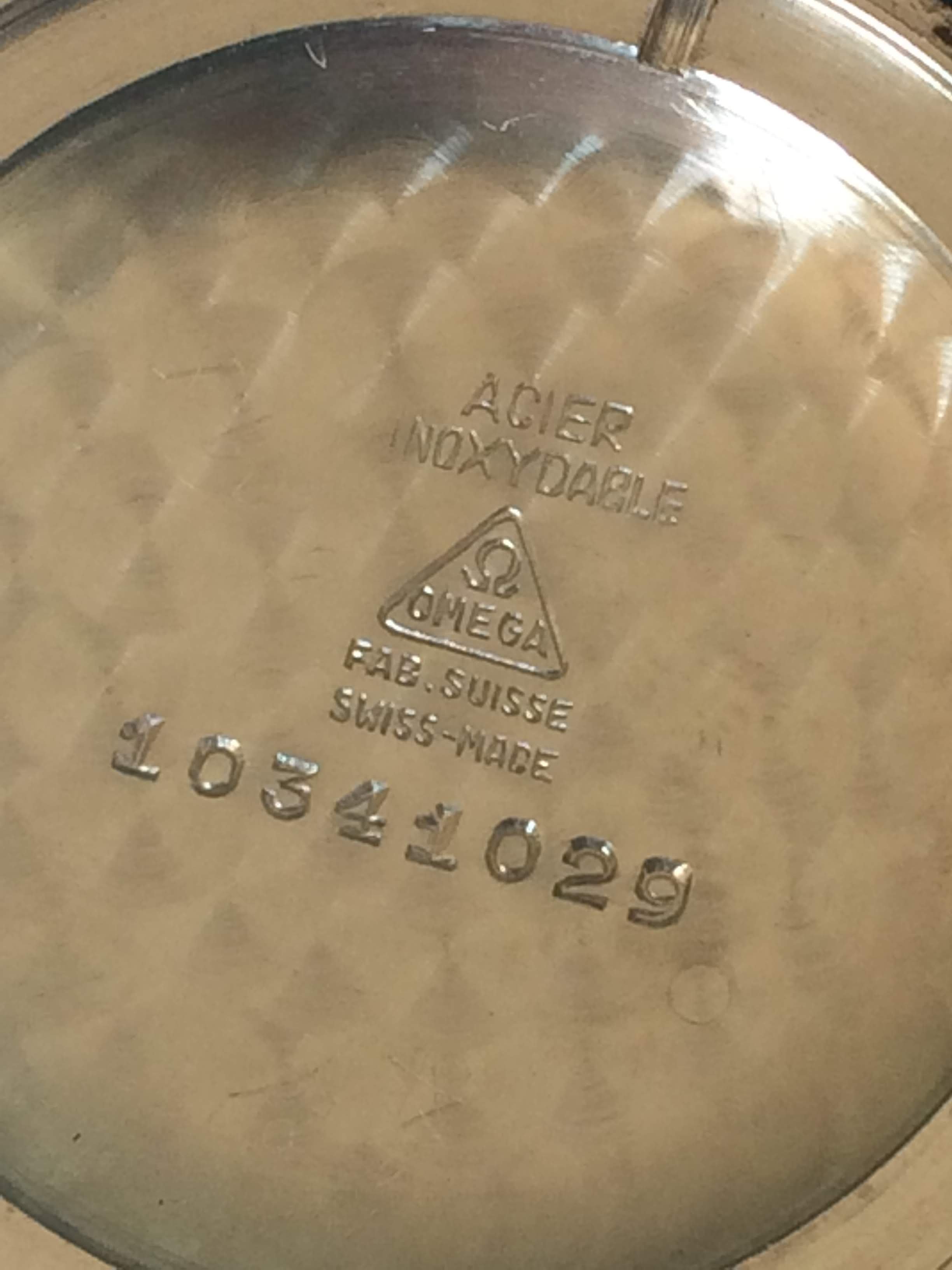

I found that it is post 1939 according to the reference numbers on the movement, but I can't find any other reference that identifies the movement on the watch.

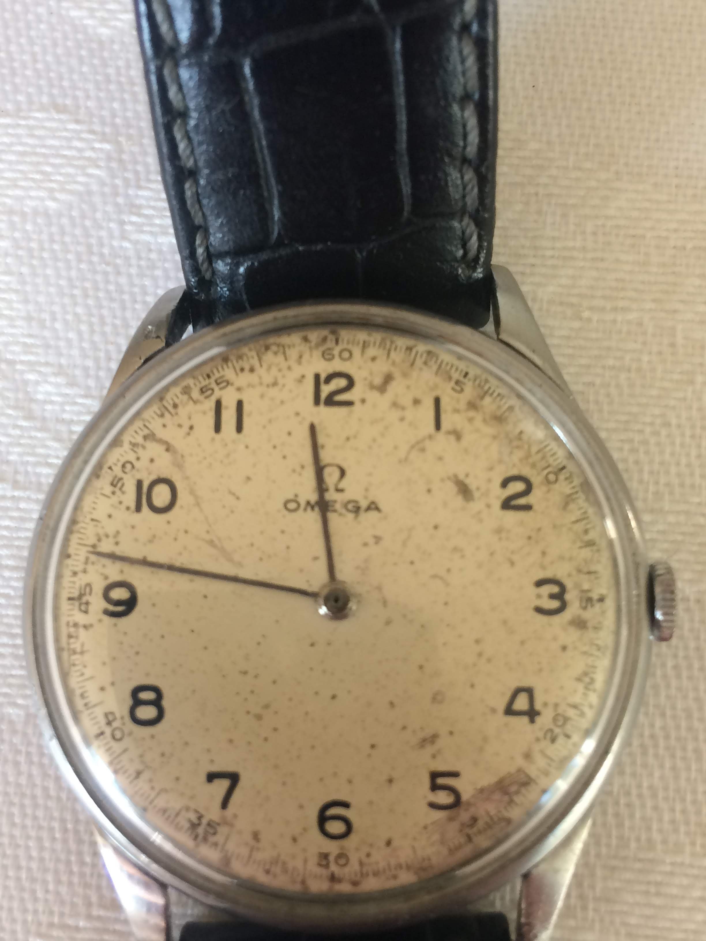

Sorry about my igonorence but I also never saw any omega like this one, with a squared movement on a round case, so any information you have on what might be this watch is really appreciated 😀
Thanks for the help!

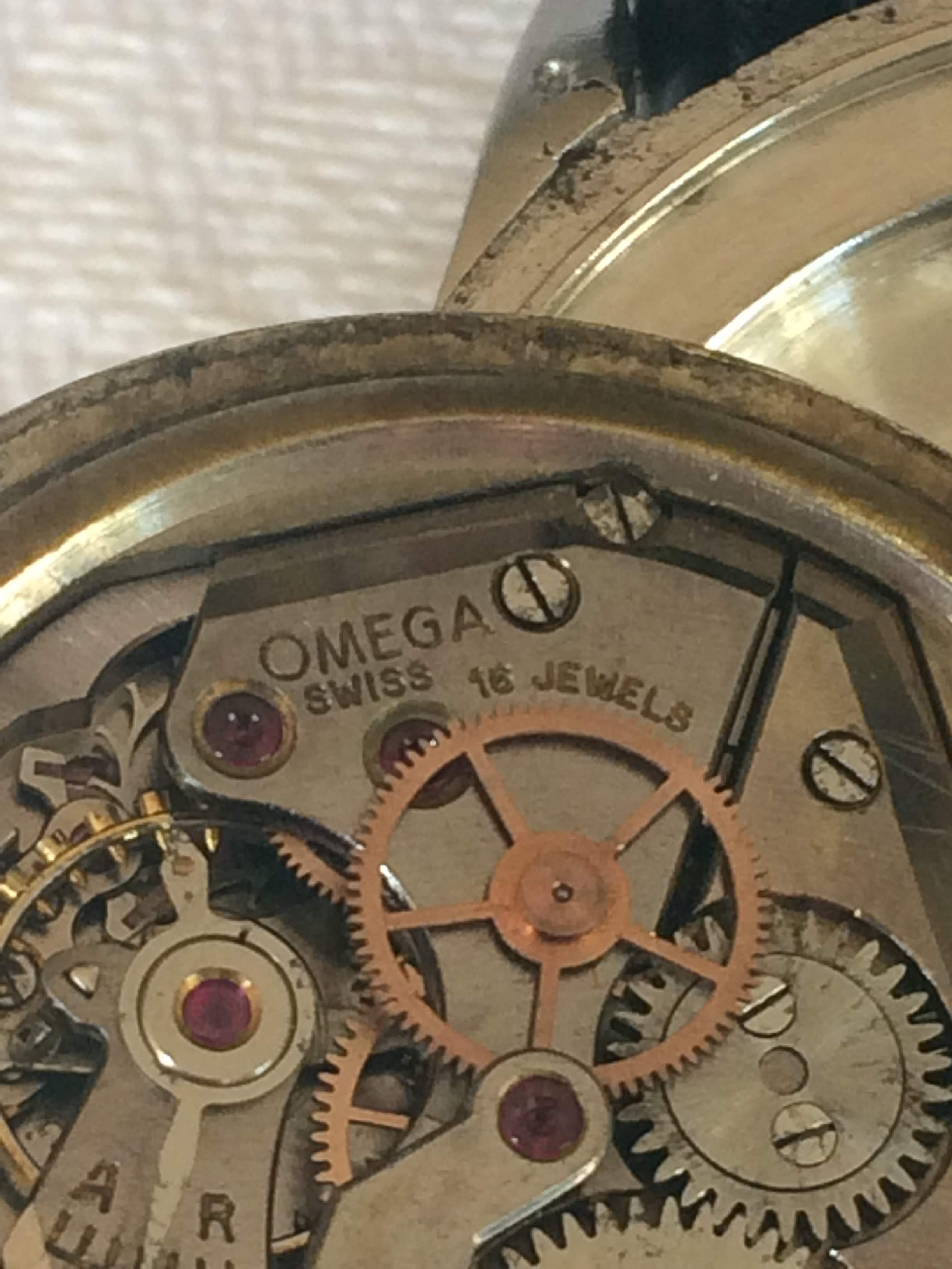

R17.8 SC from early '40's. Came with 16 or 17 jewels. Caliber 310 .

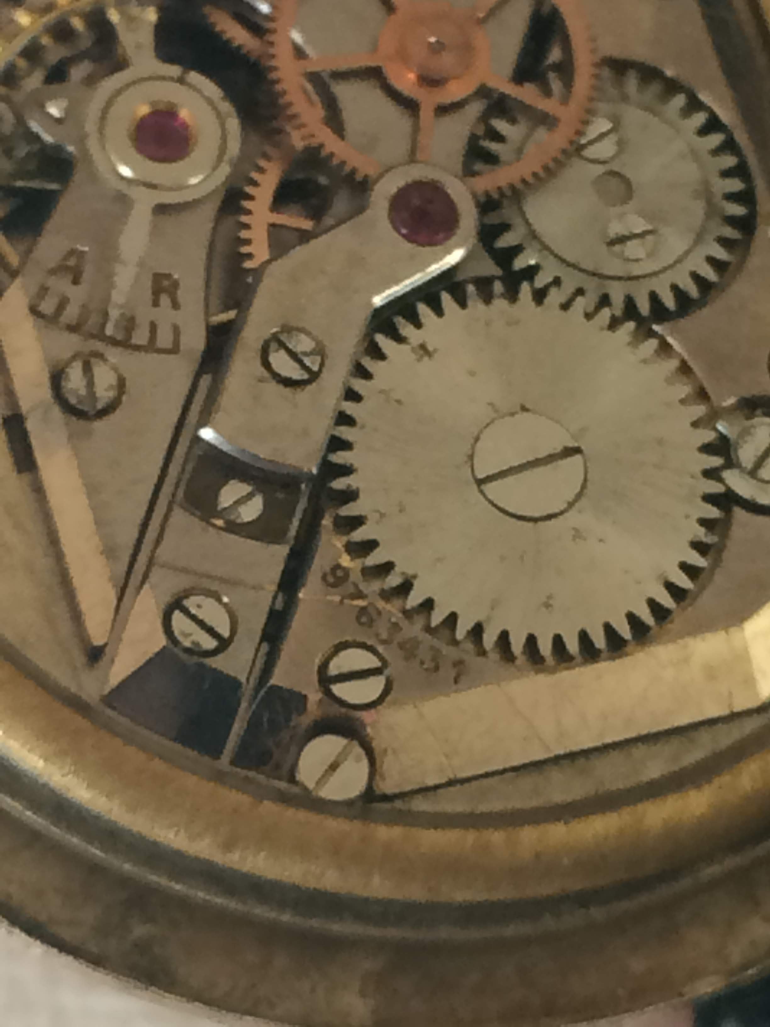

See if anything is inscribed under the balance.
