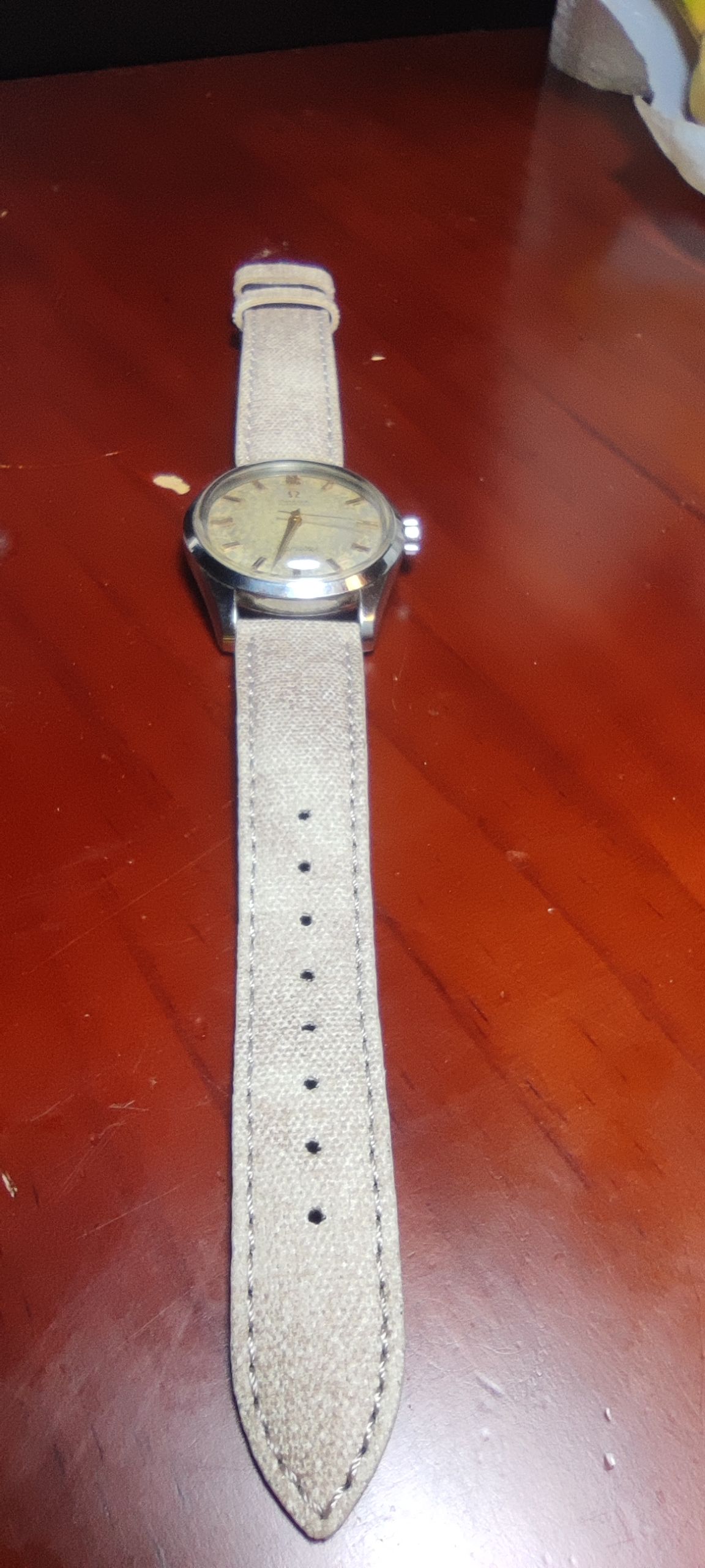

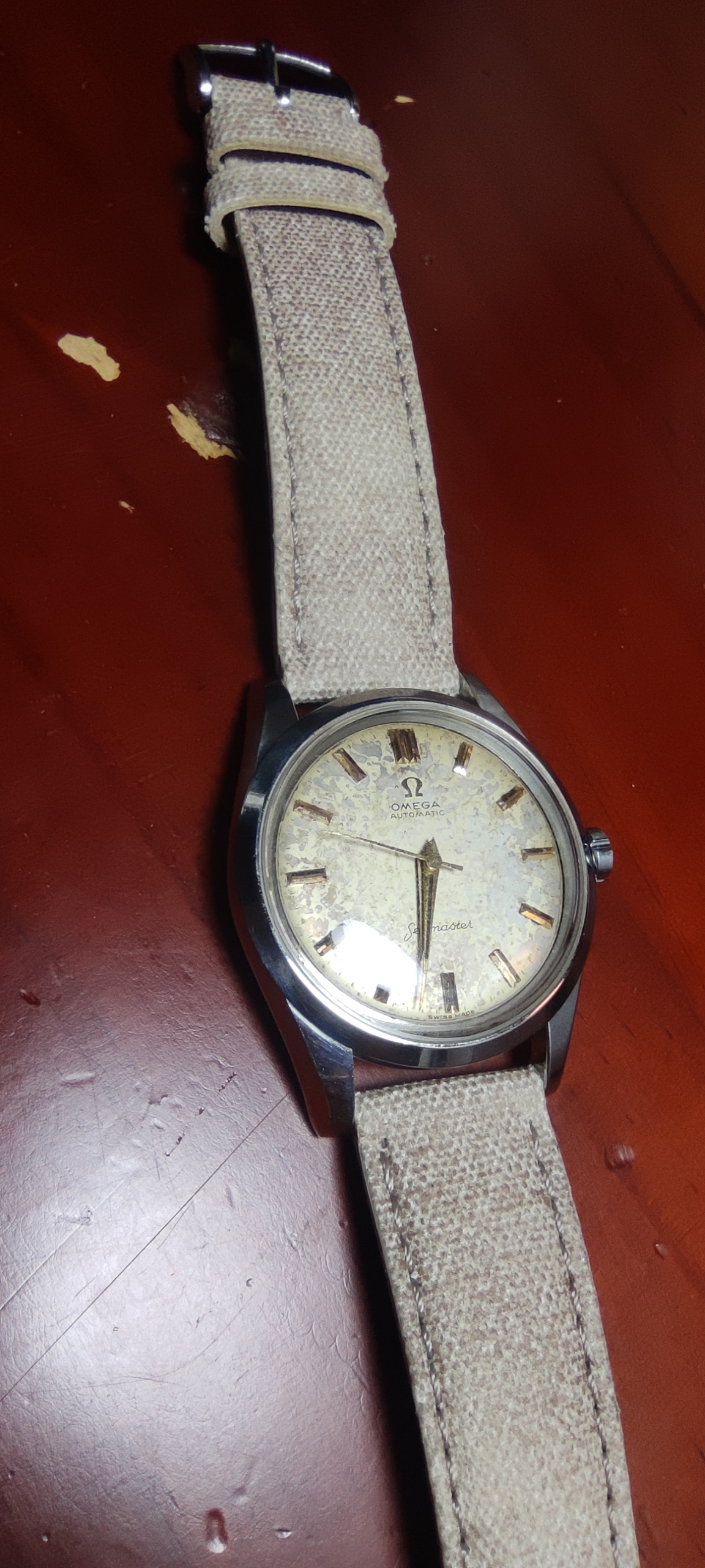

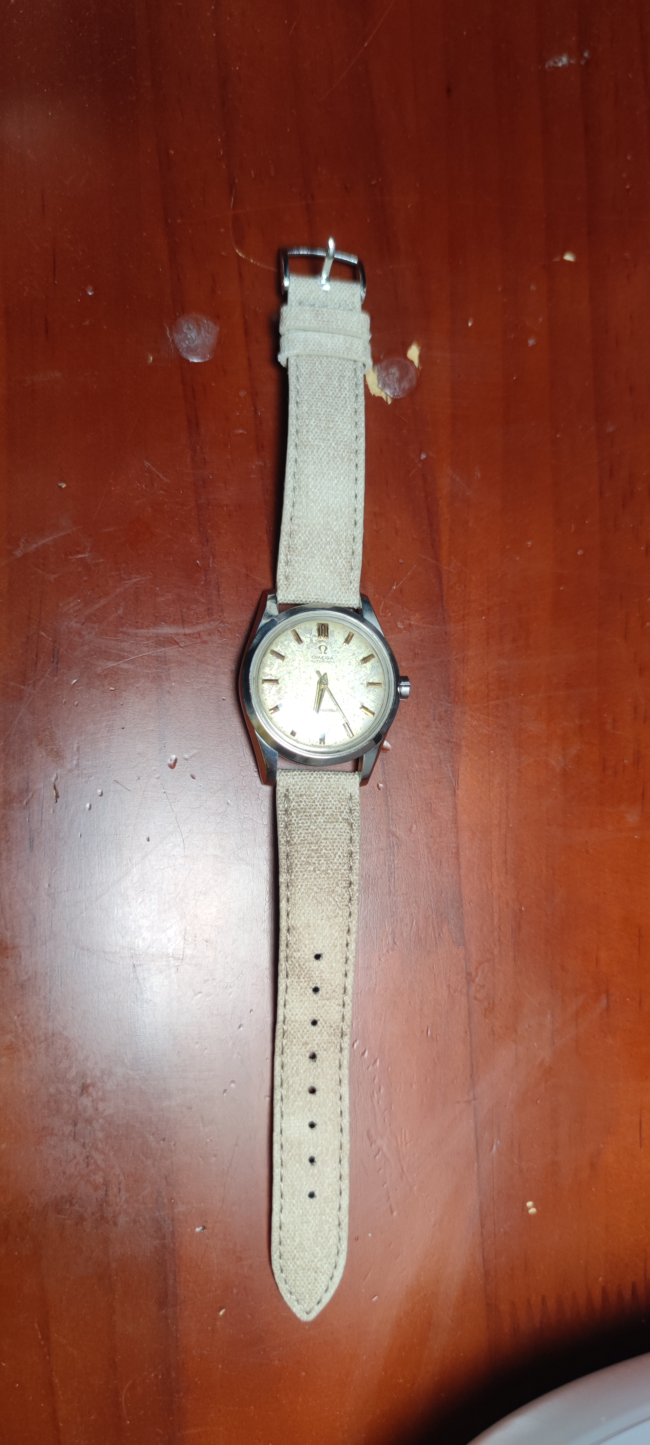

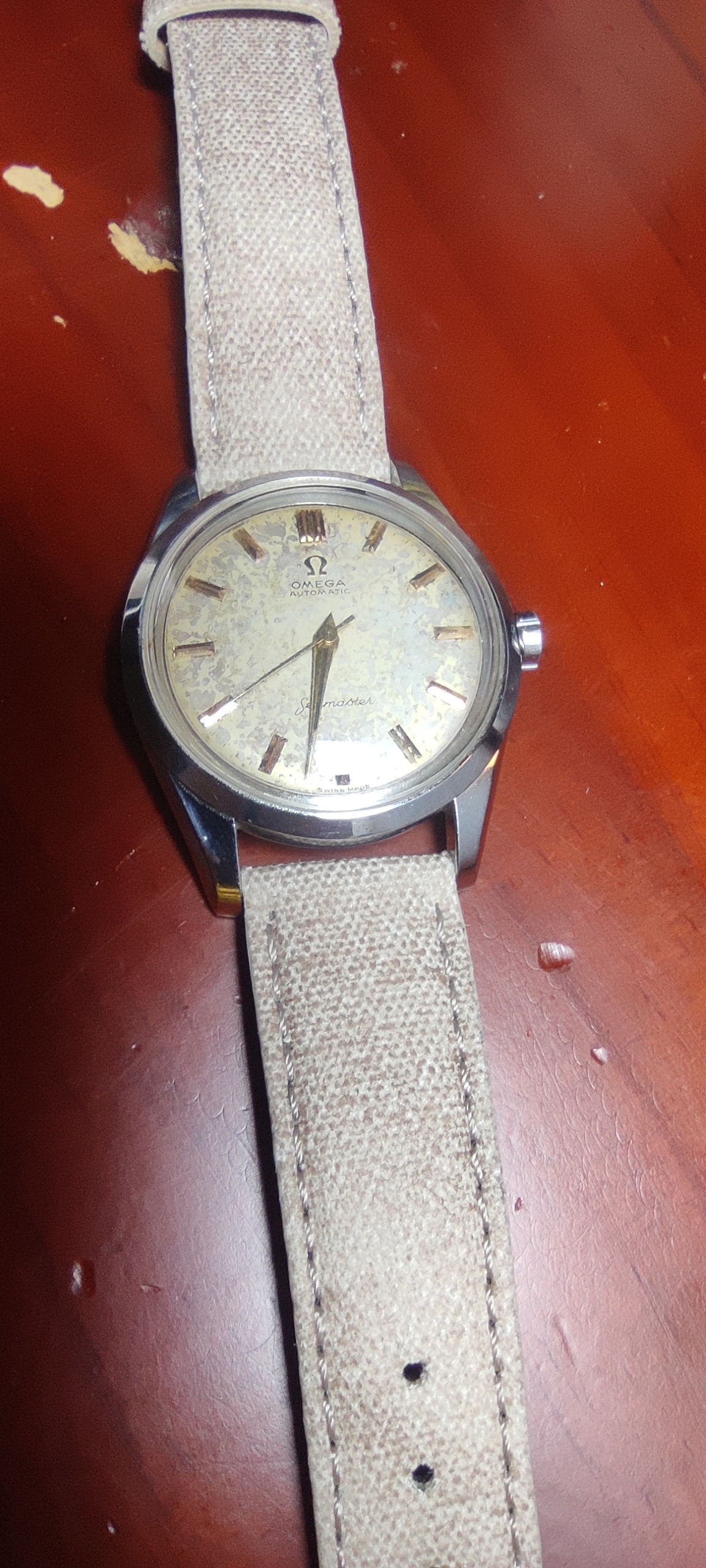

Thank you all guys for your help! I found a very nice bracelet, now I will start to enjoy it on my wrist 馃槑
Pics?

Way better with a natural light though. The match with the dial is perfect to my taste.
