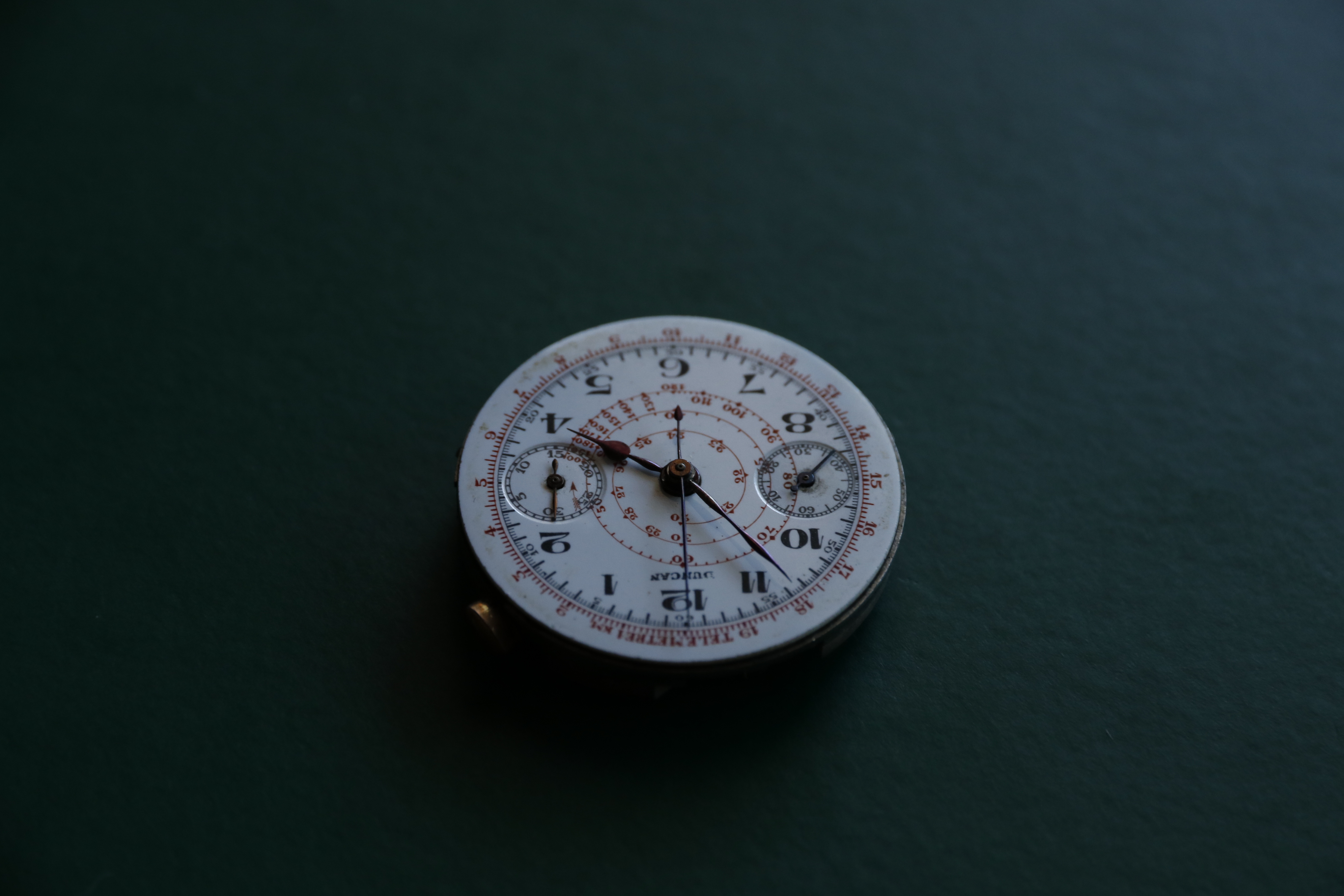

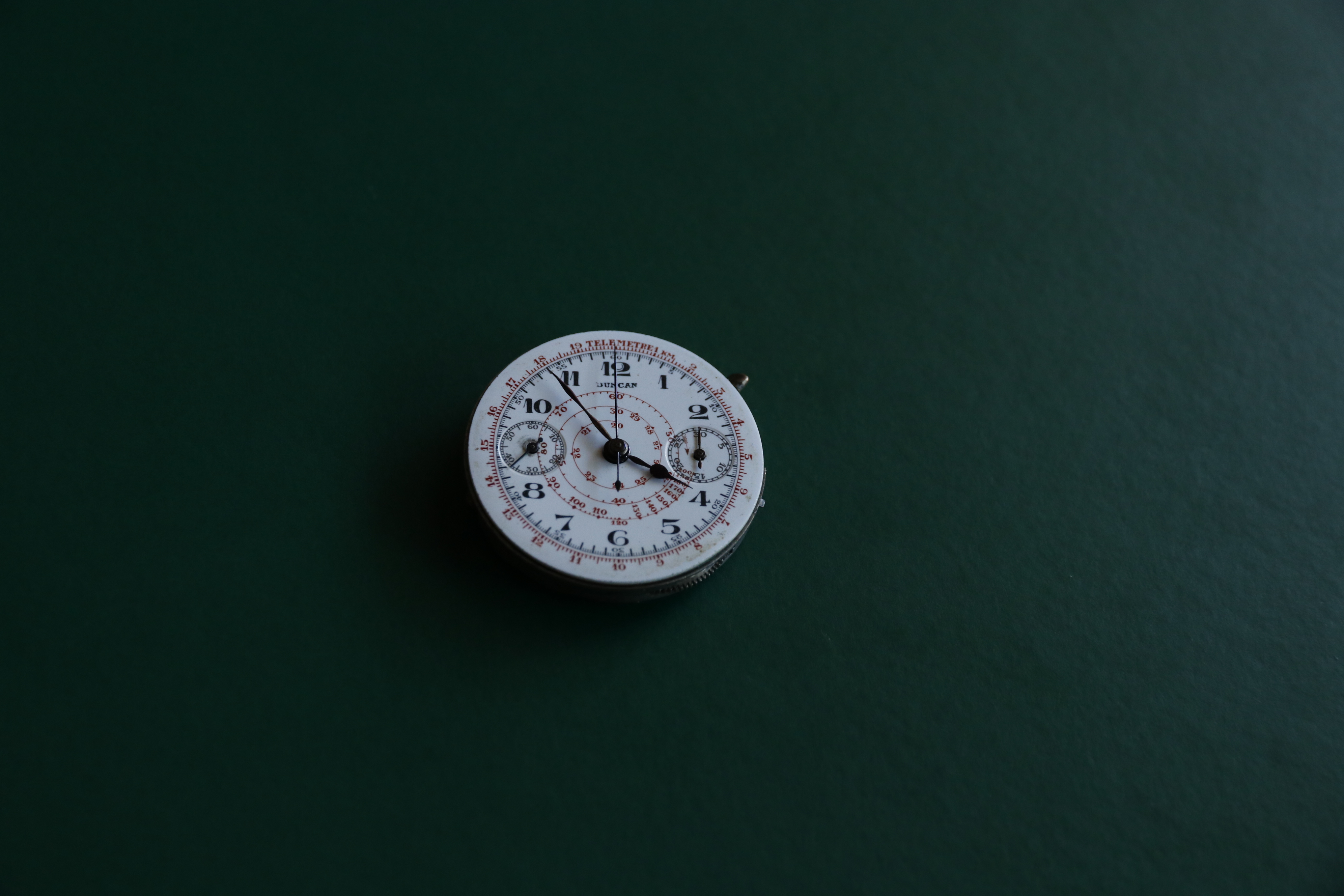

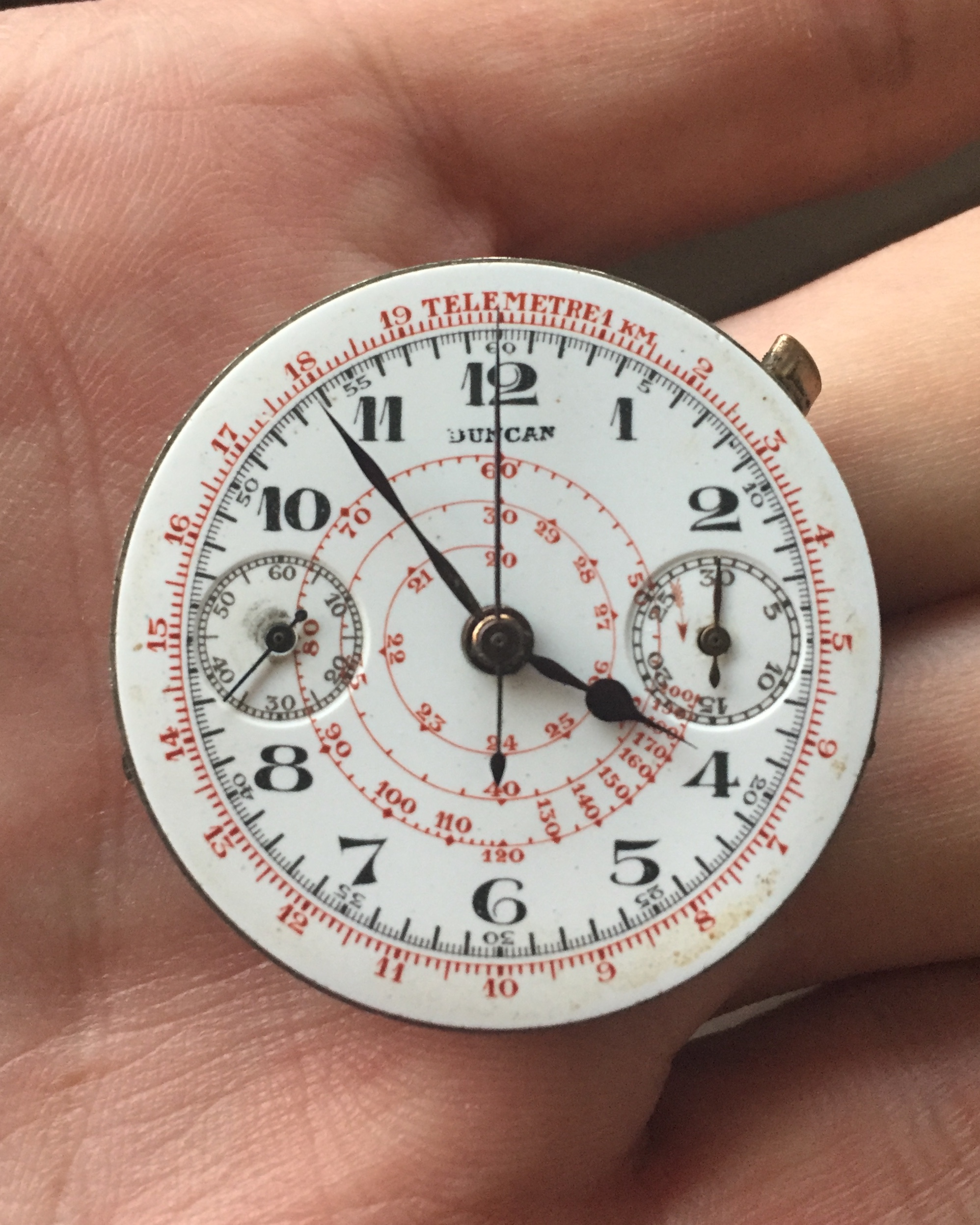

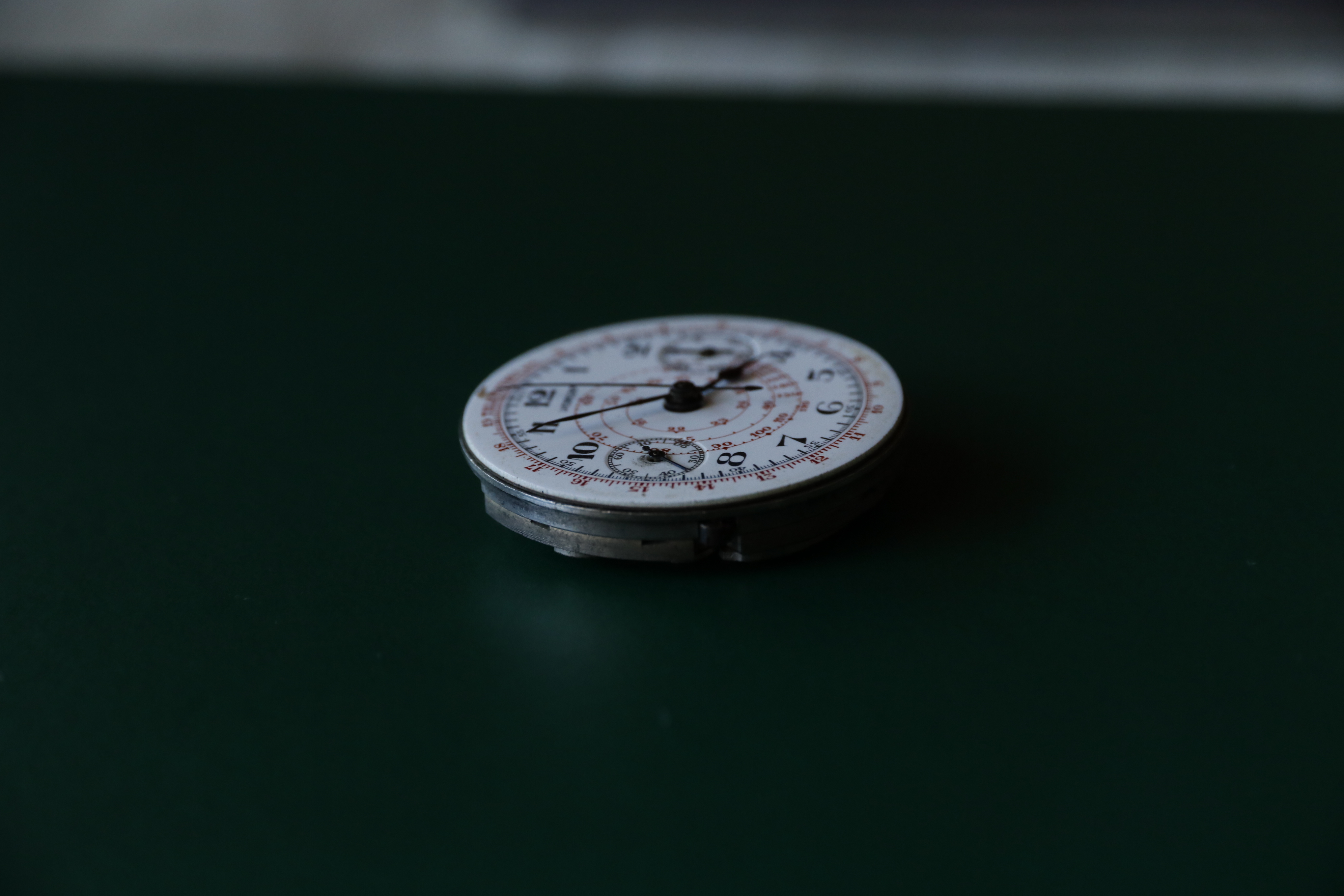

Hello to all OF members 😀

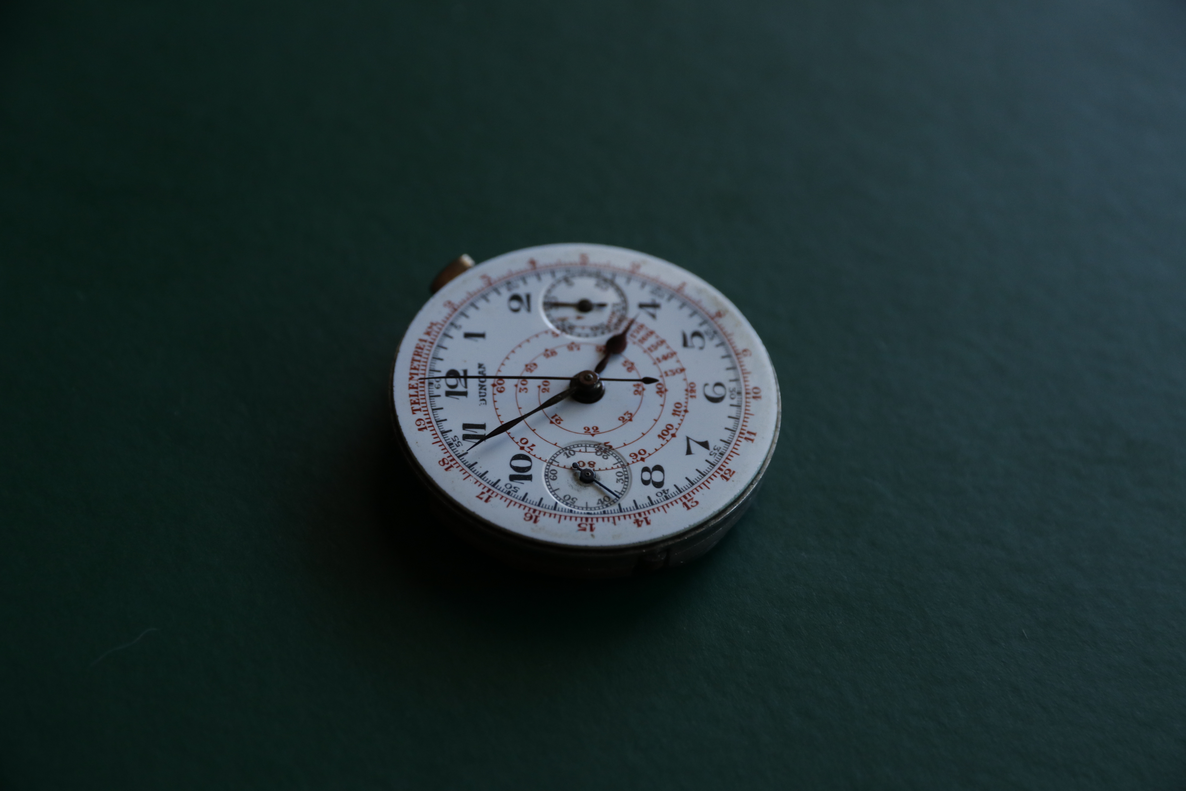

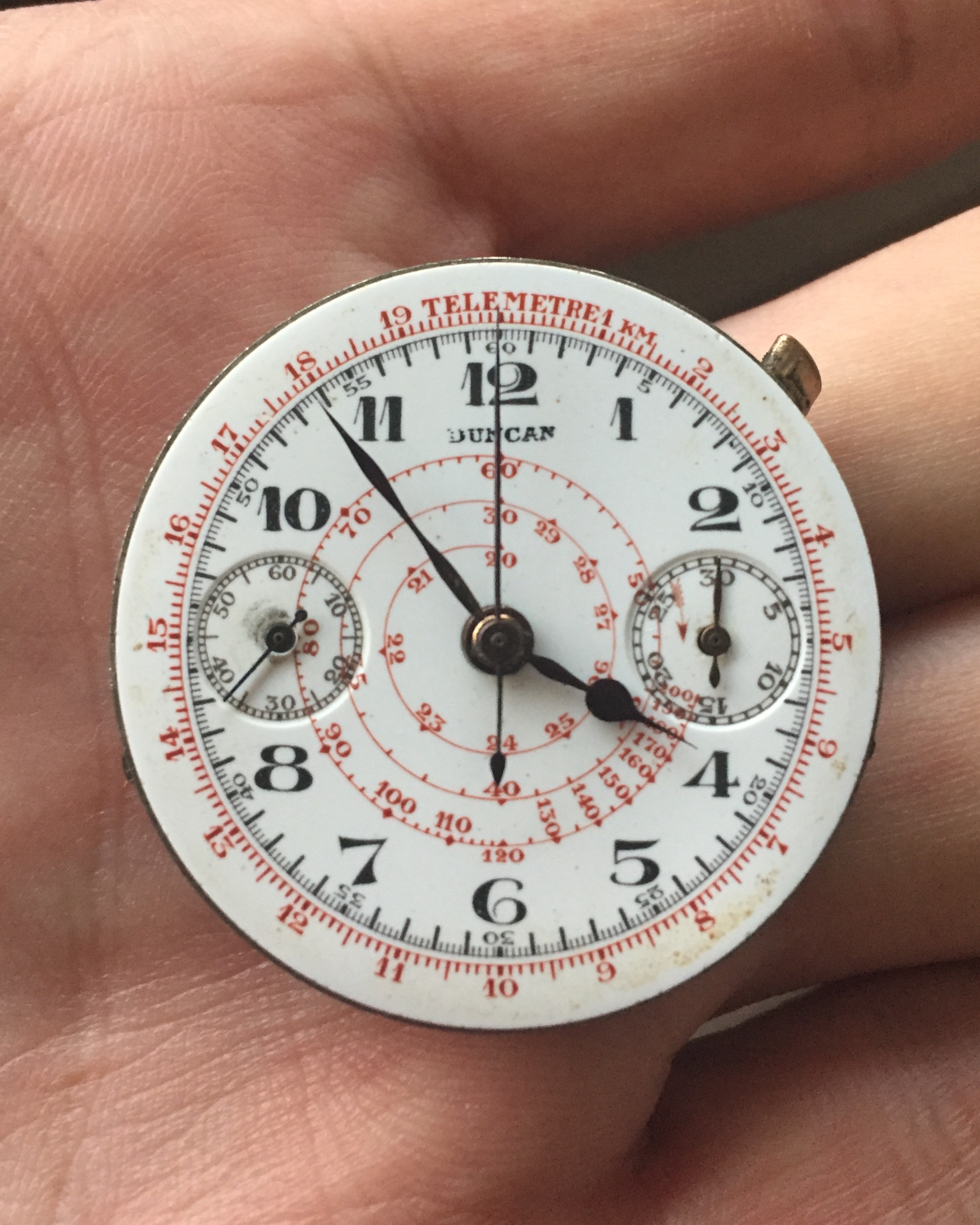

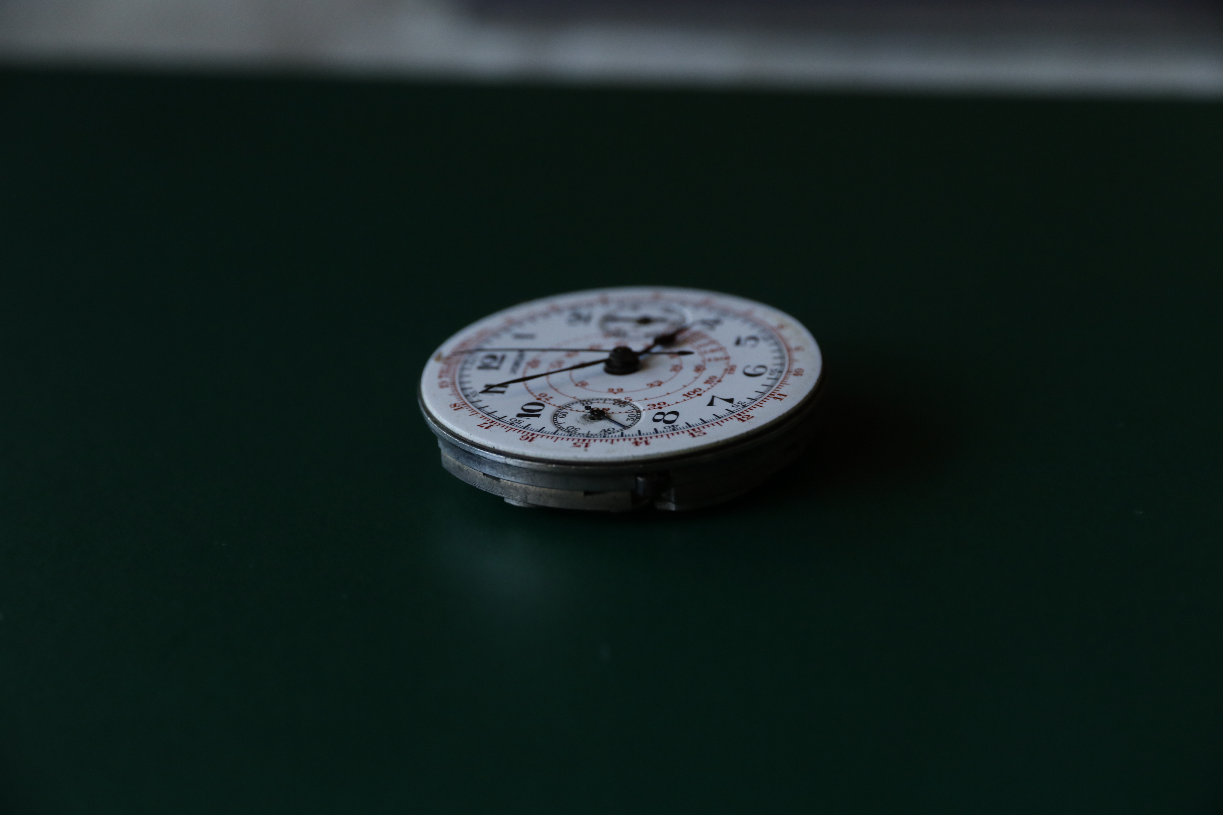

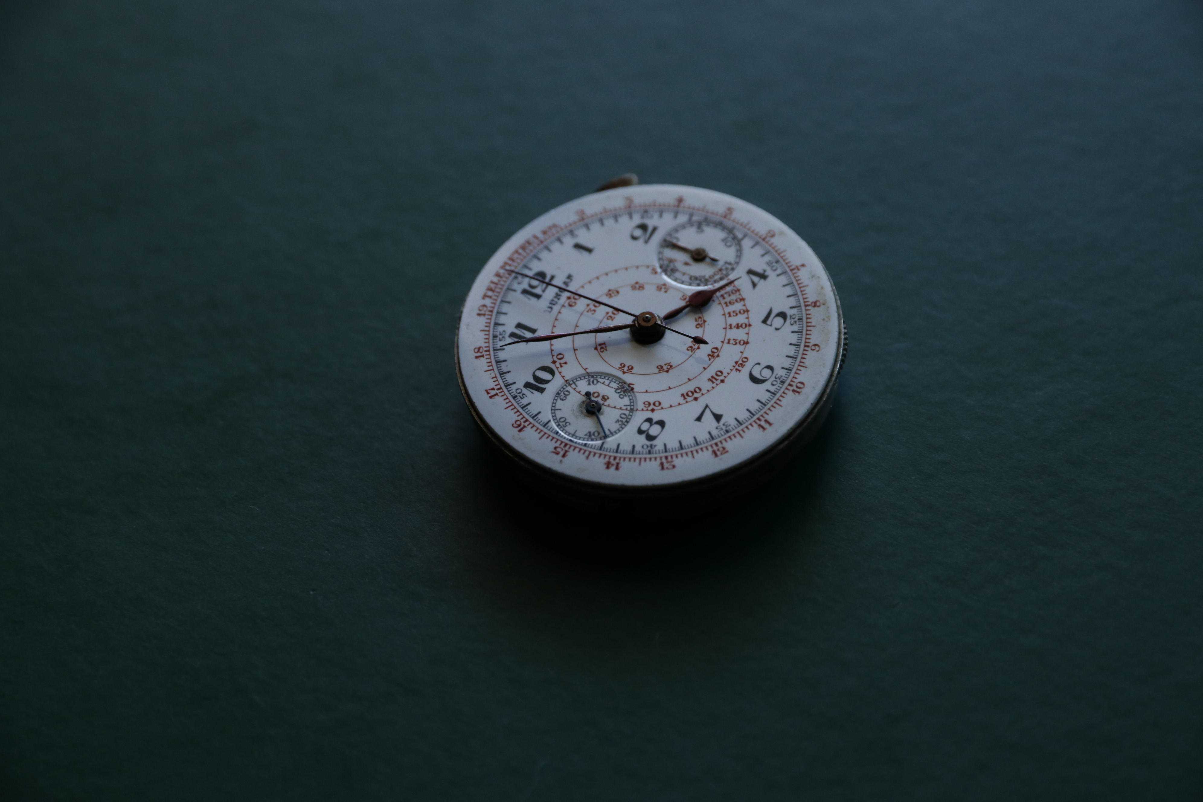

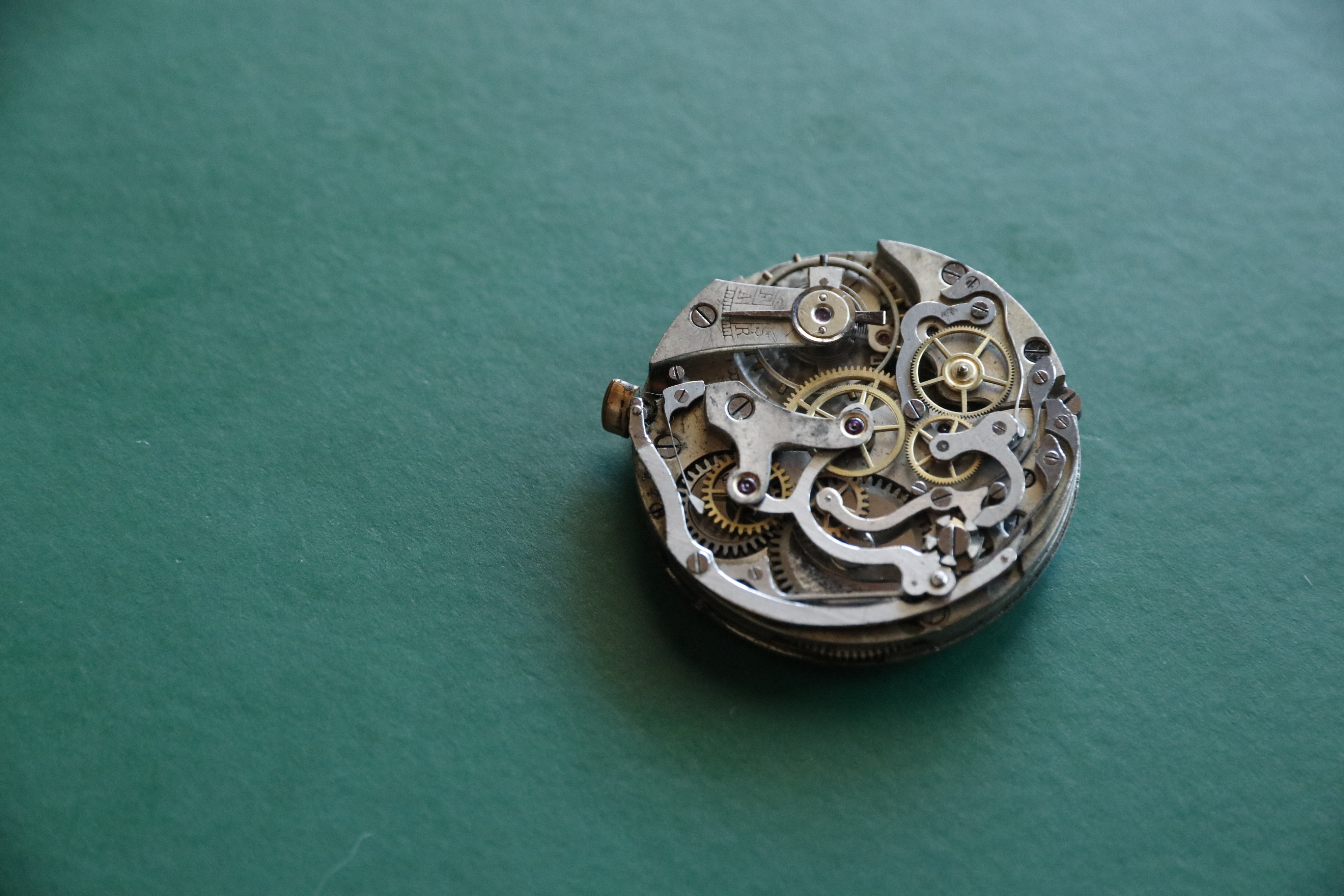

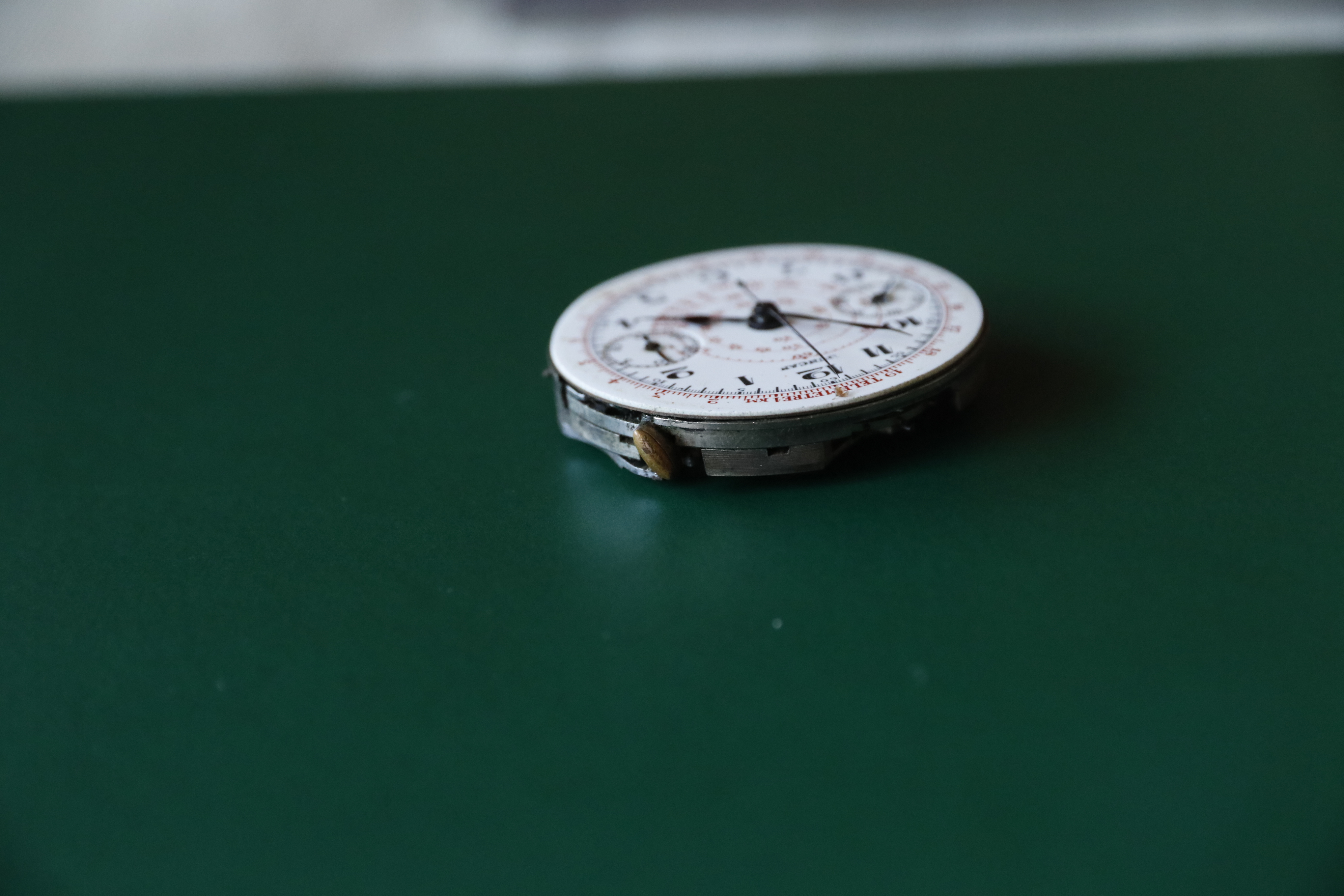

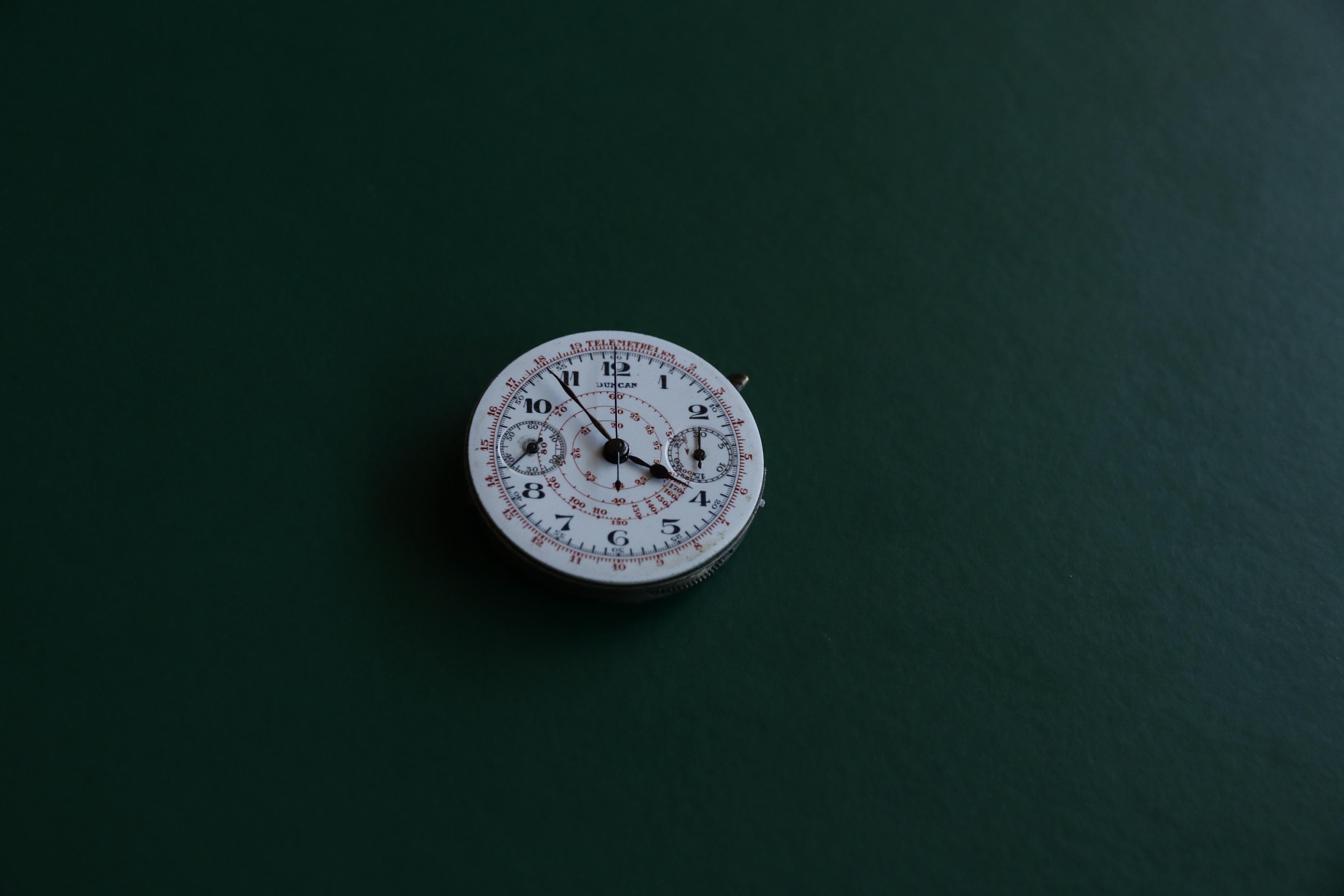

I just bought this mint movement with an amazing porcelain dial. I don't have much information about this brand DUNCAN neither about the caliber (the only inscription that has is R44) any idea about what manufacturer made this chronograph . Thanks a lot
8,884
62,943
Nice beginnings to a nice chronograph.
I'd guess mid to late 1930's from the dial.
A member will be along to ID the movement, I'd guess Landeron

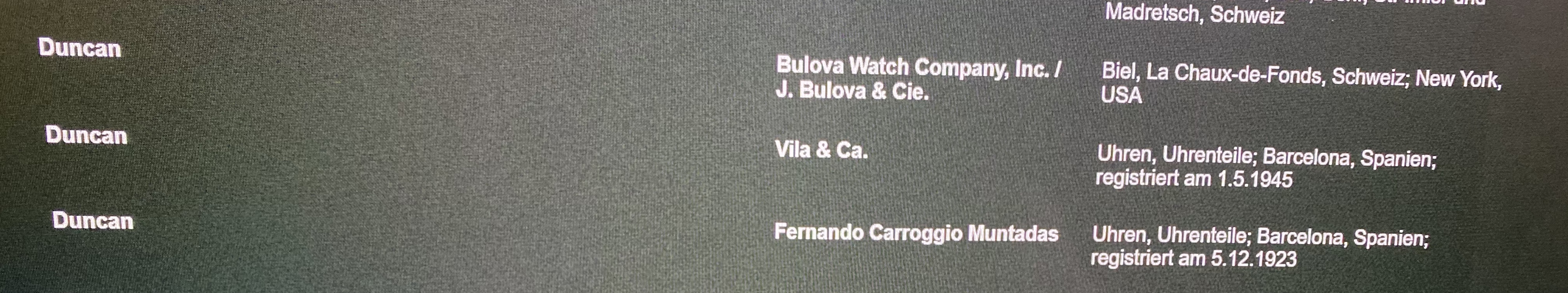

Manufacturer then Location
google is your friend

On behalf of the description police, this is not “mint”, as in fresh as the day it was born. Lovely piece, I look forward to seeing how it goes with finding a case, it’ll look great ☕

thanks for sharing information , from what I saw online is not a Landeron. I will keep searching unless someone here has deep knowledge and shares 😀

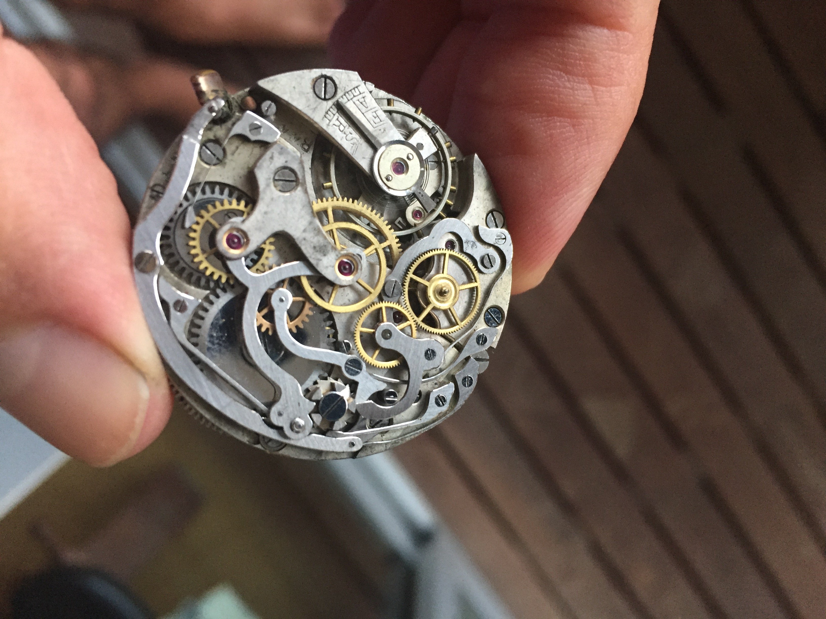

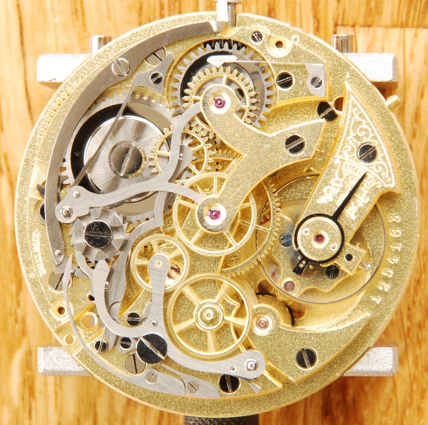

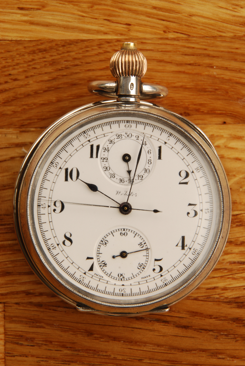

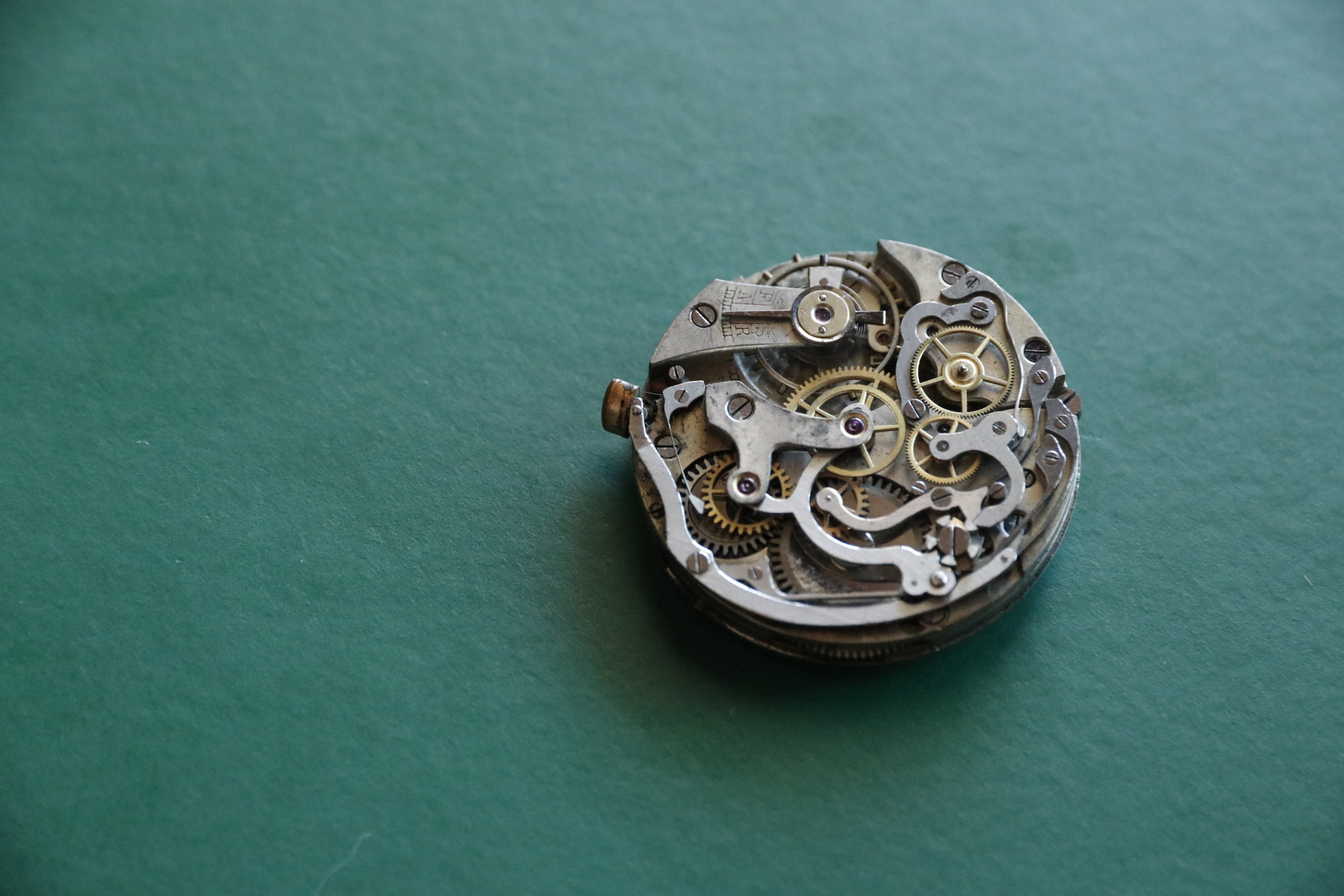

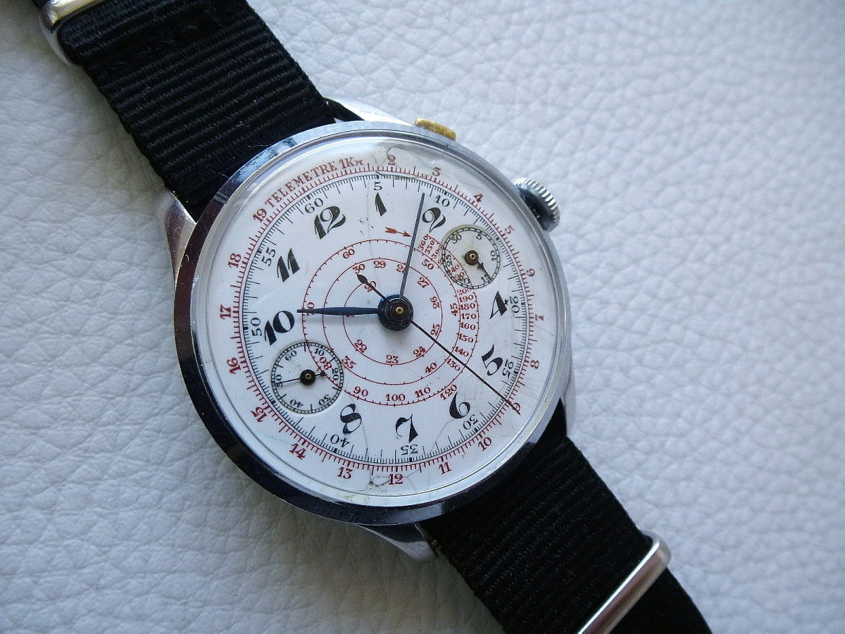

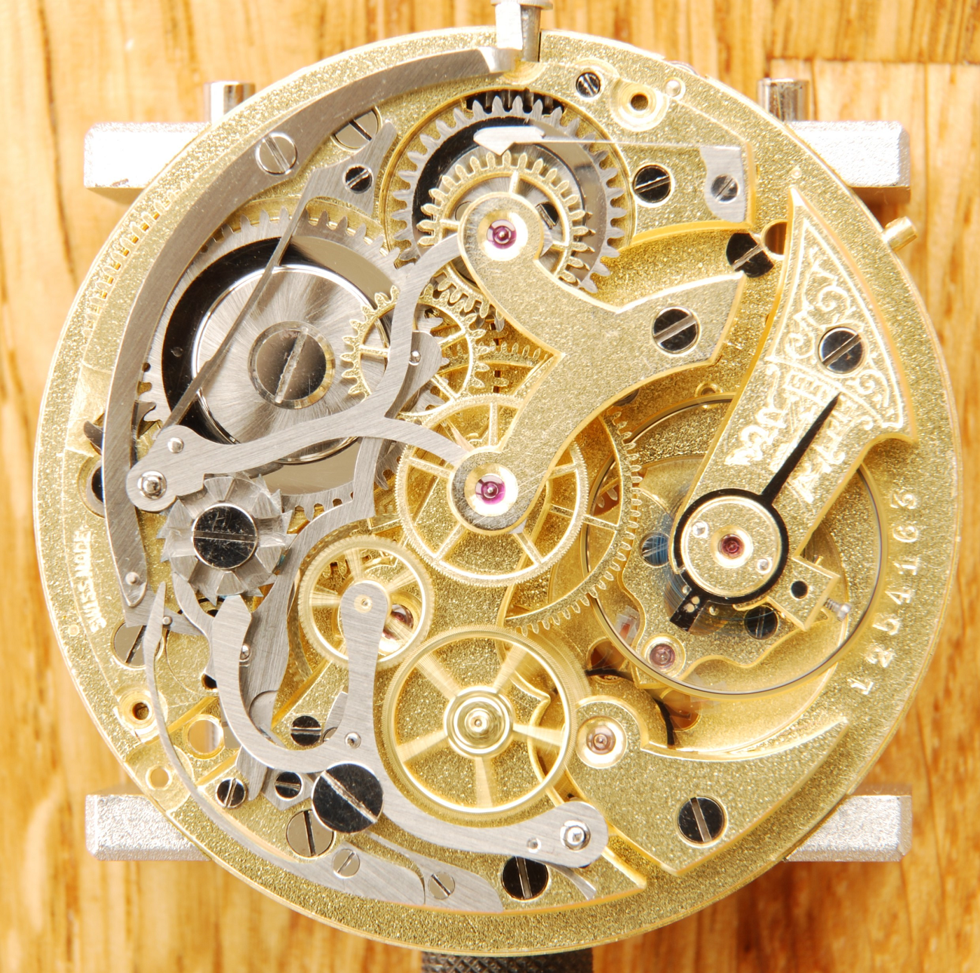

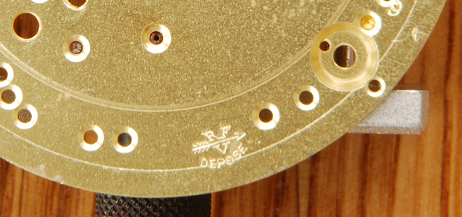

Could be a Minerva? It has some similarities to this 19-9CH I did a few years ago and this was from 1923. This is a mono-pusher pocket watch so a slightly different layout.

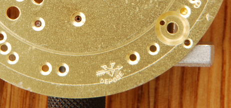

On the dial side, you would see this symbol:
Good luck, Chris
910
1,054
Thanks Chris but looking at both layouts I would say that is not the same.

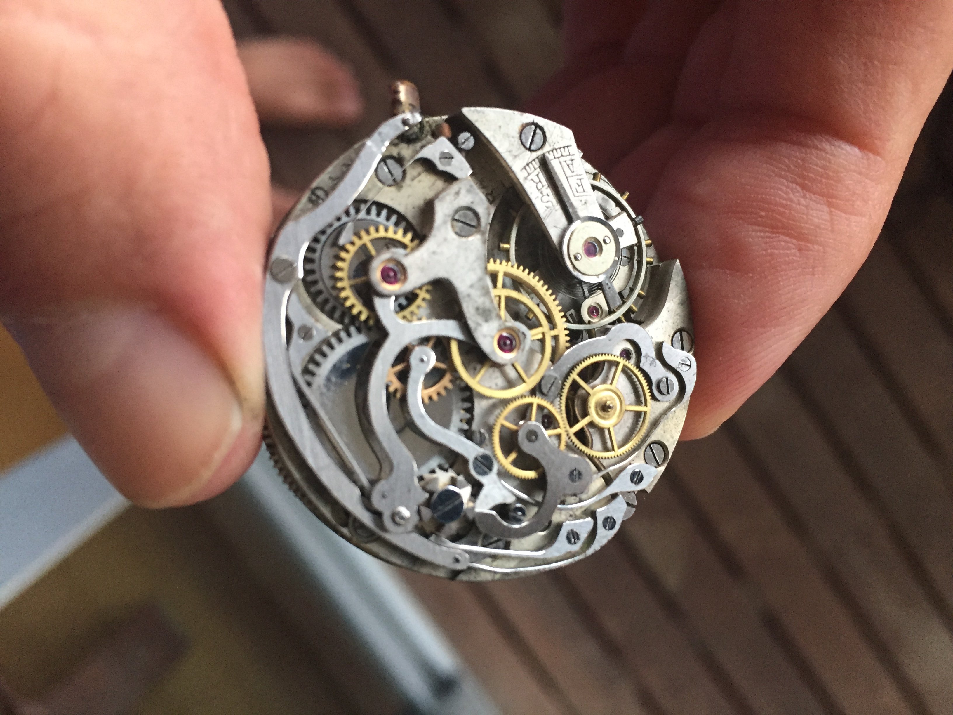

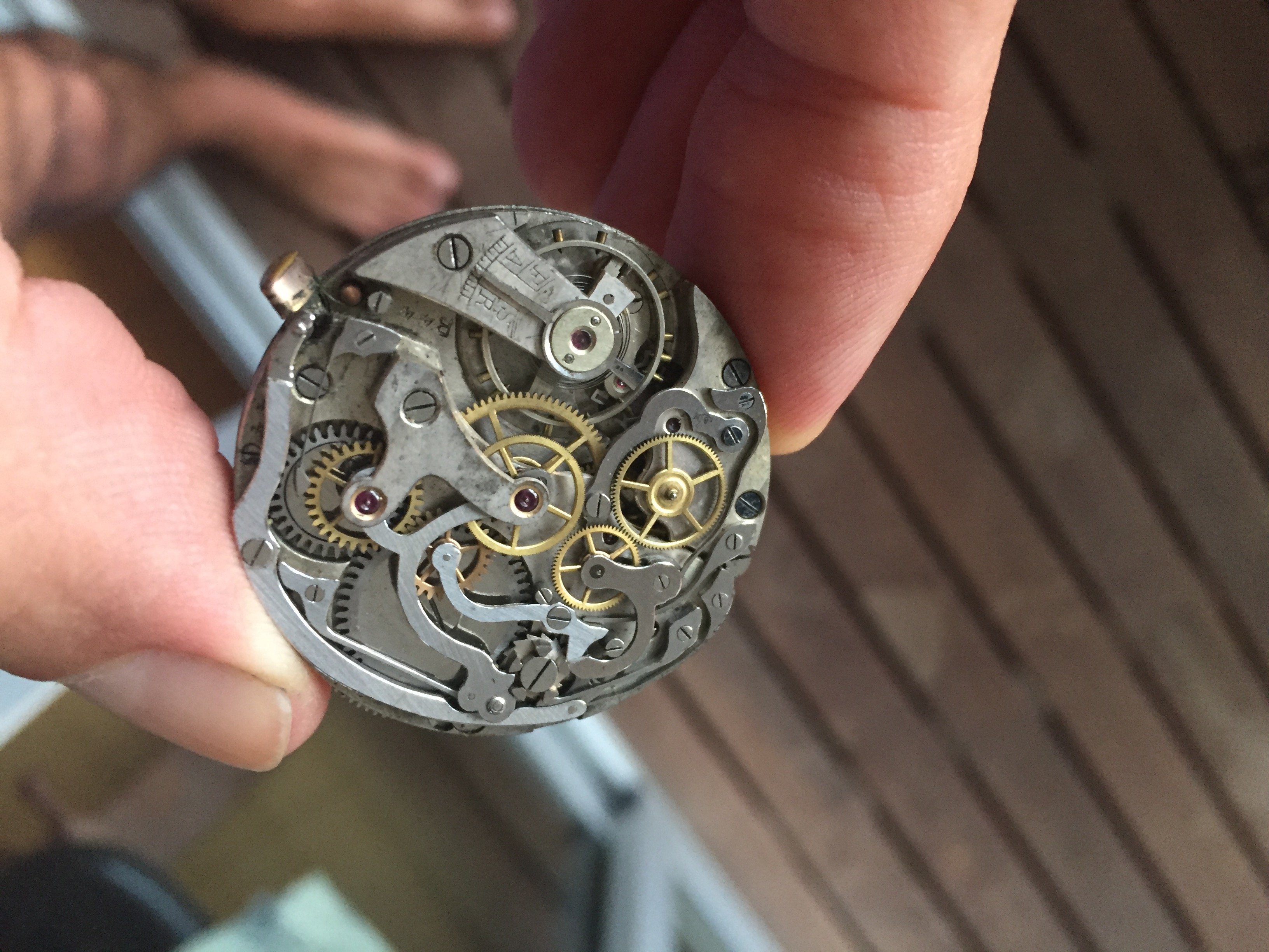

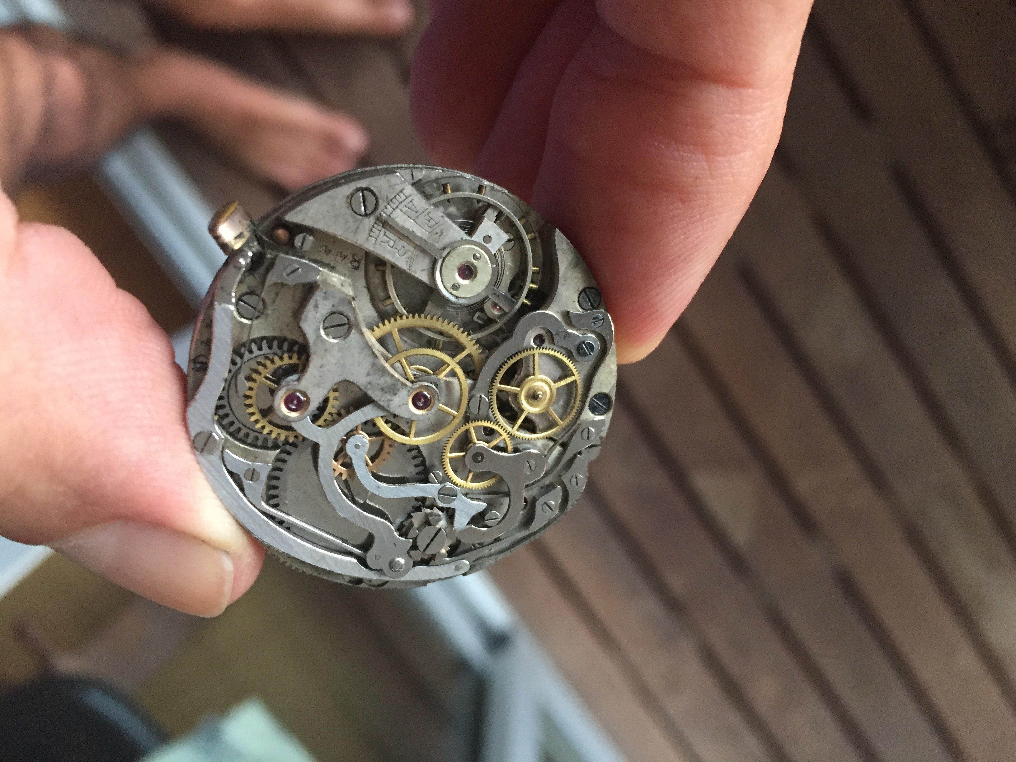

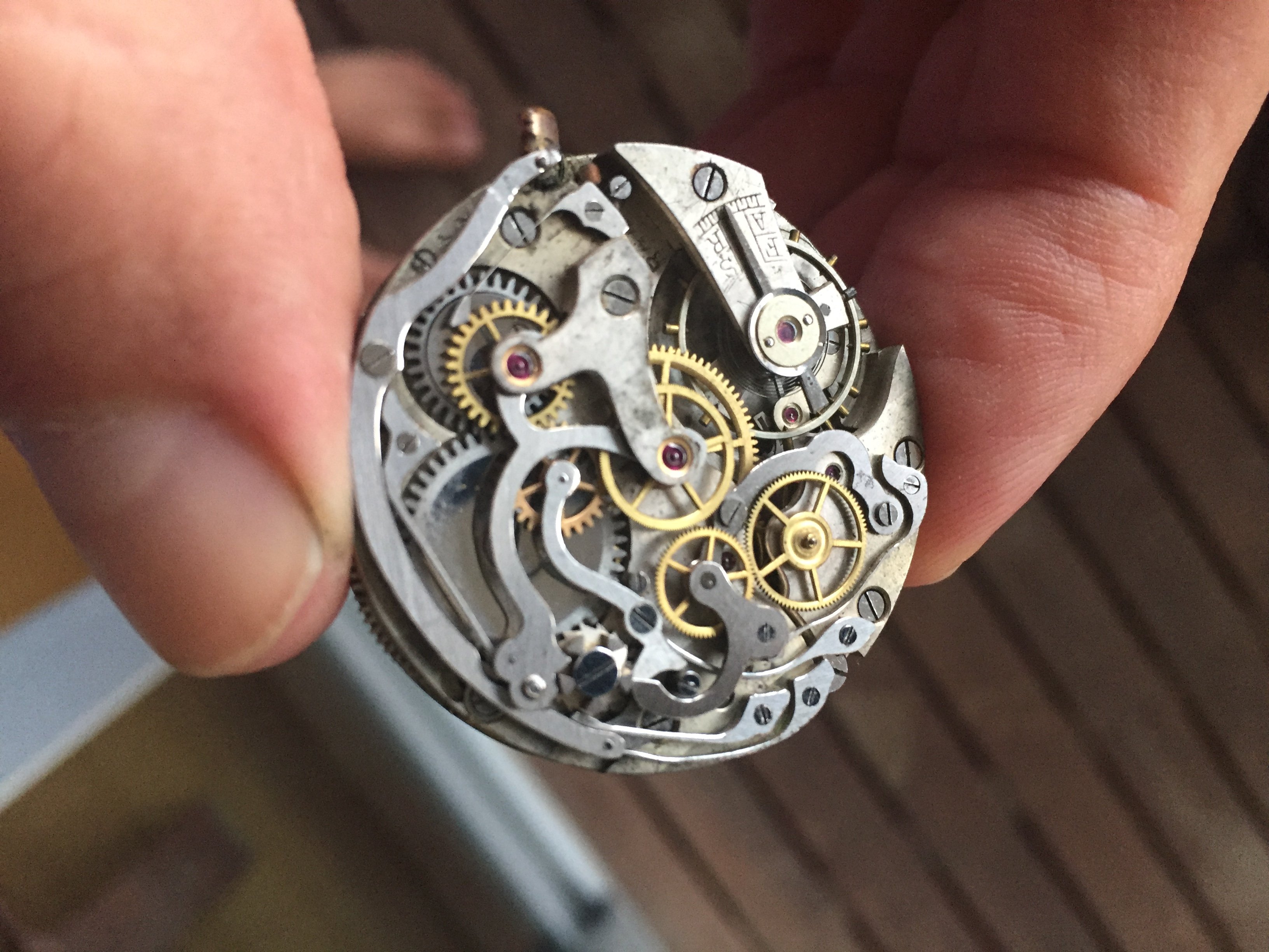

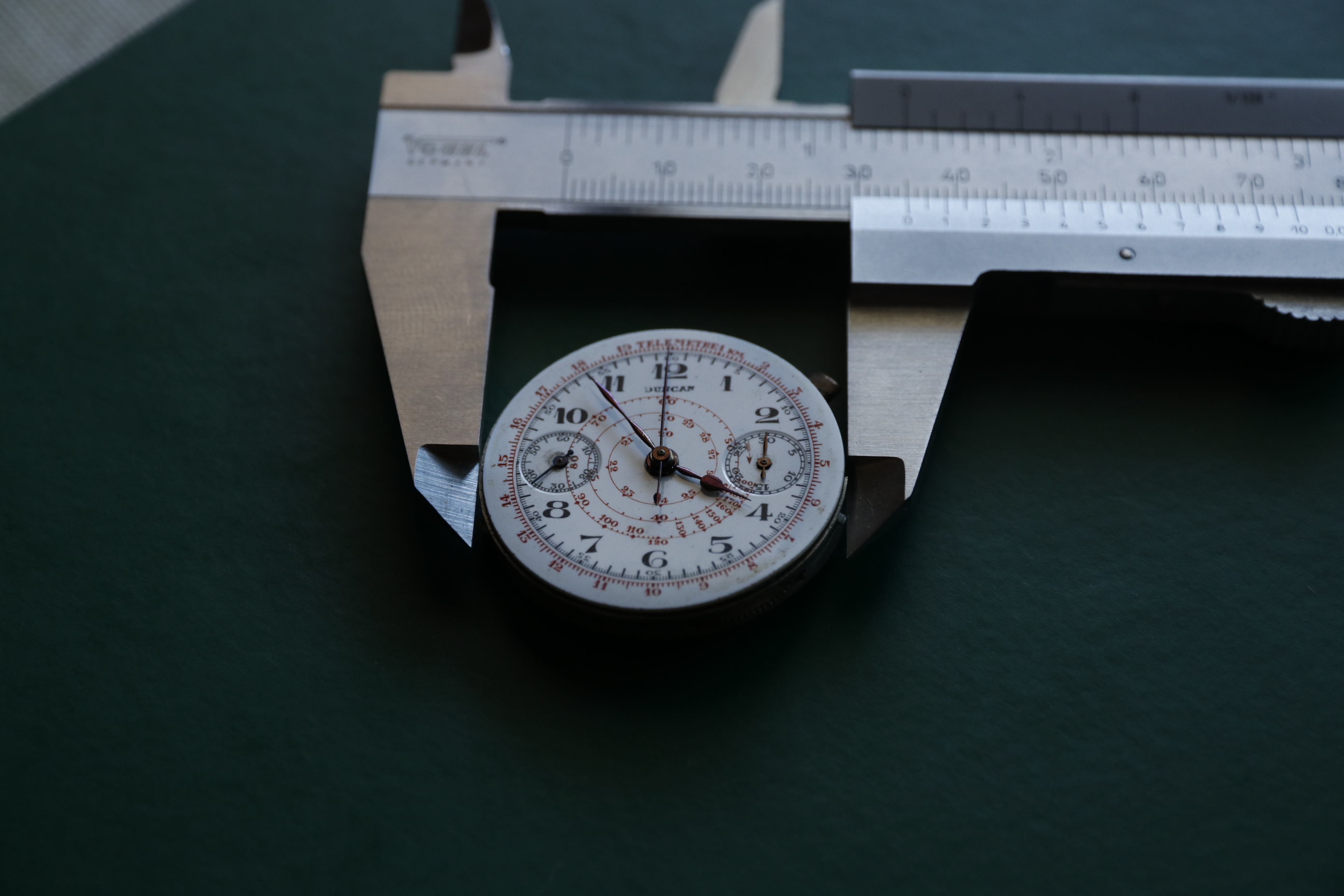

Do you have a picture of the dial side of the movement (keyless works) and what is the diameter in millimetres?
It looks to be a Valjoux of some sort to my eyes.
910
1,054
Yes, he noted that.

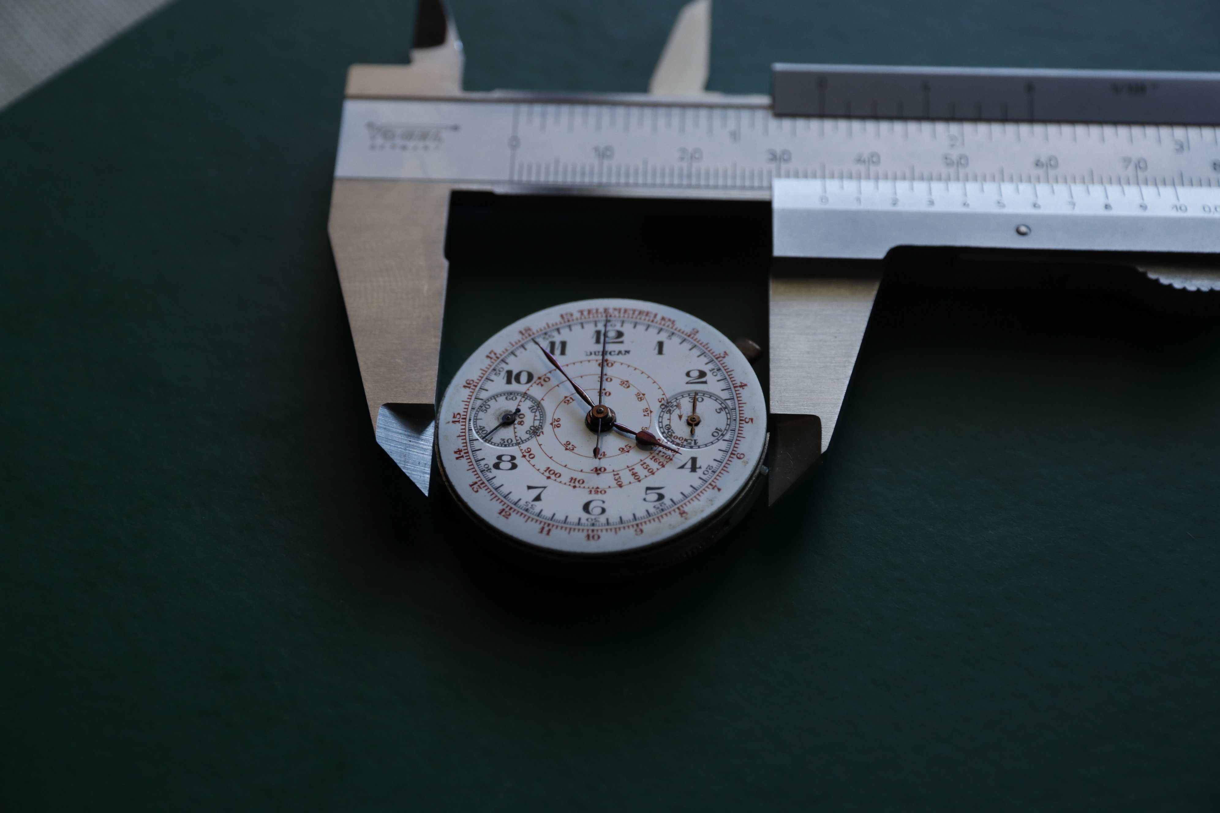

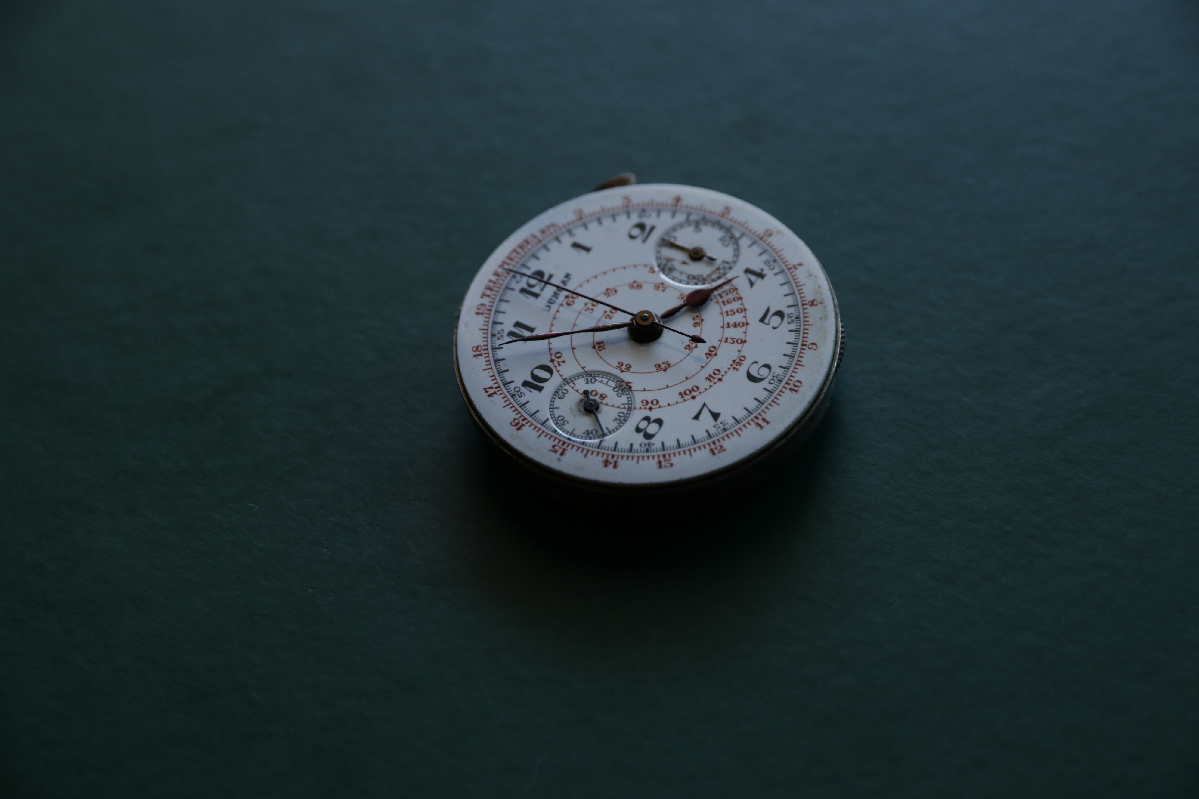

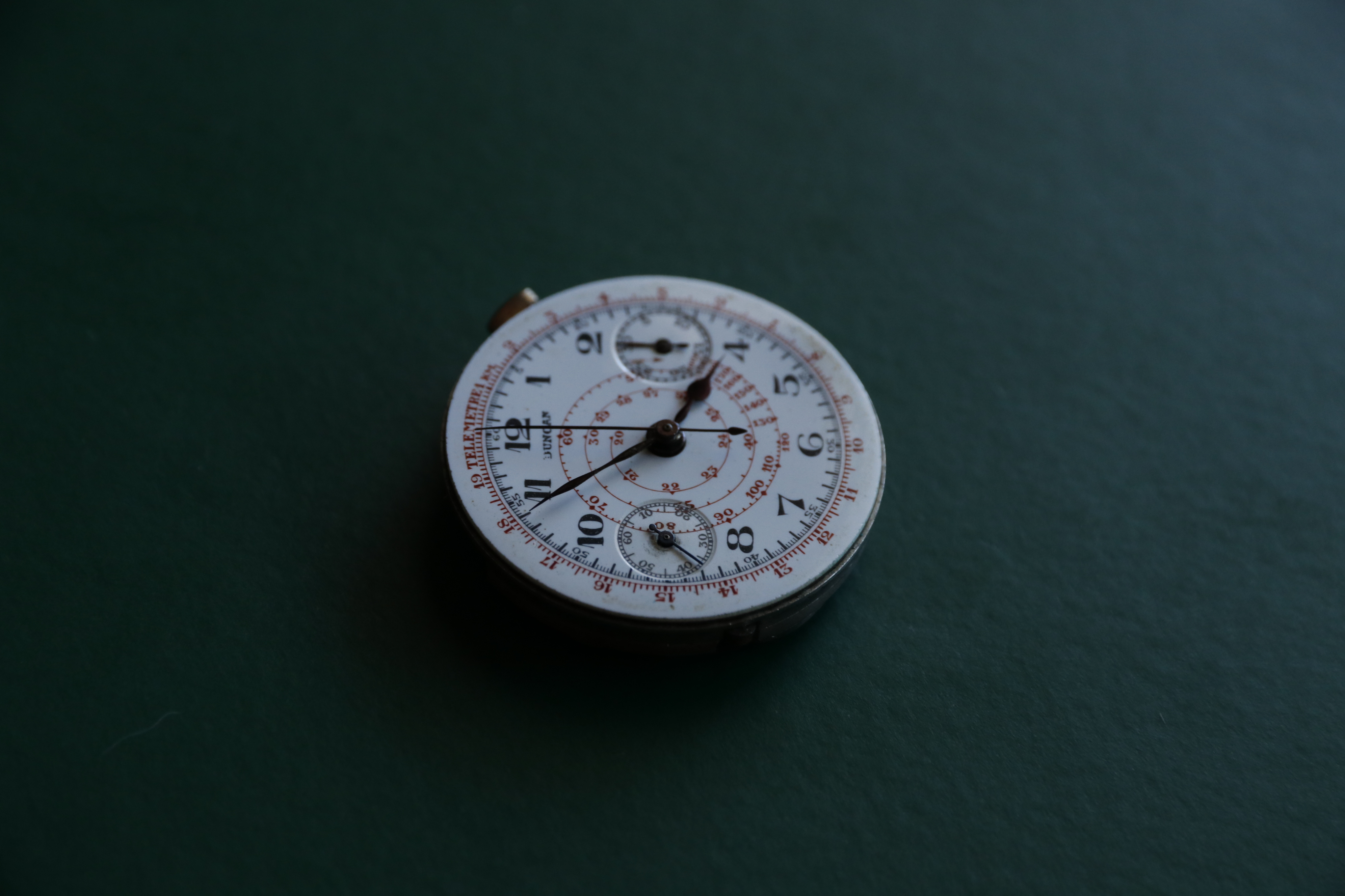

well the size of the dial is 35mm, in case will be a Valjoux which one ?

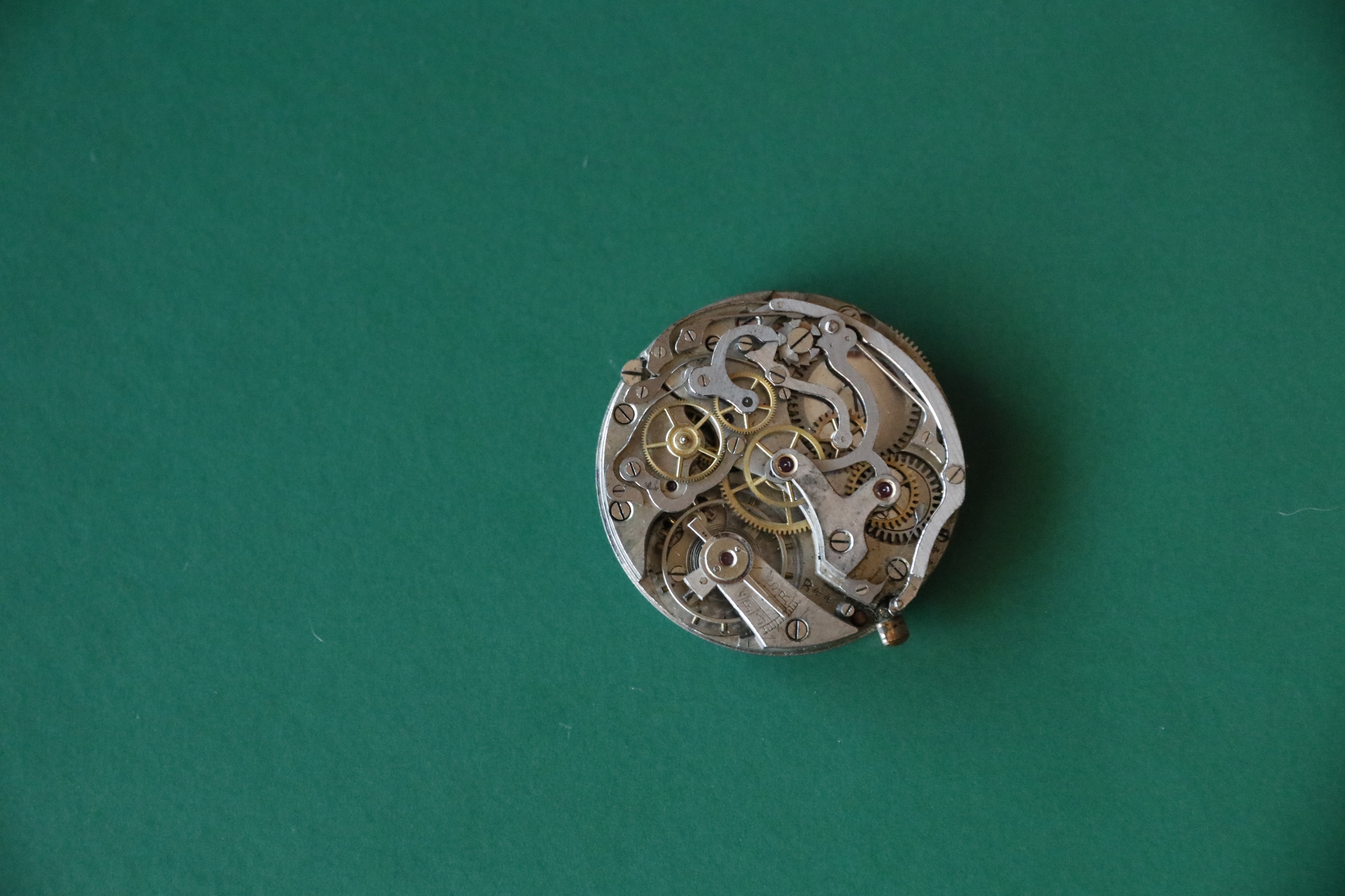

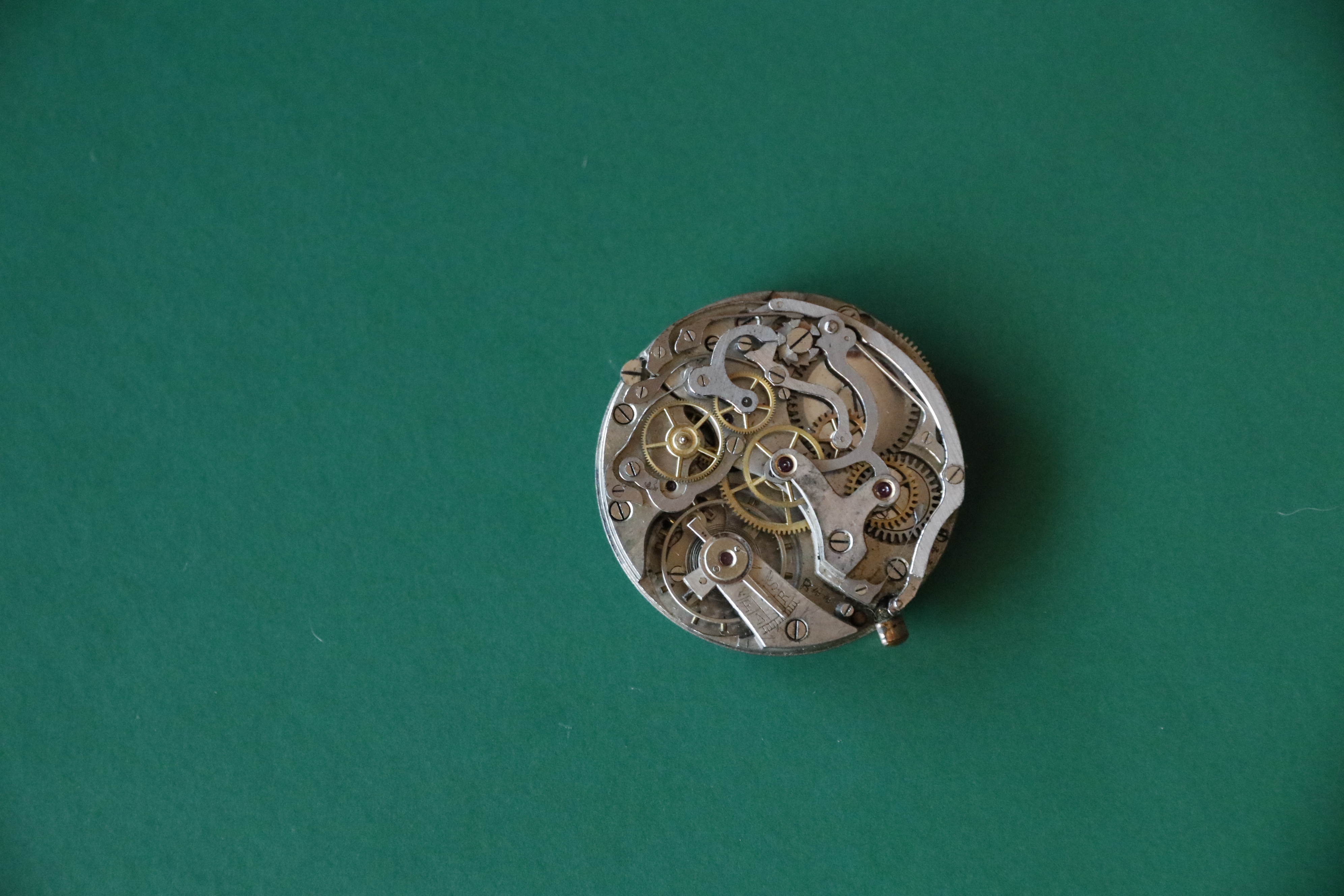

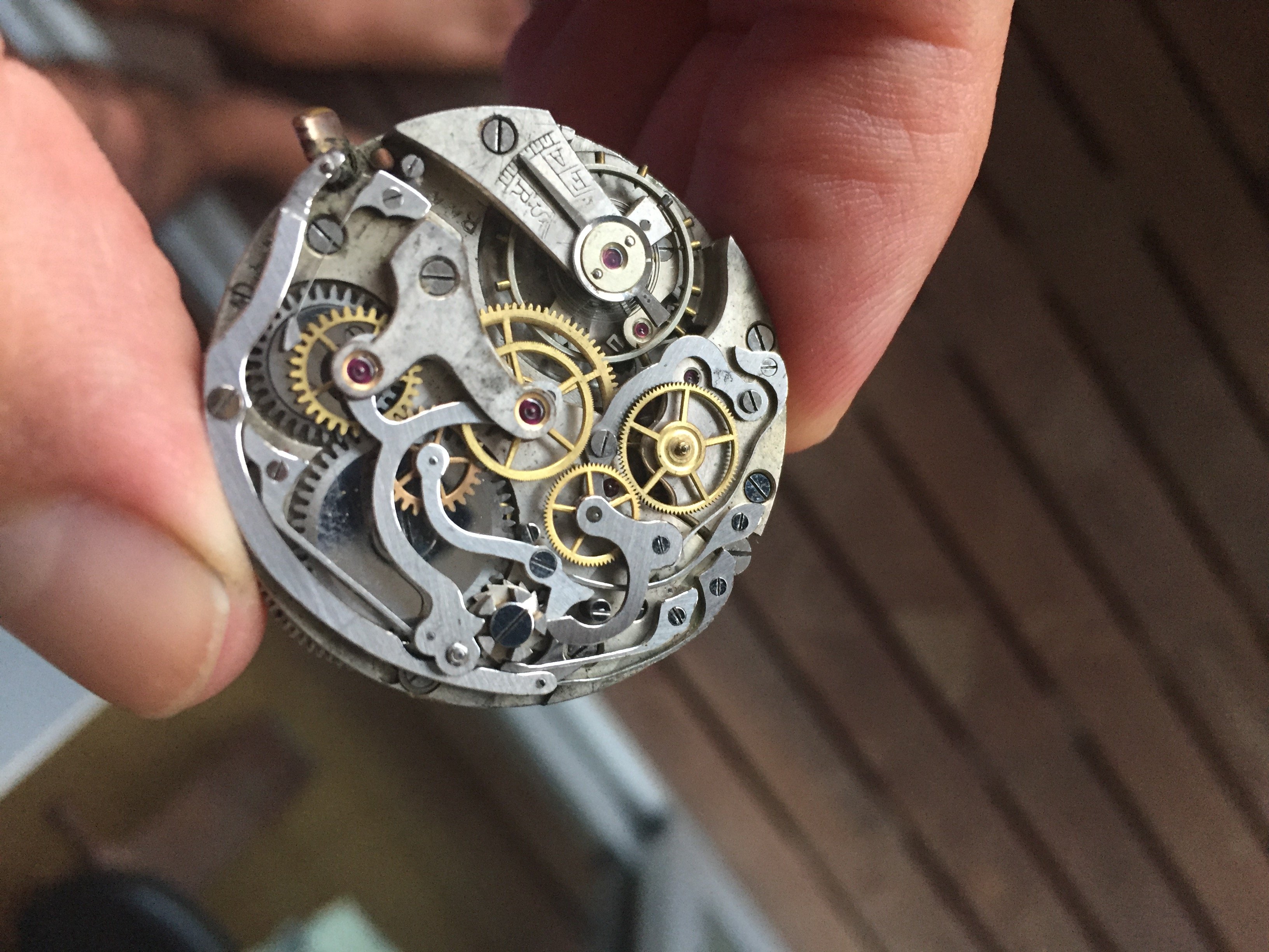

here are pictures of the side of the caliber. No key , it's a manual winding

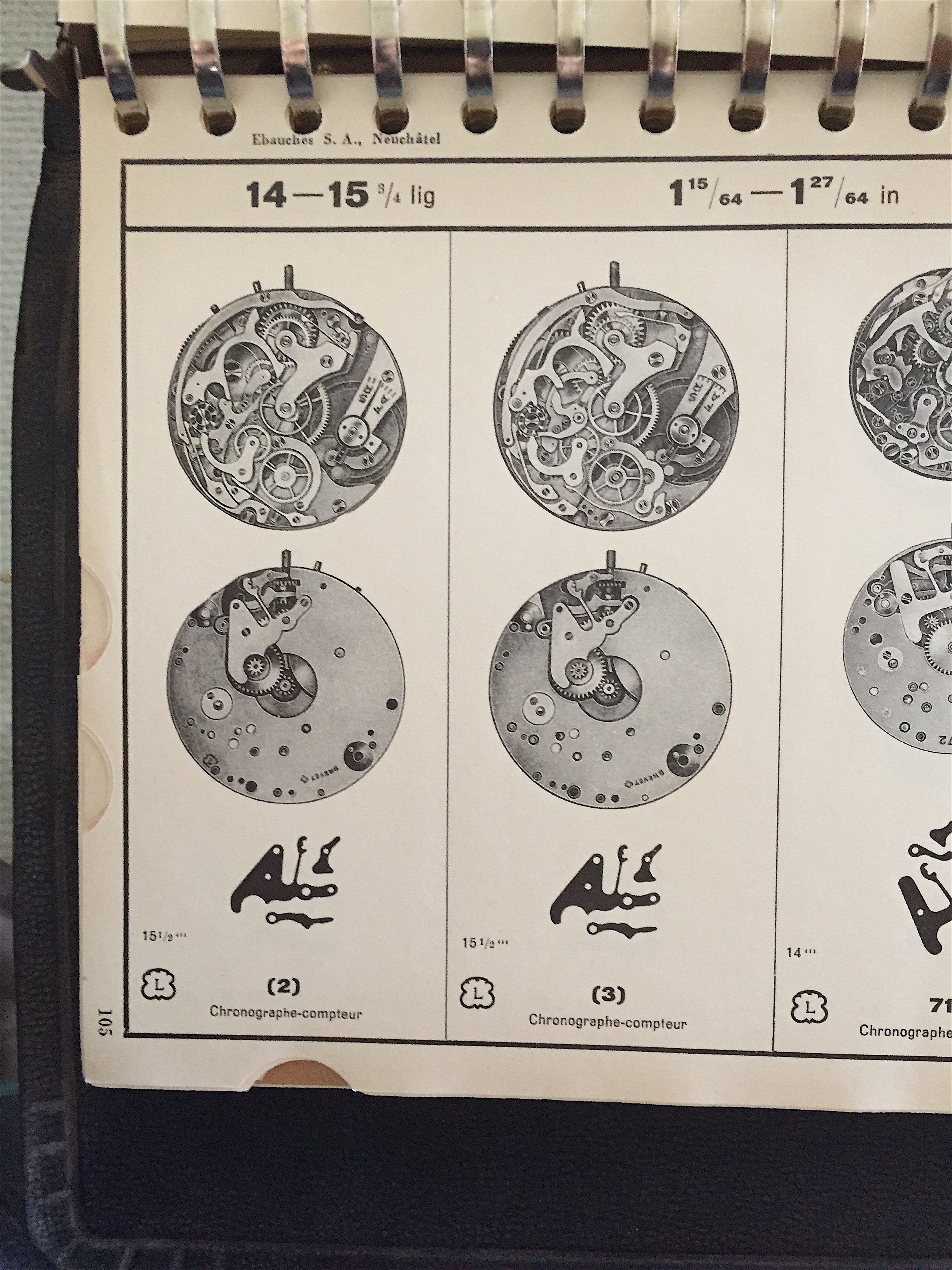

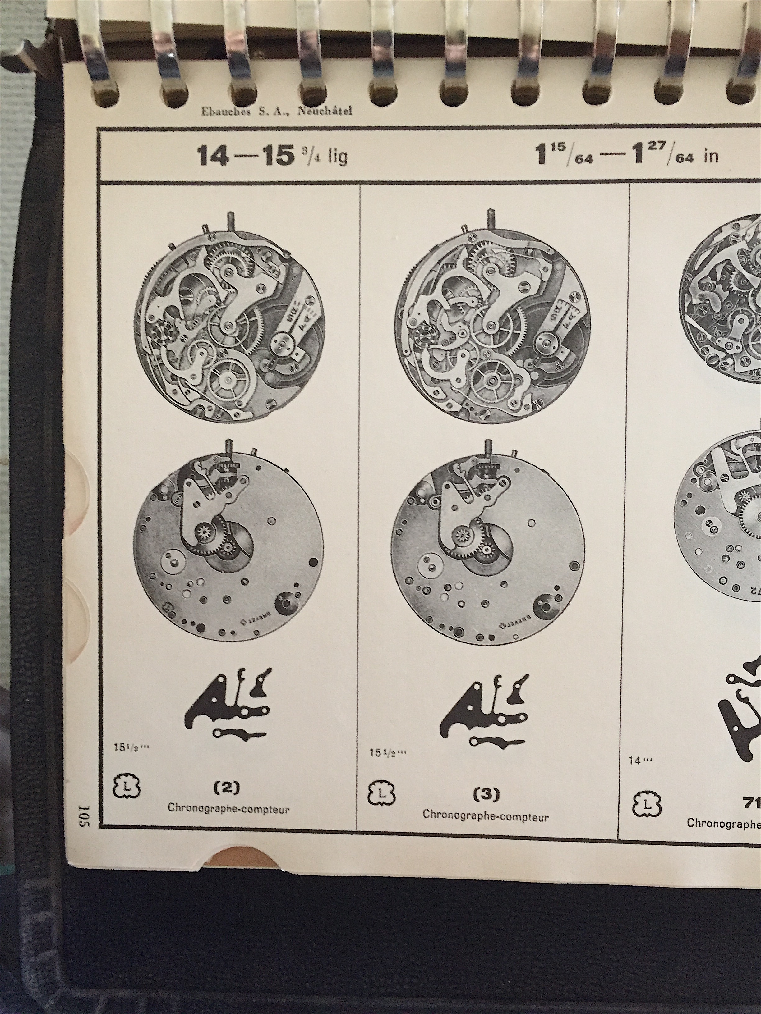

I think it's a Landeron-Hahn caliber (15.5''' possibly), but I haven't nailed it down yet.
I will search for that caliber and compare, thanks Dan

Landeron 15.5''' is getting close.
However, we need to see the movement with the dial off (as in the lower picture) so that the shape of the keyless works can be seen.
These are like the "fingerprints" of a watch movement.
The style of the layout is almost generic and was used by many makers. Valjoux, Landeron, De Praz etc.
wow, thanks a lot, there is nothing like an old book

do you mean under the dial?
The dial (front) side of the movement, showing the keyless works as @JimInOz mentioned. And it would be nice for you to explain your reasoning about the conclusion that it is not a Landeron-Hahn.
can you share any picture as example, I don't really get you, I thought that the pictures that I share were enough , thanks
24,838
55,263
Please read the post from @JimInOz, he already explained it very well. Please explain why you think it is not a Landeron-Hahn.

I just compare the images and does not seem the same
can you share the link of JiminOz please
