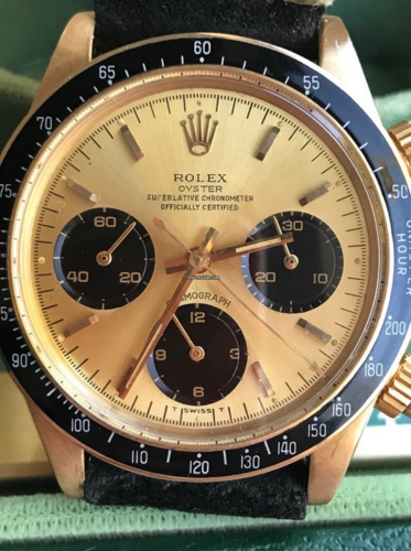

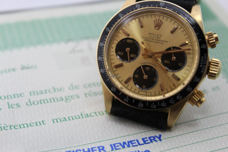

Do not like the dial on watch n1. Does not look correct, not even for a service dial.
Hard to say on watch n2 without better pictures or seeing it in person.

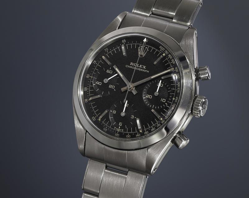

What is an exotic 6238?
These things. Actually you're right, they're not exotic. Just rare and fu****ng expensive 馃榿

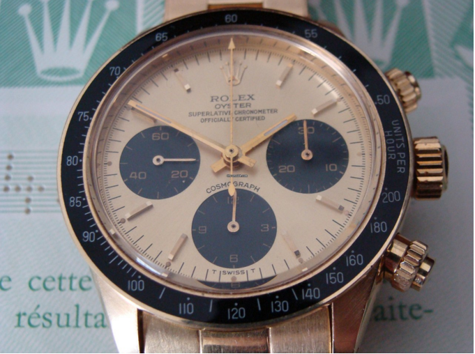

watch n1 is Fake. this is a poorly made fake dial. there are much much higher quality fakes out there. be careful.
look at the subdials. very telling. print is very poor and uneven. the 6 o'clock subdial's "3" isnt even fully printed on the register. you think Rolex would ever let a dial leave the factory like that? No. The coronet is also all wrong. Ive never seen a Rolex coronet like that. the bezel is fake as well. hands look fake also but difficult to tell from just pictures.
the second one looks better but the forgers have gotten so good and im not knowledgable enough on these to say definitively. i can say definitively that the 1st watch is fake. 馃榾
the dial below is fake. there are very very high quality fake vintage Daytonas out there. mostly from Vietnam. theyll even refinish (bevels and all) the parts in a V72 to make it look like a Rolex movement and convert it so it has the same beat rate as a 726 or 727. slap real bezels, pushers, hands, crowns, and in some cases real dials, on a fake case with a fake (but real V72) movement. all for ~$5-10k and sell it to some sucker for $50k+.
