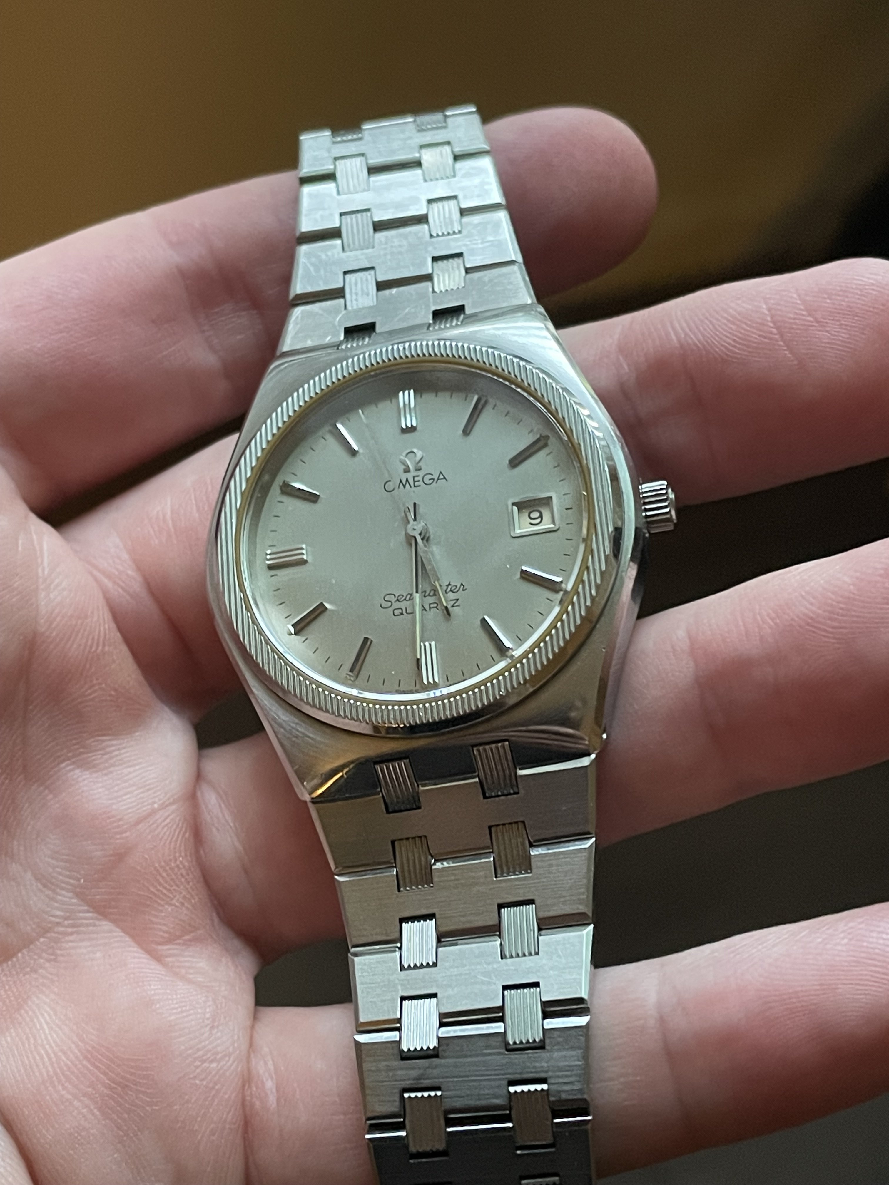

This ref. 196.0134 / 396.0873 with a cal. 1342 arrived today ticking away just fine.
When I went to set the time, and yes I’m aware that pushing in on the crown progresses the second hand, after a few turns of the hour hand to get to the right date I pressed the crown to the in position and the noticed an issue. The seconds hand no longer progresses forward, it goes forward half a second and then back to that same position. Easiest way to describe it is it’s only going back and forth, not progressing the minute hand at all.
Is there something I did wrong or does anyone know an at home fix for this? I can definitely take it to the local Omega watchmaker but thought I’d as you all.
I did open up the case back, it’s a press-in, but only to check the condition and get the serial number then closed it back up. It couldn’t have been open more than a minute and the movement was under a dust cover the whole time so I’d be surprised if that did it. Did I do something wrong?
Any help would be greatly appreciated. Thanks!

Usually this is a low battery signal. Probably time for a new battery. Opening the case probably jigged the battery enough that it shifted the contact point.
18,851
39,205
Setting the seconds/minute hands on these watches uses a fair bit of battery power. If the battery was low to start with, you may have used up any useful juice.
Just fit a new battery and see how it goes.
If it's still flickering, get a watchmaker to run it on a line release machine to free up the gear train.
If that doesn't fix it, get it to a competent watchmaker.
Haha I’ll be sure not to leave it on the bookcase next time. Appreciate the quick reply! I’ll try a new batter and report back!
Thanks @JimInOz for the quick response! And thanks for the link to the batteries, really appreciate it!
