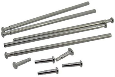

Hey guys,
while I was, out the pin of my 1039 clasp came loose and got lost.
Where do I find a replacement? Or do watchmakers generally have stuff like this in stock?
Thanks!

Watchmaker will sort it out easily for you

@Majork - nothing to worry about. You've got your Speedy, and you've got both halves of the bracelet, and these are the important parts. The beauty of a mechanical watch is that when something breaks, you simply fix the broken mechanical part, and everything will be back to 100%.
@rogart is on the right track, and this is likely what you will use to repair your clasp.
I own several 1039 bracelets, and, the clasp pin you are referring to fits differently in each of them - one is a little looser; others are a little tighter. When you're getting down to the level of these parts 50 years ago, I don't think you had "factory original" spring bars, pressure bars, etc manufactured by Omega per se; rather, they sourced them from various suppliers, such as what @rogart is suggesting above. You can expect that a watchmaker who specializes in vintage watches will easily be able to fix this for you (feel free to ask on here for recommendations - you'll find many strong references).

Bottom line - your issue and the required repair is about as minor as it gets. You'll have a better, and more reliable bracelet that will serve you well for years to come when you are done. Enjoy, and good luck!!
