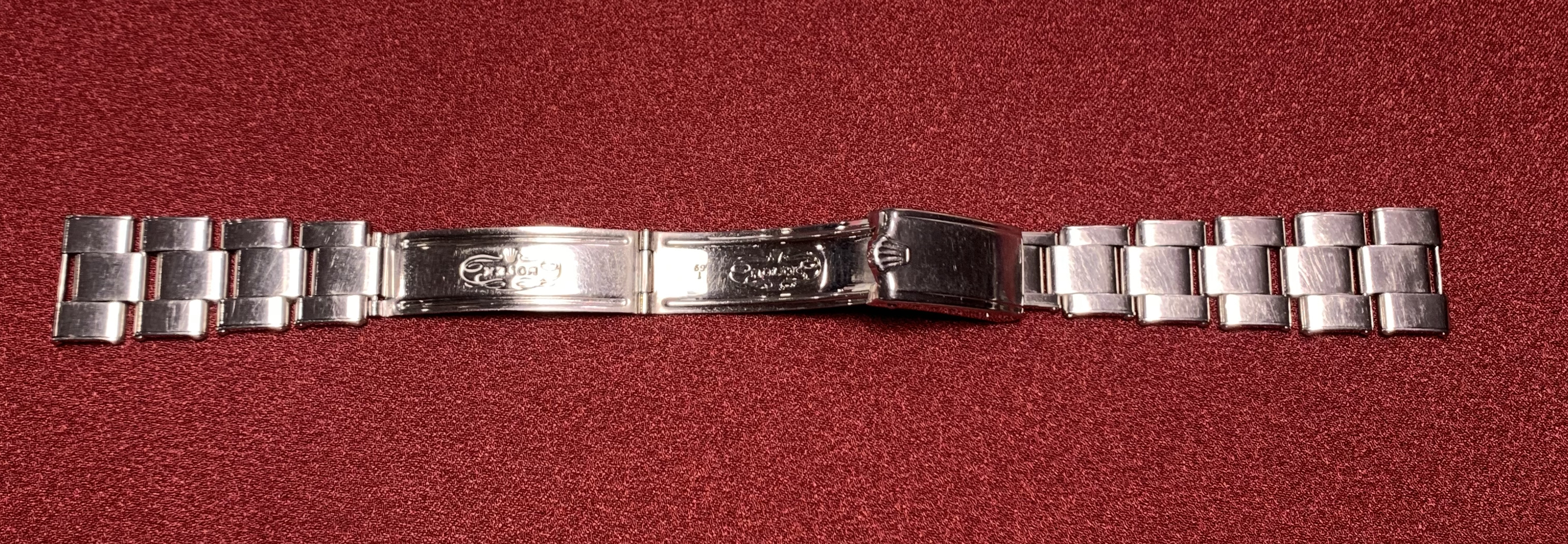

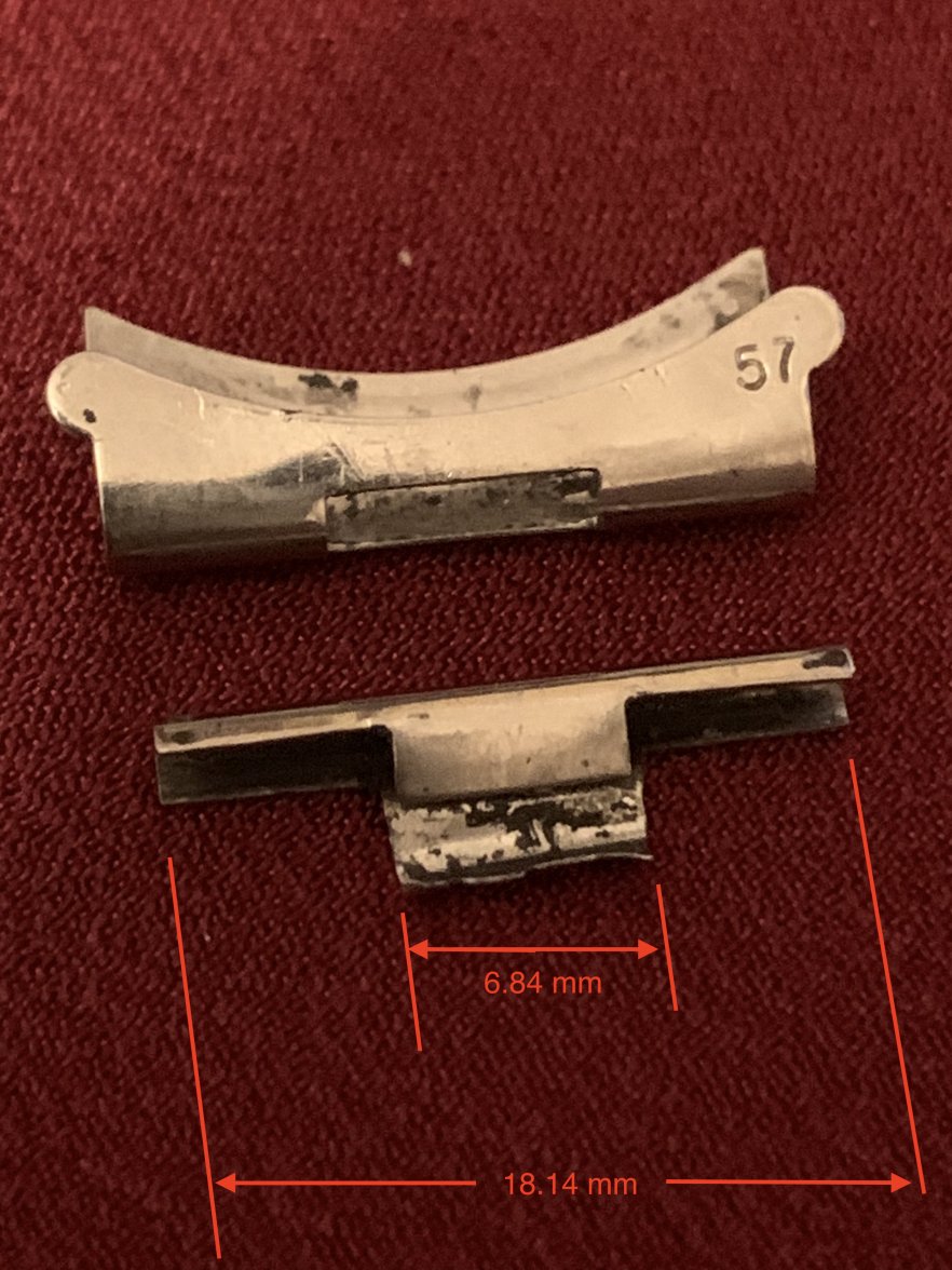

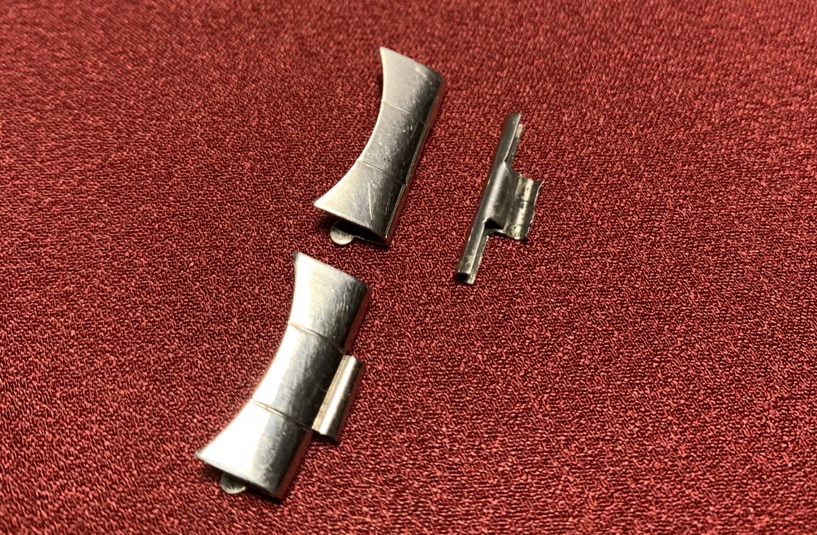

I was wondering if anyone could help me with getting this bracelet fixed. I know when it comes to Rolex that getting parts is not easy so was just wondering what my options are?
I'm trying to help out my father in-law fix his 1968 Rolex Oyster Perpetual Air King Date bracelet.
Below I have added some pictures of the end links and the broken parts that need replacing, they have worn through. Not sure what they are called.
Any help wold be appreciated.

I would suggest having the whole bracelet restored, since it is looking pretty stretched out. Your options include Rolliworks in California and Classicwatchrepair in Hong Kong. Those connector pieces will be fabricated if necessary.
24,800
55,082
I've had two bracelets restored by Rolliworks, both rivet bracelets. One was a Swiss 7206 and the other a US-made C&I. Based on the end-links, yours appears to be a C&I. I would use them again. Michael Hui does good work and he is excellent with his communications. He also restored a case for me.
Michael Young in HK also gets very good reviews and has been restoring bracelets (as well as other restoration) for a long time. It's possible that MY may be a little cheaper, but the shipping costs may eat up some of the savings.
You might also want to ask both of them about their current lead-time.

They made bracelets for Rolex, but I could be wrong, it could be a Swiss bracelet. Can you show a better photo of the engraving on the clasp? Any numbers on the clasp or on the back of the bracelet links? I don't mean the end-links, you already showed the 57.
24,800
55,082
OK, sorry, I should have done more research. This is likely a 7205 Swiss bracelet with 57 end-links. You will probably see 7205 somewhere. There may also be a date code on the clasp.

I am having a 7205 19mm rivet and a 7835 folded oyster restored at rolliworks and the cost is $450 each and the lead time is currently 4 weeks on mine.

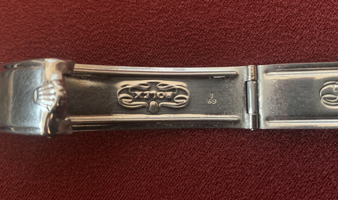

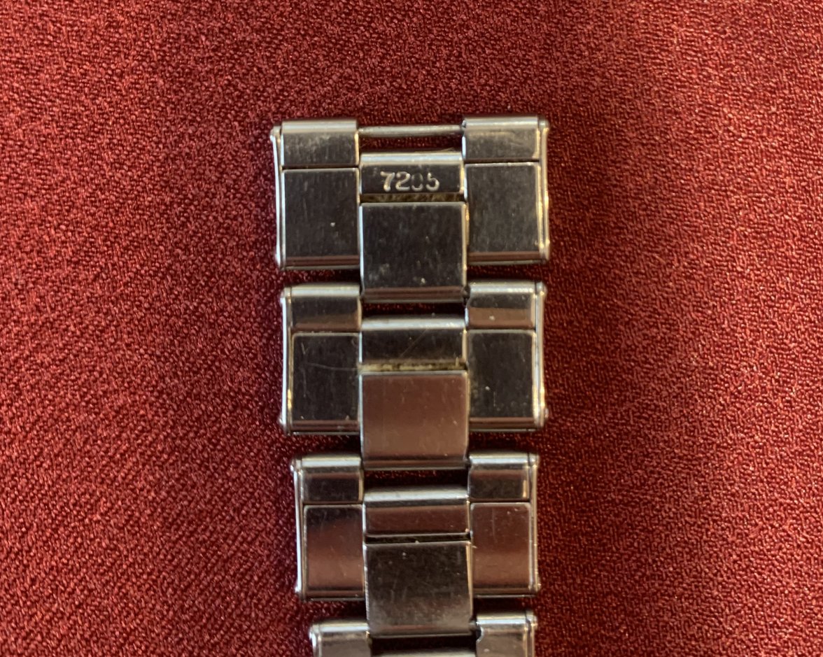

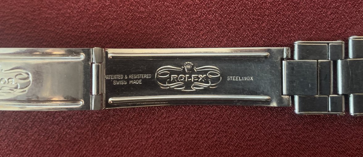

Here are few pictures of the markings I found on the bracelet.
So do the numbers 1, 69 mean it was made January 1969?

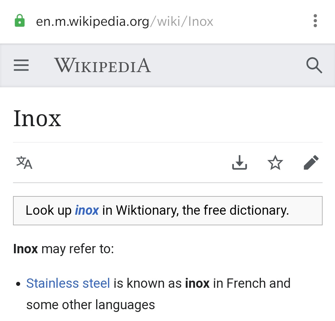

Was this bracelet made out of Nickel or steel?
Is that what Steelinox means?
So from these better pictures can you guys confirm this to be a 7205 with 57 end links?

Was this bracelet made out of Nickel? As well what does Steelinox mean?

Yes, January 1969. STEEL INOX is just a way of saying stainless steel. INOX is short for "inoxydable". Yes, appears to be a 7205 with 57 end links. 7205 should be on the back of the final regular link, not the end-link.

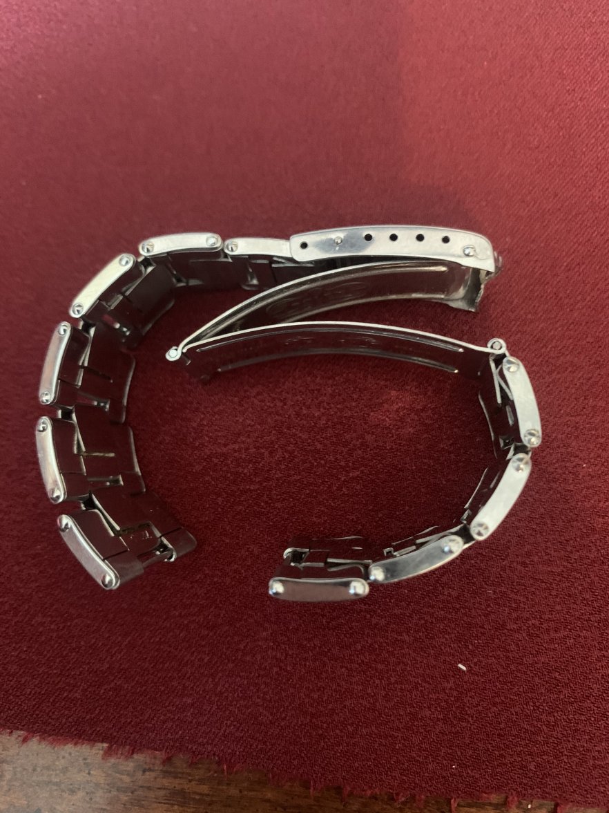

134
133
Similar issue for me here, I have a c&i rivet bracelet where the endlink connector bent and snapped completely. Looking to send to Rolliworks, but also really like the unpolished look. My Tudor is ex-navy so I feel like the scratches tell a story somehow. Hoping they can make make new tight connectors while preserving the dents and scratches.
