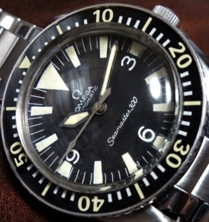

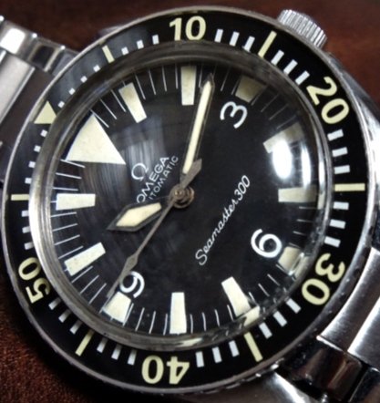

Help needed: Seamaster 300(cal. 552) - is this a redial
457
152
Please help. Is this a legit dial? The triangle at 12 looks weird to me.

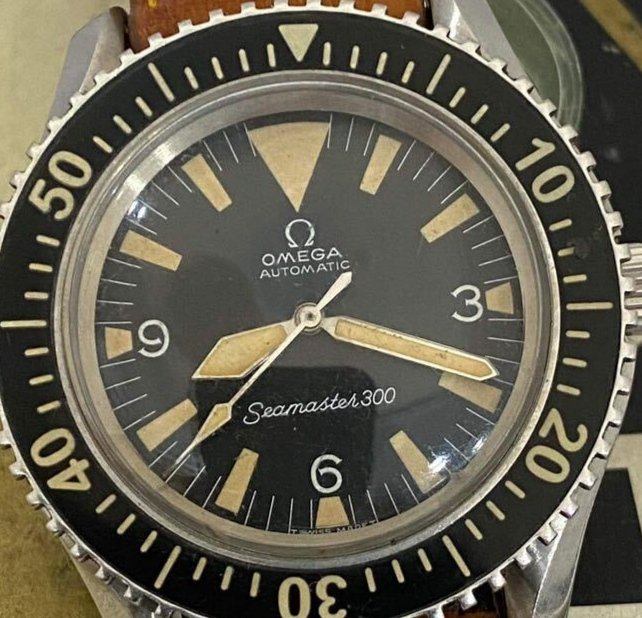

And another one:
Please comment on it too.
This dial is not correct, you can compare the font of 6 and 9 with mine. The other one I cannot tell, the image quality is too poor.

The first has stubbies (look between the lume plots and rehaut) and has at least a fake dial. No idea about the second, the lume looks more legit but as noted the pic ain’t great.
Unless you know what you are doing, you should steer clear of this reference. It is the most widely faked Omega it seems.

Both dials are fake. You are correct on the first one, I missed those stubbies... The second dial I just look at the serifs of the number 3 6 9 I know it is fake or a service dial.

Both watches could be complete fakes with an Omega mvmt. in the wrong number bracket.
